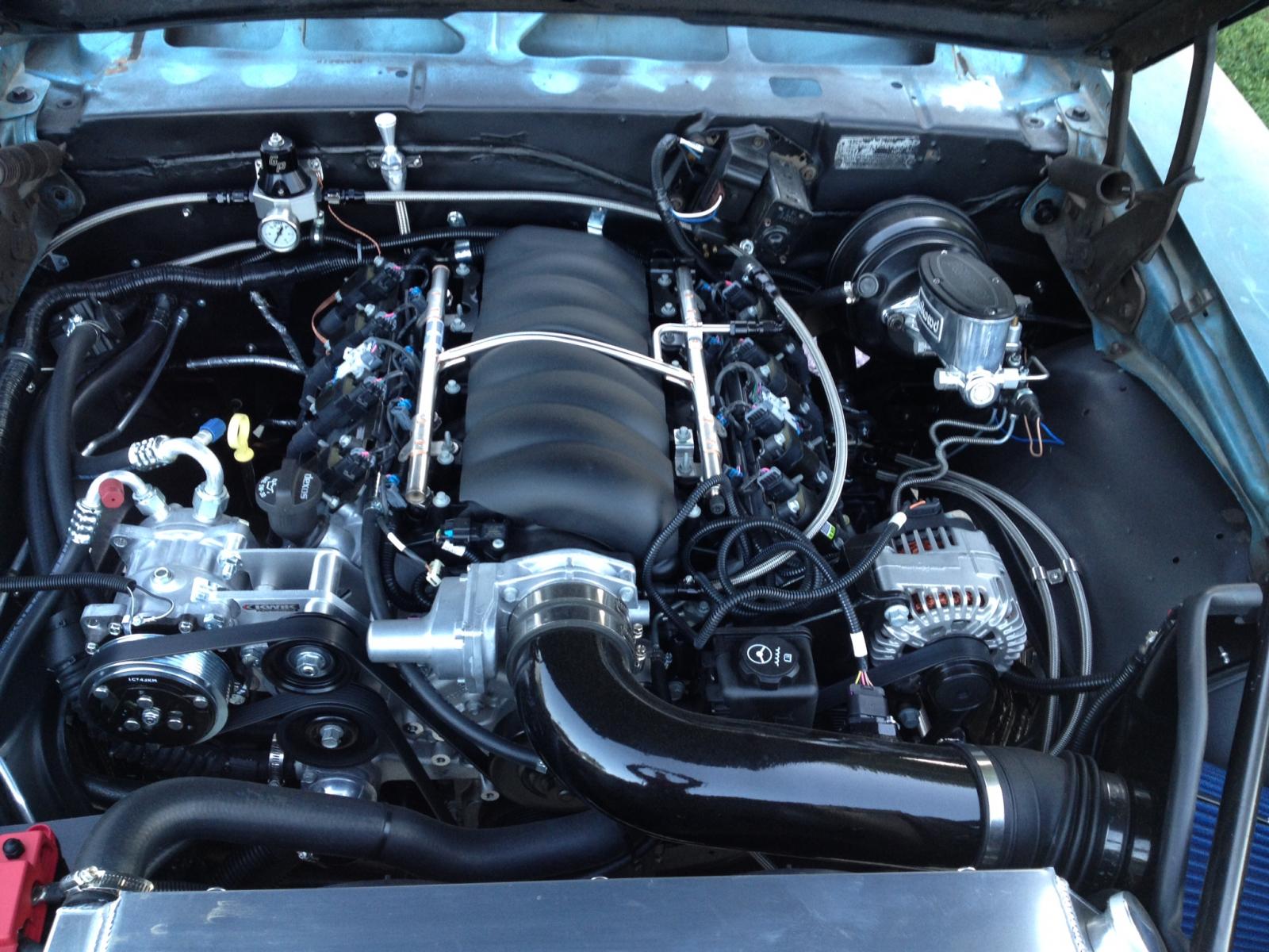

      get a factory gm one. i used a factory c5/c6 system for mine. all gm, easy to get parts and havent had any issues ever (6yrs) and 10k miles i just had to get a vintage air bracket to adapt my compressor to fit. This is a old pic from when motor went in.
