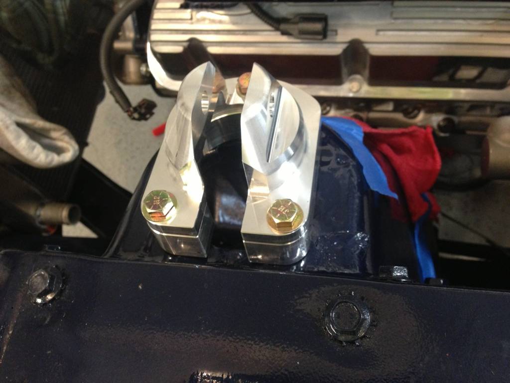

      First the upper shock tower: The three bolt slots need to be widened at bit. The bolts were about 1/16 wider then the slots.

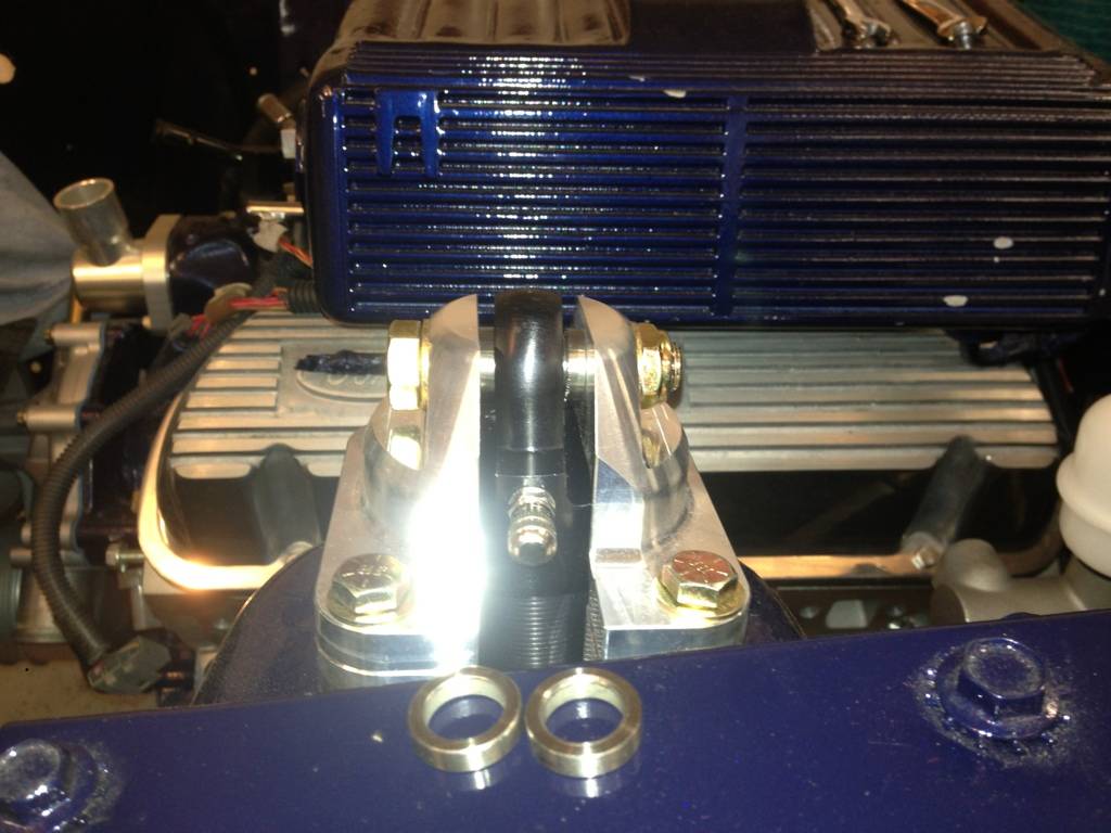

      I little work with a grinder open the slots just enough. The top two aluminum pieces fit in perfectly. The 65-66 kit has a spacer that the 67+ kits do not require.

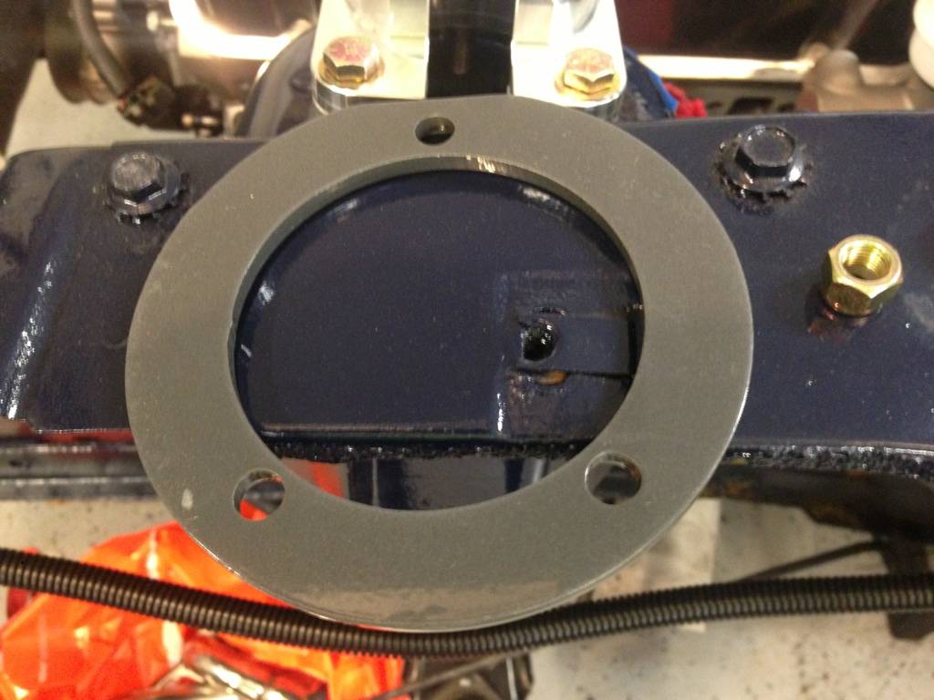

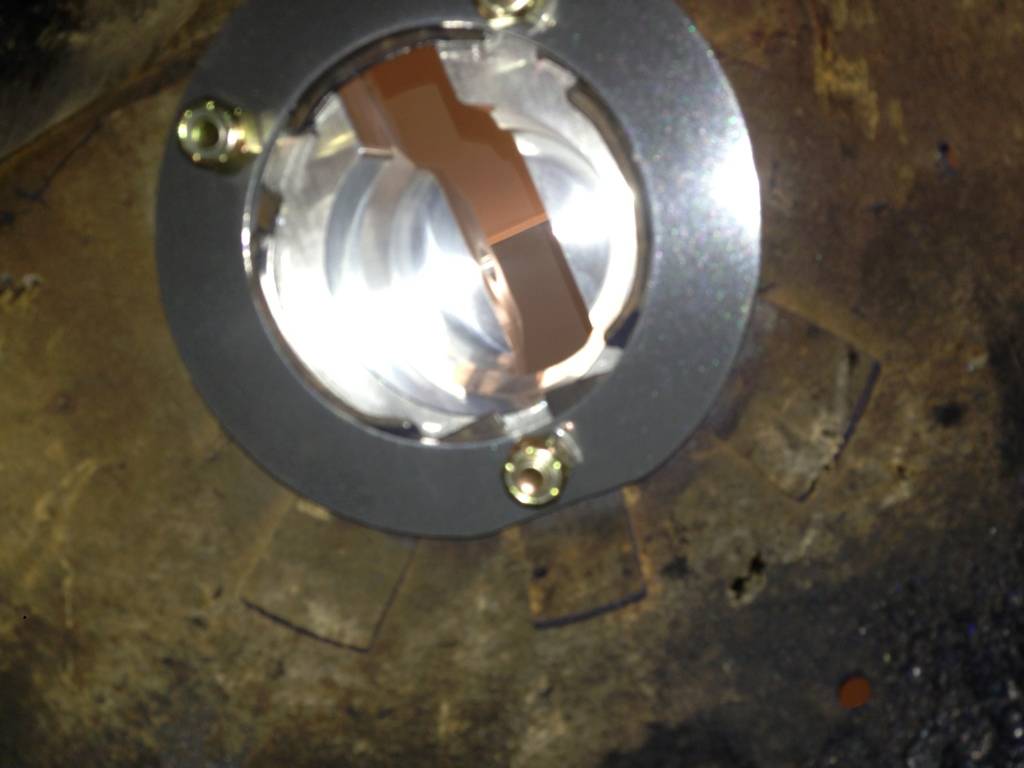

      Under the top of the shock tower is a round bracket that is put into place.

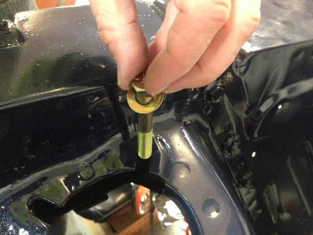

      The bolts provided need to be longer. When I put on my shock tower brace the bolts are too short.

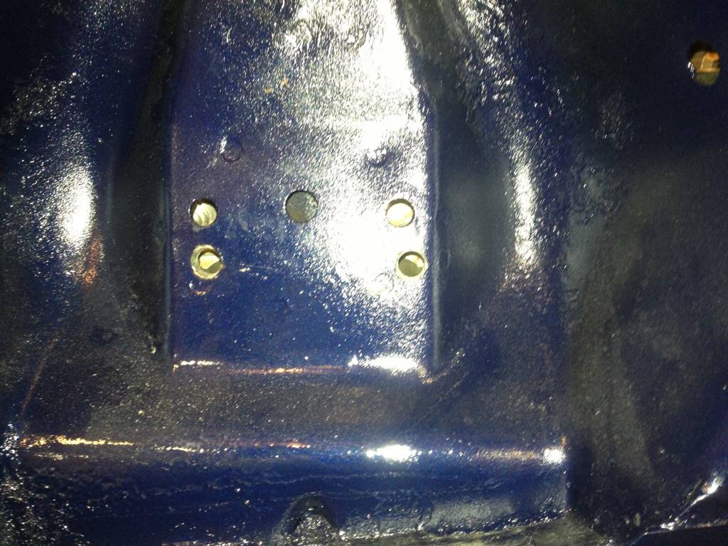

      The lower control arms need the shelby drop holes drilled into place. On the 65 its down 1" and back 1/8"

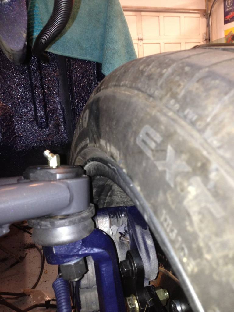

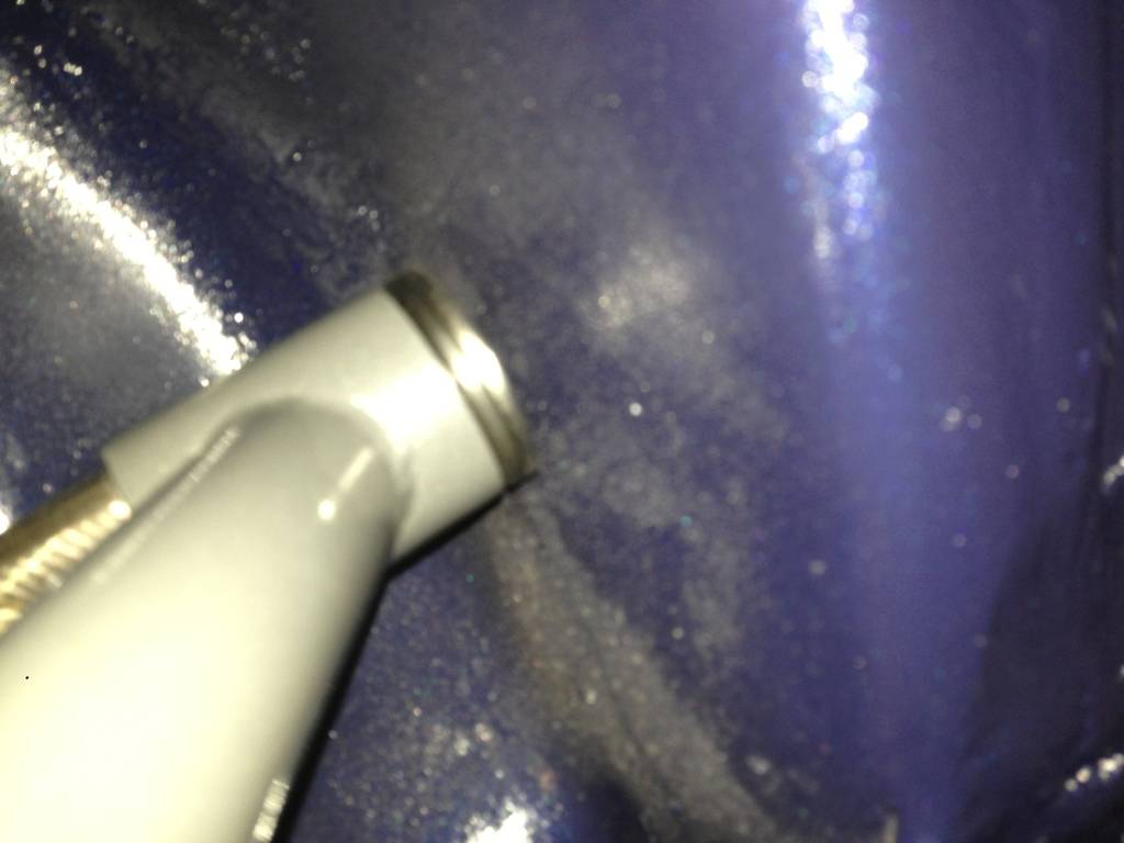

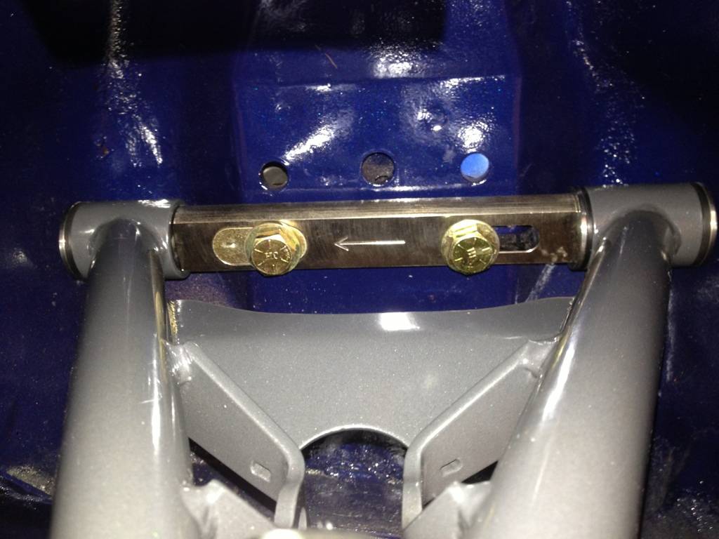

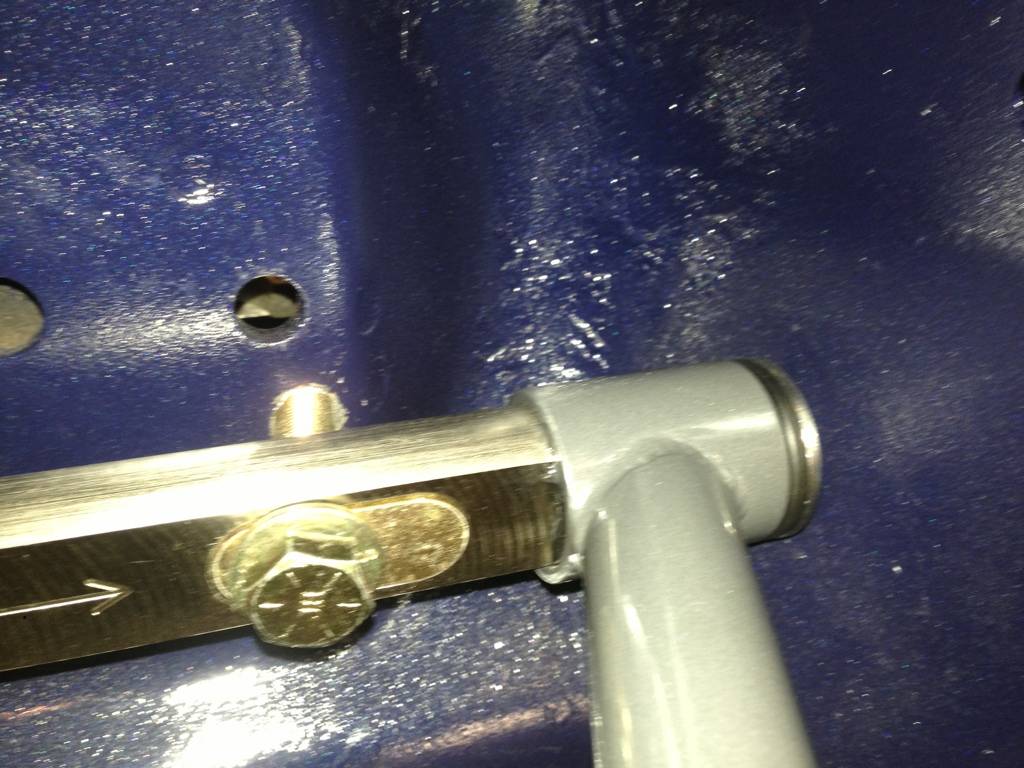

      The upper control arms needed a lot of work get fit. The arrow on the upper control arms point to the front. The back part of each shock tower needed some major hammer work to create the space needed for the control arms to fit.
      A fair amount of hammering and a little spray paint and the control arms fit like a glove.
      (Note in the picture the control arm was on the wrong side with the arrow pointing in the rear as opposed to the front.
      The coil over bolts in pretty easy. Aluminum spacers are needed to ensure a good fit.
      Once the top of the coil over was bolted into place the lower control arm and spindle bolted on easy as pie.

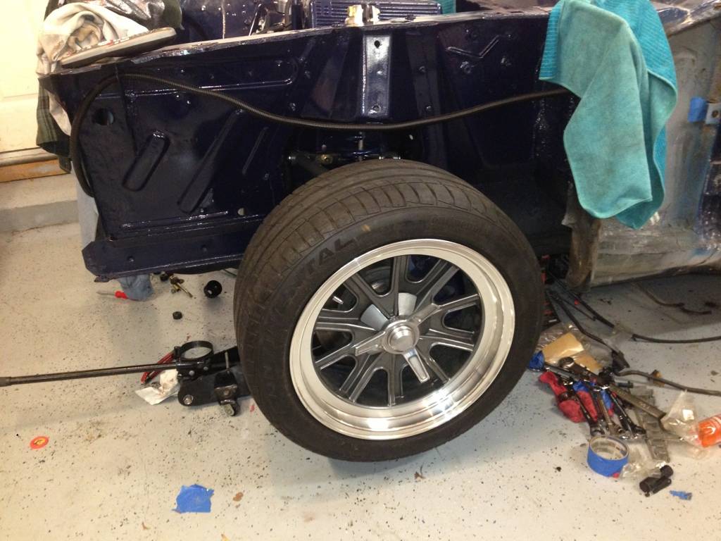

      I have noticed that Mike Maier is running 18" wheels. I was worried about the 17" wheels I am running hitting the upper control arm. I mocked up my hubs and brakes with a 1.25" spacer on wheels with 6" of back spacing.
      Overall I had over 5/8" of spacing. I am going to run a 3/4 spacer to move the wheel in and away from the fender to run the car as low as possible.
