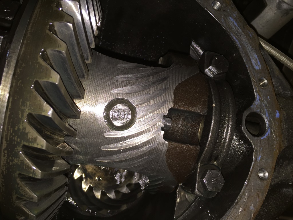

      Im going to put on new brakes and therefore removing the axles. First I noticed quite a bit of play in the axles (0,05"), and then when removing the diff cover The diff itself is a Little "loose". I dont know how these things are supposed to be but judging from the scars in the diff body something is wrong (broken bearing?)

      2. Can I still ute the diff and gears (if you look at the wear in the Pictures) if i change the broke bearing?

      Looks like the pinion nut came loose, or the crush sleeve collapsed?????

      1. Side to side play with c-clip axles is normal.
      2. You could still use the differential, but with the amount of metal to metal and shavings, i would look at a new gear set.
      The pinion has been rubbing the carrier.

      Thanks for the info. I took the rear end out today and its 8,2. From what I understand i can fix it but its probobly better to get a 8,5 and fix that one instead.
      And the Hunt begins...
