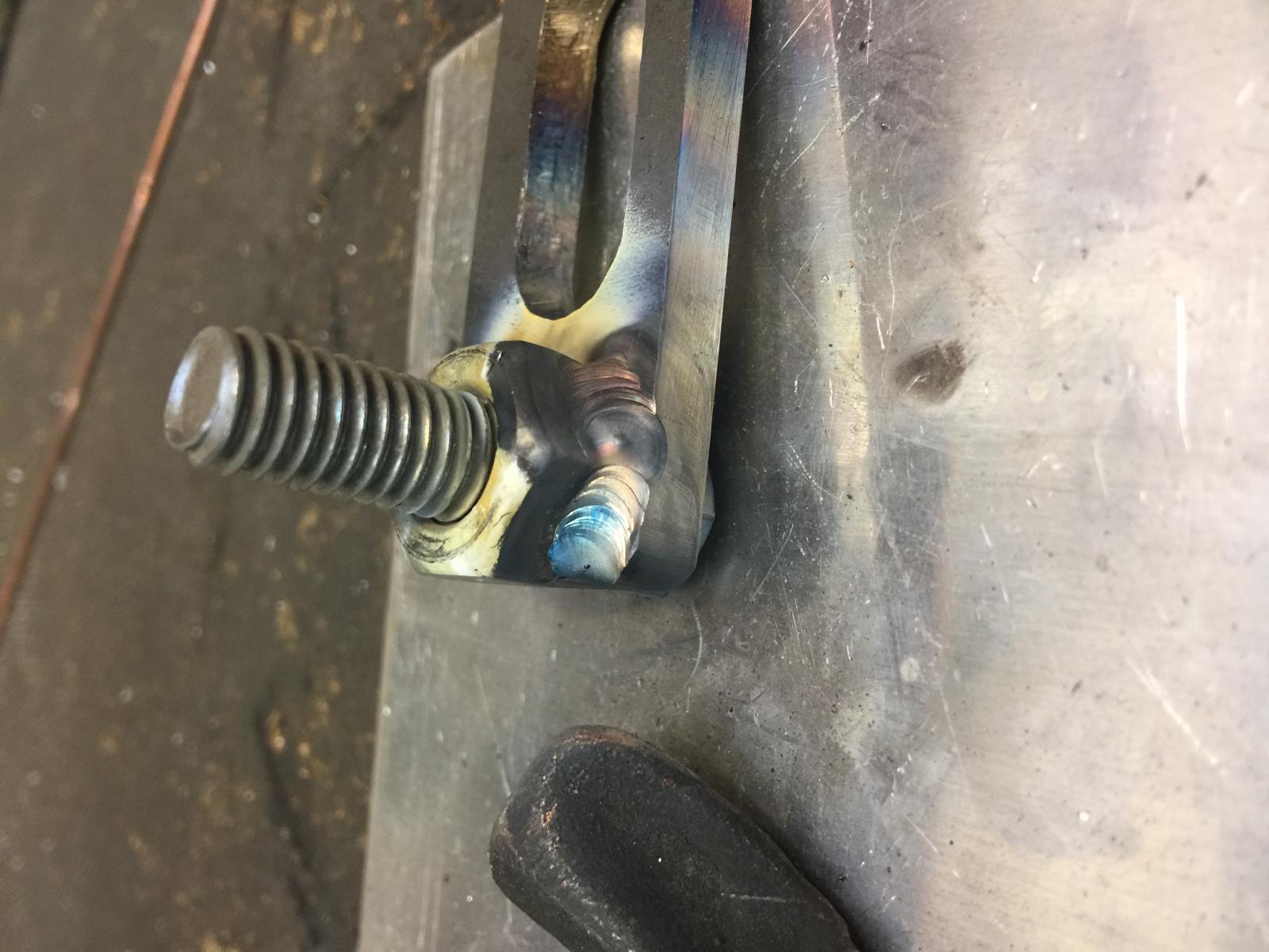

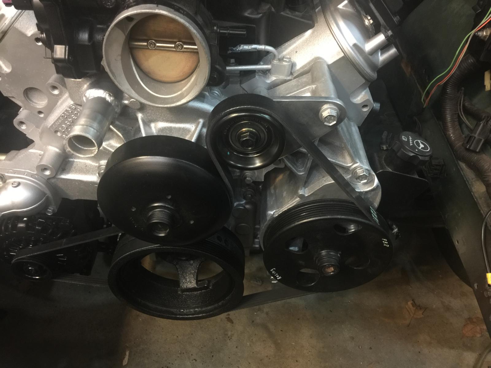

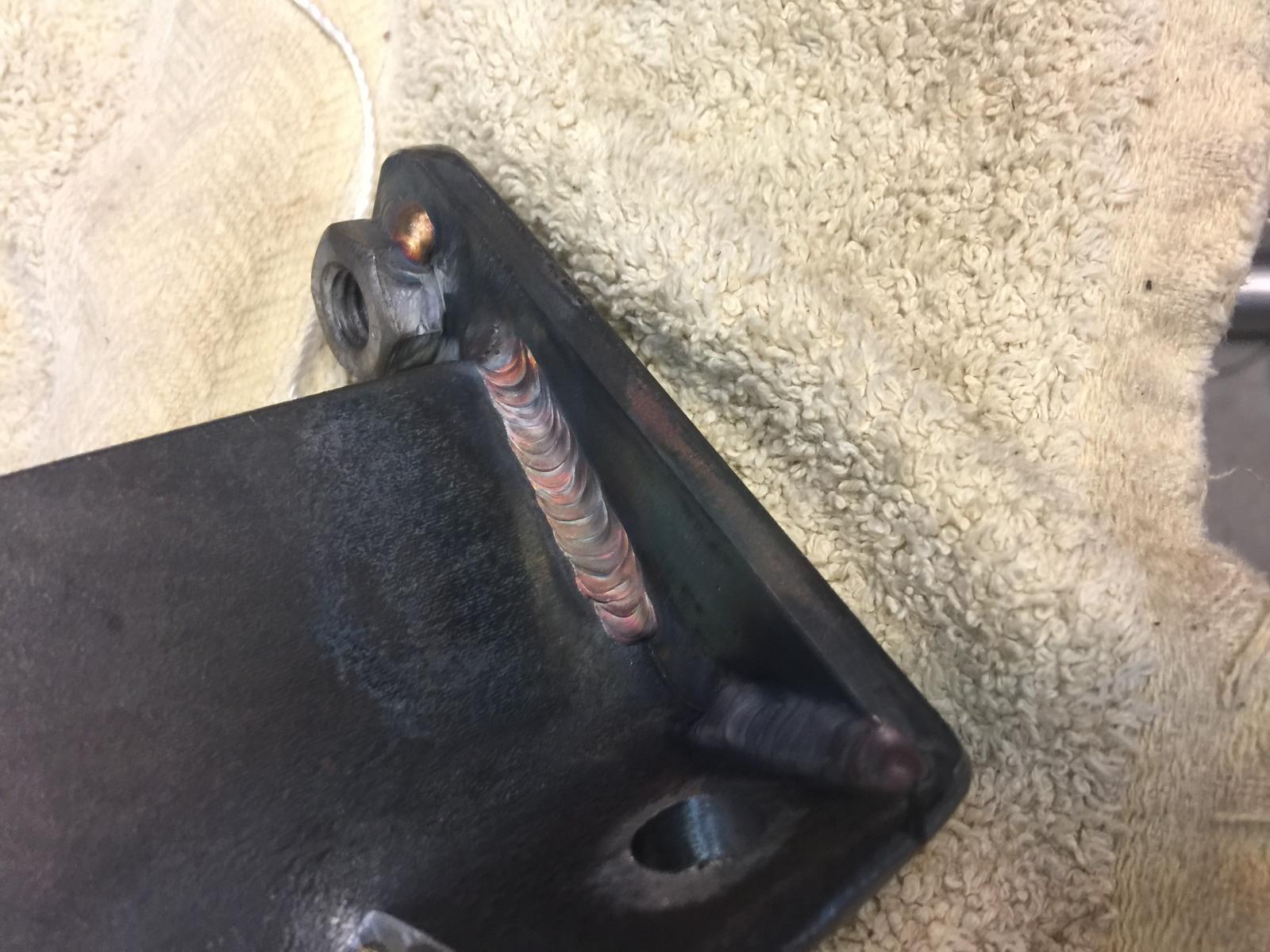

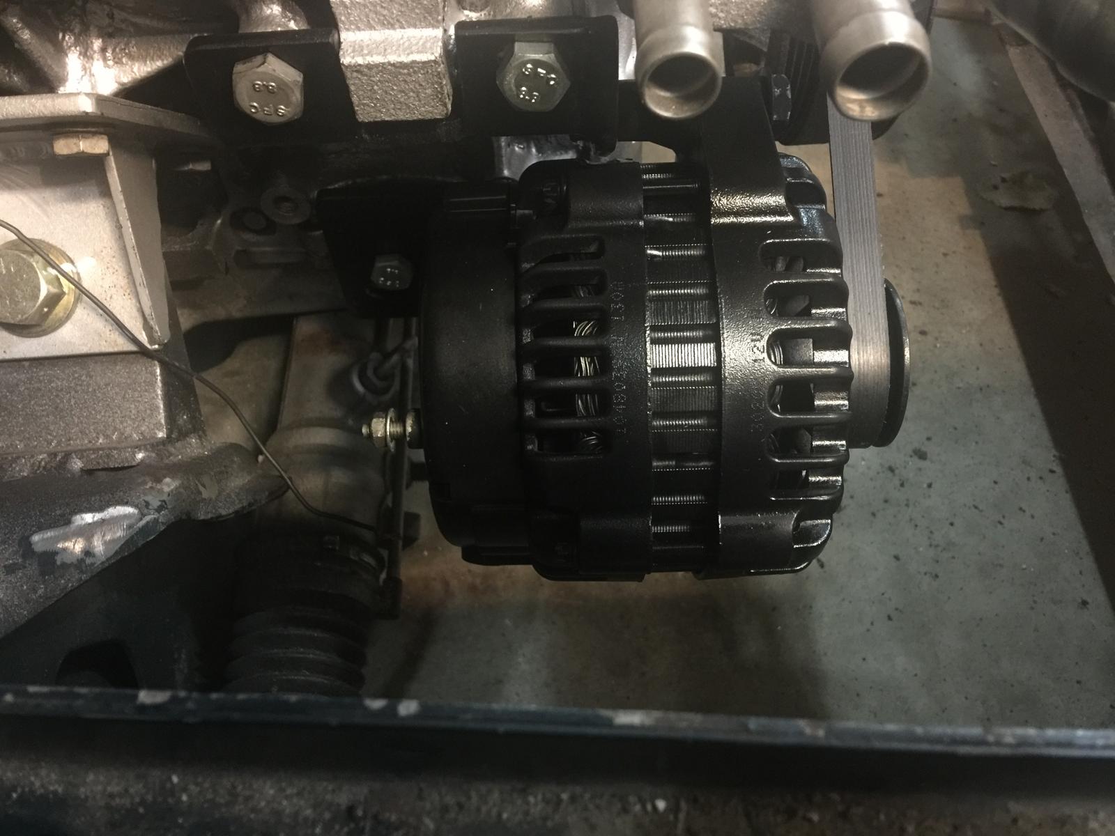

      I finally got the new alternator brackets finished. It went through 3 revisions and to many trips to the parts store trying to get the right length belt, but I’m happy how it turned out.
      Brackets

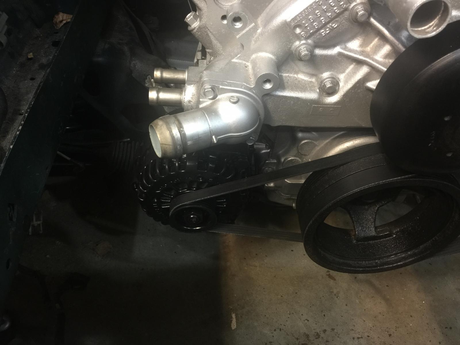

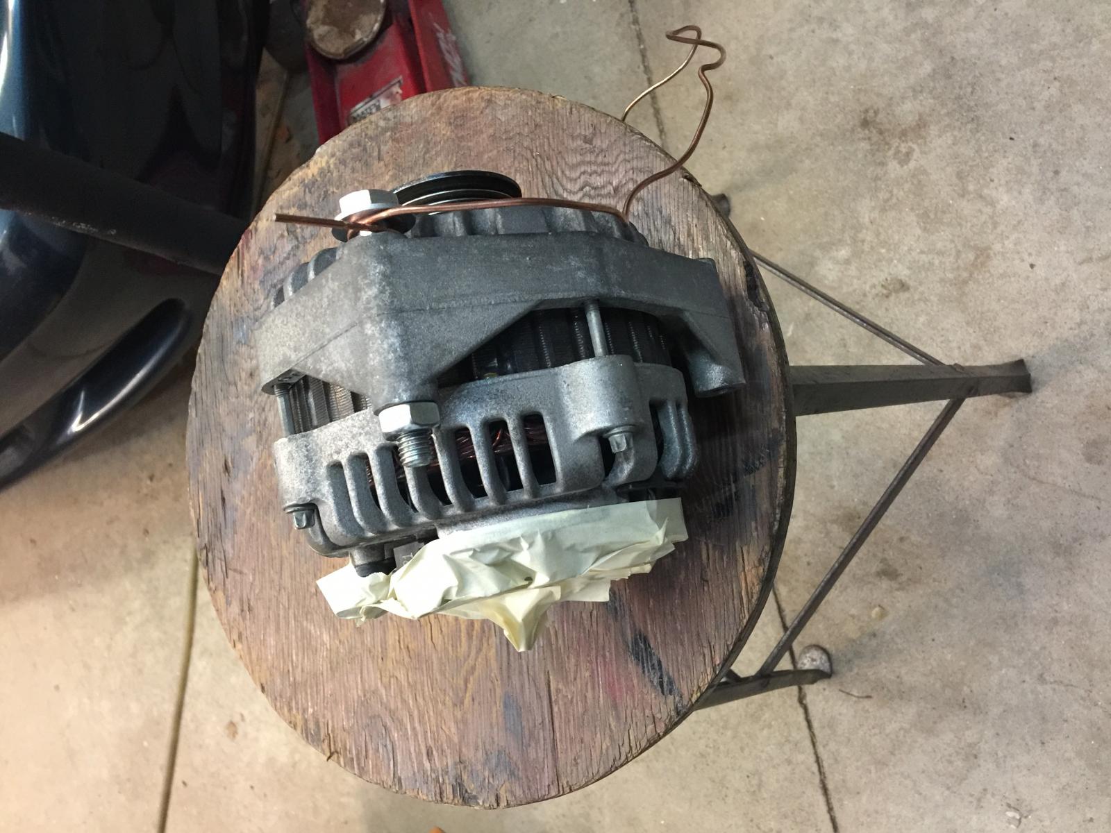

      Alternator mounted
      Wire brushed and painted the alternator and brackets. I didn’t take it apart, hopefully the paint won’t affect it.

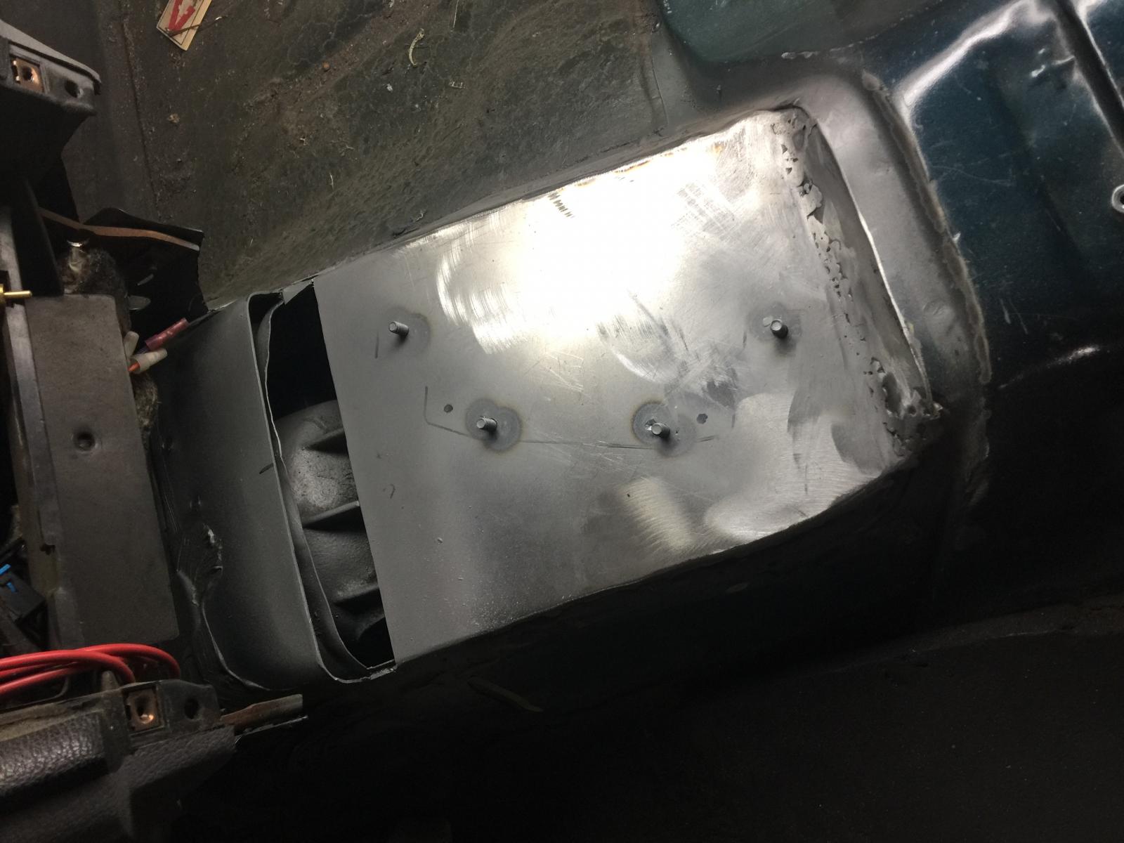

      Shifter mount

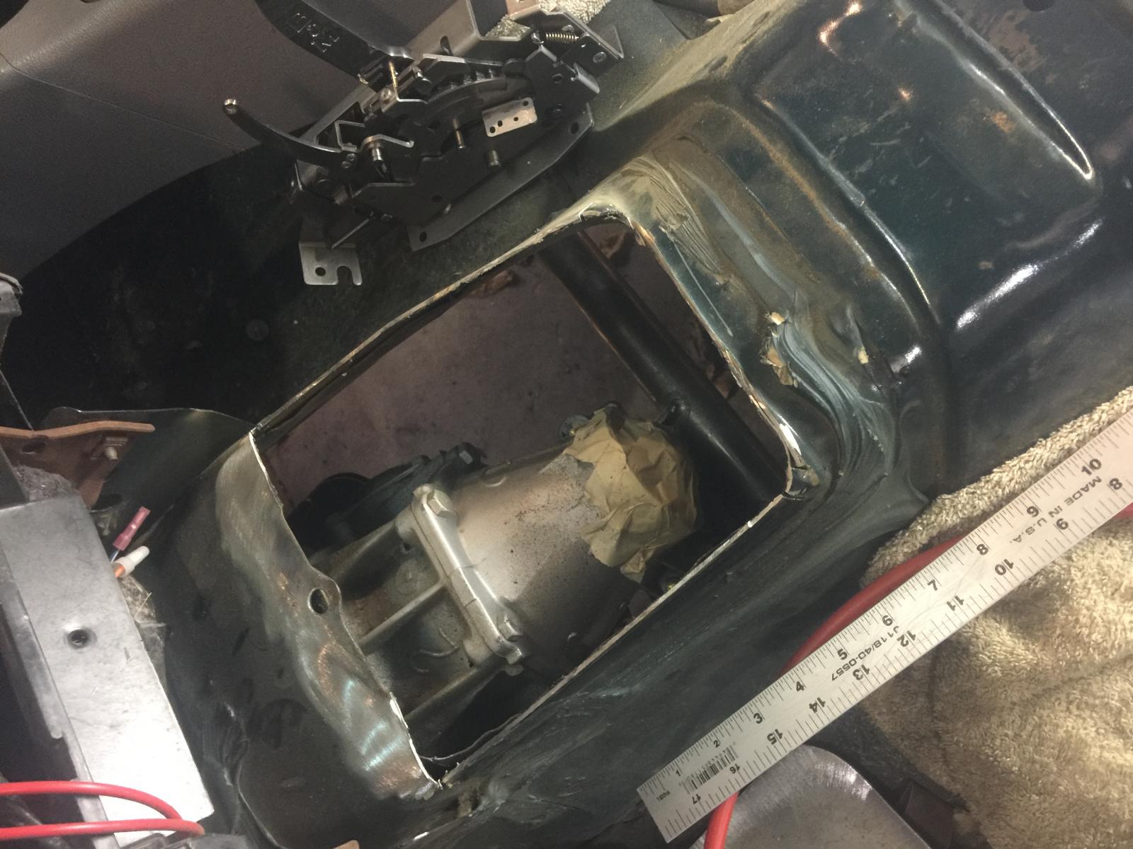

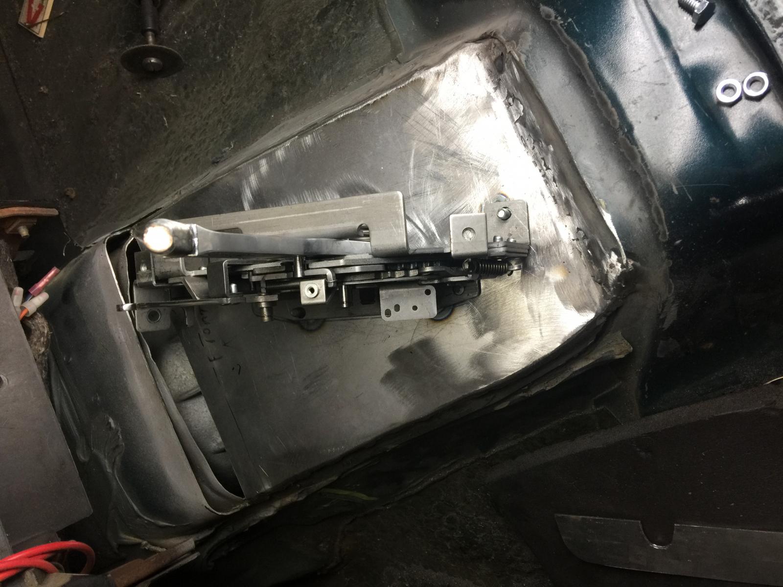

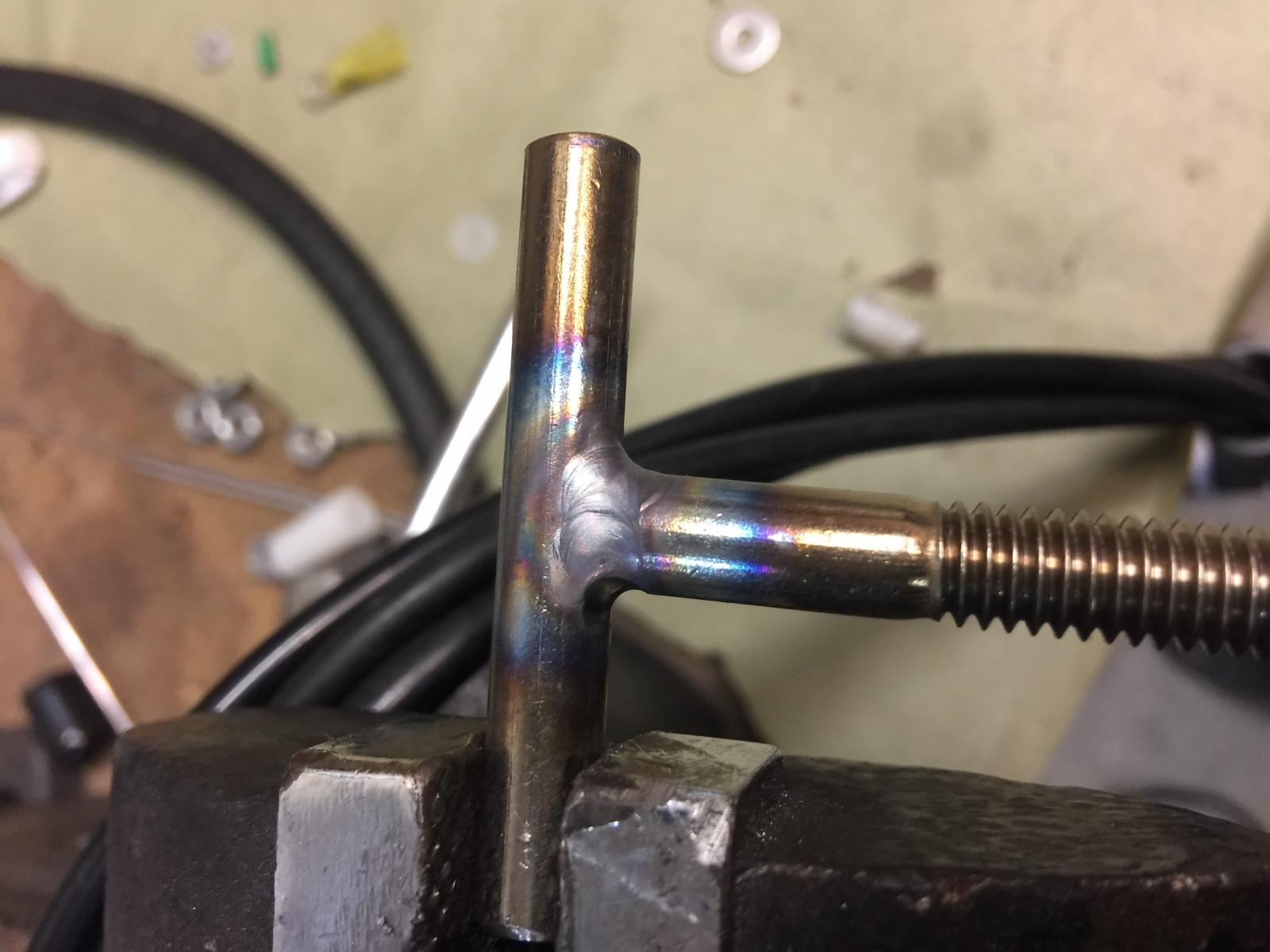

      I am using a B&M Pro ratchet shifter but wanted it to work in the stock console, even use the shifter boot from the stock 5 speed. The shifter was to tall and long so I cut out part of the tunnel so I could lower the shifter.

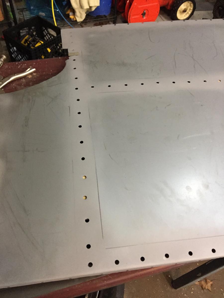

      Trunk Floor

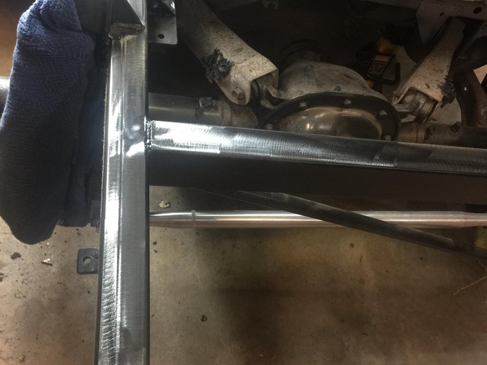

      Working to get the floor and wheel tubs finished.
      Rough cut of floor.
      Marked where frame rails were.
      Drilled holes
      Bottom cleaned and sprayed with weld thru primer.
      Top ready for welding.
      Frame rails cleaned

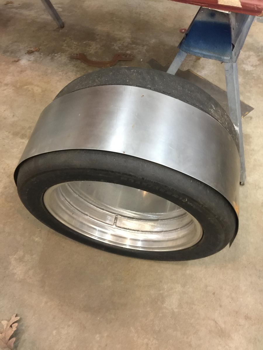

      I was planning to reuse the stock wheel tubs. Just move them in a few inches and weld in the filler strip between them. Well, it was not going to be that easy so I desided to make my own.

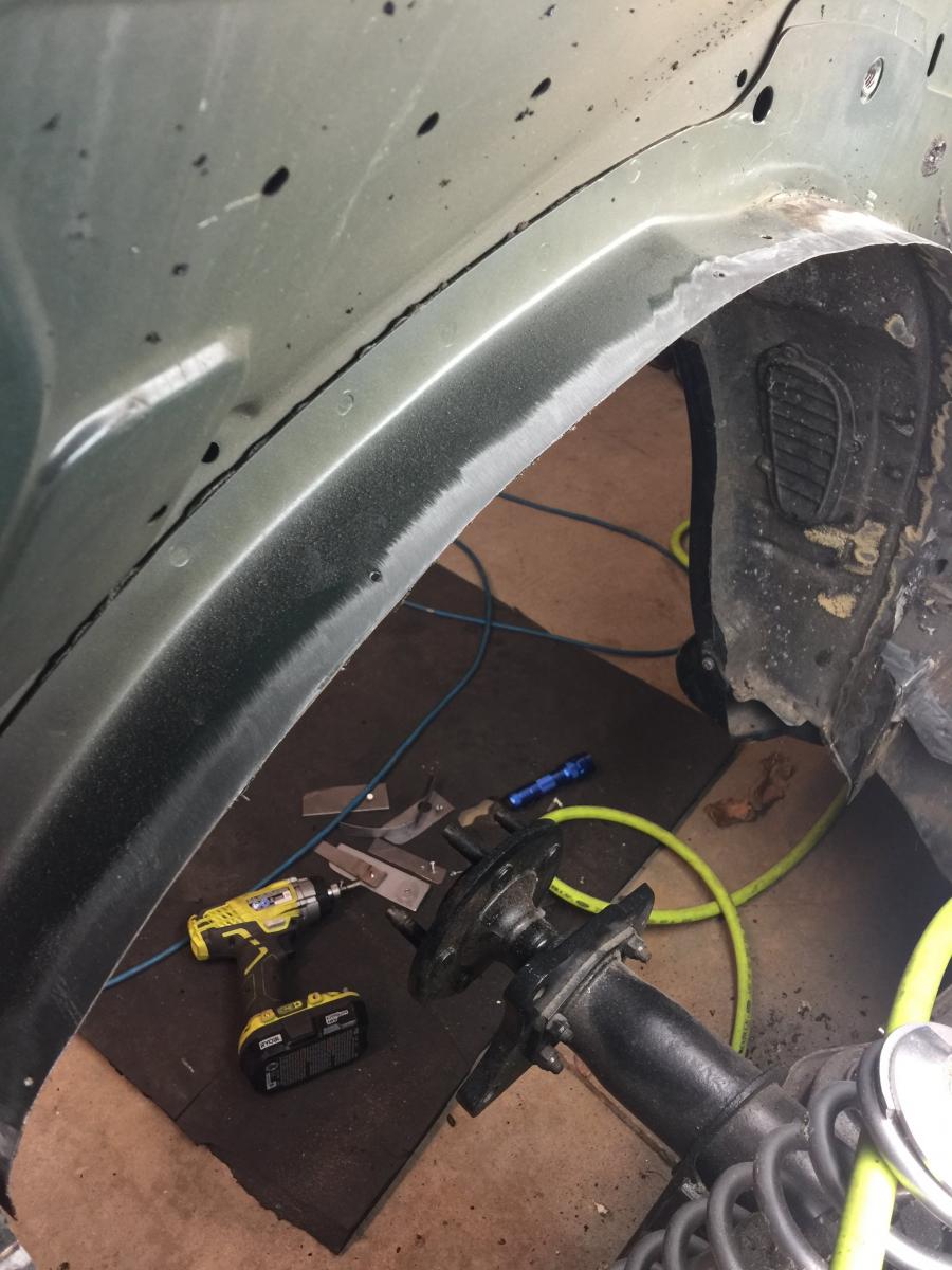

      Stock tub.

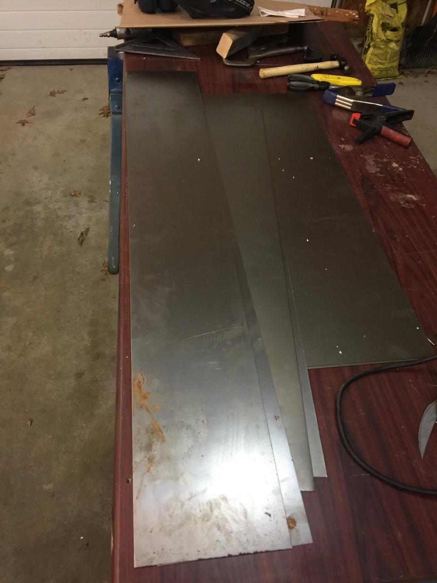

      Picked up some sheet metal cut to correct width.
      Formed the shape. Use what you have!

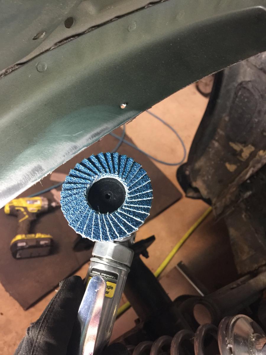

      Cleaned the paint off, I'm so happy I don't have much rust to deal with. These little flap wheels work great and were cheap on Amazon. First time I have used the little ones.
