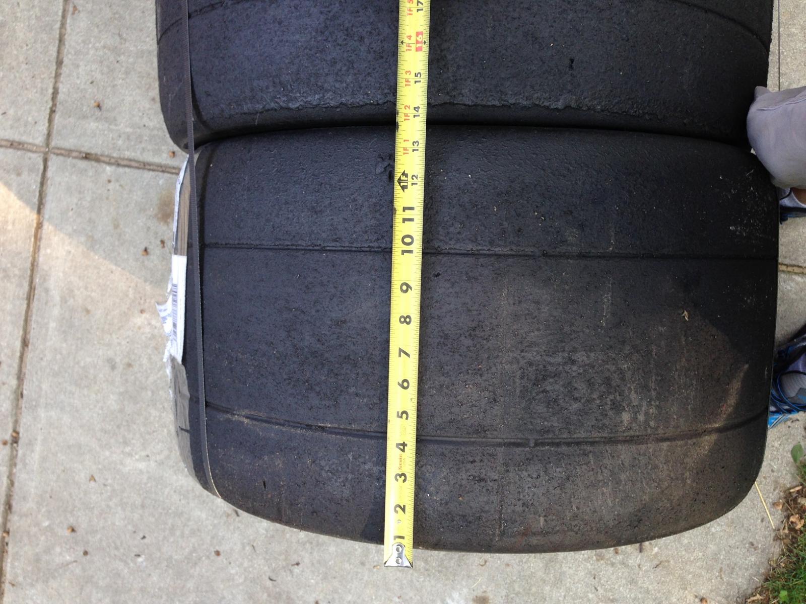

      I bought the tires before I bought the car so I wouldn't take the easy road and buy smaller tires to fit the car. They were even bigger than I thought they would be.
      Hoosier 345/35ZR18

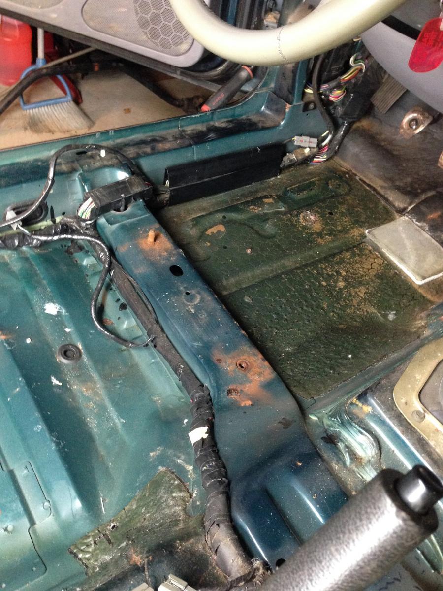

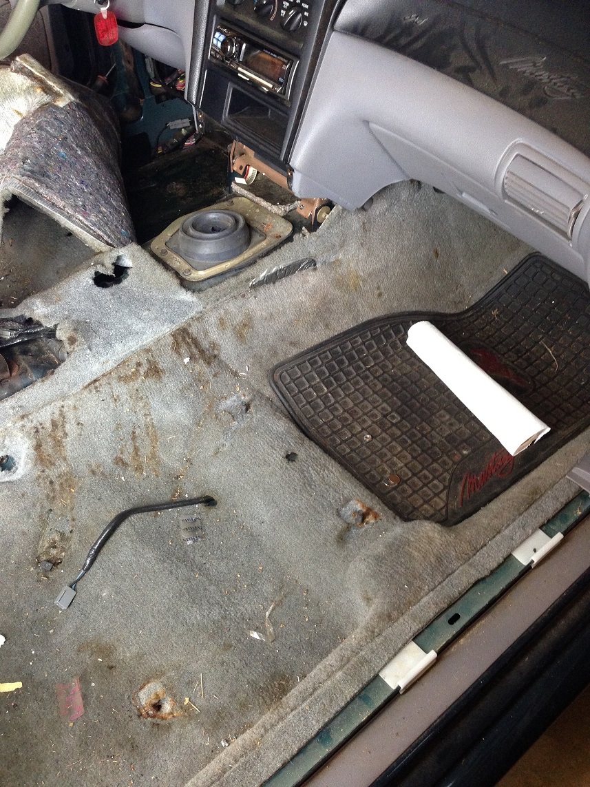

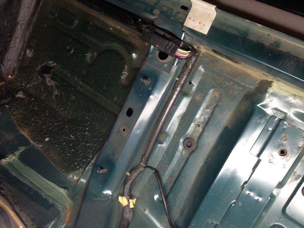

      The carpet and front seats were trashed when I got it.
      The guy included extra seats and some black carpet, so I tossed the seats and carpet. I am pretty happy with how solid the floor is.

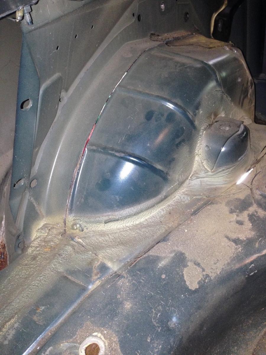

      Needed to make room for the tires, so out came the wheel well.

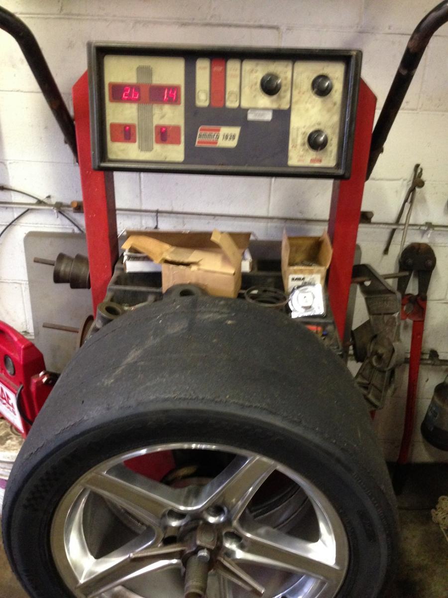

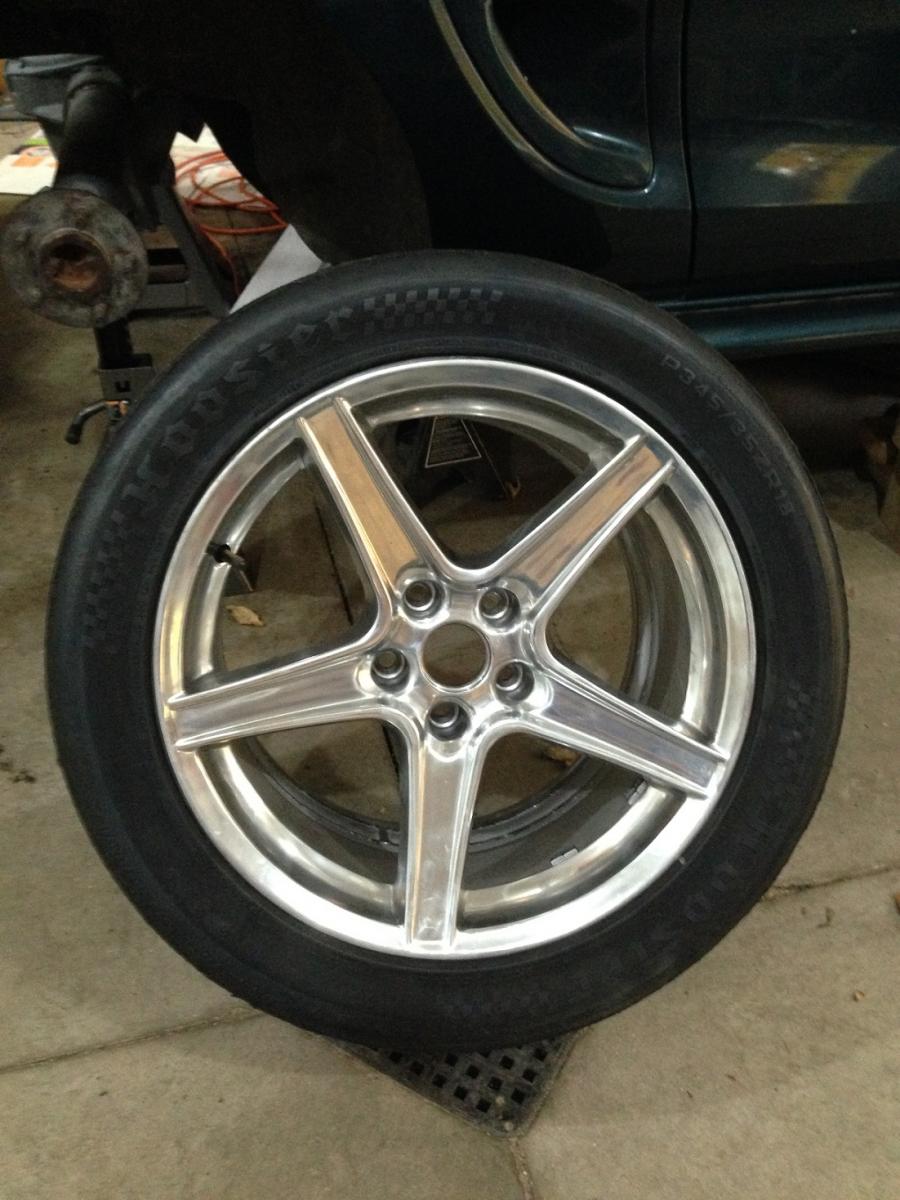

      Sorry to disappoint you guys, but the bullet wheels were already sold. They were beat up and not even the same color, must have been off different year cars. After looking a a bunch of pictures, I still love the Saleen wheels on these cars, so thats what I went with. Of course there are better wheels, but not in my price range. I took them to my brothers shop to get the tires mounted. I didn't think about valve stems until the day of and after stopping at 3 places for some bolt in chrome stems (with no luck) I used the rubber ones. I will change them at some point.
      Here is the first check on the balancer. I thought this was a lot of weight but considering these are heavy wheels that have been modified and used tires he thought it was pretty good.
      And it balanced out OK.

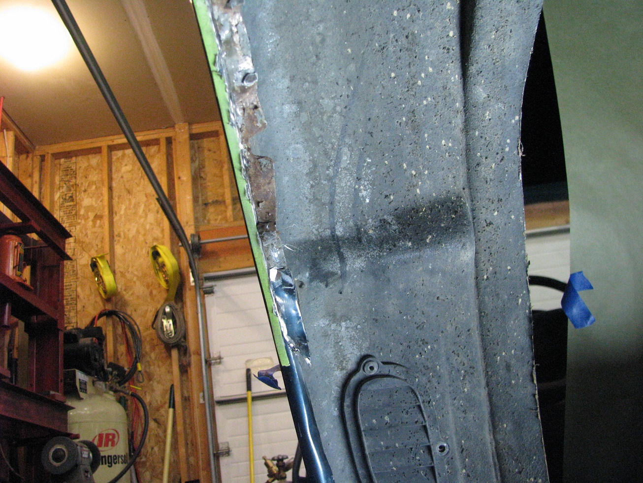

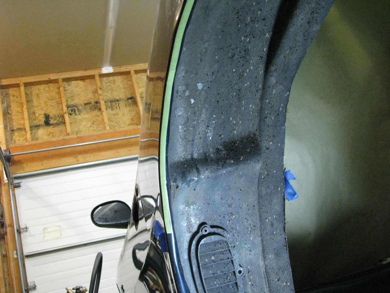

      Fender lip rolling
      My first attempt at rolling the fender lip did not go well. The inner fender lip meets up with the quarter panel so once "rolled" up (it was more like beat up, with a large hammer) it was 4 layers of sheet metal with seam sealer in the middle. It looked terrible and was still to wide and rubbed the tire.
      Here is the first "rolled" attempt.
      I put the tape on after to act as a guideline for cutting the lip off. I bent it back down 1st then cut away.
      Here you can see the inner fender after the quarter was cut off. More spot welds to grind off.
