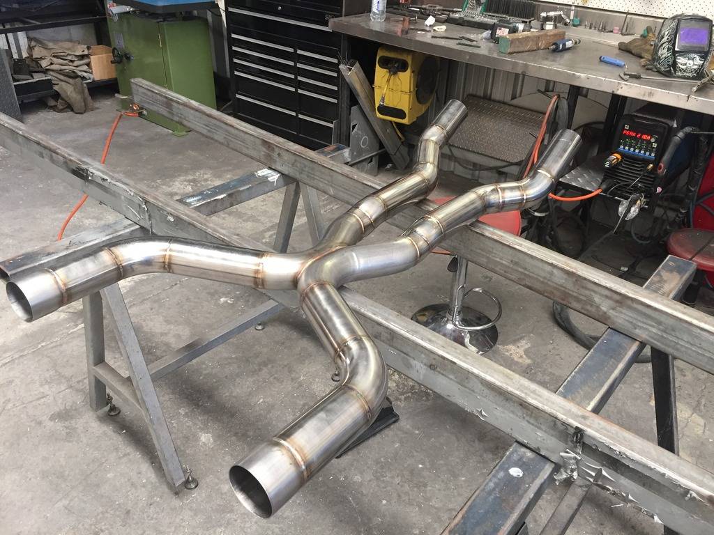

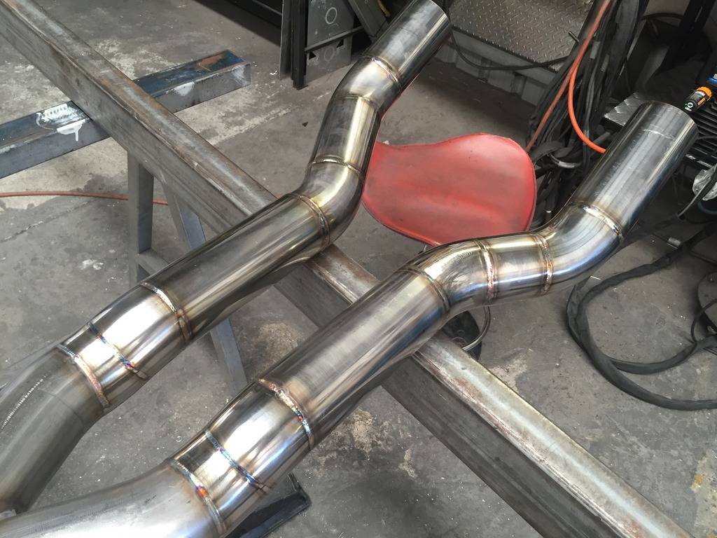

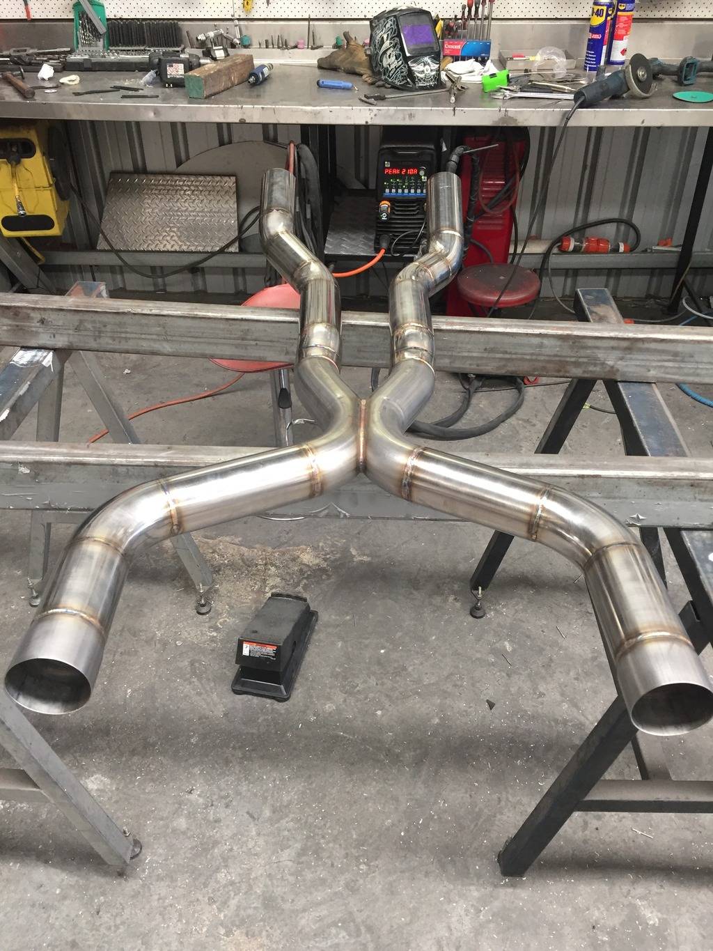

      Ok. Driveshaft made and fitted. Exhaust coming along....

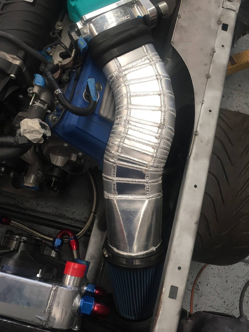

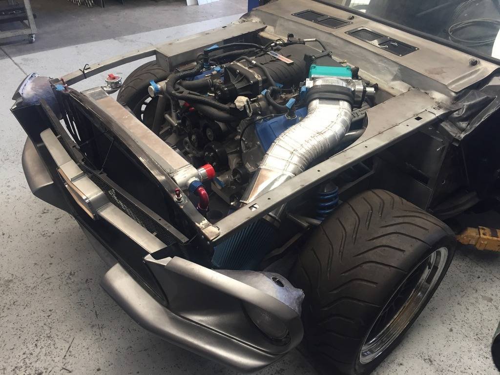

      The teal coloured piece you see above the throttle body is an extension to the intake on the supercharger. It is a 3D printed plastic piece to check the fit. Without it the hood just touched the throttle body and this piece kicks it down slightly and allows it to clear. The final piece can now be machined.
