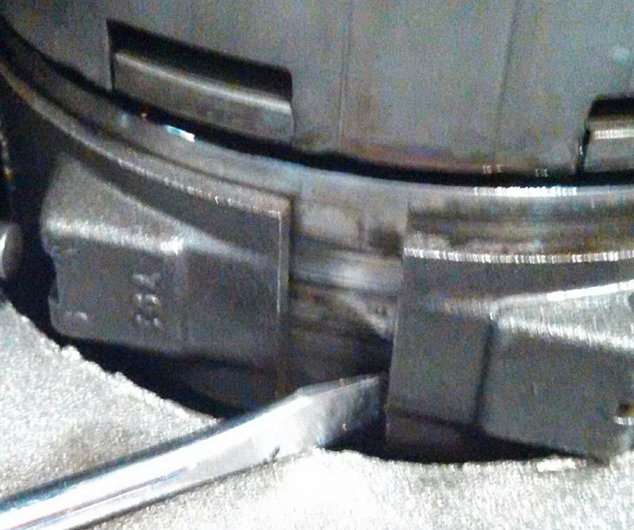

      So ended up having to crack her open and your cause was correct... Your reason was not... The reality was SOO MUCH WORSE...
      The band had seized itself to the drum and the drum was scored all to hell...
      Thanks for help, but this one is looking like a boat anchor...

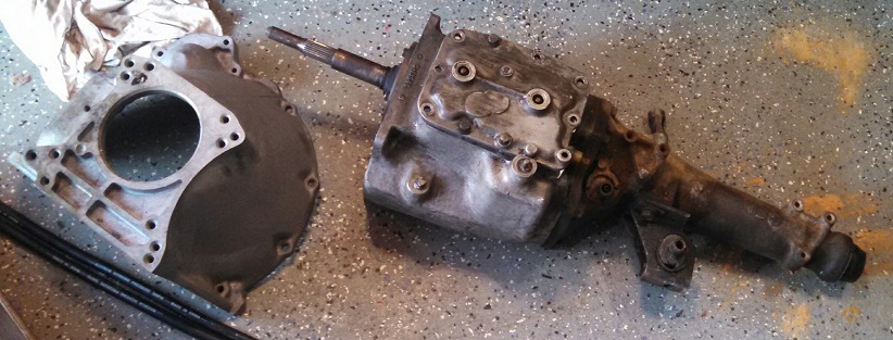

      Thank for the tip. I decided to use the money to do a manual swap. Found an A-833 OD unit for a couple hundred on CL that I'm gonna clean up and swap in.
      So I will now be bugging the manual guys trying to figure out how to get that accomplished.
      Any one know if there is any value to a 904 core? Not being a 727 I figure it's pretty much a boat anchor at this point.

      Since that is a factory OD trans, you might want to have it checked out by a local shop, unless you were able to drive it prior to purchase. The aluminum cases on those were notorious for wallowed out counter shaft bores. They can be sleeves and rebuilt if it is, but it adds cost to the conversion. Also, since those OD cases only came in A and F body cars, are you sure its long enough for use in your Challenger? Chrysler typically had two lengths in manual transmissions; short for A and F bodies and long for B and E bodies.
      To swap you will need the clutch/brake pedal assy, all the linkages, shifter and rods, trans tunnel and carpet along with a few wiring tid bits, if you want to keep it factory looking, as well as all the clutch parts. I use Brewers Performance for these parts on my cars. Typical auto-manual conversion runs about $3500 for everything, but if you found a trans and bell for a few hundred, you can knock a grand and a half off that total.
      Value of the core... not much, even if it was a 727. Chrysler made millions of those two transmissions. The 904s use less power to spin and can be built to hold up to high power. 727 are simple brutes that will stand up to huge abuse.

      I tried to make sure everything was kosher on the tranny before I bought it as far as sizing goes. It has the double shifter mounts and is 27" from case face to tail. I believe it is from an 80ish truck... I was aware of the possible wallowing issue with the 3rd gear OD and had planned to have it inspected. A rebuild would set me back around $400ish (as long as no major parts are damaged) so I haven't decided if I'm going that route or just gonna use the money saved to invest in some tools... (mmmmmm PRESSSSS!!!!!!!!!)
      My plans are to go with a hydraulic clutch setup and I know I can get pedals and tunnel mod from they typical restoration sources and clutch and pressure plate from typical performance shop. It came with shifter and linkages... I will need new linkages as these were for the forward shifter location. It has an oldschool hurst shifter, but a truck shifter handle (though I would LOVE a pistol grip I'm not sure its worth the $$$)... So I will have to do something there... or drive like I'm in an Ed Roth cartoon...
      Though just buying a kit and not having to round up all the parts would be nice I just CANNOT justify prices on swap from places like brewer... $4000 (maybe $2500 since I don't need tranny or bell housing)?!?!?!?!?!?! that is 1/5 of the total cost of my car... and its not like I'm getting a T-56 or even a 5 speed out of the deal...
