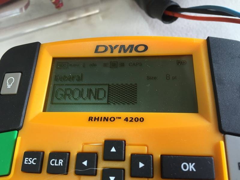

      I thought I would share this cool tool for wiring. It prints on heat shrink tubing. You can get white or yellow with black letters. It does a nice clean job of identifying wires if you haven't installed the connector yet. It might slip of some smaller ones but I have not had to try it yet. I haven't tested it yet with under hood temps but I plan to soon. I will hang some junk wires under the hood of my daily driver to see how they hold up.

      great tool where and how much $$$$ also any more info regarding two things...dse steilow housing ends ive emailed dse and they cant even be bothered to return a email. as well as the abs system did your guy come back to earth ?

      The heat shrink label tool is under $50 - http://amzn.com/B005MR516Y
