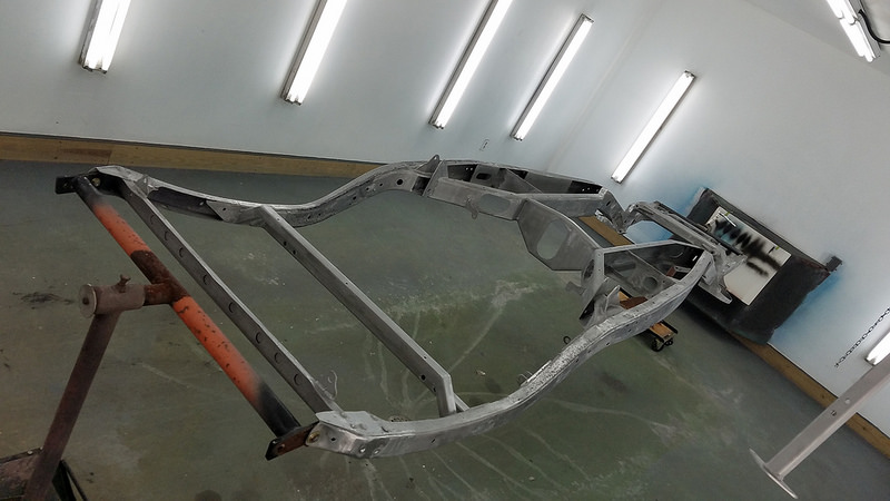

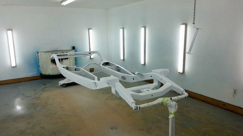

      Now the fun part! Strip it all down and get it ready for body work.

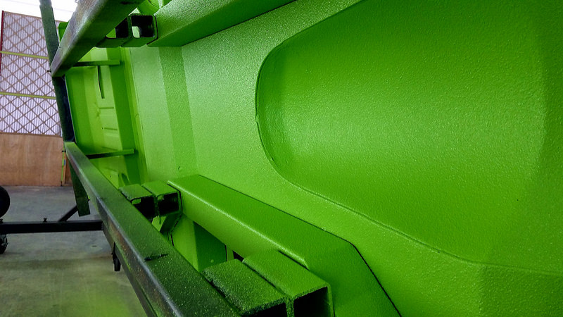

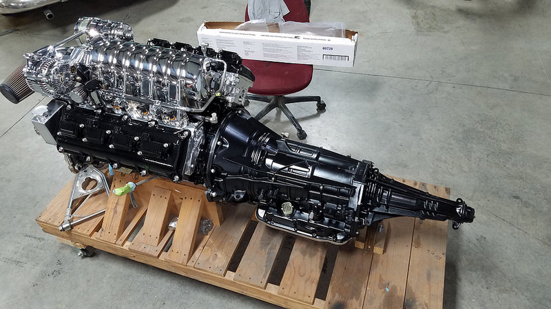

      Finished Cleaning up the HEMI and painting the transmission. Customer decided to do body color floor coating plus the belly pans will cover most of the bottom any way.

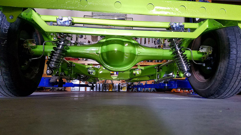

    4. #24
      Tennessee

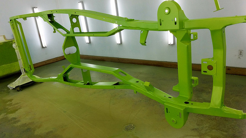

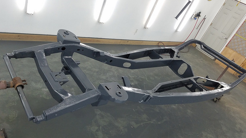

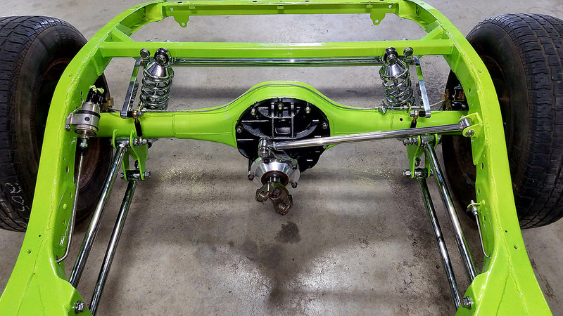

      499

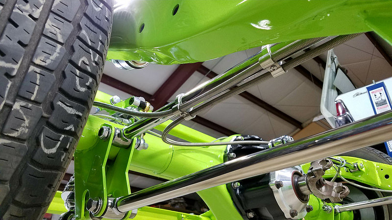

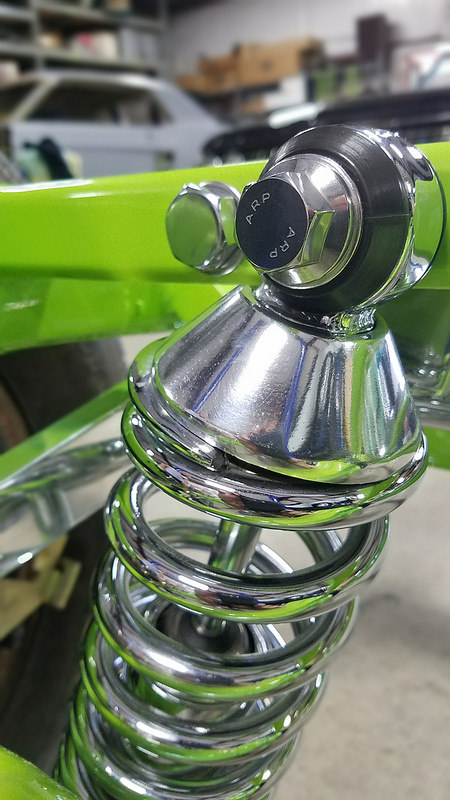

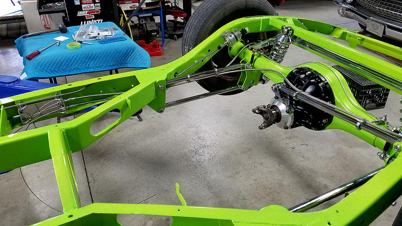

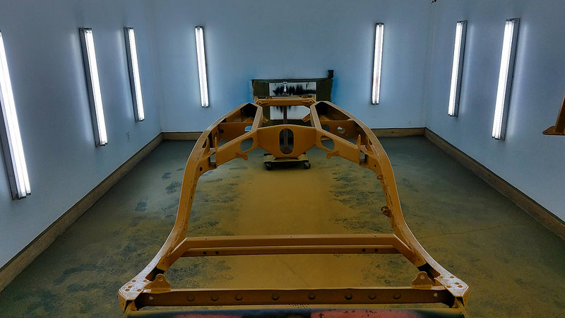

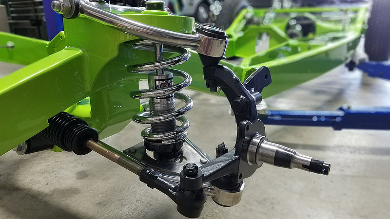

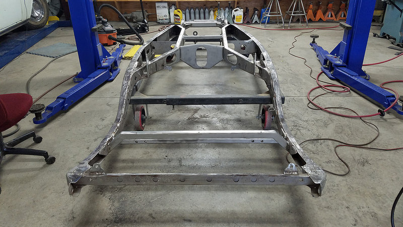

      Frame is coming together pretty good. The front is Fatman IFS and the rear is a TCI rear 4 link with sway bar. I have also upgraded all the bolts to ARP stainless.
    5. #25
      Tennessee
      499

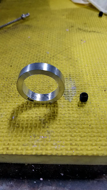

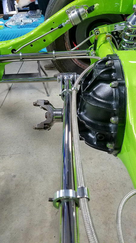

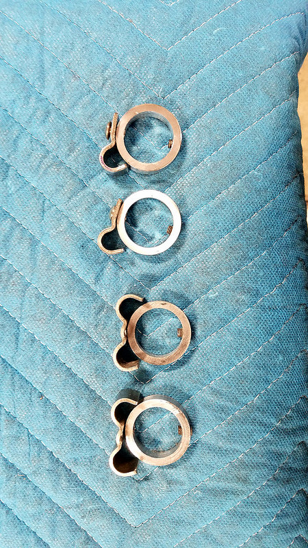

      Because I will have belly pans I need to get the E-brake cables up out of the way. So I milled some aluminum rings to go on the 4 link bars to hold the cables in line and keep them up off the paint.

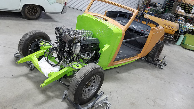

      Engine and frame done and ready for the body.

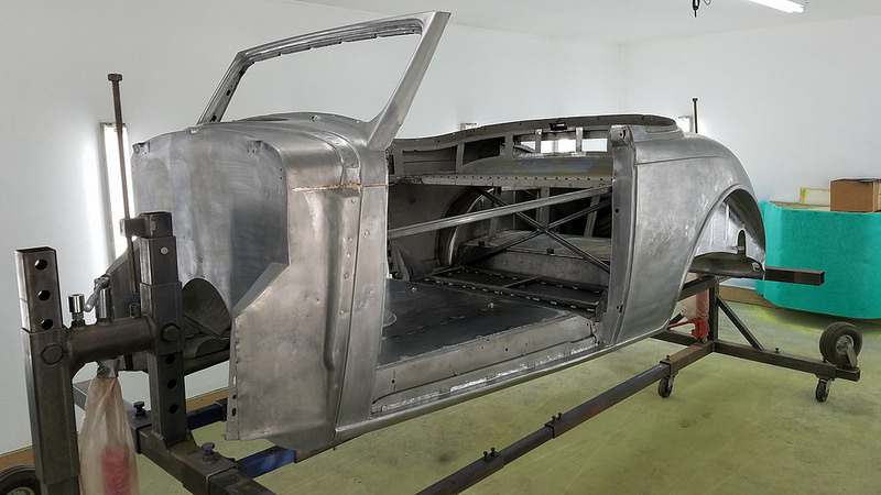

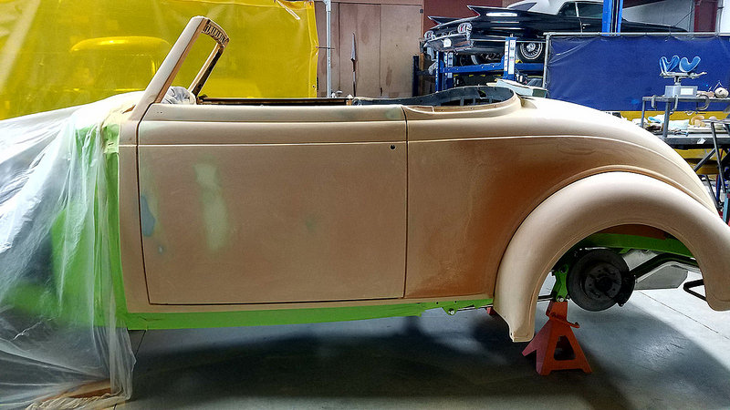

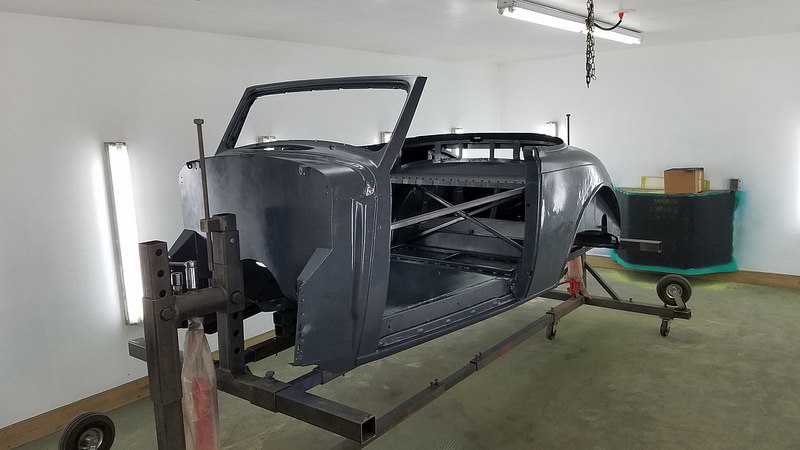

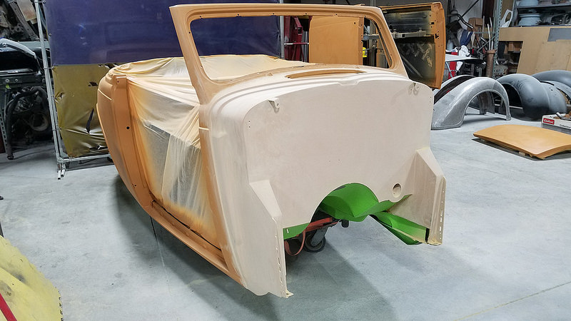

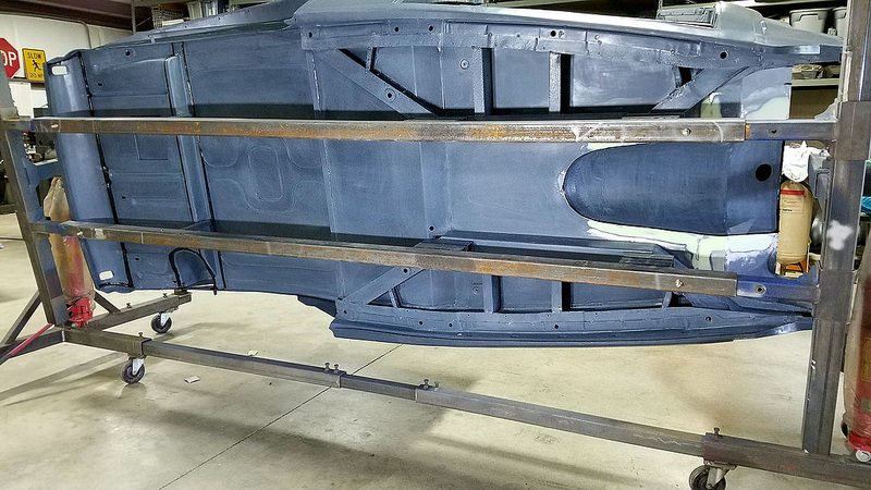

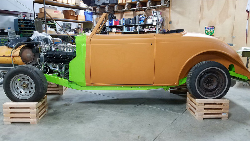

      Before we set the body on the frame we did all the body work on the firewall and painted it. I really wanted the body mounted for the last blocking so everything would come out nice and straight.
    11. #31
      Tennessee
      499

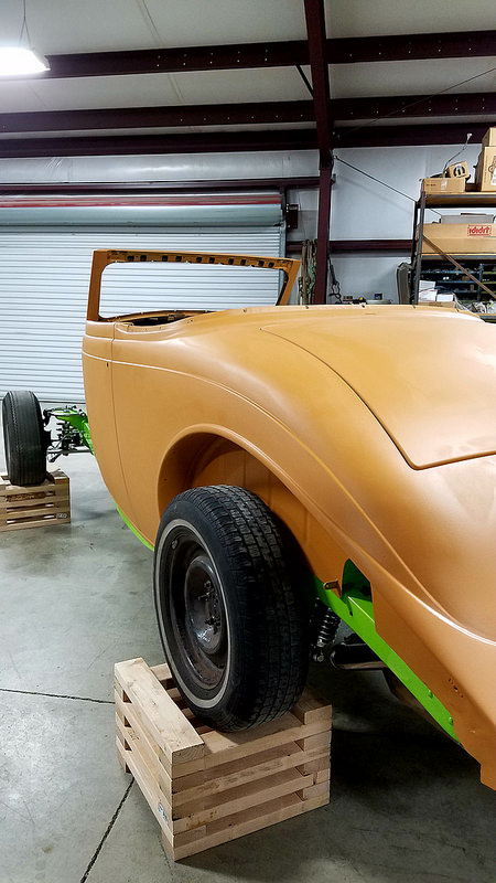

      Firewall painted and body tightened down for the last time for blocking. So far it's all lining up as planned.

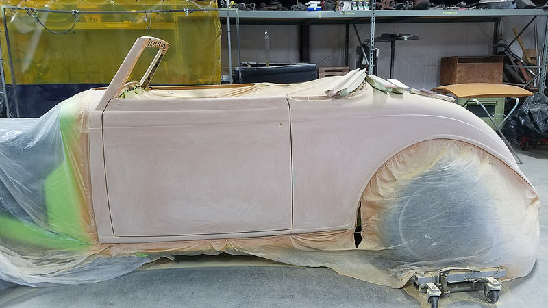

    12. #32
      Tennessee
      499

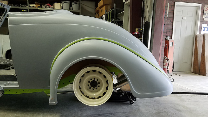

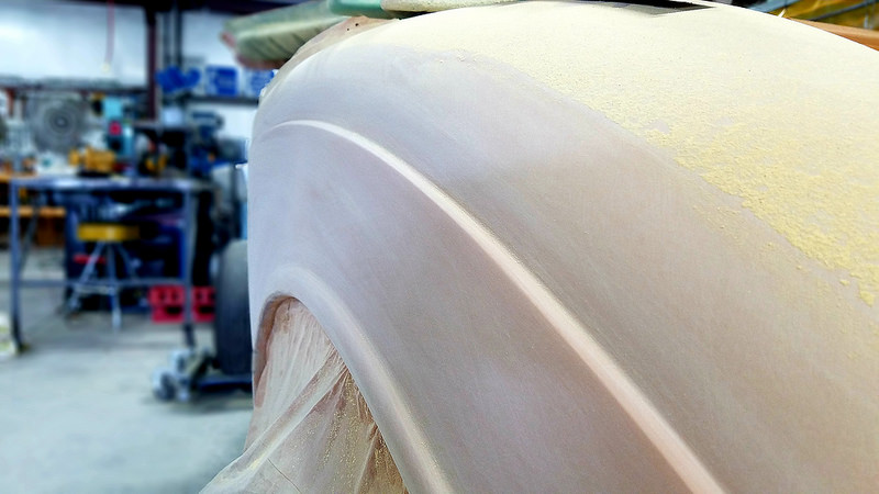

      Now for the sanding party!!

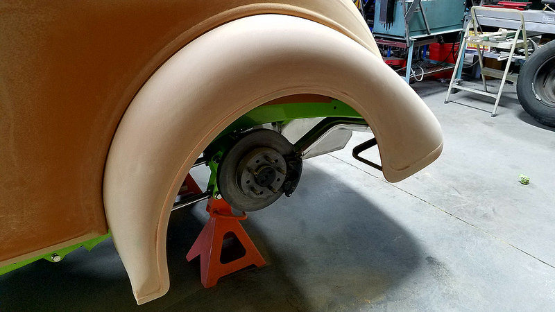

    13. #33
      5,569
      It looks great, nice and straight in the gray primer.

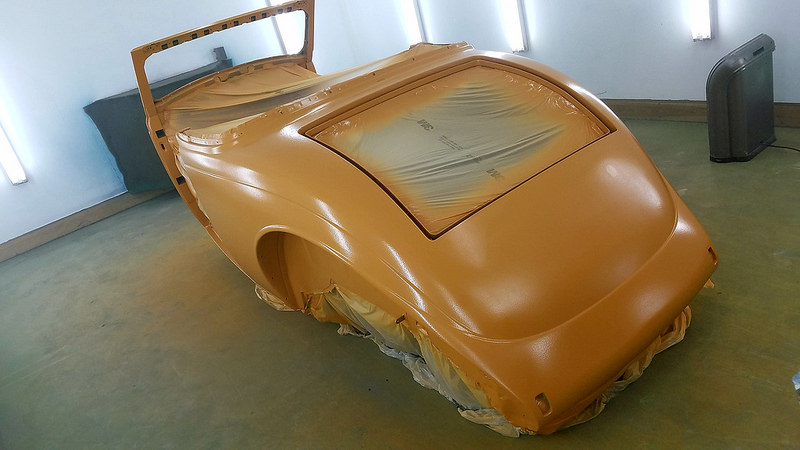

    14. #34
      Tennessee
      499

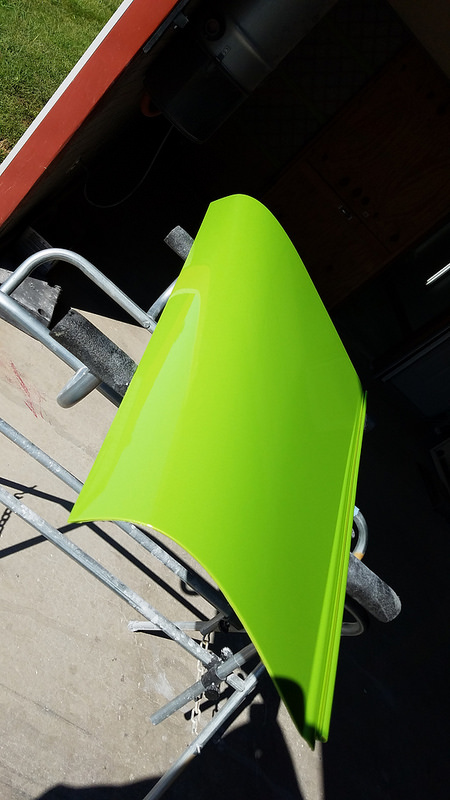

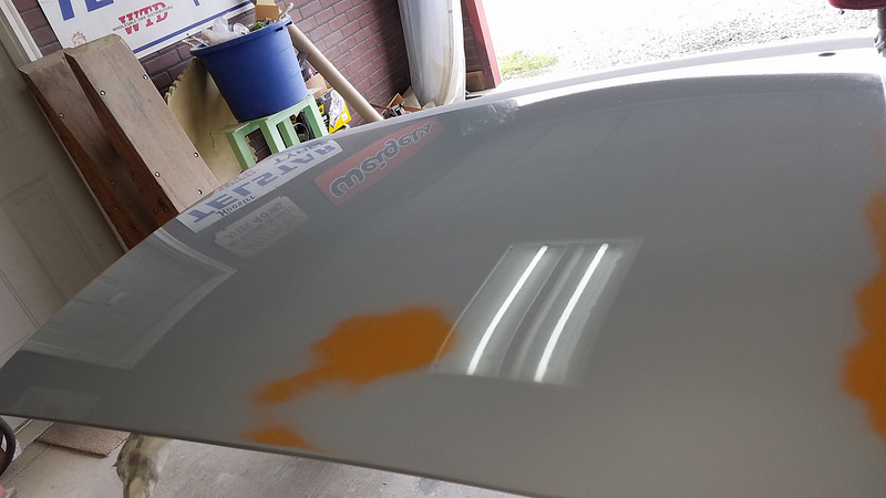

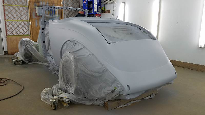

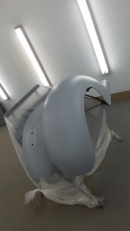

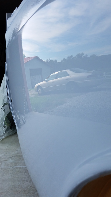

      Thanks, so far so good! Its all wet sanded and painted now. I like when we get to color sand & buff.
      This is just a mock up wheel but I think a 17 front and 18 rear in the Artillery style is what the customer is wanting. Still not a 100% on that yet.

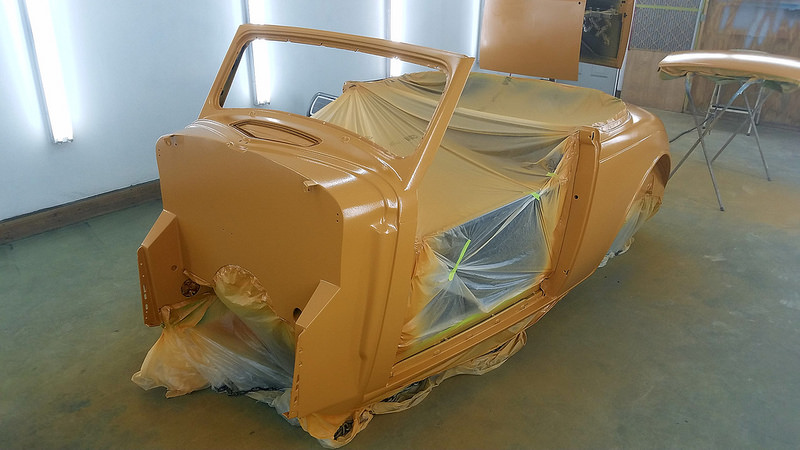

    15. #35
      Tennessee
      499

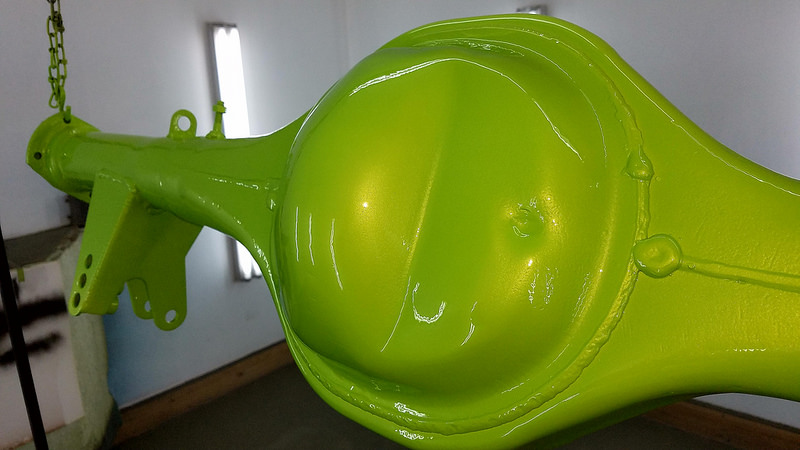

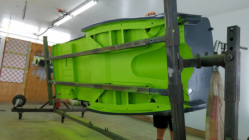

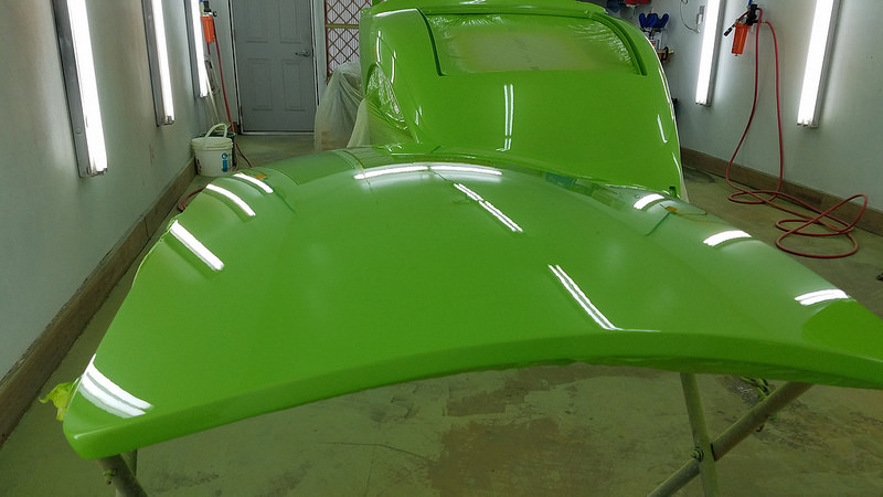

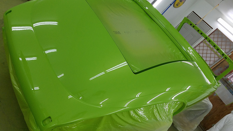

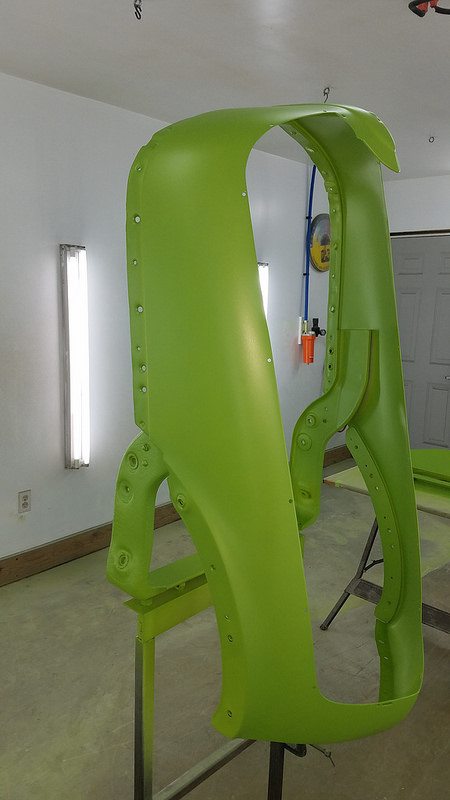

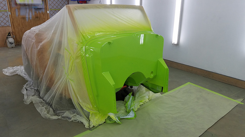

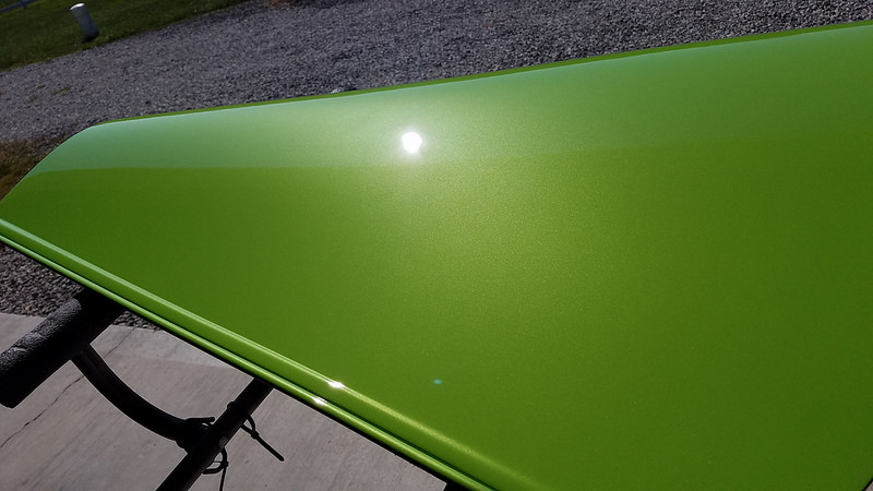

      Time for some Green!!

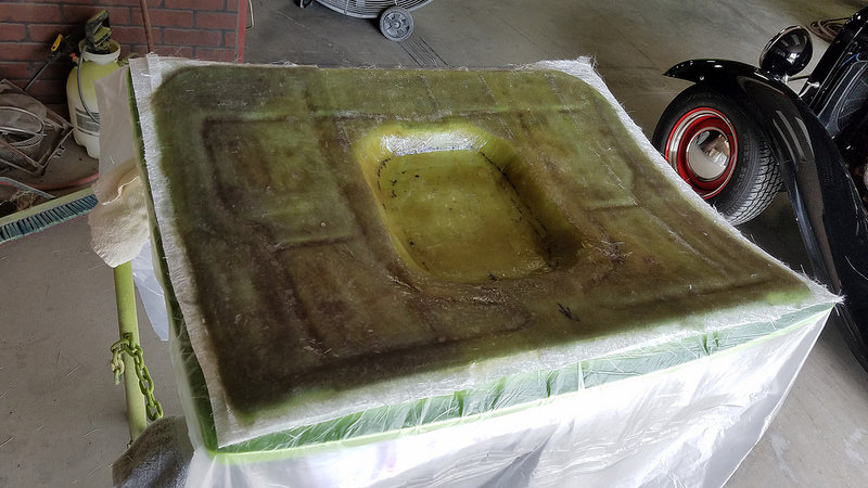

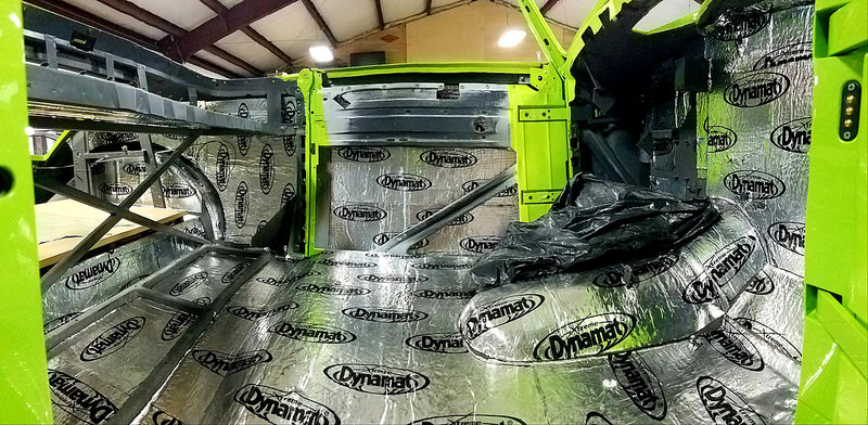

    16. #36
      Tennessee
      499

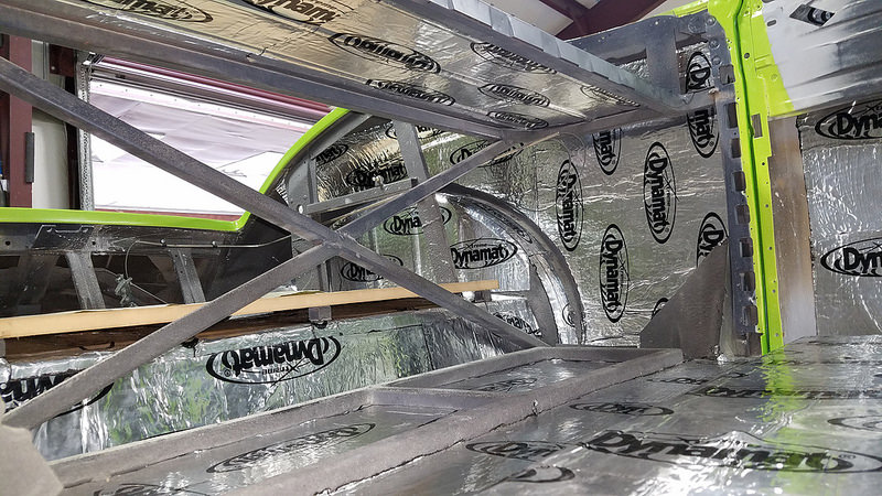

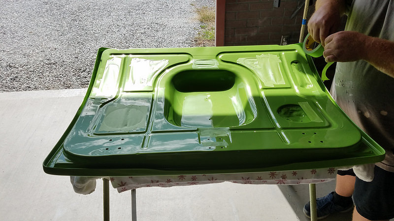

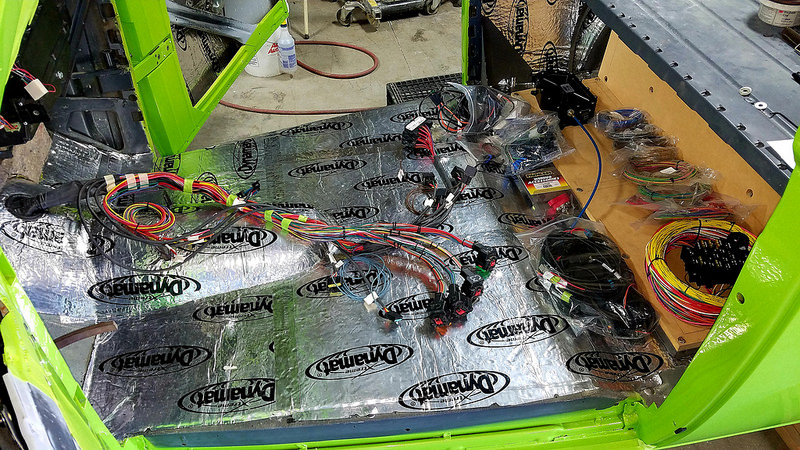

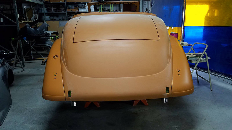

      Now that the trunk lid is good and dry we flipped it over to make a fiberglass mold for the upholstery.

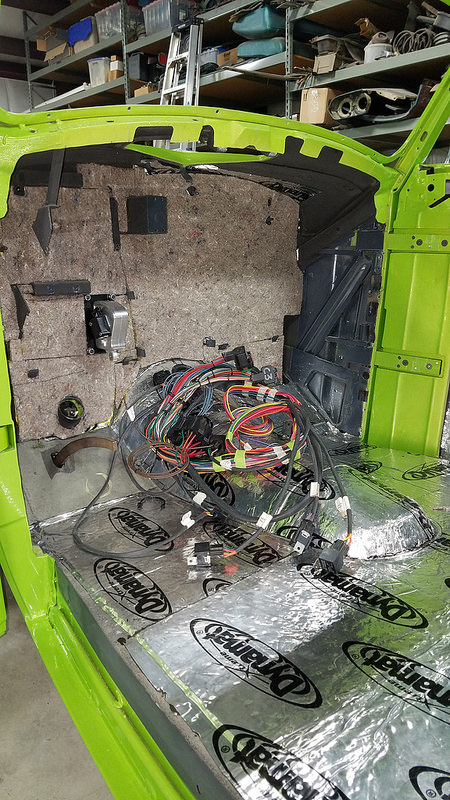

      New Dynamat down witch is on top of Lizard Skin. Probably over kill but O well.
      Jute mat carpet done on the fire wall so now the wiring can start, O what fun!

      Superb build...
      What is that green? I have a custom Kawasaki street bike that would look great on...
      Joe
    20. #40
      Tennessee
      499
      Quote Originally Posted by Motoracer838 View Post
      Superb build...
      Joe

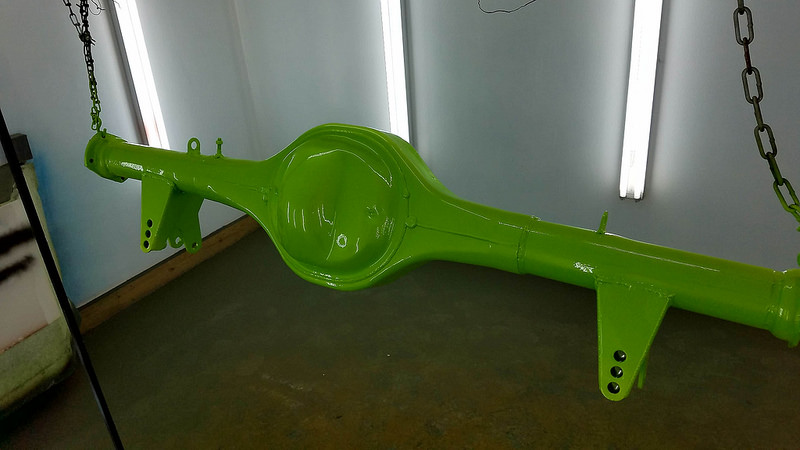

      Dodge Sublime Green Effect, 7 Coats on top of white base or white sealer.
