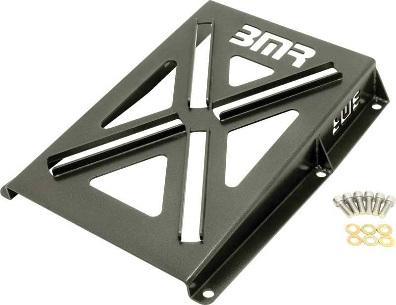

      yes with the sub frame connectors you can skip the shakers....you should also upgrade the factory chassis stiffener with one of the after market ones from Hotchkis or BMR the factory one was way to thin

      Thanks Rod I have the Hotchkis cross brace as well, but from I understand it's not the stiffness it's the vibration and harmonics that dampeners help with. Looking to hear for some real world experience from some vert owners that have removed them.

      it is the stiffness, the uni-body had to much flex and that created the vibrations, that was the reason for the extra brace under the car and the shakers.... I worked in the restoration industry for 8 years, then I worked at a Vintage speed shop for a few more, before moving completely into the performance industry the last few, and now I maintain camaro car collection as well as work on a race team
