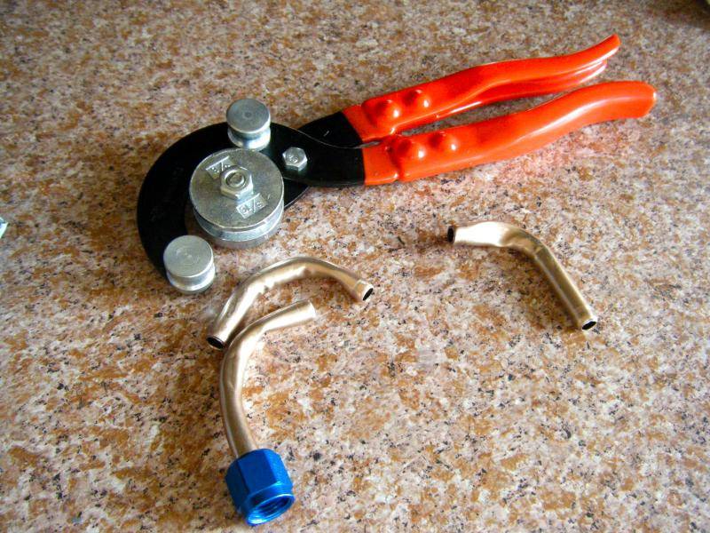

      x2, used it for my fuel line so far and will do the brakes too, will never used anything else. Only problem I had was trying to make a hard 90 +degree bend, kinked a few times and ended up having to space out a few lesser bends to get what I wanted

      First attempts at bending 3/8's to a 90 degree
      Spaced the bends out slightly
      BTW, 3/8's is good to 7000psi, smaller sizes are even higher. Will probably use 1/4 for my brake lines
