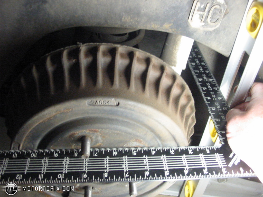

      The wheels you have a over 1" too deep for our cars, the rears will not mount, as there is very little over 5" from the wheel hub to the rear frame/fenderwell.
      Our cars fit these without too much work:
      Front: 18x8 4.5" backspace (0mm offset) or 4.25" bs, tire 245/40/18
      Rear: 18x9.5 5.0" backspace (-2mm offset), or slightly less offset (4.75") tire: 275/35/18
      To fit your wheels, you will need a 1" wheel adapter on the rear 9.5" wheel w +22 mm offset, and a 1.5" wheel adapter (38mm) for an 8.5" wheel w +30mm offset.
      Note: on the front with an 8" wide wheel, a 4.0" bs (-10mm) puts the tire outer edge into the inner fenderwell boltheads.
      You could also fit an 18x9.5 on the front, with carefull measurements, and not running the car too low.
      I am running:
      17x8 4.5" bs w 255/45/17 Nitto 555's
      17x9.5, 5.0" bs, w 285/40/17 Nitto, and 1/4" spacer on both rear sides.
      My SS is slightly lower than 2"/1" drop.
      Note: you may have to replace your rear UCA for adjustable arms to center the rear axle, you may be fighting for 1/4" on either side, a 275 is a tight fit in most tire brands. Depending on the wheel hub you may need to replace you rear wheel studs, specially if you need to add a small spacer.
