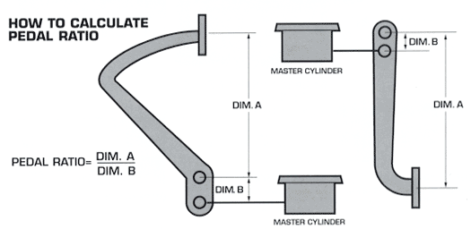

      What is the pedal ratio?
      Enfield, CT
      423
      Hmm, you got me...
      Somewhere I saw a method to measure that - I'll have to search for it.
