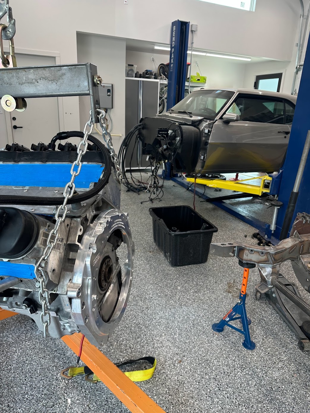

      Yeah it was a lot of work to chop it out without messing something up and then put everything back together. I'm glad I did it, though.

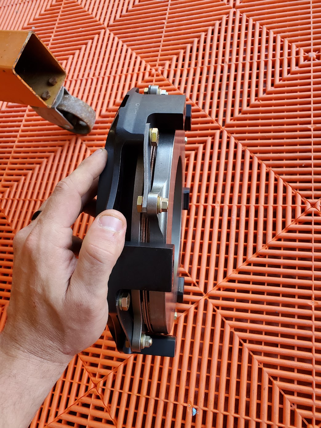

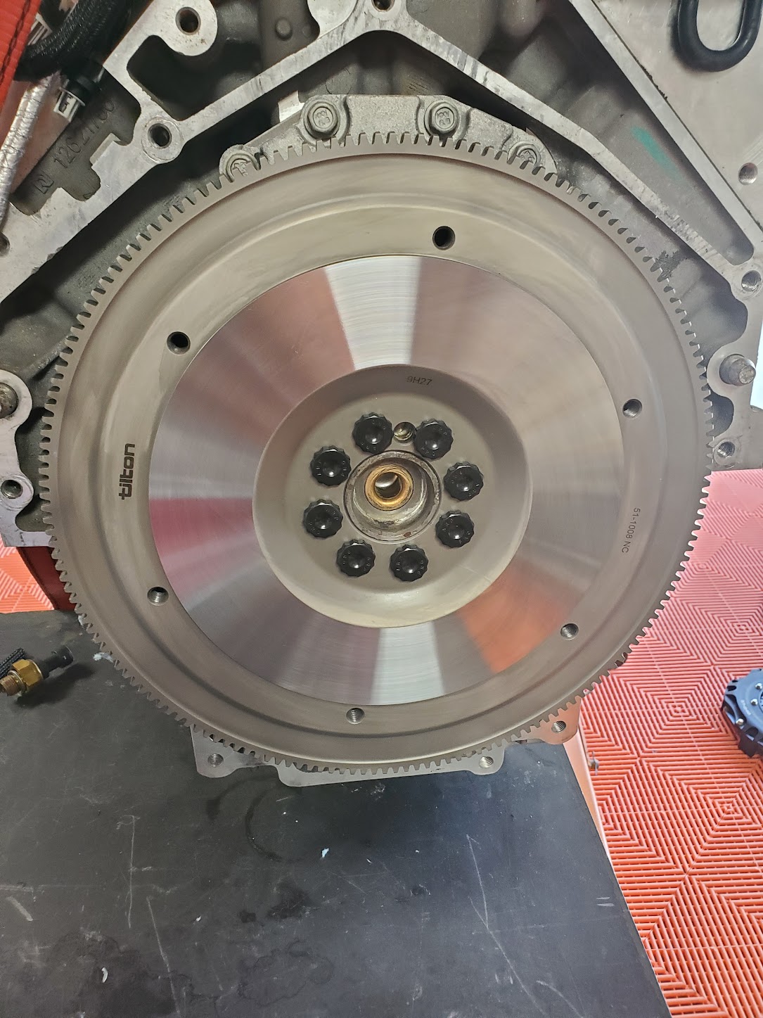

      While the engine and trans were out, I decided to make a few upgrades (again before the car is even done). I got a Tilton ST248 clutch which is very solid quality and came with all ARP hardware. Their support is top-notch as well.Name:  20200613_081633.jpg

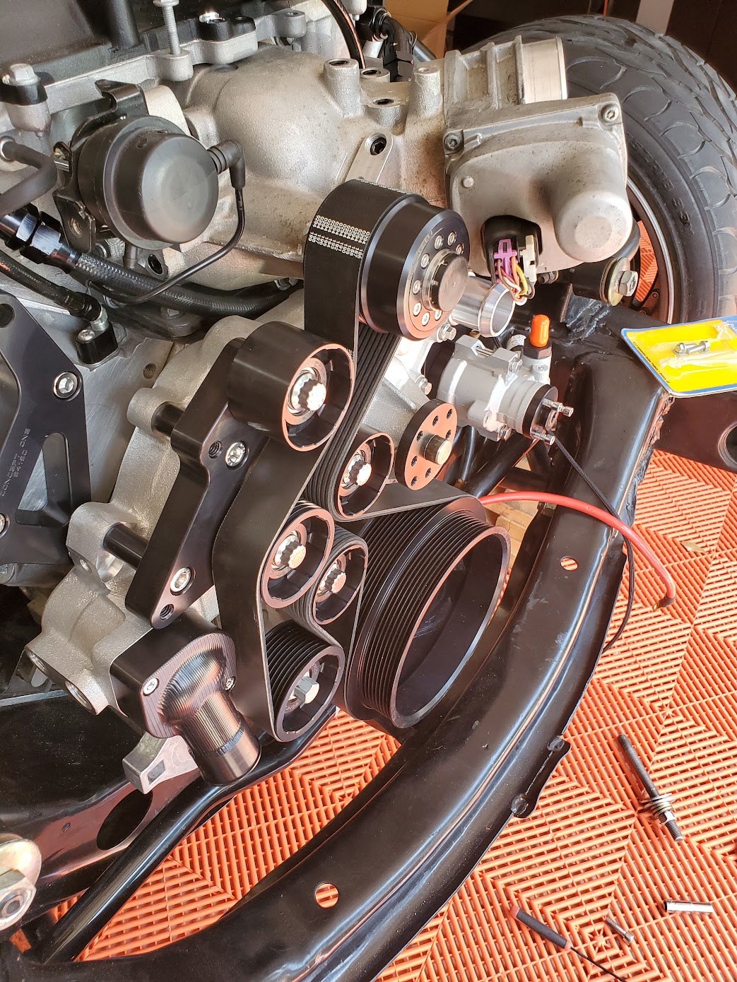

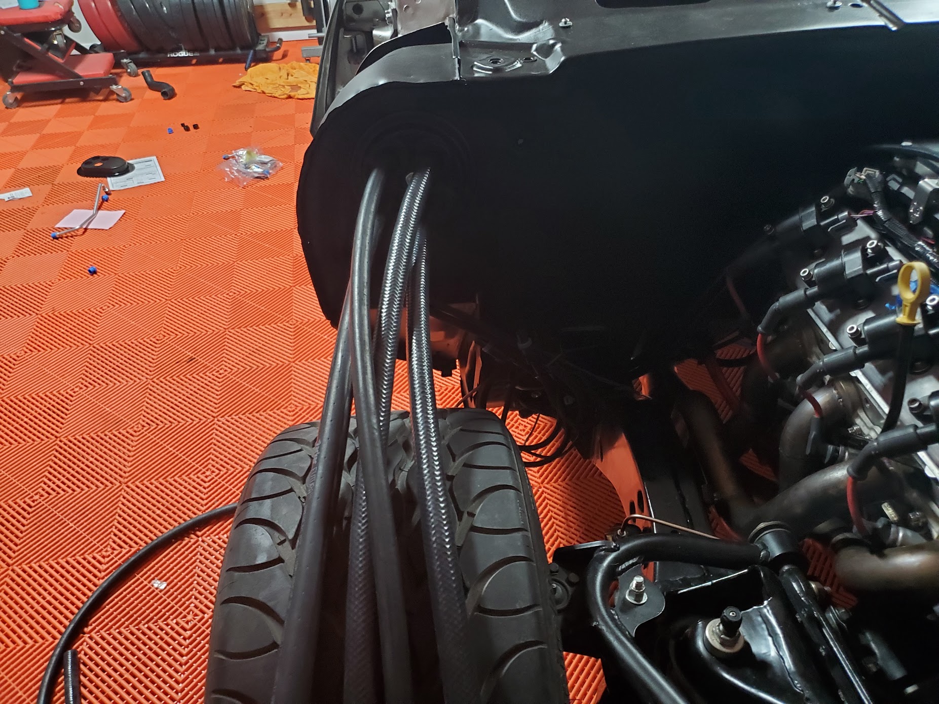

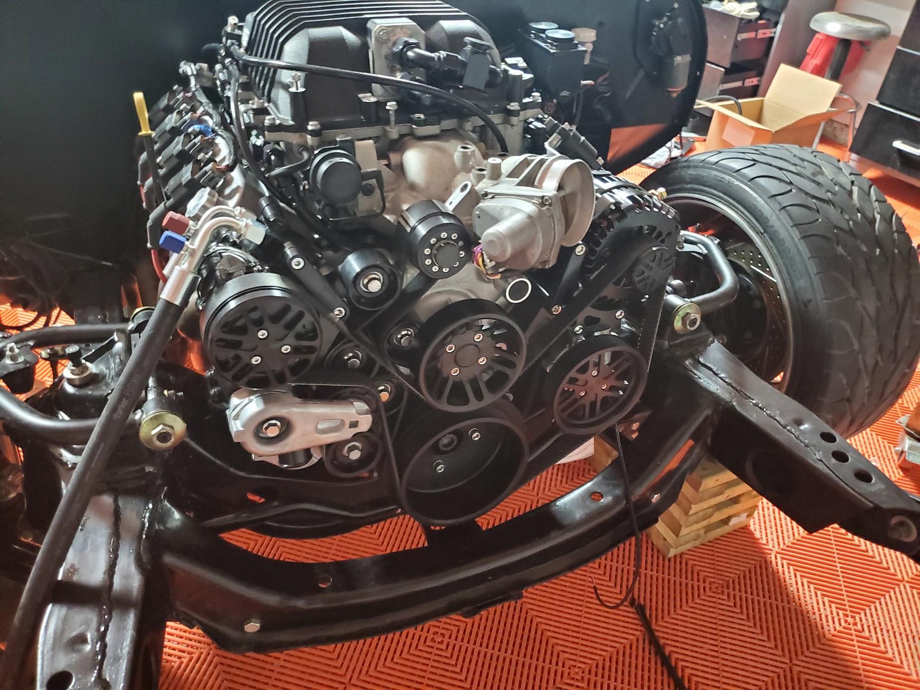

      I also decided to upgrade from the Concept One single belt setup to their 10R setup, which uses a 10-rib belt for the blower and a separate 8-rib setup for everything else. Again its a very nice complete setup that tucks everything in as tight as possible, and I'm pretty sure belt slip is impossible. Again the support from Kevin from Concept One is nothing short of some of the best in the industry.

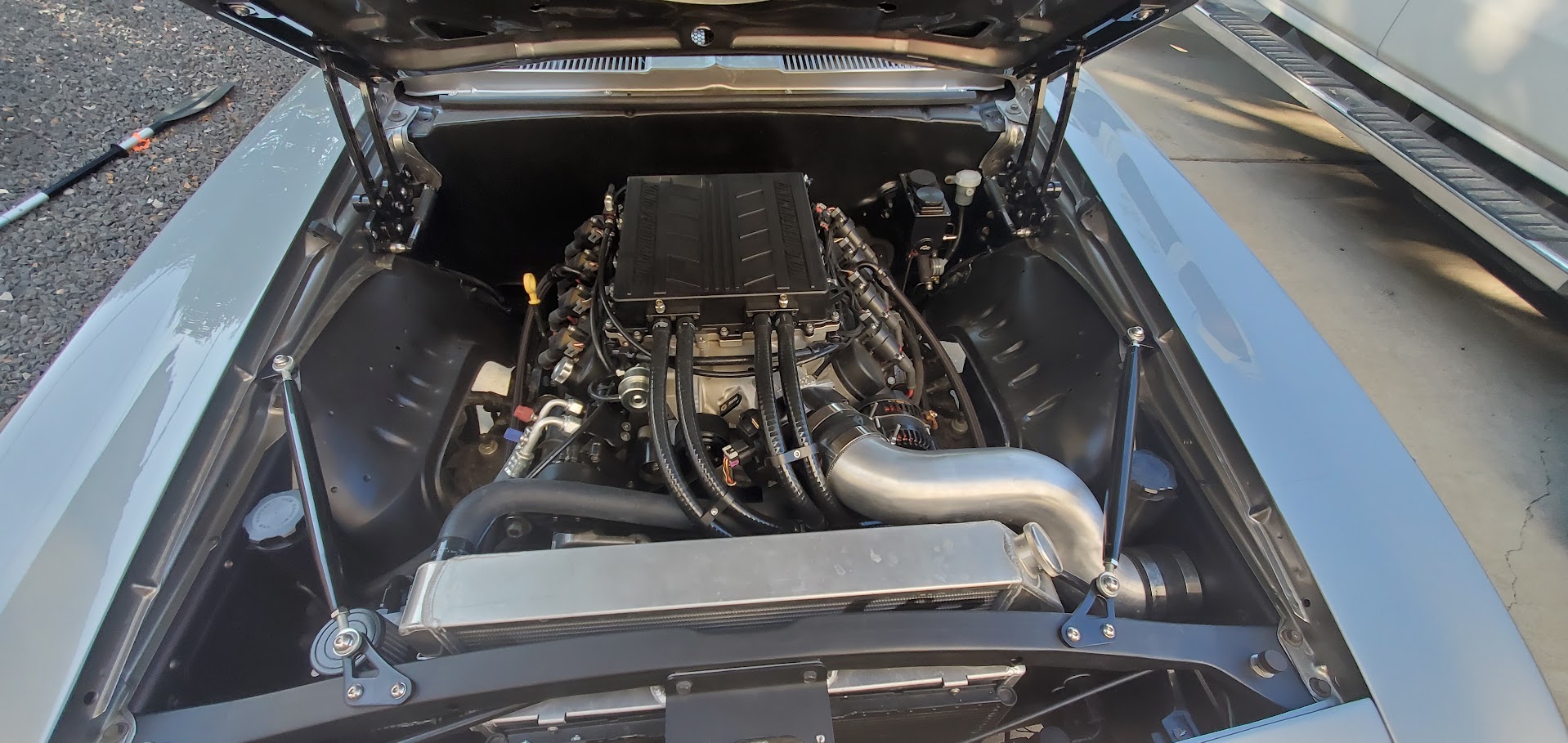

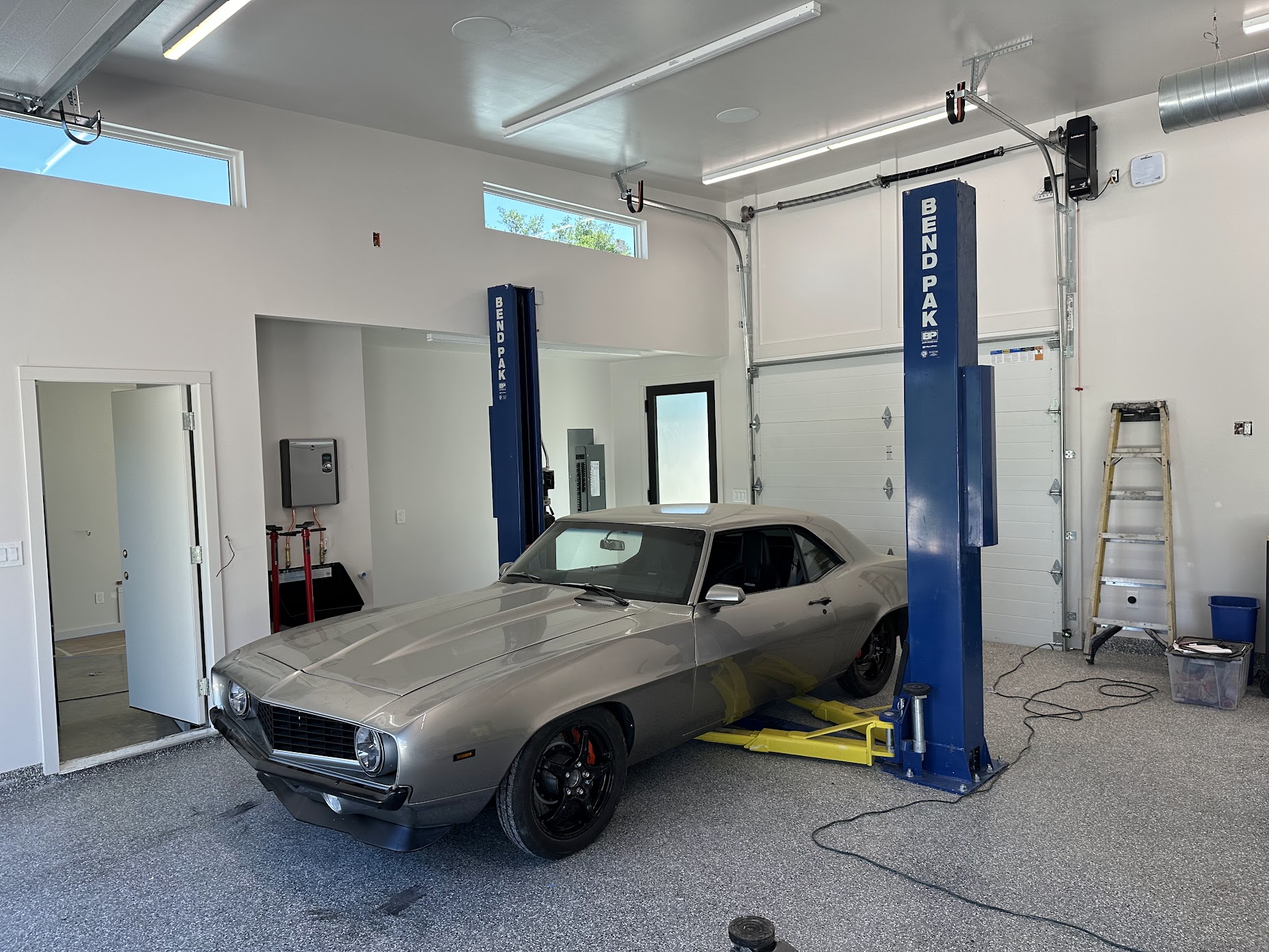

      Well here is what the car looked like not too long ago.

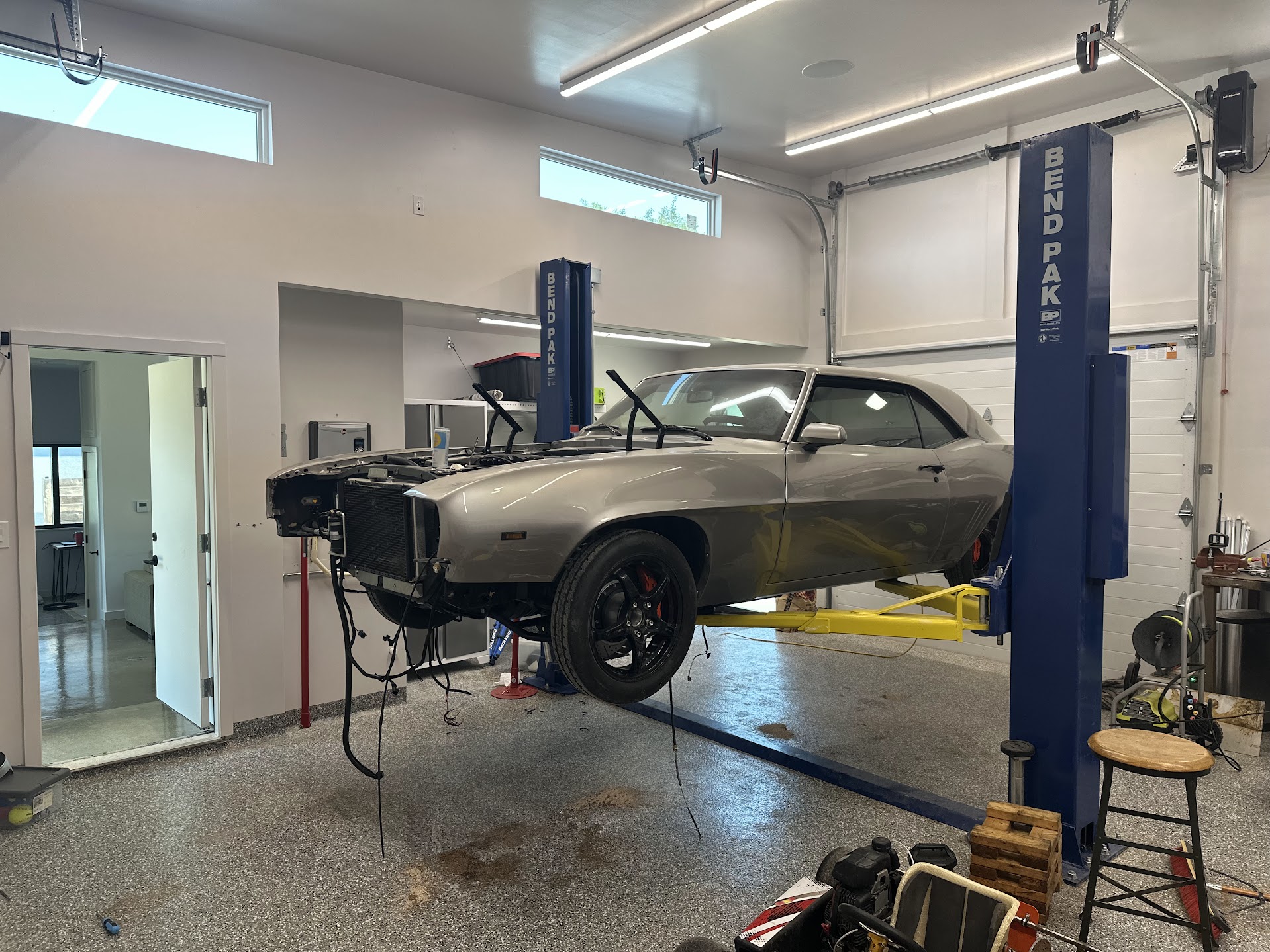

      I decided to go ahead and tackle some of the work myself. It will likely go to JCG for some finish out. Here is what it looks like after this weekend.

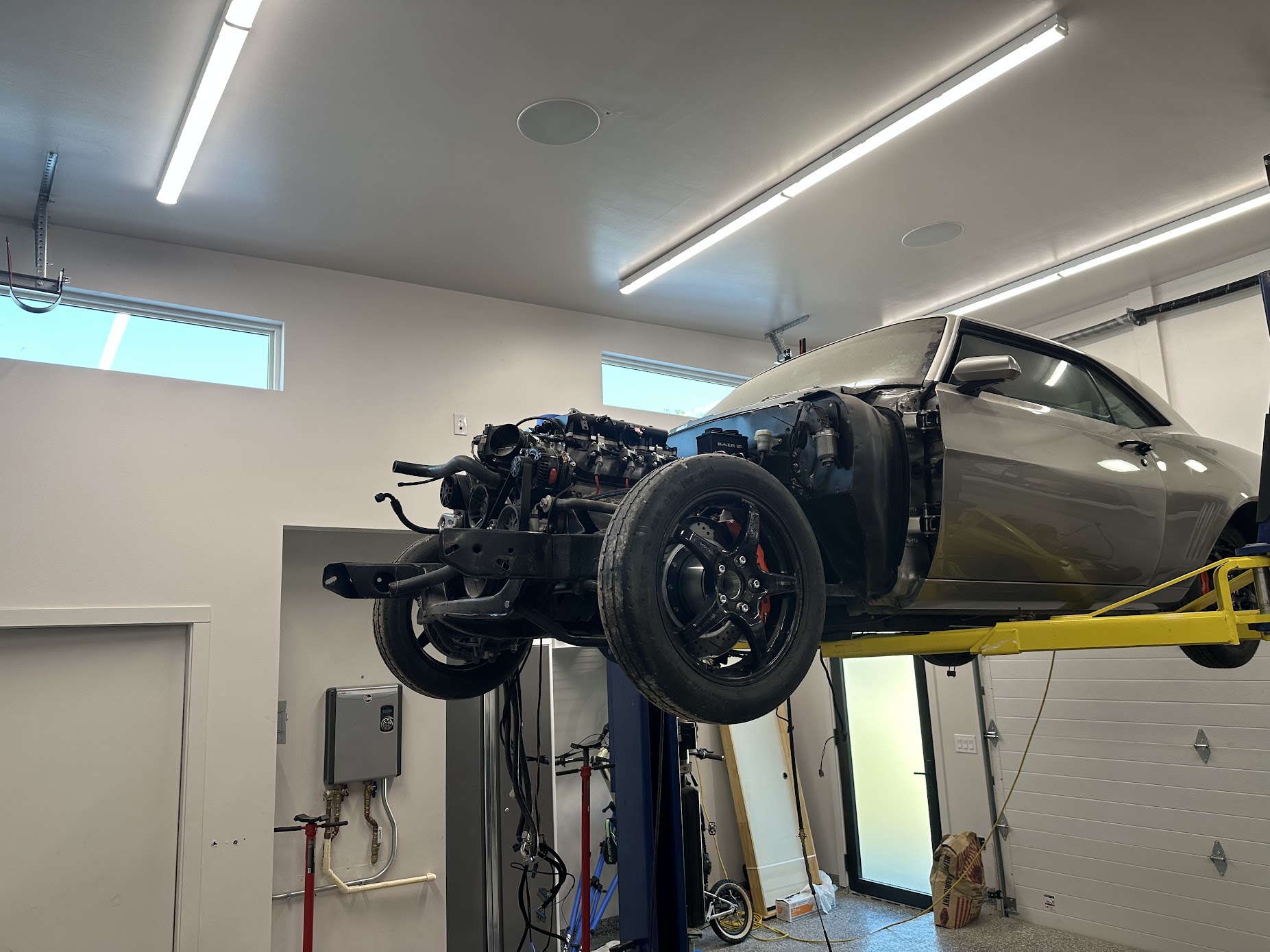

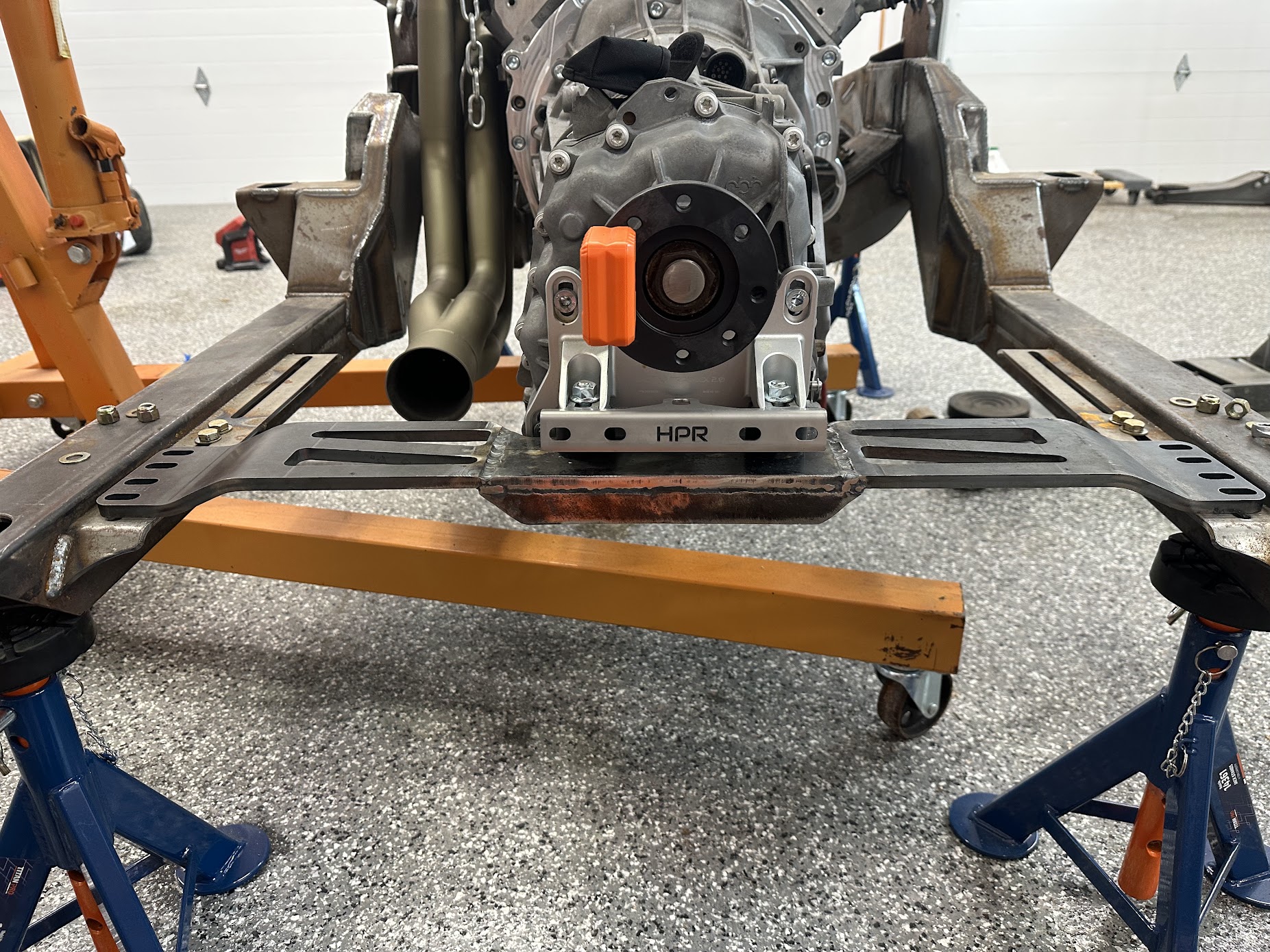

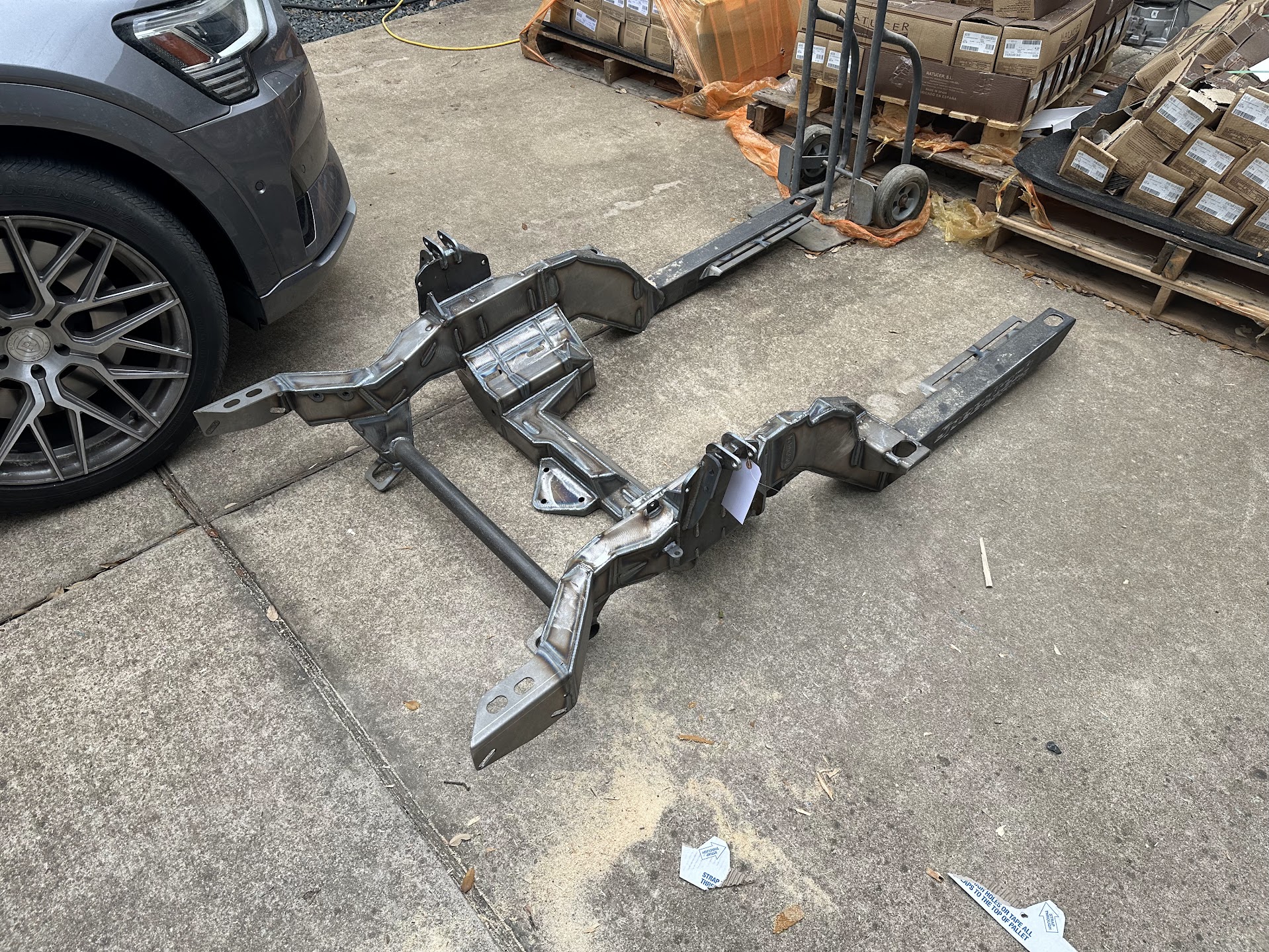

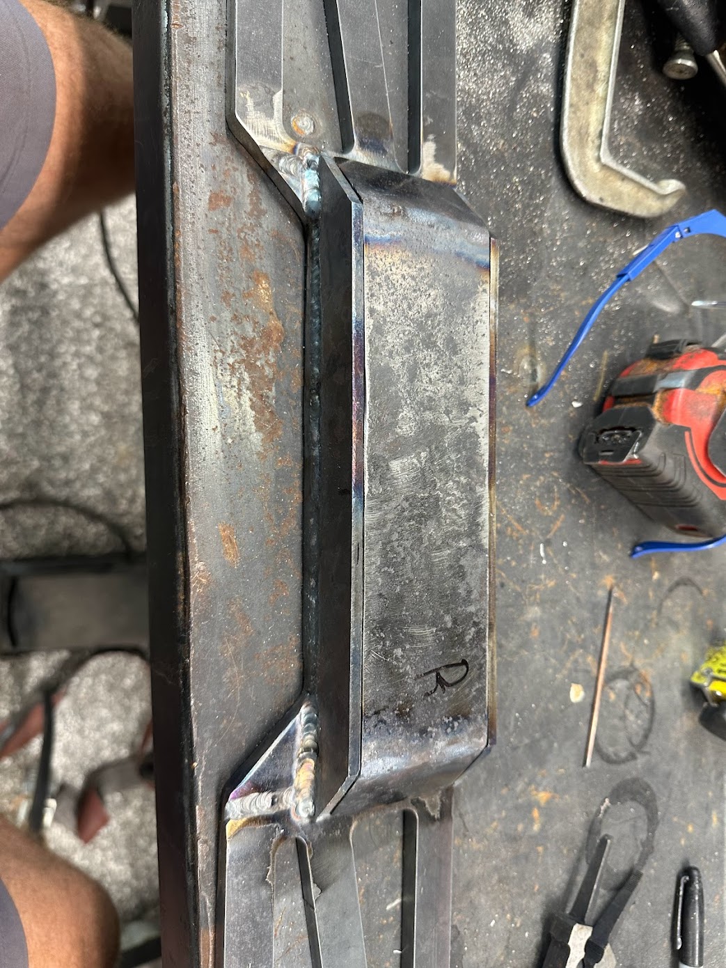

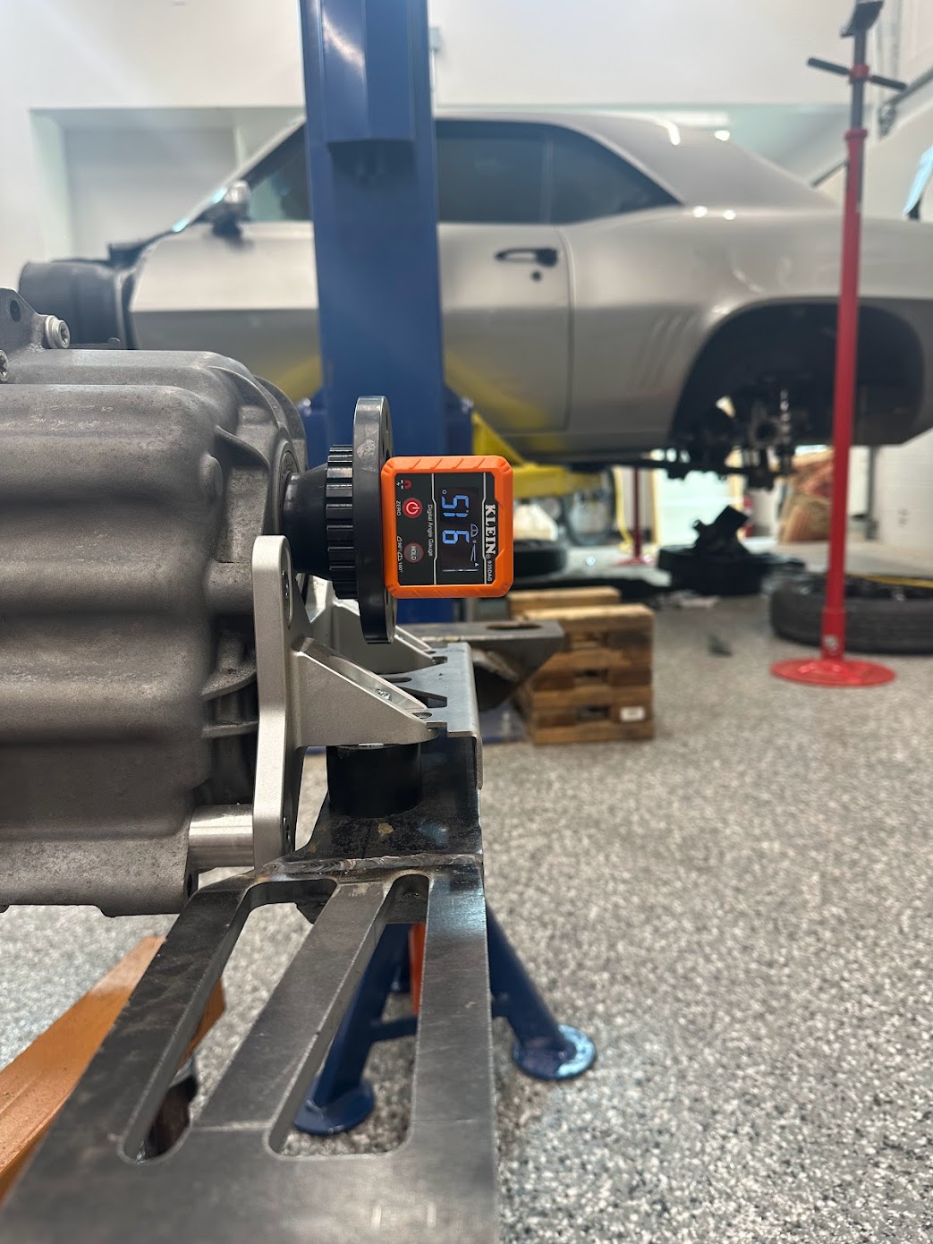

      I was able to make some progress this weekend. I got the DCT mounted to the engine and it mocked up in the subframe. I decided to use a mount from HPR vs building my own but it was significantly wider than the gm style mount. Luckily the height of the mount was not that far off so I chopped the mount out of the Speedtech cross member and replaced it with a piece of 3/8 plate. Leaving the mount perfectly flat would have been great as it might have provided me with enough room to run an x-pipe but it did have some deflection. To stiffen things up as well as spread the load across multiple welds I braced the center of the mount with some 3/16th. This removed most if not all of the deflection and Im fairly confident it will work. The next big step is to see if the transmission will fit in the speedtech tunnel or if I will be forced to modify it as well.

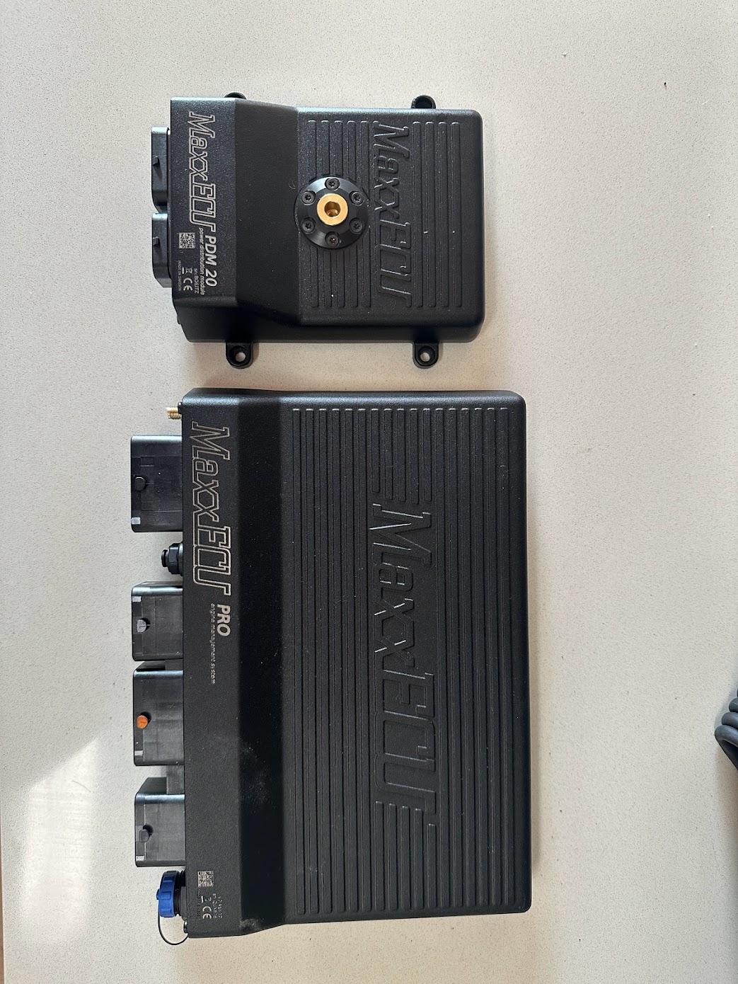

      Its a Getrag dual clutch transmission from a BMW. It will be controlled by a MaxxECU pro and I'm planning to run traction control as well.
