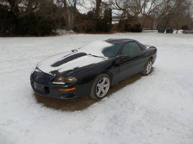

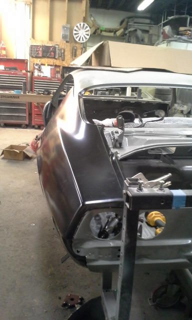

      I picked up a smoked 98 Z with an LS1 and 6 speed. I tore down my 70 and realized it's shot. It needed pretty much everything behind the doors. SO it now sits on a rotisserie getting major surgery including deep tubs.

      The victim

      Deep tub install

      I am slooowly assembling the deep tubs and fitting the rear panels. I got my panels from AMD, as I heard they were the best(?)
      I will say that I expected some difficulty getting the pieces to fit, but this has been worse than I'd thought. The fit is crap. It's gonna take a lot of monkeying around to get this to look right.
