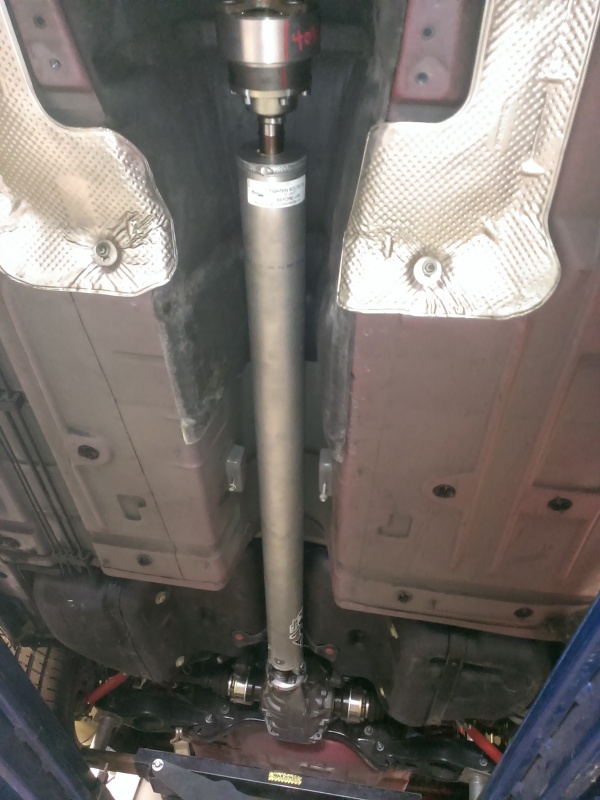

      All though not what we're discussing, it's a great example of his work. This is for a build I'm expecting somewhere between 1400-1600 at the wheels. I have no doubts we'll bust something else before taking out this driveshaft..lol.

      WOW...Lol looks that way!!!
