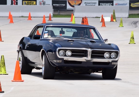

      Got the Spectre spoiler installed on my Firebird. Took some finagling but I got it to fit OK. Probably not quite as flush as Chad's but It'll get the job done.
      Still for sale on Amazon. Price was $385 in Jan. Now $411, and going up I'm sure. I like the design of this one, how it goes out wider than others for first gens. Took some messing with but not too bad.
      I went with black as you can see in the second two pics.
