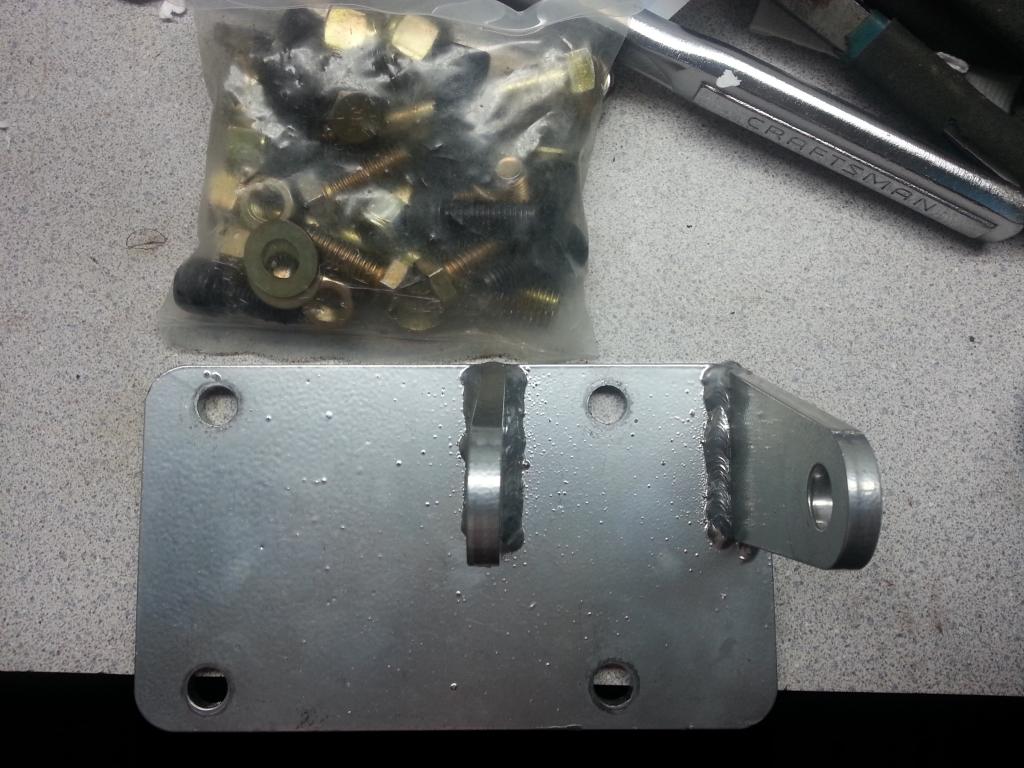

      I received my BRP LS swap mounts and am a little disappointed in the quality considering they are one of the most expensive mounts at $280.
      They arrived chipped from poor packaging. They were in a small box individually wrapped in thin paper with a few pieces of popcorn inside. Also from the marks in the powder coat it is obvious they were already mounted and repackaged.

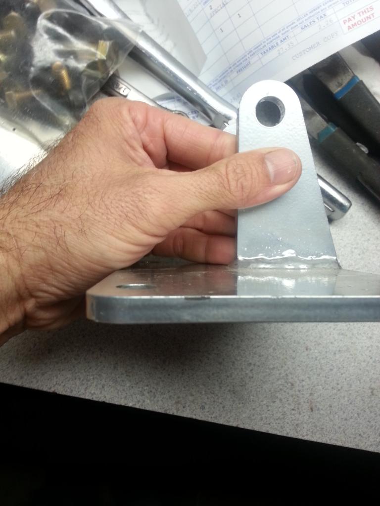

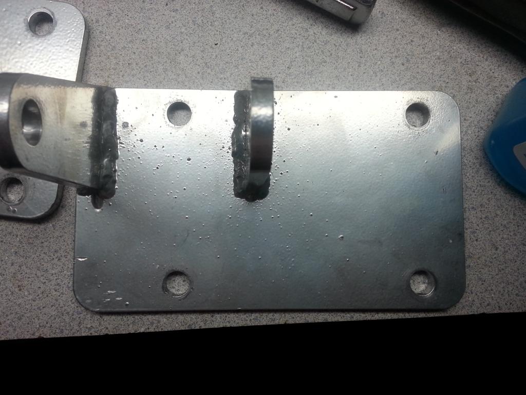

      In the pictures you can see that the welds are MIG not TIG and they did not even clean off the spatter. The powder coat is also very thin and chipped off in places from lack of packaging.
      The metal looks heavy enough and the bushings are polyurethane. I did notice that the tubing used does have an internal seam that is sharp and all the info from energy suspension says that the inner surface of any tube for their bushings must be smooth so I am sure this will be a wear point. Needless to say for the price my opinion is that the quality does not justify it.
      I have not installed them yet but I did buy their Mid-length headers too that have not arrived so I will report back on the fit once I get a chance.
      I will say that their customer service has been great and that they were willing to work with me due to the fact that there was shipping damage. If everything lines up and installs easily I will be satisfied but I think they should be priced along with the other companies at about $150 considering what they are but I knew this LS swap was going to be expensive so what ya going to do...
      So to sum up my mini review.... Customer service = Great, Product quality = Average, Price = a little high.

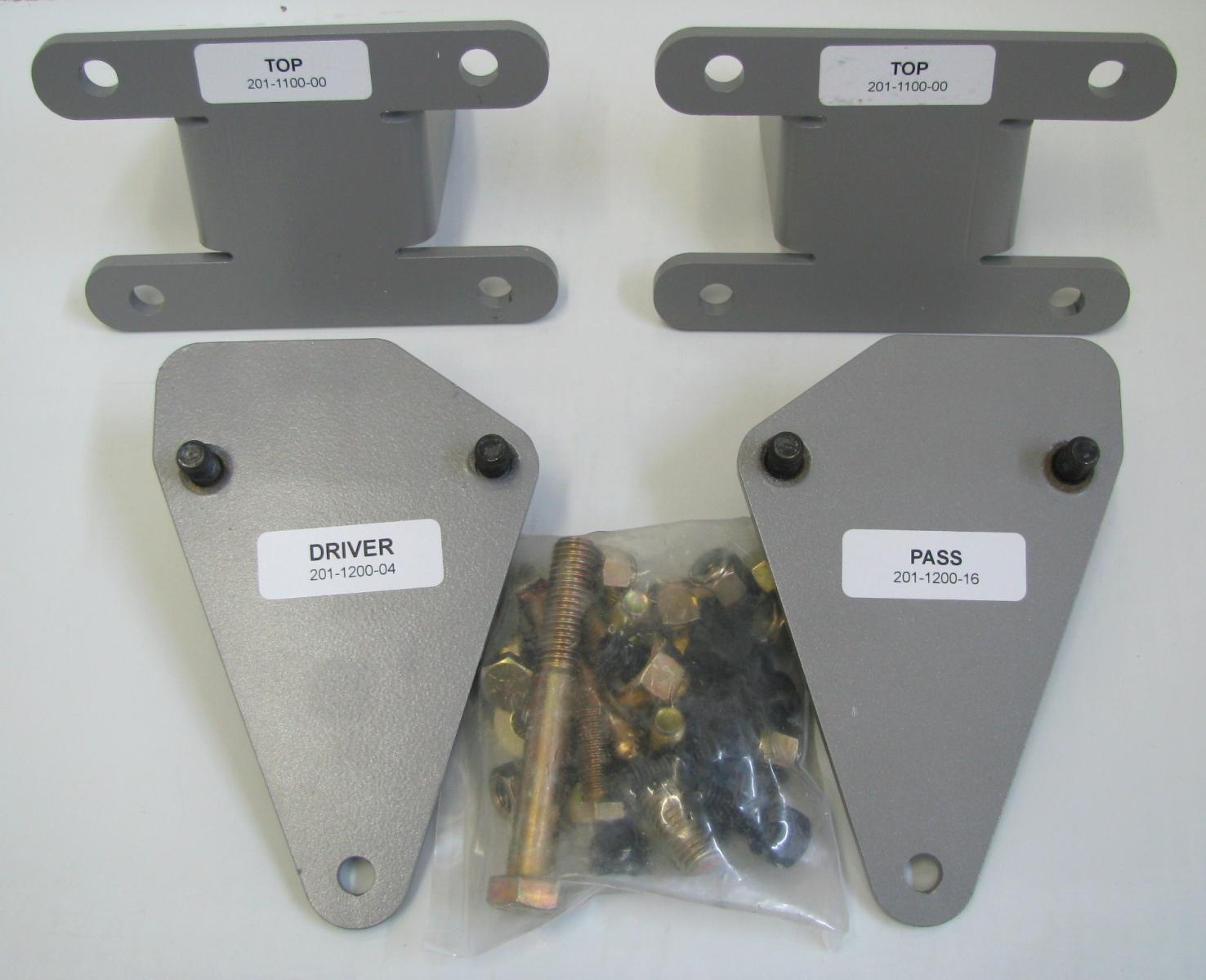

      I received my LS swap stuff from them a couple weeks ago.
      Yes their packaging is lacking in making sure nothing gets damaged.
      My set up is for my 66 Chevelle.
      I went with these since my car presently has a 6 cylinder and by using these there are only 2 pieces to work with rather than the traditional 3.

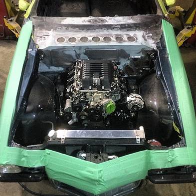

      Apr 2013
      99
      I ended up ditching my BRP mounts as well. Mocked them up with my LSA and 6L90 and the engine was sitting too high and on an angle. Ended up using the factory 2013 CTSv fluid mounts and fabbed them up to fit.
      I used the BRP headers and cross member and they fit perfectly
