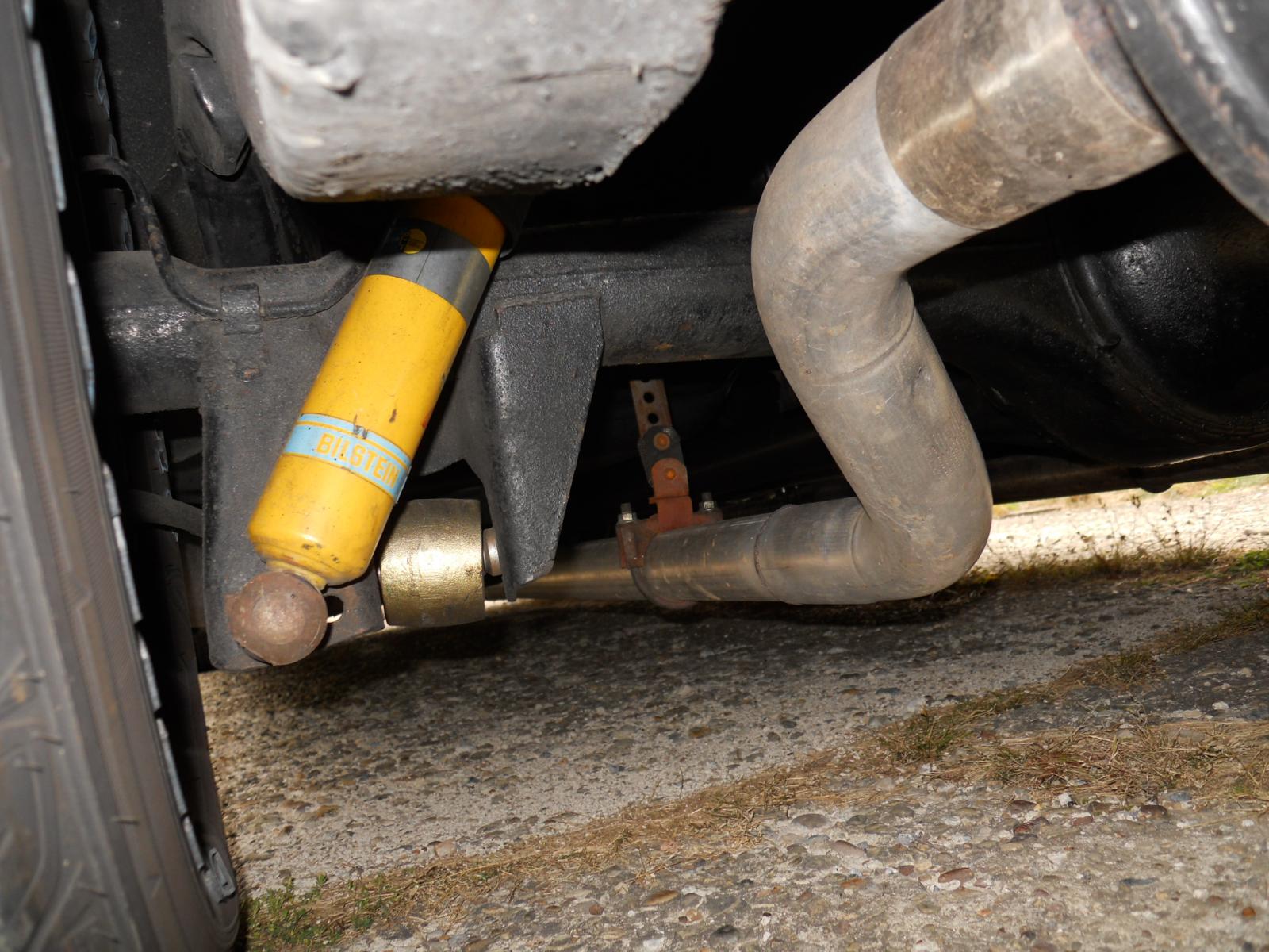

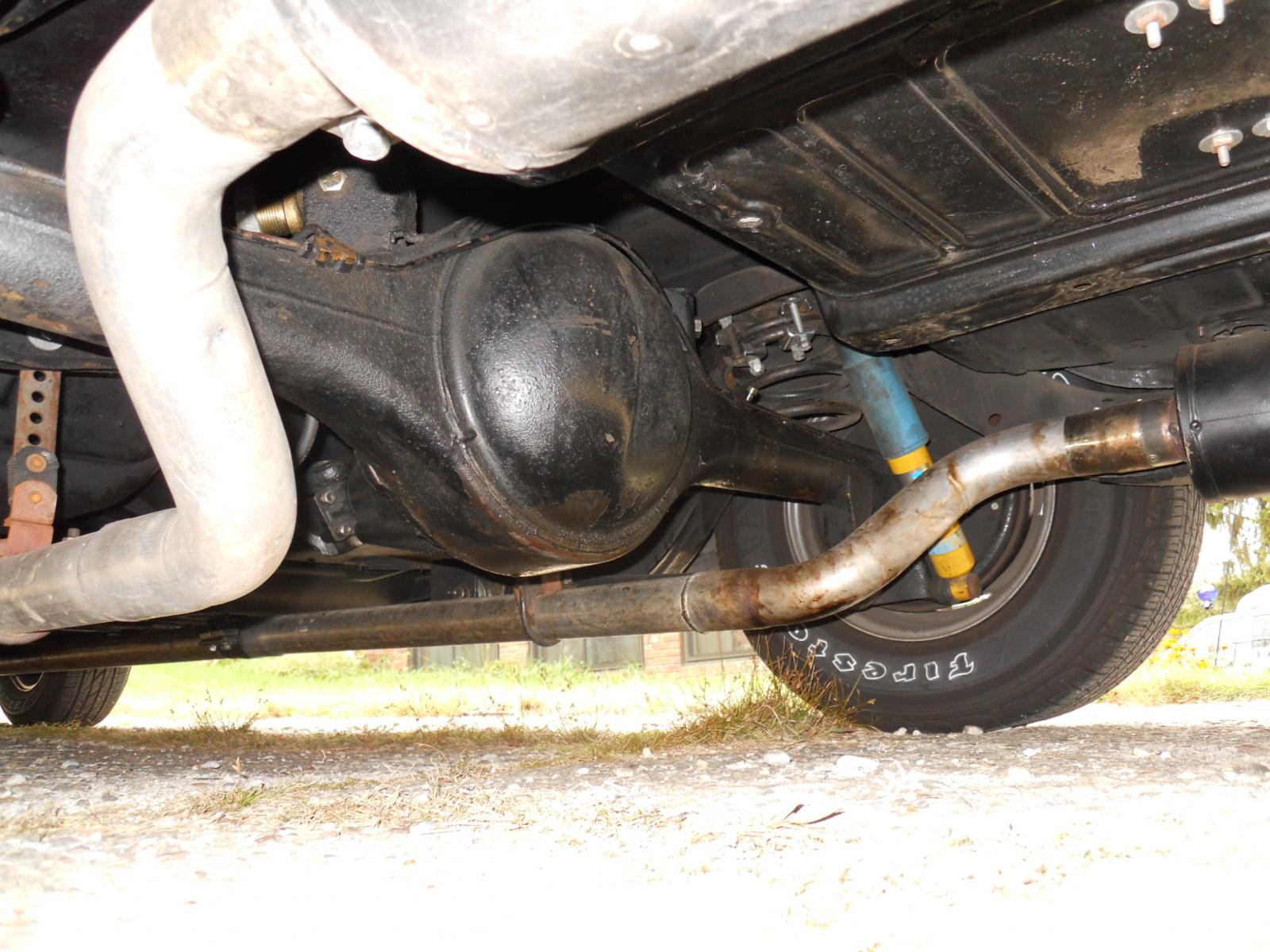

      I have over 40,000 miles on a full set of Currie Johnny joints on my 64 Bonneville's four link.....
      Name:  rear end 2.jpg
