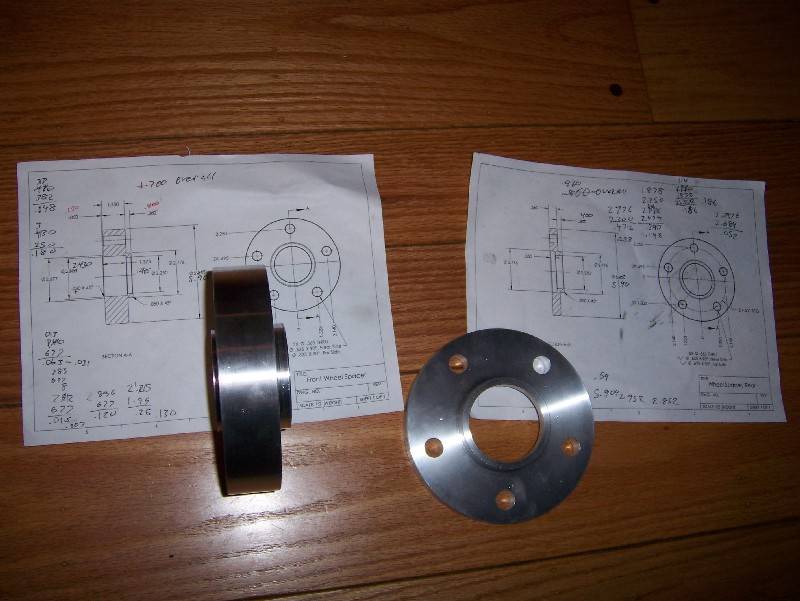

      That pricing looks very reasonable. 6" diameter 6061-T6 is about $12 an inch. On a manual lathe and mill, they take a little over 2 hours each for hub centric. The CNC could probably run them in 15 minutes each. This was a set I made to run late model mustang wheels on a 68 mustang hub with a rotor centering ring for a 350Z rear rotor. Lots of fun.
