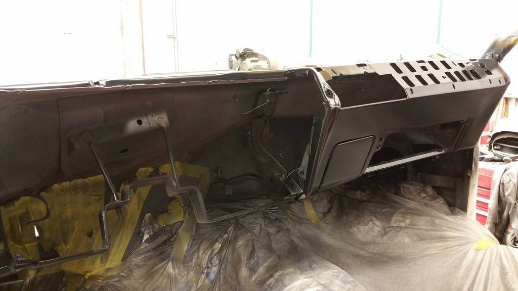

      Couple more pics....the dash ...
      And the firewall semi smoothed, I almost welded it up solid and smoothed the whole thing but decided against it and went with just the smoothed heater box area

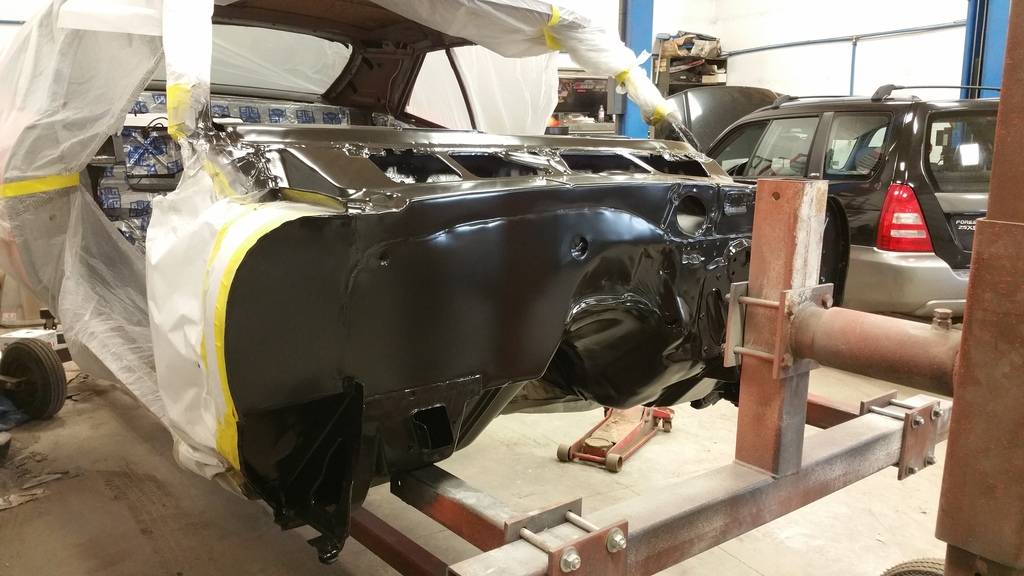

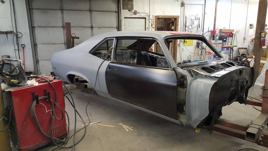

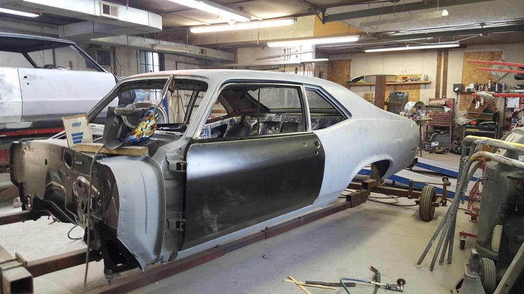

      So guess it's time to update this thread.....anyway. I decided I didn't like the seam on the firewall so that is gone

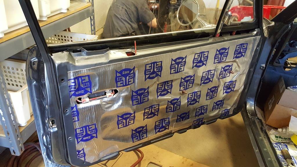

      Next new set of door skins on and all fitted...

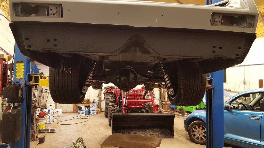

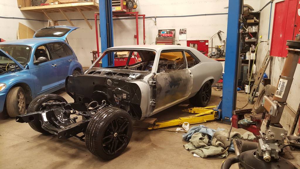

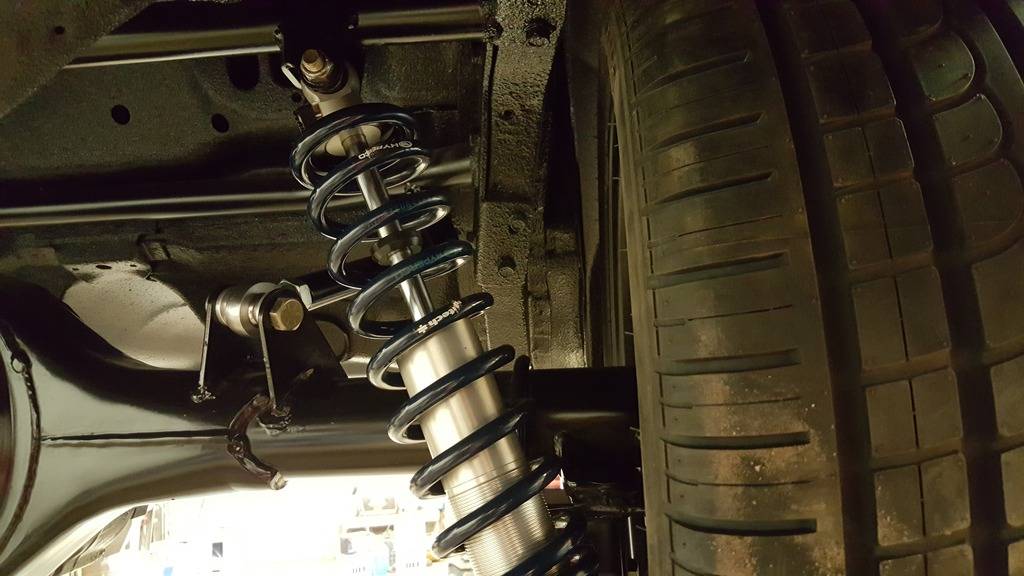

      Then it was time to take her off the rotisserie and put the rear suspension and front sub back in so I could fit the nose...

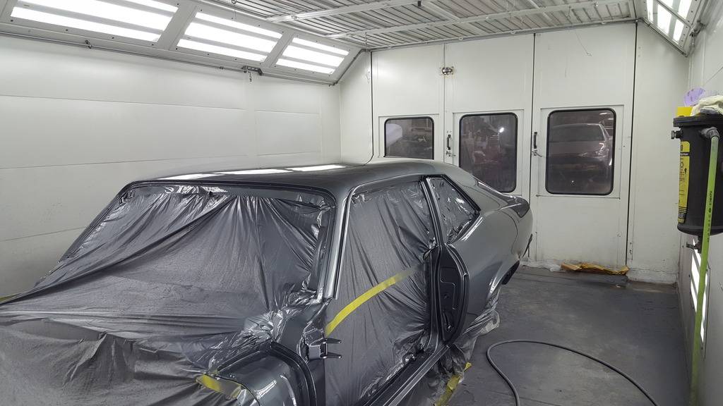

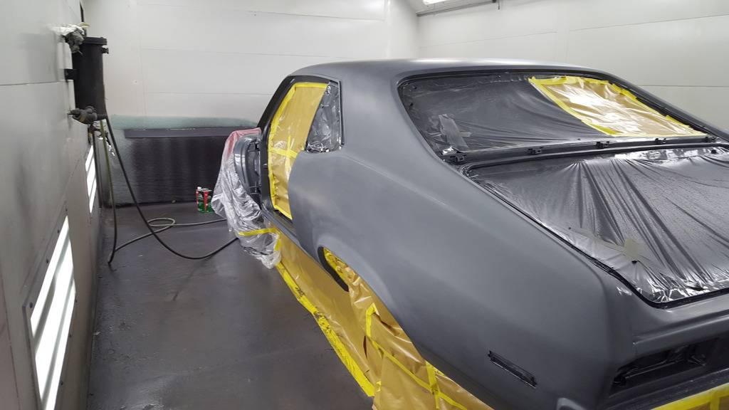

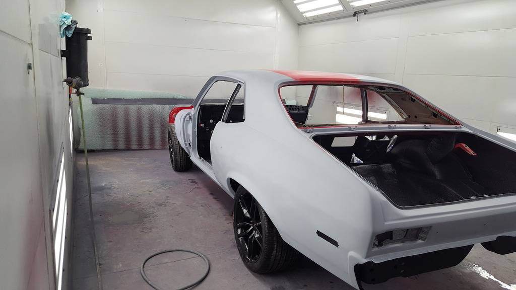

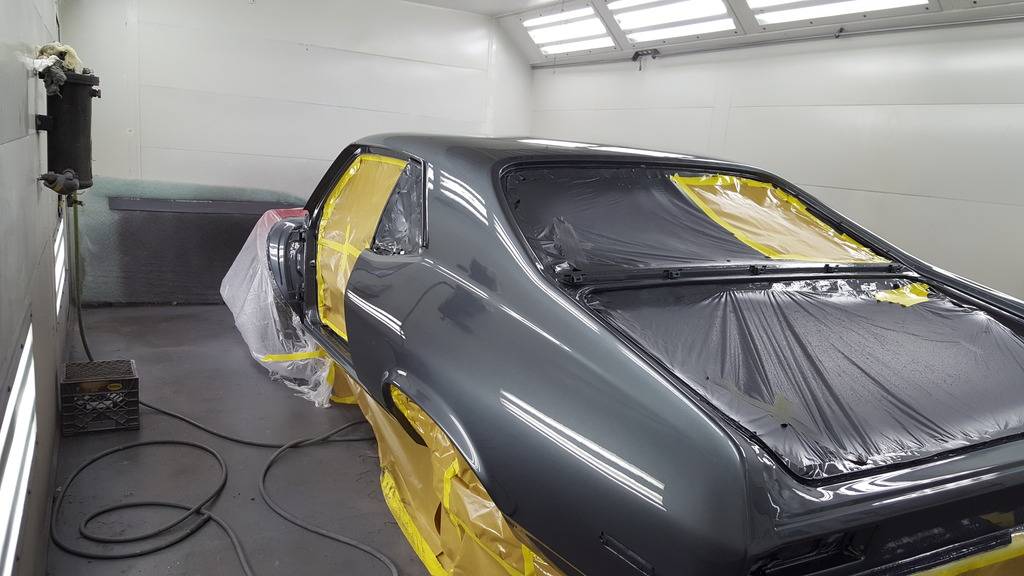

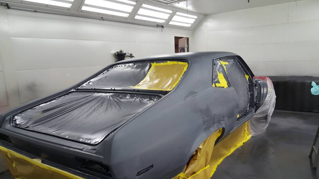

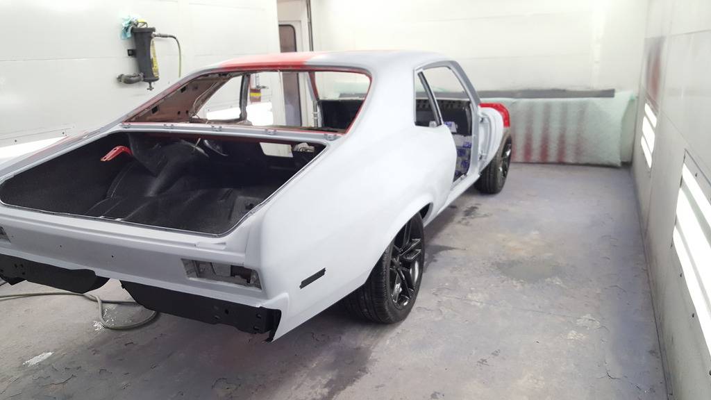

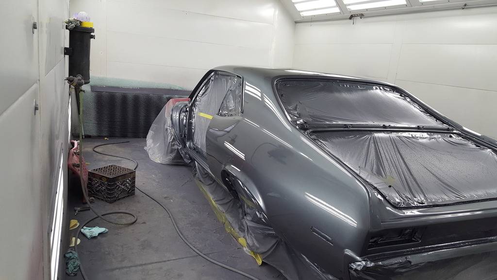

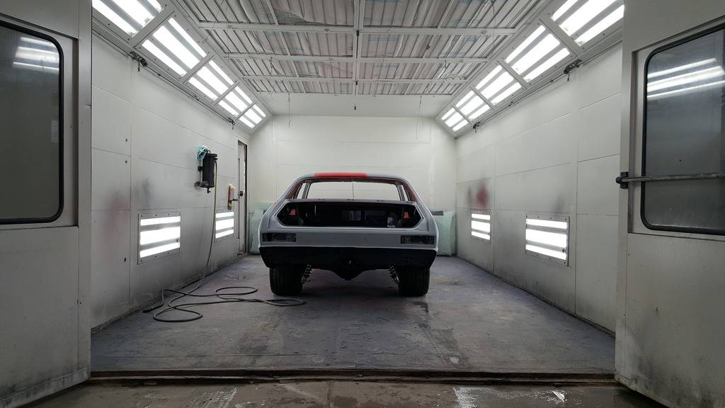

      Shell ready for paint
      Then....some color!
      Then I waited a week and resanded the clear and recleared/ flowcoated

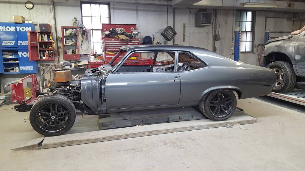

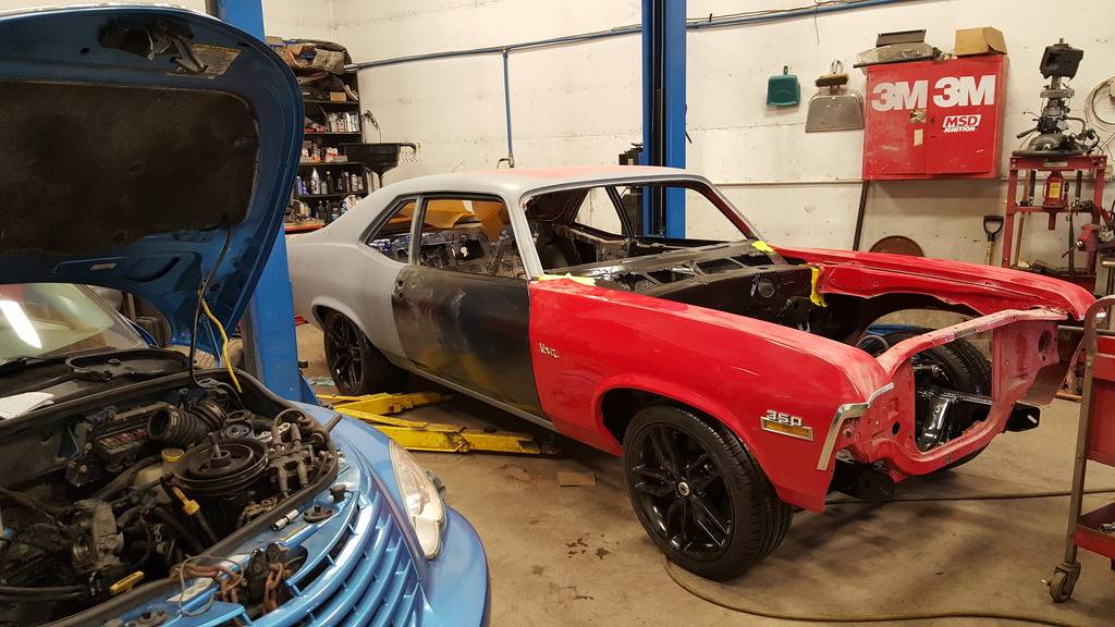

      Next was doors and trunk lid...

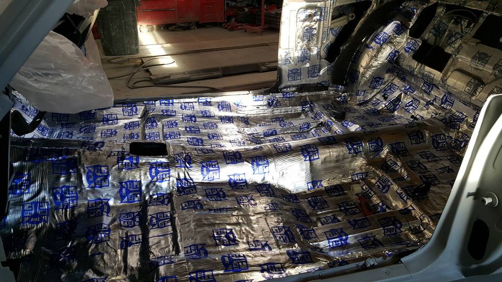

      Then some new sound deadening

      Haha...thx guys ya....I really was gonna go red again but about 6 months ago I sprayed a Mercedes color that I really liked....so I started with that color then added a little of my own custom twist to it...

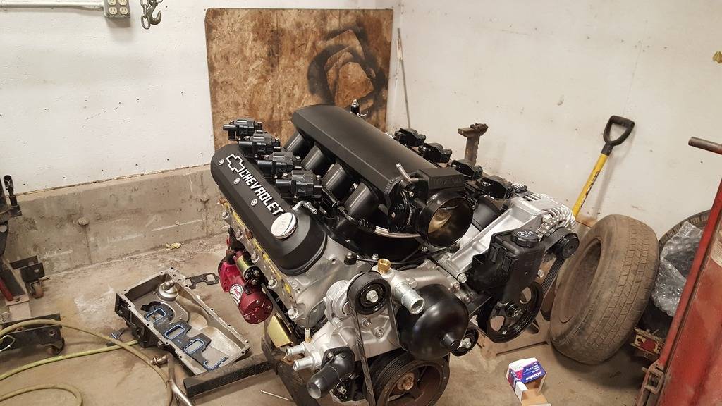

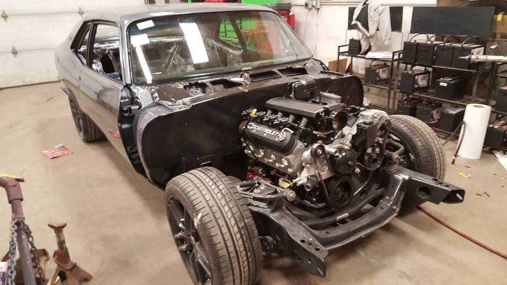

      Ok so as many projects do I decided to change direction on engine set up and decided it go injected, here's the engine now after intake ,oil pan and valve cover swap
      - - - Updated - - -

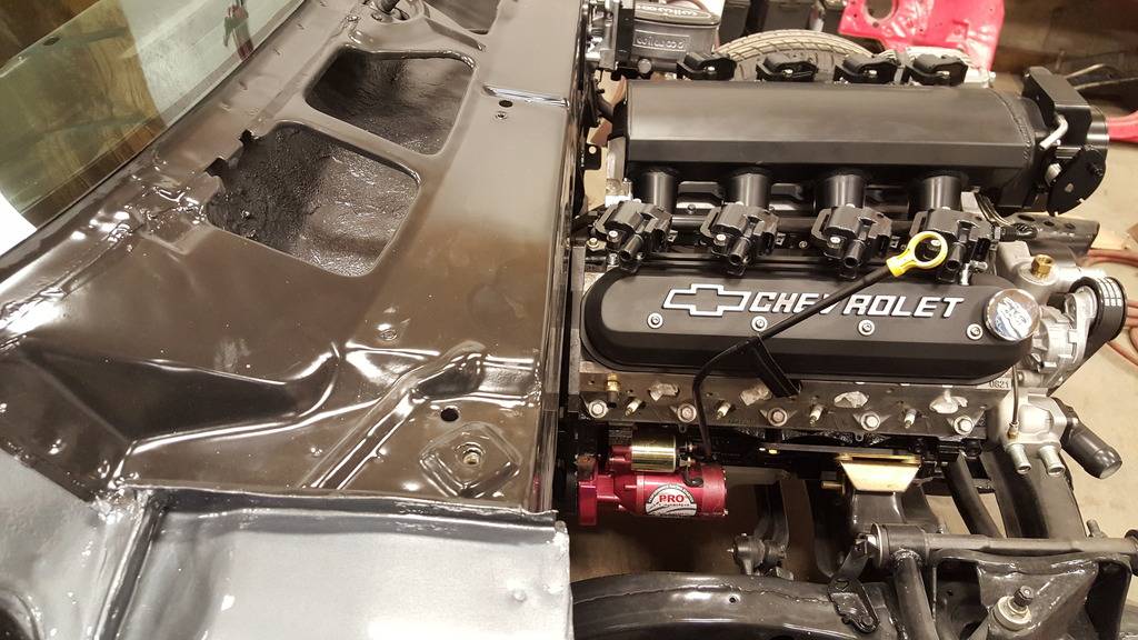

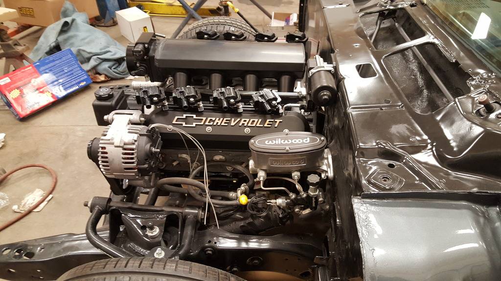

      And finally motor and t56 back in car
    12. #32
      Petersham ,ma
      522
      That's pretty much where I'm at now alot of not so exciting stuff now.....waiting on my new headers to show (found out the hard way my brand new dynatech headers hang too long below suffrage for a car that sits low!)
      Still gotta paint nose but I'm waiting to do headers and new wiring which I will tackle soon?

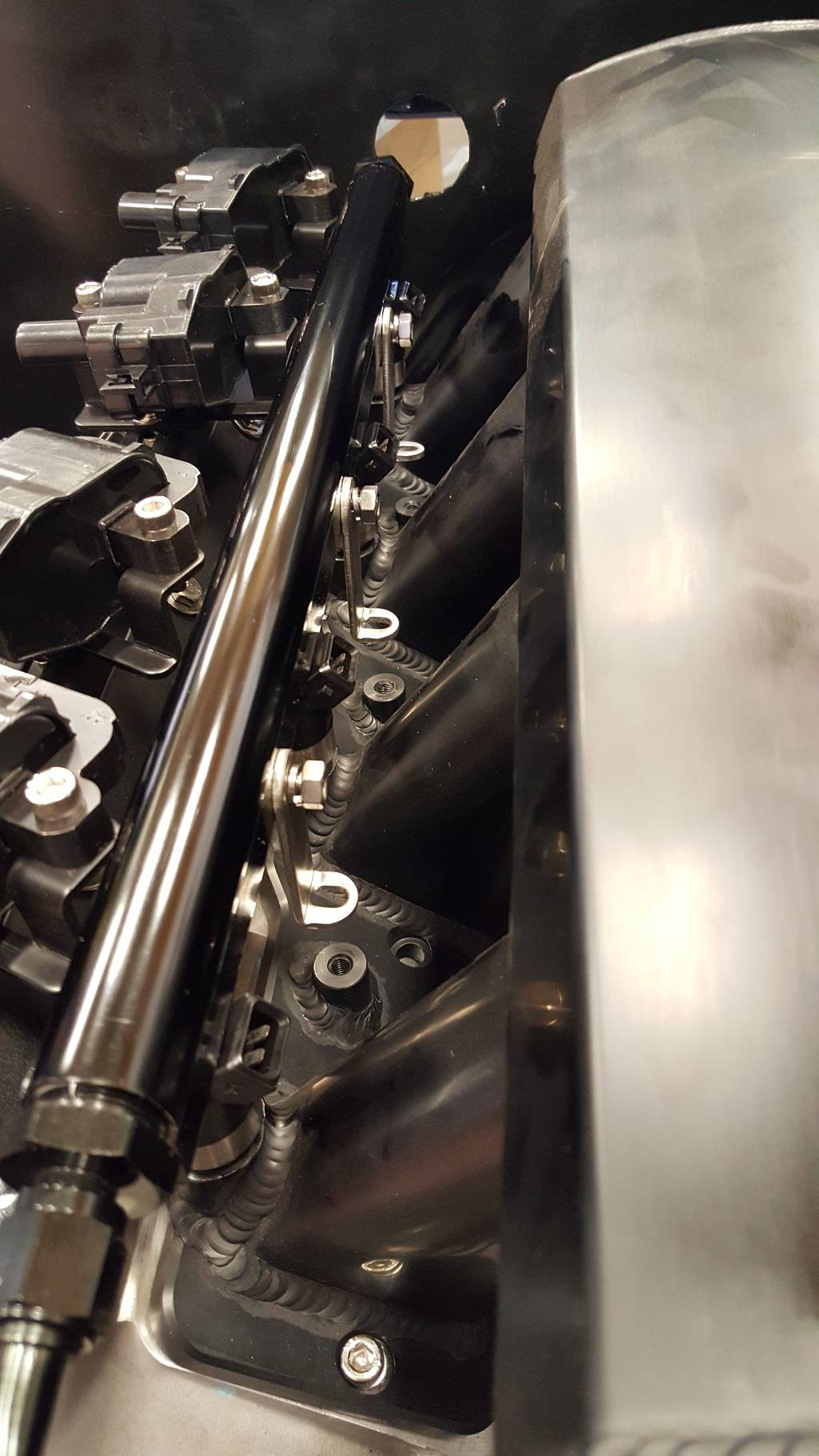

      So got my new 42lb holley injectors yesterday which are ls1/ev1 style and ran into a snag....while they fit the rails and intake(tsp ls3 intake) the hold downs are one inch short.....kinda looking like I will have to make up some spacers....

      yeah i believe my injectors were about an inch too tall and came with billet adapter spacers to pick the fuel rail up. Looking awesome!

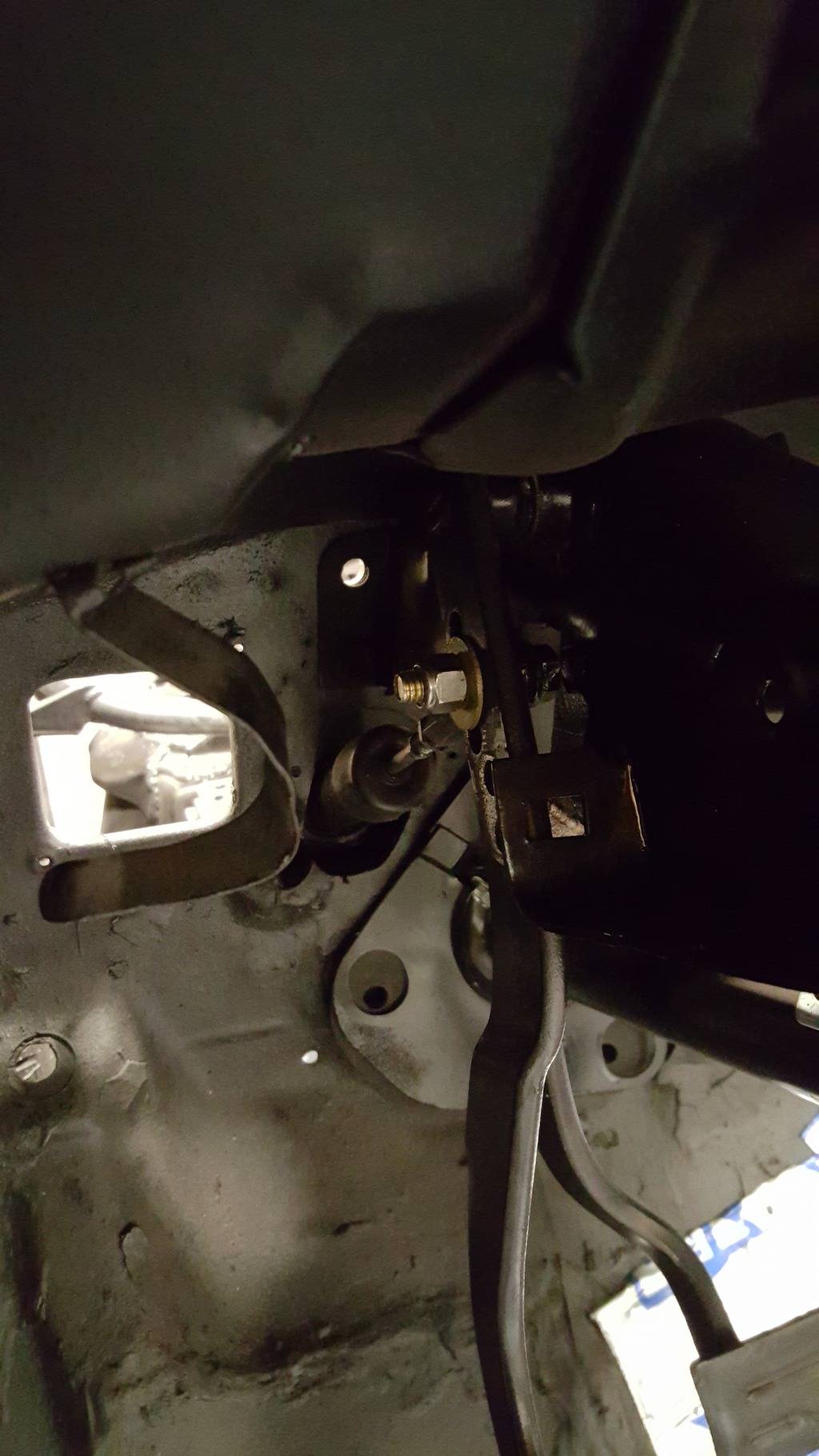

      Well Saturday I worked on my clutch and brake linkage...using camaro clutch Master and I have a dse firewall bracket. Was pretty straight forward just took some time. I cut the stock camaro clutch Master and welded threaded Rod to one side and welded a threaded sleeve to the rod end which gave me about a 1/2" of adjustability. ...while I had the clutch pedal out I drilled a few extra holes for adjustability.
      The wilwood Master was straight forward and was a complete bolt in

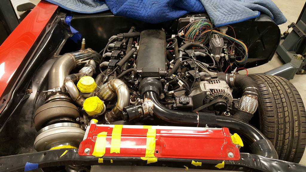

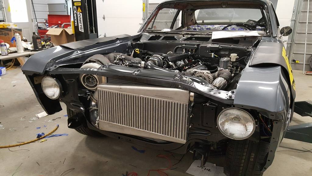

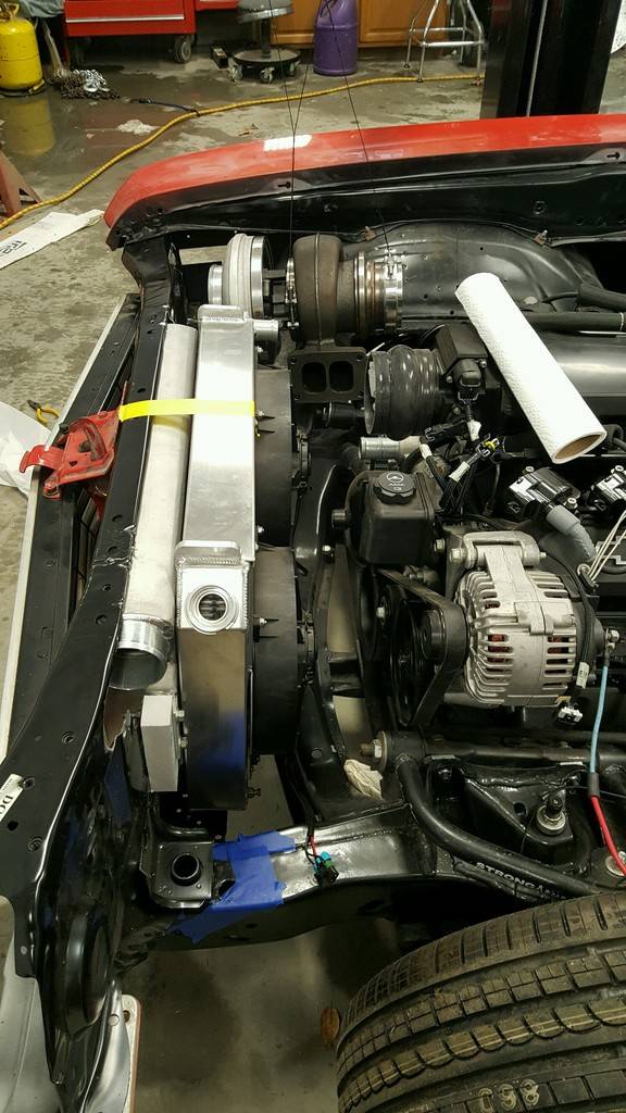

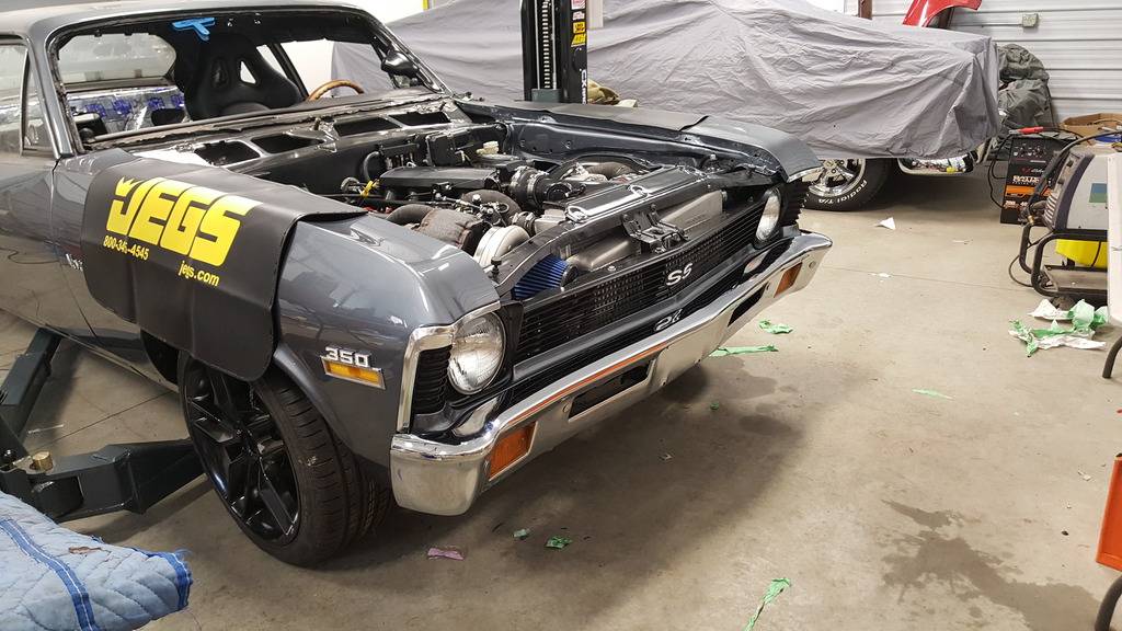

      Haven't been on he re in a while....took a bit of a u-turn. Decided to go TURBO. So sold injectors and na cam. Got thicker head gaskets, head studs,ljms turbo cam, aem meth injection, Precision blow off valve,Precision dual waste gates and a be s475 turbo....heres a few pics.
      This week o gotta do alignment final suspsion adjustments and beg for my back seat back from upolstr. After that road time/tune Holley efi and turbo setup

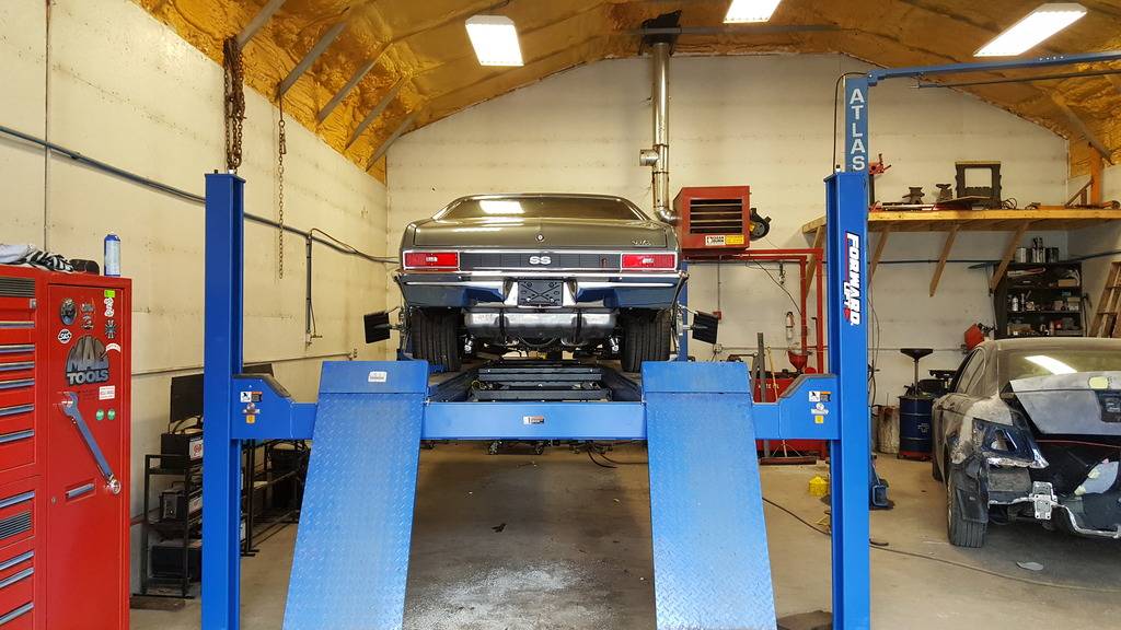

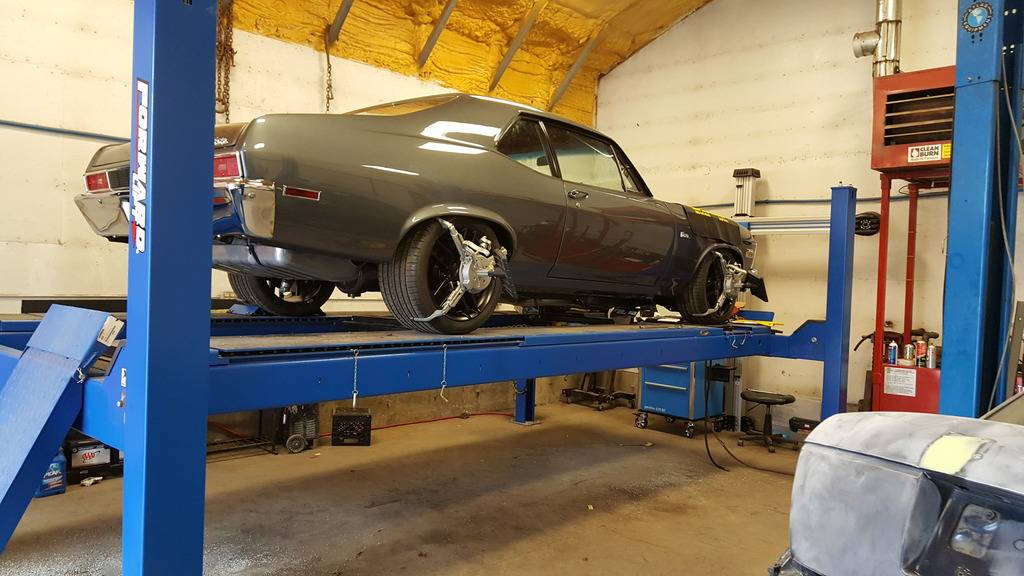

      Today 1st time in a long time car came out for alignment
      What a bitch to align, as it these cars went bad enough with the shims....all this dam turbo stuff didn't help the situation lol

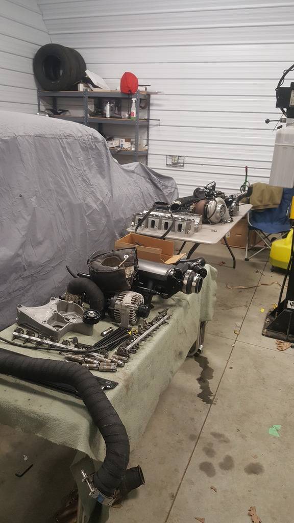

      Well...as you can imagine I was eagar to drive it after 7 years so after alignment was done I took it out for it's 1st drive , at 1st it was going great was tuning the Holley ecu in learn mode . The car was insane fast ...in 4th gear I could roll into th throttle and it would loose the rear tire at 70mph....and thats were thing got bad.
      I got off the hwy and slowly rolled into it in 4th I saw the boost gauge go way up into the mid 20's boost range( for some reason the manual boost controller failed) I imeidetly let off but it was too late and had a loud valve train ticking sound. Still had great oil pressure, I limped it back to my shop , tore it down and found it bent #3 connecting rod.
      So I'm now tearing down this is where I'm at now uhg!
