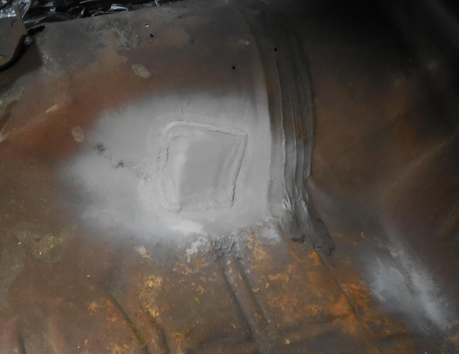

      engine and trans installed cooler line fittings and shift lever real close to floor pan I guess I should cut floor pan was hoping to slide trans cross member back but can't even get cross member inside of frame rails. I wonder if the after market cross members are worth buying if I cut and reweld the original it will not be easy to take the trans out in the future. what have some some of you guys done or seen done to fix these problems

      ok I had to buy a aftermarket cross member worked great summit sales 4l80e to 6an adapters put a 90 on the end notched and rewelded the floor pan for the return line and ran braided hoses threw frame. Also got Ford fan installed to radiator and vintage air condenser
