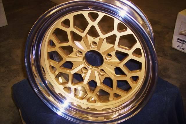

      Lastly, here are the wheels I had in mind. Year One Bandit Snowflakes! I think they're around $500/ea, but Year One's website doesn't say. I thought I saw that price in their catalog. Probably a little under $3,000 for this set up; shipping, tires, mount and balance, etc.
      I love the way they pay homage to the originals, but in a new school way! I think some 18X8 up front, and 18X9 out back would be nice, although the wider out back the better, short of mini tubbing. I like the way this guy painted them too, said the gold they came in wasn't gold enough for him.

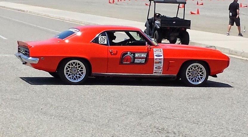

Size:  116.3 KBName:  image.jpg
      Here are the Year One 17X9 Cast Snowflake wheels on my 69 Firebird for reference

      I saw you had snowflakes in your sig, and was wondering which ones. That looks incredible!! Thanks for sharing!
