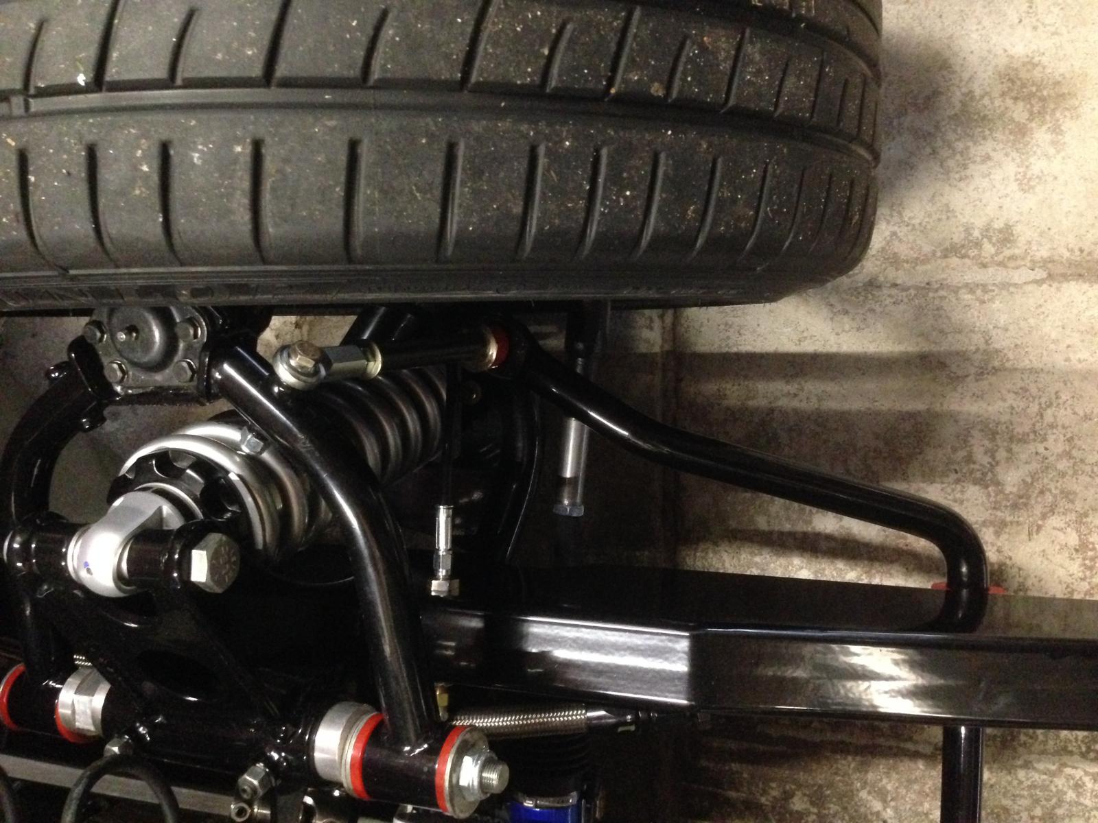

      Here is my problem. I am using 10x19" wheels with 285/30-19 in the front and my wheels are pretty quickly hitting the sway bar.
      Rob, you have a solution. Please post a photo here. Thanx. Kai

      Sorry, but do not know why I see the photo two times. Looking at the post there is only one attachment.

      Go with a splined sway bar setup to give you more room.

      Yep, that would be the plan. Rob wanted to take a photo from the sam angle as mine and hopefully post it here.
