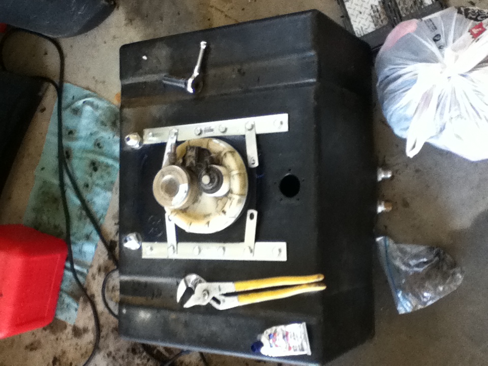

      Here are a few updates: mounted the dodge ram fuel pump assembly in the fuel cell.

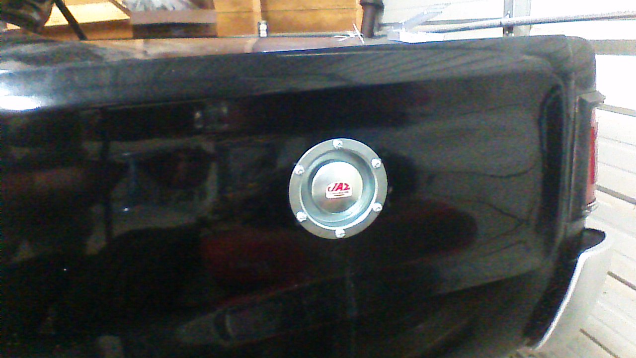

      Third update is I replaced the old leaky fuel cap with a complete fuel filler assembly from Jaz products.
Size:  210.4 KBName:  WIN_20150206_164954.JPG
      Some new pics.
      Anthony Hammond

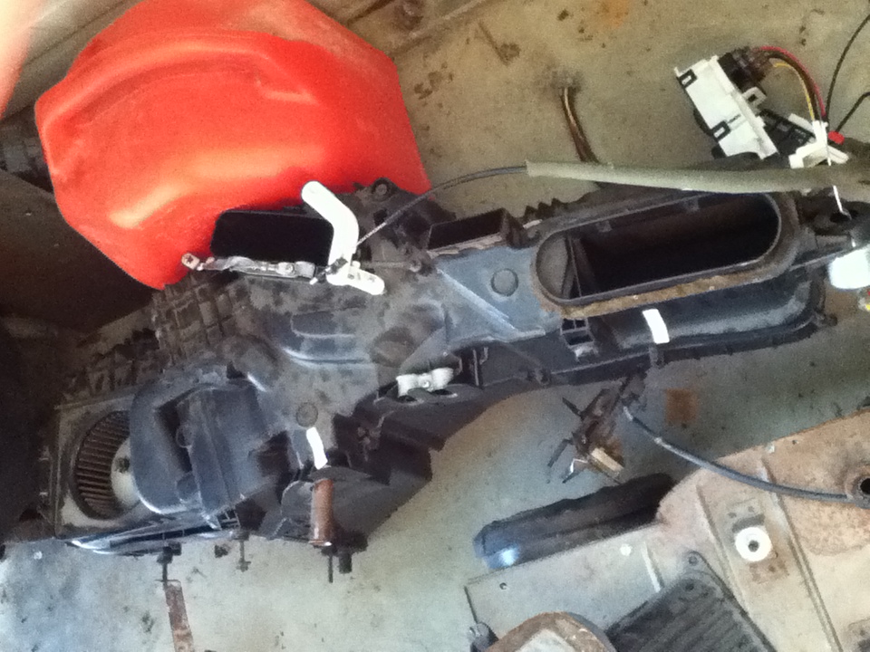

      Very nice! Will that HVAC unit fit under the dash of an old car? The manufacturers do great work on new parts, but I enjoy adapting parts where I can. I must admit Vintage Air does fantastic work. How do I know? Because I've extracted HVAC units out of three late models and not one actually fits under the dash of a '57 Chevy.

      Yes the heater air box does fit, but it did need some modifying. In fact the new box is smaller than the original.

      have tried taking the HVAC from small cars like Neon's, or Colbalt's? I see that you don't need to because of the Vintage Air, but if you do another car this could be a budget friendly way to go.

      I pulled one from a '96 Grand Am. What I found was that it seemed small enough until I actually tore the dashboard apart...but it was considerably larger in places which weren't obvious. A '91 Lumina unit was configured entirely differently but still too large. I measured the unit on a 2000 Contour and also found it too large in some critical dimensions. The basic issue is that modern cars have a dashboard much deeper than cars of the 50s and 60s. I haven't purchased a Vintage Air or any other and would love to find a unit that would work...but just don't know where to find one.

      So your problem is the depth, and not so much the length. I will have to get a picture of my two HVAC units, the original heater box is mammoth. the one from the ram is only about 3 inches thicker, but it fits under the dash with very little effort, in fact I don't even have to remove the dash to get it into place. Do you still have the HVAC unit? I can take measurements of the Ram's unit to see how they compare in size to yours.
