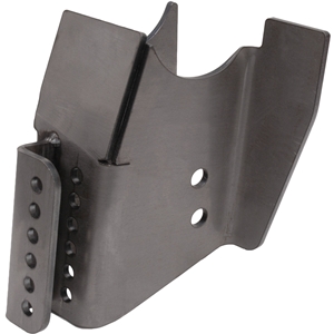

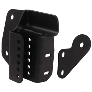

      The Chassisworks/VariShock rear system is available with many different options. There are three shock options; single, double, or 4-way adjustable with remote reservoir. The upper and lower shock mounts are available either bolt on, or weld on. You can see that the brackets are laser cut for clean edges and superior fitment and are made from thicker steel than our competitors for excellent strength. You can read a LOT more about this kit by downloading the Product Data Sheet HERE.
      This is the bolt-on version of the lower mount that will work with your stock brackets. Recommended for most applications.
      If you get the weld-on lower control arm bracket it gives you an additional lower control arm pickup point so you can adjust the IC. It also opens up additional wheel clearance. The picture below shows the weld-on style bracket. It's the same one we use for our factory welded Chevelle g-Link style FAB9™ housings.
