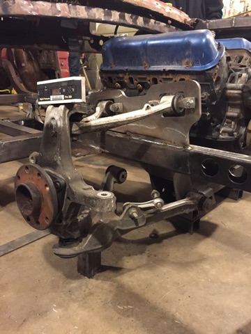

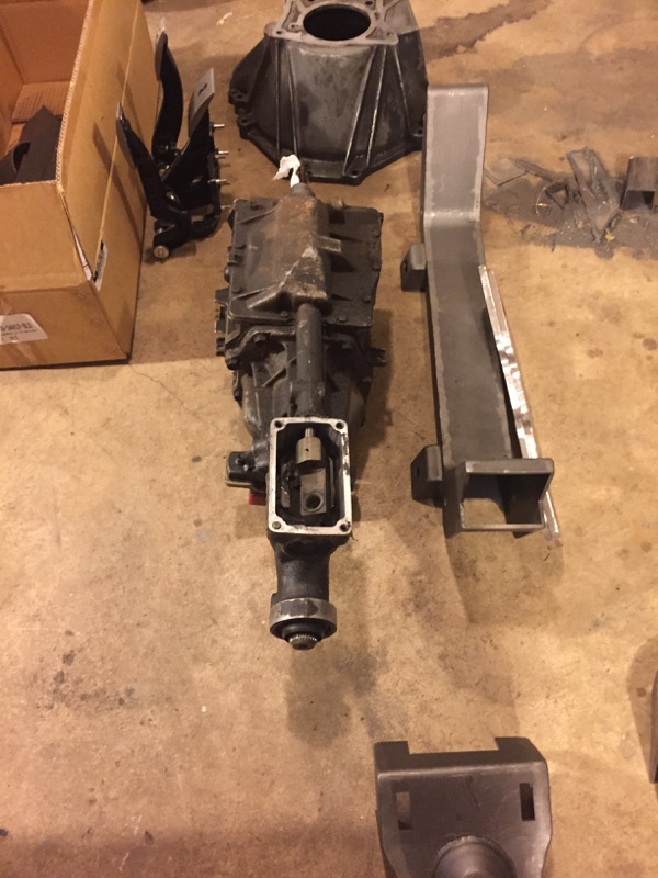

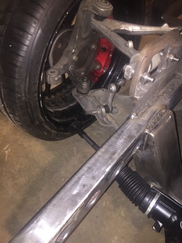

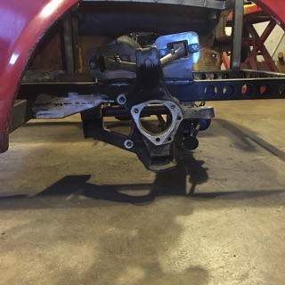

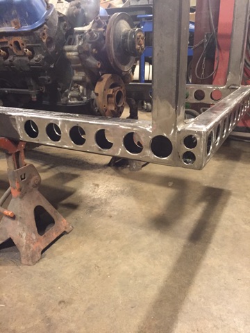

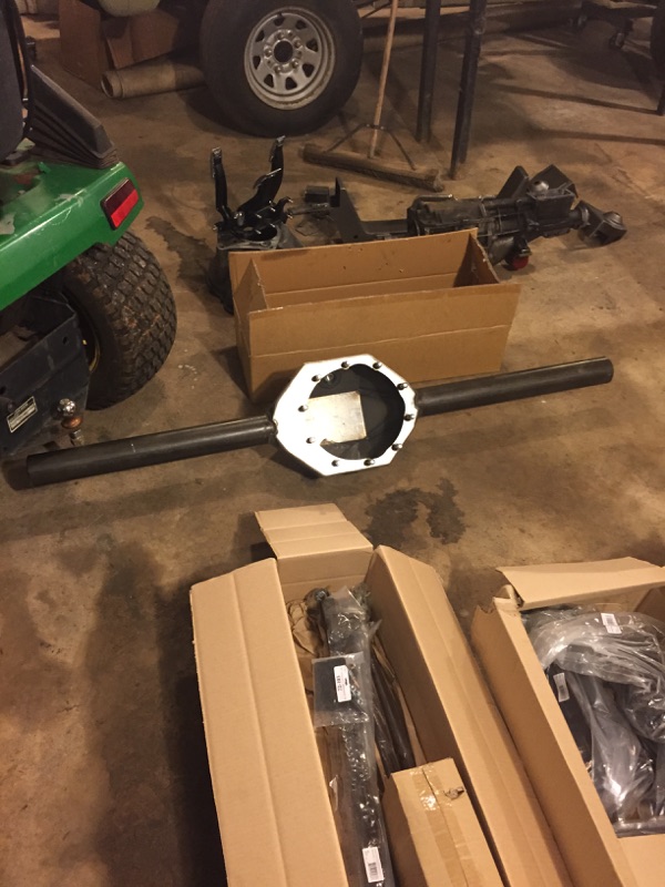

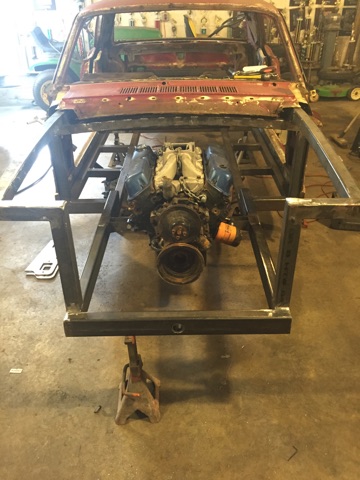

      Well got the frame finished for the most part, finishing up the front suspension minus a few things. Got the wheel sizes and tires sorted out as well. Its coming along really well now just need to start on the rear suspension next! Here is some progress pics, let me know what you guys think.Name:  IMG_2354.jpg

      Nice update love the lightening holes.

      Awesome work! Great Fab Skills!
      Thanks thought it would add some taste and a crush zone to absorb impact if I ever crash!
      Quote Originally Posted by injcted View Post
      Thanks a lot my first time doing fab work on this scale!

      Super nice work , I see a bow or radius in the top rails where the front fenders bolt on, how did you determine this ? and what is the
      dimensions ? I'm going to have to do this. since so much welding was done on mine they warped . Thanks for taking the time to document
      your build , it really helps guys like myself.
      Vern

      Pretty nice outcome for a first project. May I ask where you sourced the C5 crossmember and frame plates? Are you using a 'vette rack and pinion too? Seems everyone is doing this, but if it works, who cares and there's no guesswork involved. Thanks for sharing
