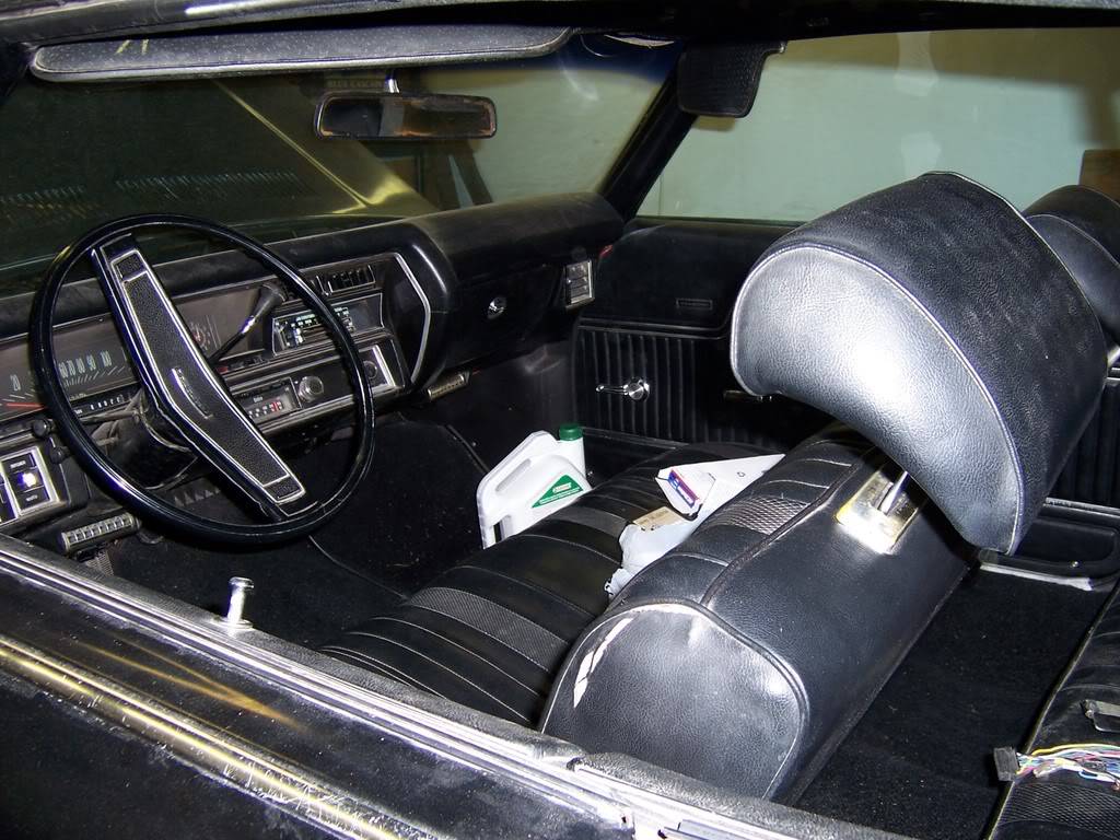

      I'm probably a long ways off on actually starting in on this so I'm going to hold off on a build thread but it's probably time to at least consider the concept and maybe what direction I might go. Plus i'm kind of bored and the weather is geting crappy so I thought I would start a discussion on it and see what you all thought?? Maybe even start collecting a few parts if the deal is right in front of me while I finish up my GTO.
      Iv'e got this thing laying around. It's a 1970 Chevelle Malibu. Its all there. Bone stock, 1 repaint in the early 90's. There's virtually no rot rust. Its been in the family since it was brand new. I was the last one to drive it in Highschool in 1998. 350/TH350 8.2" 10 bolt. Bench seat, column shift, AC, PS, PB rear window defog and most importantly...vintage aftermarket AM/FM Delco 8track and complimentary 3 Dog Night 8 track.
      So i'm thinking i'm going to completely leave the exterior, most of the interior, sheetmetal and frame alone and build it from primarily nothing but bolt on used parts. The goal would be to build a killer handling, reliable daily driver street car on the cheap and leave the patina. CHEAP being the key word. I'm thinking like $10-12K for a hardline budget.

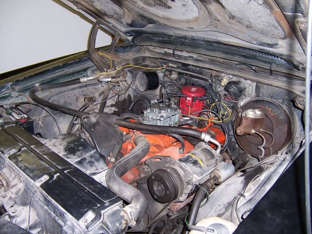

      -I'm thinking a junkyard 6.0 with a few bolt-ons for an honest/street happy 87 octane 400hp

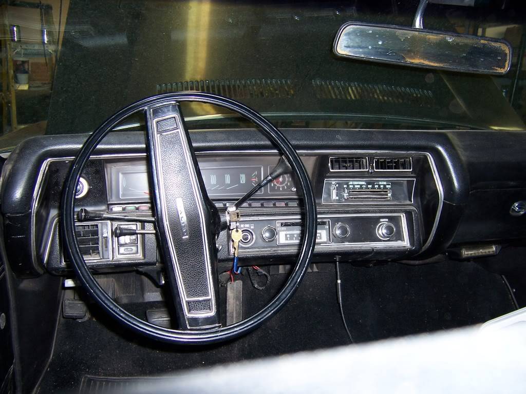

      I think you are spot on with the 6.0,700r4, and the Tanks fuel thingy. Something you might of not thought about is where will you put the gauges to watch the oil pressure and such. The stock dash leaves alot to be desired. The clock is kinda cool but I think I would rather know my oil pressure.

      Guess I haven't thought that far forward. I'll probably do the 80's esque gauge pods below the dash like I have in my GTO currently. I'm going to be doing speedhut stuff in my stock GTO dash this winter so ill probably re use those under the Chevelle dash. I know the Malibu dash isn't very utilitarian but it will stay since its kind of a nostalgic thing for me.

      Quote Originally Posted by Nicks67GTO View Post
      -Tanks inc fuel system
      That was my exact goal when I did my LS swap. Look for a LY6 6.0, I believe the came in the 07-10 Chevy/GMC 2500's. They have the 823 L92 rectangular port heads on them. I deleted the VVT cam and timing set added and LS3 intake and a 223/230/.601 lift cam and headers. It makes and easy 400+ horsepower and the 9.6 compression ratio is happy on 87 octane. The engine has a great street manners!
