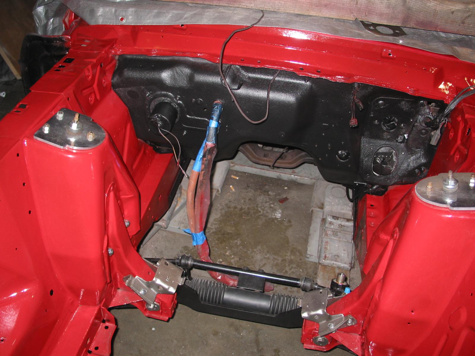

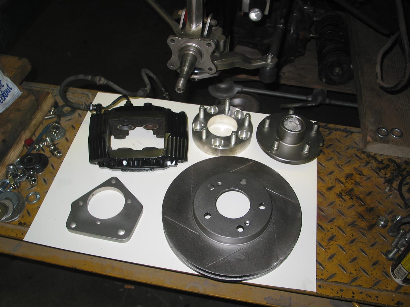

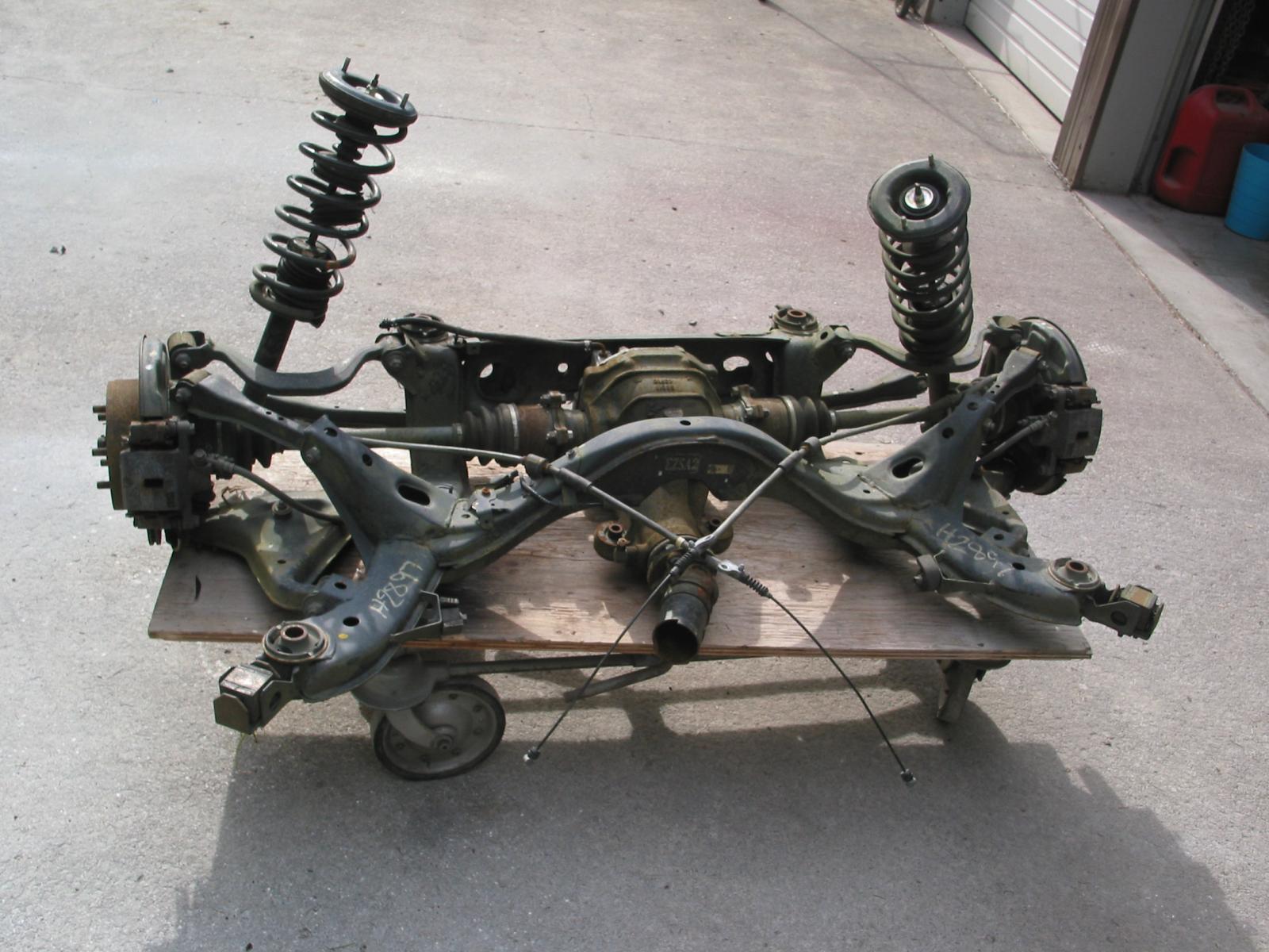

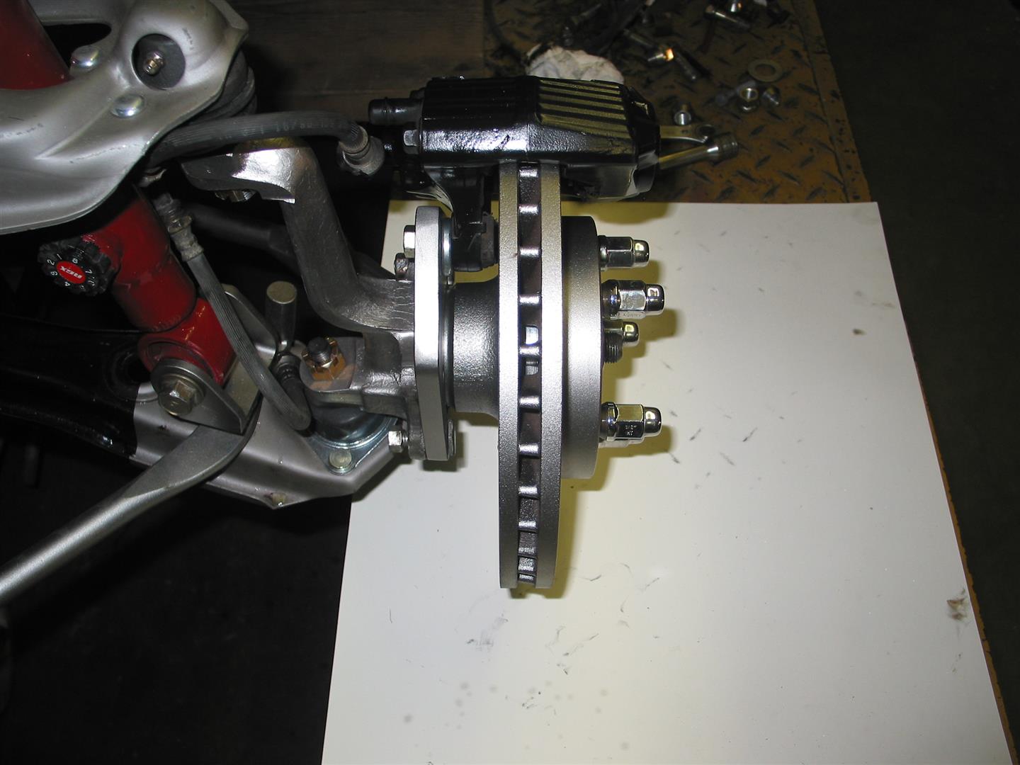

      building 68 mustang for a friend, thought you might like some details. installed new front suspension arms and modified the lower control arm to accept a adjustable nissan rear shock and spring arrangement that fits into stock perch. lower mount is ride hieght adjustable. also, dropped upper mount location 1 inch. rack and pinion steering kit and export brace. the rear has been modified to accept skyline (nissan) irs with custom fitted coilover from a 240 sx drift car. the front and rear brake system is also skyline 4 piston calipers and rotors. total parts costs are under $2800. post some pictures if i can figure out how.

      photosName:  IMG_0324.jpg

      esrifno; you might want to make sure and use a lower control arm ball joint that was designed to be in tension. The factory Mustang LCA ball joint was never expected to support the weight of the vehicle in tension. I'd hate for that factory joint to come apart while you're cruising down the highway.
      will look into it thanks-sean

      thanks for the interest. the front strut shock i used is a kyb adjustable from the rear of a 240sx-s13 and i believe the spring is mazda rx7 2nd gen which has the correct wind size on the bottom and is wound to the same as a stock mustang coil on top. the adjustable lower mount is a old ferrari lower control arm frame mount(s) i just had laying around(lol) the stock upper control arm balljoint in a mustang was choosen for its strenght in compresion. the stock lower appears to be the same or similar to a mustang 2 lower both of which are for tension loading , although early mustangs see very little loading in normal use, but the m2 has the spring on the lower arm so the same joint see's all the load.
