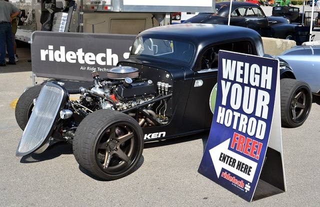

      that is why we do this!! weigh cars at almost every event because then we can tune the shocks to be perfect for that cars, average weight, corner weight and balance
