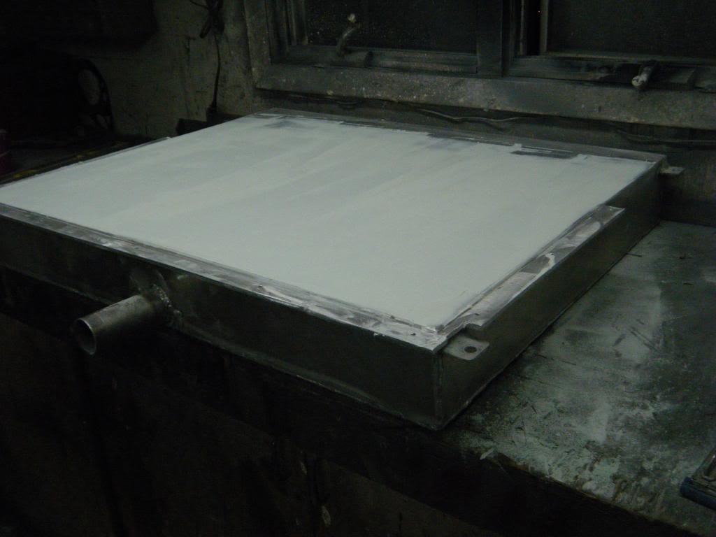

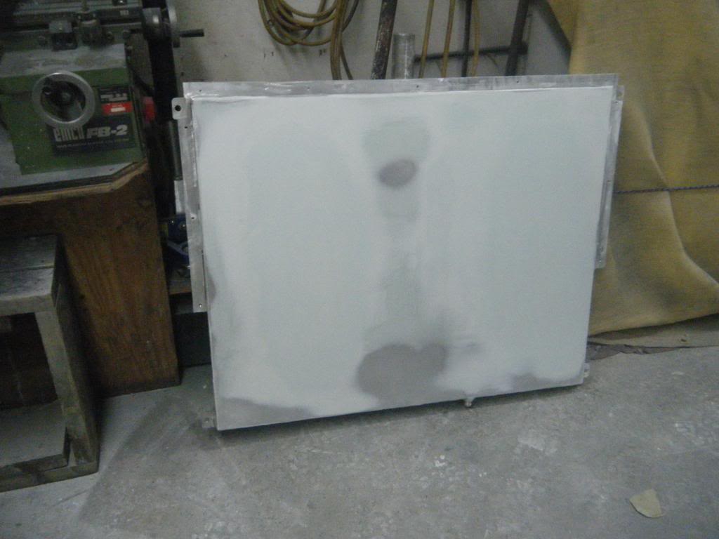

      Custom aluminum fuel tank I built The flange around the outside of the tank is where the close out panels bolt up to giving me easy access to fuel pumps and filters and keeping the bottom of the car clean

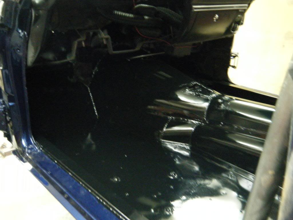

      Quick paint job on the floor pans

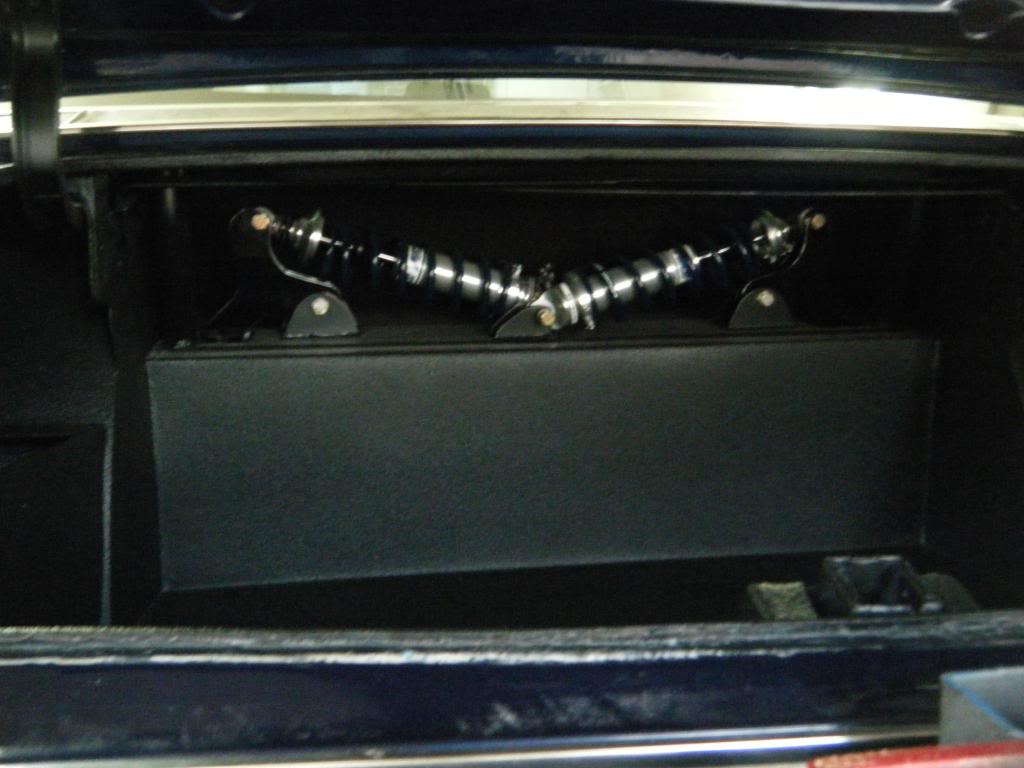

      Rear cantilevered coil over setup painted up and installed With Afco double adjustable shocks and Ride tech springs

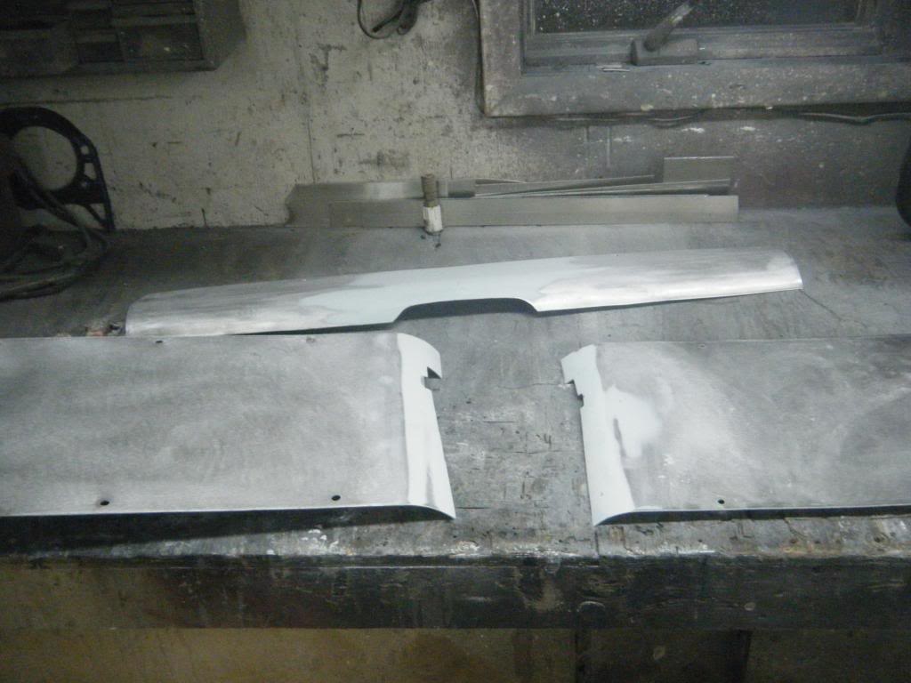

      Fabricating an aluminum rad cover
