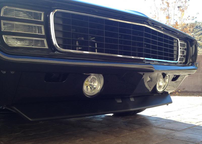

      Car has a few subtle body features, Deleted marker lights, filled cowl vent and notched rear spoiler. Body matched smooth bumpers.

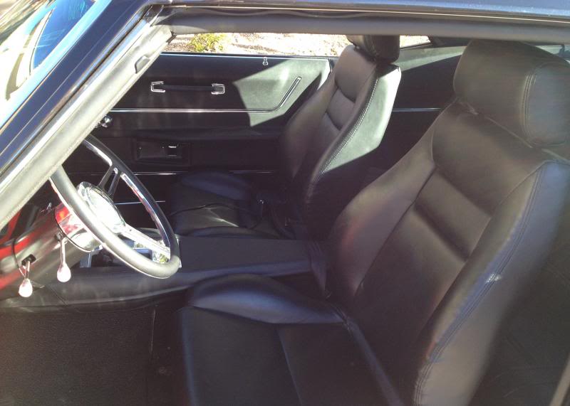

      what kind of seats are those and whats your opinion of them? great car BTW

      The seats look like pro car rally
