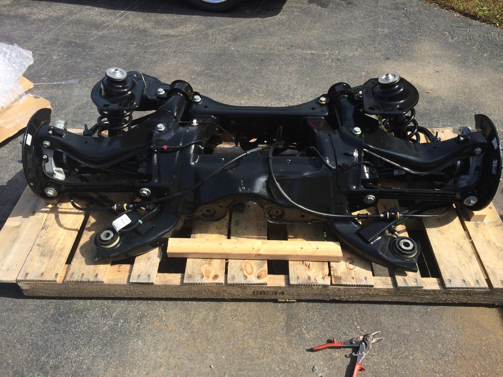

      Just in parts collection mode: Radiator, brakes, guages, motor, transmission, etc. All on the way to me.
      Interestingly enough I got this very cheaply...
      Birmingham, AL
      3,355
      5th Gen rear? Interested to see how well that will fit. You have some nice brake options with the Brembo's and consumables like rotors shouldn't break the bank. What is the width hub to hub?

      Mar 2012
      285
      Quote Originally Posted by srh3trinity View Post
      Not sure it's going in yet, but it is what Art Morrison and a few others are using. It's from a 2013 ZL1. 62.5" WMS to WMS

      Mar 2012
      285
      I have a few choices. Ford 9" with four link/watts bar/panhard bar or this suspension with a stock center or 9" center kit.

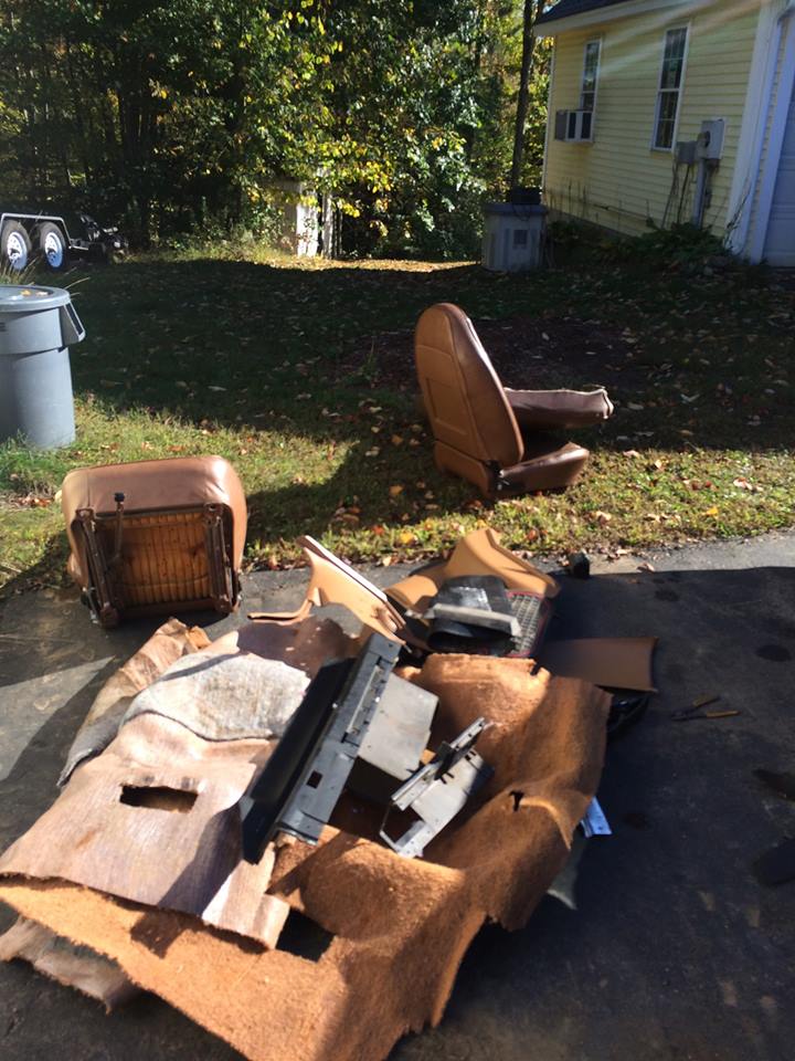

      285
Size:  114.9 KBWhoops... the interior fell out.
      Actually, prepping it for TR6060 install with DSE mini tubs. Heading out to the suspension builder soon.
      Mar 2012
      285
      So, after a lot of conversation and planning with a bunch of fabricators and manufacturers, I've decided to work with Scott Mock. His mandrel bent front sub frame, with C6 suspension. He will install the 5th gen Camaro rear suspension with links to his front frame, modify the trans tunnel, install DSE mini tubs and mock up all the steering, engine mounts and trans too. Should be fun. I am driving it out to him on the 1st.

      Birmingham, AL
      3,355
      My subframe came from Scott and my car is now in the mock up phase. I like the idea of having IRS so I will be watching. Mine is getting a ridetech and 9 inch floater, but depending on the fab work, you potentially could come out around the same if you got the IRS for cheap enough.

      Mar 2012
      285
      Exactly. This will be less expensive, as most would cry if they knew what I spent on the rear end. I also have two Caddy rear sets to play with in other cars.

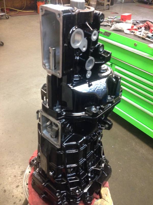

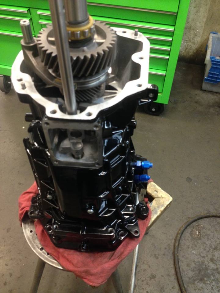

      Mar 2012
      285
      and we're getting closer to having a bad arse, 6 speed manual trans:
Size:  64.8 KBName:  1921907_10203592512708163_4429130998886931906_n.jpg
