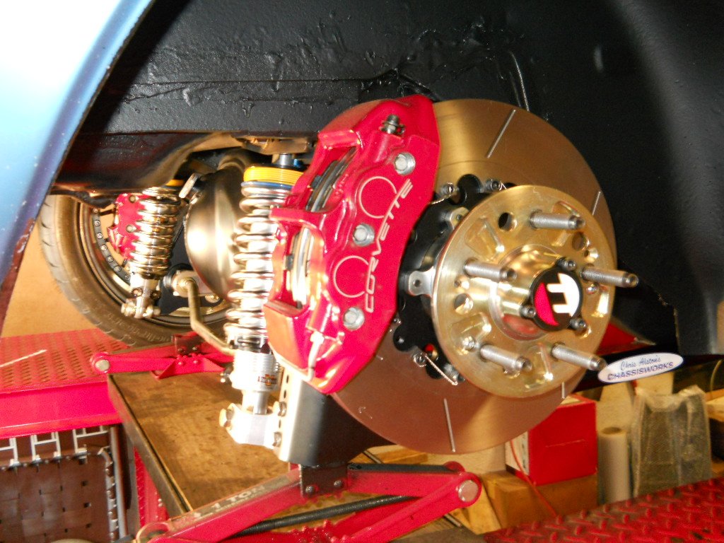

      Quote Originally Posted by TheJDMan View Post
      If you are springing for a complete rear end there is really no reason to not go with a full floater. The cost between a floater and a big ford end is virtually identical and floaters work just fine on the street. I have a Moser 9" floater with over 6000 miles now without a single problem and the complete rear housing with hubs, bearings and axles sells for less than $900.
      wow that looks awesome was it hard to adapt the c6 brakes on their? Also since my rear wheels are still 15s would I be able to run drum brakes for the time being then switch over to those? Really set on a fab 9 floater now just need to decide on what spline axles to run and posi

      Interesting question. Can you fit big brakes on a floater with 15s?
      C6 z06 rears rotors are 13.4" by themselves. I'd think you'd need at least a 17 to house them w/calipers

      Drum brakes on a floater? It can probably be done but the cost would be high and the results would be disappointing. I do know 15s can be run on floaters with disks, NASCAR teams do it every weekend. In fact, you can buy surplus NASCAR brakes (and floaters for that matter) from places like Roush-Yates used race parts for pennies on the dollar.
