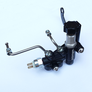

      Another solution with similar plumbing is the new Wilwood valve they made for us after we begged enough!! It has the adjustable rear valve built in.
      It installs the same way, in the same location but, of course, the quality is much higher.
      It looks like this:

      The exit lines are similar, not the same, it will take some tweaking and adapters to connect but its a VERY popular valve now!
