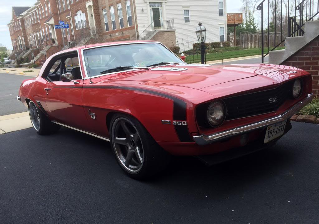

      I really want to thank everyone here and at PT and Lat-G cause without you guys, I couldn't (and shouldn't) have done this!
      I only copied what so many others have done before, so no real need to go into full detail...
      A special thanks goes out to my old neighbor Herb Lumpp for all of his help, Matt's Classic Bowties for a ton of parts (and patients), and my tuner Ed Hutchings for making this thing purr like a kitten!
      Stock LS3 crate motor
      LS9 cam with stock valvetrain
      Magnuson TVS 2300 for a 2010 Camaro ported and fit for a Wegner 10rib front runner setup by Casey Wegner
      Injector Dynamics ID 850 injectors
      12 pounds of boost
      C&R heat exchanger for 1969 Camaro (Ed said it was Very efficient)
      Kooks 1 7/8 headers with 3" exhaust
      Magnum t56
      Moser 3.73 wavetrac 12 bolt rear
      Ricks vaporworks tank with Camaro ZL1 pump and regulator (pump is maxed out)
      So after 2.5 years of building my first car, I am finally on the road and enjoying my first full build. Still a small list of punch out items, but she's driving really nice and burnin rubber. I'll spend the rest of this year getting the bugs out, and next year I'll hit as many events as I can!!!
      Thanks again,
      Matt
      '69 Camaro Coupe, Full Ridetech stage 3 suspension, moser wavetrac 12bolt, Forgelines, Ls3 T56 Magnum and once again tuned by Ed!
