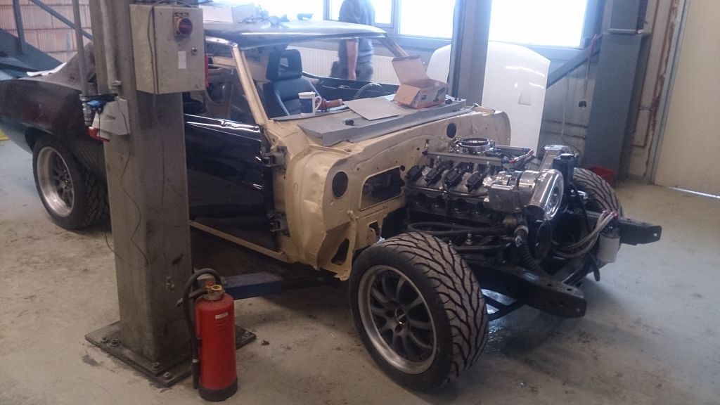

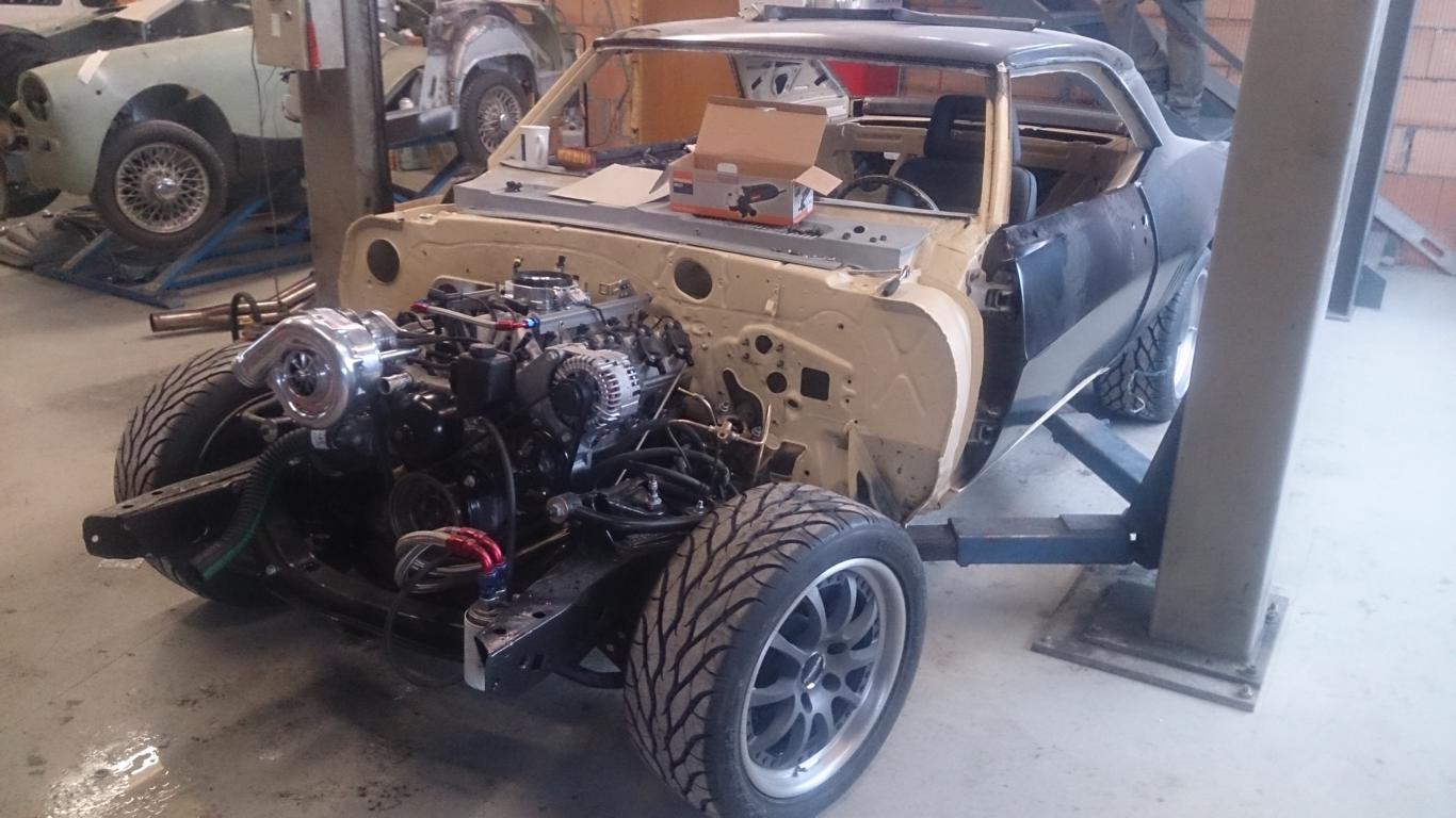

      i did some research on that topic before so i ordered the corvette brackets without A/C which is only available through pace performance (they just build that kit from single parts) and used a reverse rotation procharger with Corvette C5/6 brackets. works flawless and should clear the hood (iīve got the standart height cowl hood). exit is gonna get up front where the stock battery location has been and comes back in the same area on driver side. havenīt made the piping yet but i have some pics of the charger installed just to show you how it looks like my way.

      cool set up. Hope your car isnt an RS. What are your plans with the air filter since your intake is going to be right where the hot air is coming from?

      hehe pat...thatīs the engine you sold me a couple years ago from your camaro sale weīll do piping for the air filter cause law restrictions wonīt let me have a open filter anyways, so weīll fab a filter housing somewhere in the wheelhousing/battery location. my car was a standard 307/350 so no big deal there.
      what size supercharger did you go with? D1 or F1-A? Any more pics of the setup?

      thatīs a p1sc1, so way too small for that engine but i got it very cheap here in austria and being on a budget leaves no room for a f1 which should be used on it. hard to sell and iīm just shooting for 600rwhp so iīll give it a try. what kind of pics are you looking for? i have taken it off right now and thereīs no piping done, but if i could help you out i can bolt it back on to take any pics you need.
      Im curious about the distance between the p1 and the radiator.

      this picture was taken from a sideway angle so if you look at the holes where the radiator support is getting mounted and some imagination it would give you a place to start. i have the support and my old 2 row aluminum radiator installed now so if you need exact numbers i can mount the charger next time iīm at the car and take pics/measurements.

      Thanks for the pics. It does look damn close.
