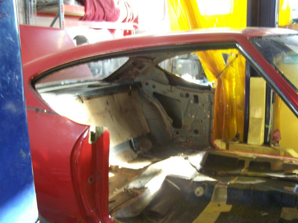

      The body was rough and I wish he would have passed, but it was too late buy the time I saw it.

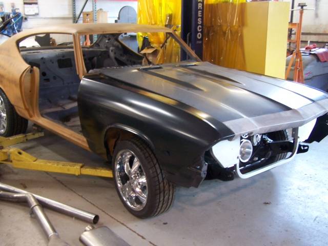

      These are a few pics after the car went to the shop for disassembly.

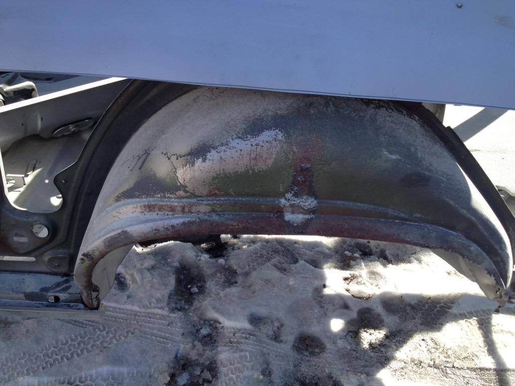

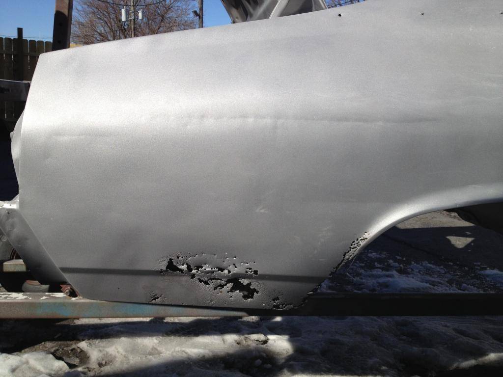

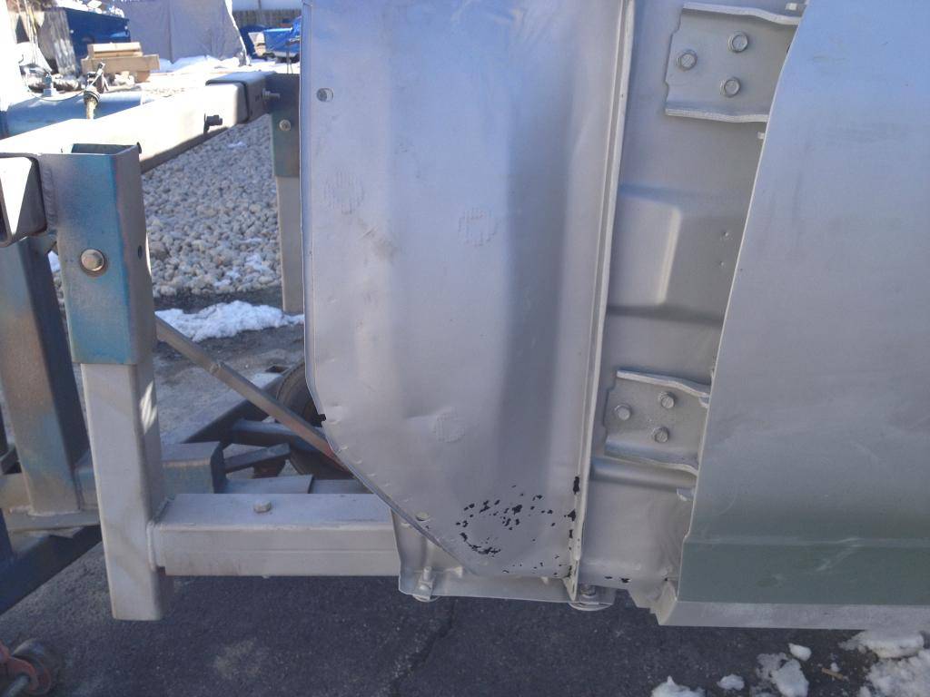

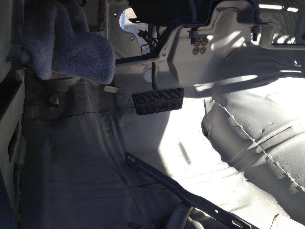

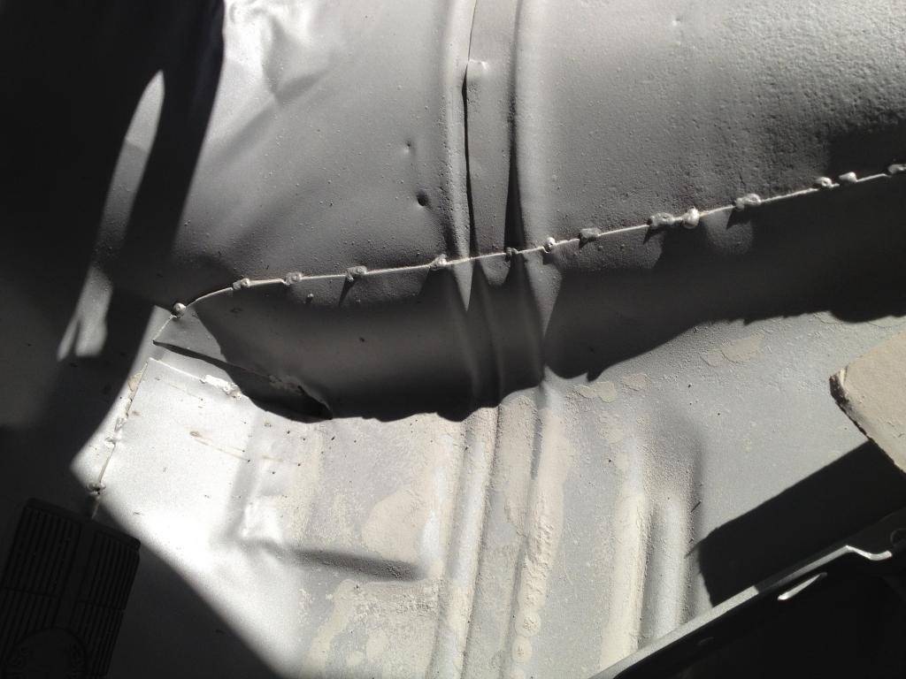

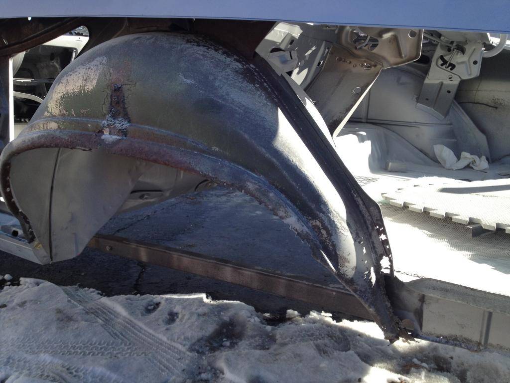

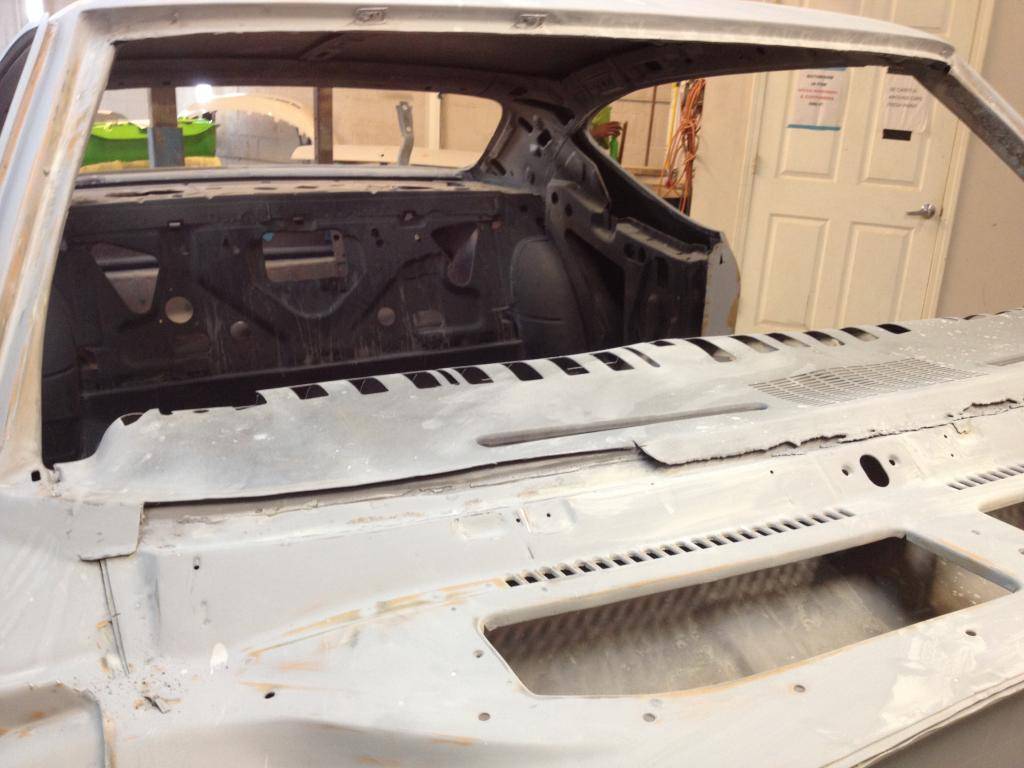

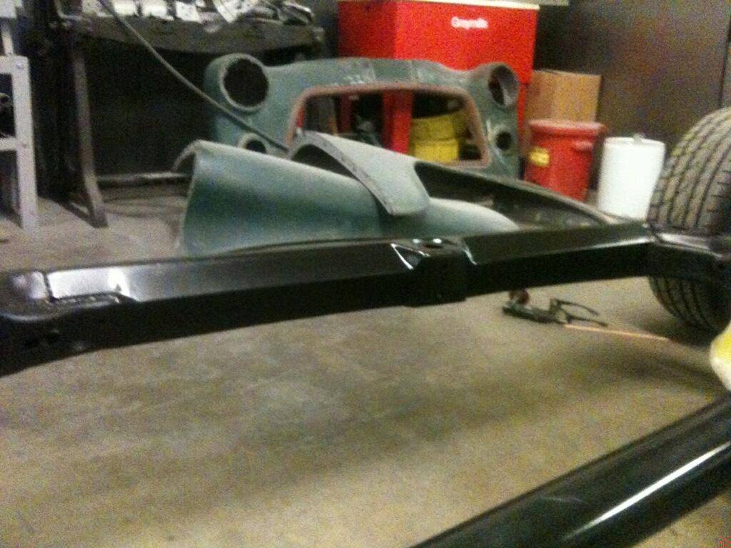

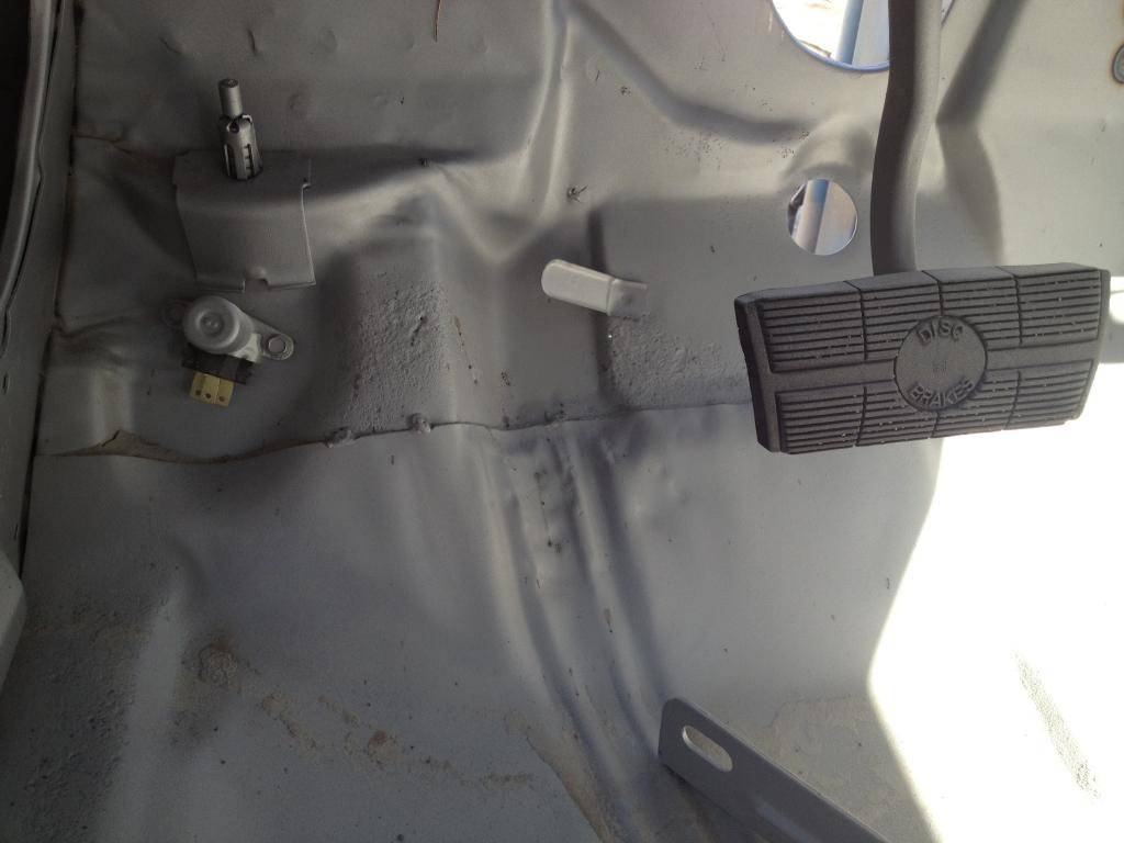

      The car was sent off to media blasting and the results were what I expected.... terrible.
      quarters were as was the winshield cowel area.
      We found the floors had been patched with something that was not from an A body as the lines and brackets were not correct. Since the car had a bench in it this was not apparent. Wish he had taken me with him when he looked at it.
      Big dreams, small pockets....

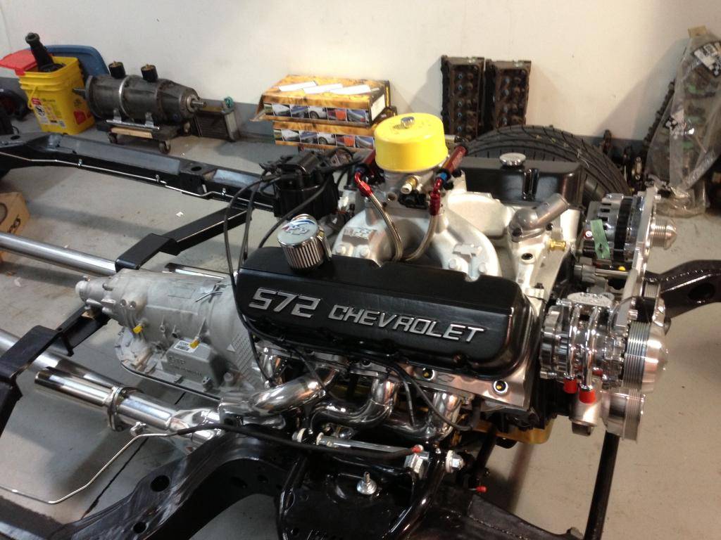

      So my friend decides this is going to be his last car(he owns a 65 Impala SS and 65 Lincoln) so now he jumps in with 2 feet. We call Mark at SC&C to order a Currie Sportsman rear and BAER Pro Plus fr/rr brake system. He liked the look of the classic torque thrust, so he ordered Foose with a 2" stagger front to rear. These were not my suggestion, but he's paying the bills...
      When the time came to find a good rebuildable core, he decides he wants to step up to something bigger than 454.... GMPP 572!
      This is another occasion where builder wants to use one of his people "engine guy", but his guy is 3k higher than Jegs or the local GM Performance dealer. WTH? We ordered the 572 and 4l85e from Jegs. We also got a Pro-Touring converter from Steve at Twist Machine.

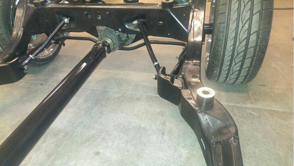

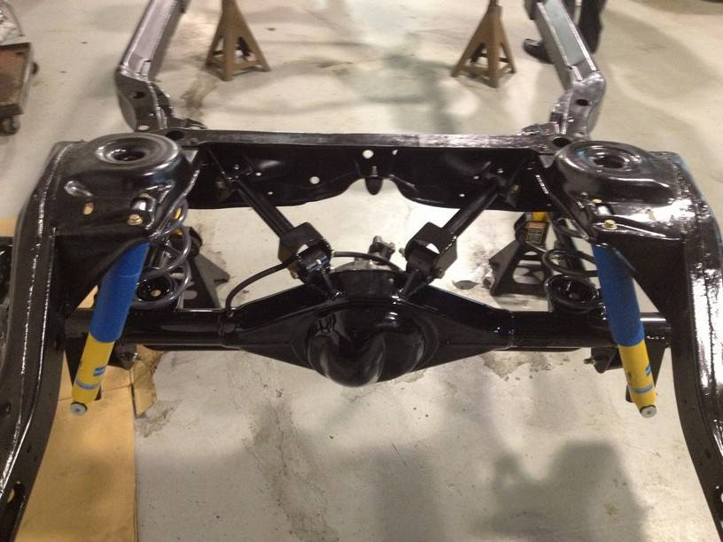

      So because the car is sitting higher than expected, he says "You ordered the wrong springs. Those must be 1000lb springs in the rear, its sitting to high" I say "no, they are probably 175max. You do know the car is not completely assembled right?" Since these are Hotchkis springs that come from UMI, I proceed to call Hotchkis and spoke with John. I put him on speaker so he can explain to the builder that the car should be assembled and driven 5miles before he would consider the suspension settled.
      He returns the car to the painter who calls me a few days later asking if I could come by the shop he has a couple issues. When I get there he tells me the wheels will hardly turn and he noticed some welds the looked bad.

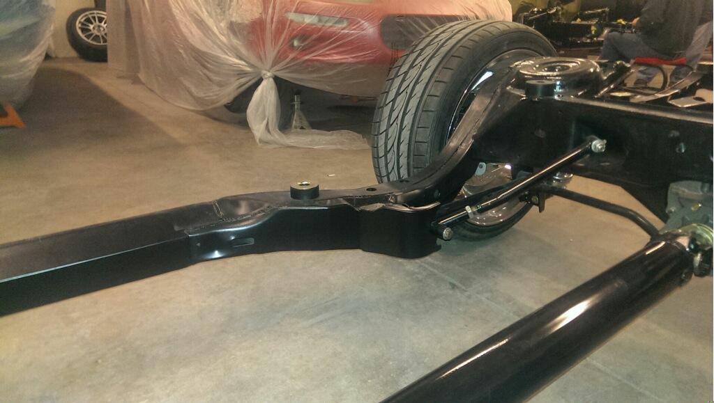

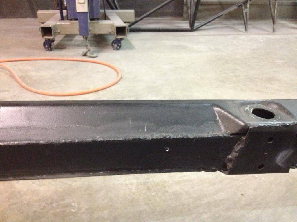

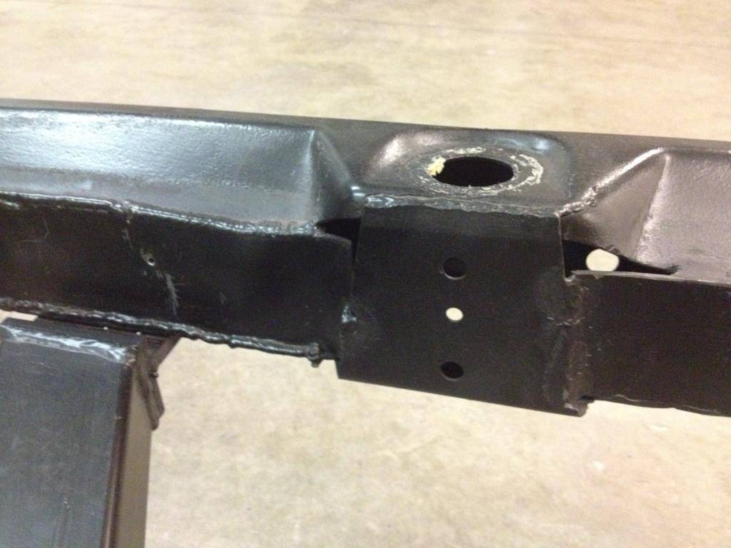

      Remember that word fabricate? Well I get under the car to see this:
      Should anyone that welds like this and charges people be able to use the word fabricate?
      I notice that the tie rods are hitting the sway bar which is preventing the wheels from turning, so I call the builder. He says "well you know that aftermarket bar is much thicker than stock. We'll fab some spacers when it gets back to the shop..." I tell him "I'm not trying to be funny, but my sway bar is just as big and my wheels have no trouble turning and I'm building my car in my garage!".... Now he hates me...lol

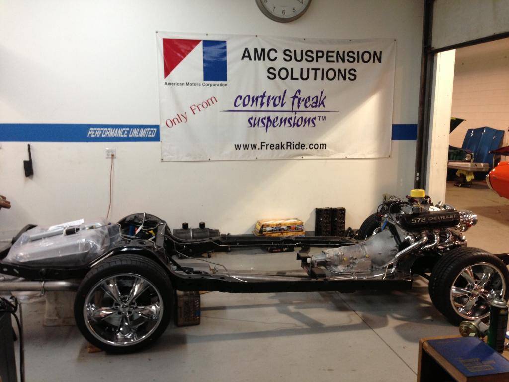

      So while looking at the car, the painter says to me "Why don't you guys check out my friend? He has a shop not far from here and he does good work." I call my friend and say "we need to move your car. I'm going to check out this other shop and I'll let you know what I think.."
      Fast forward a 15 min ride and I'm at Sled Alley... Yep the same one that Mark Stielow works with.... Matt's a really nice guy. I tell him about our situation and the crap we just found out. He says he's be glad to help up finish the project. I call my friend to tell him "it's time to move the car..."

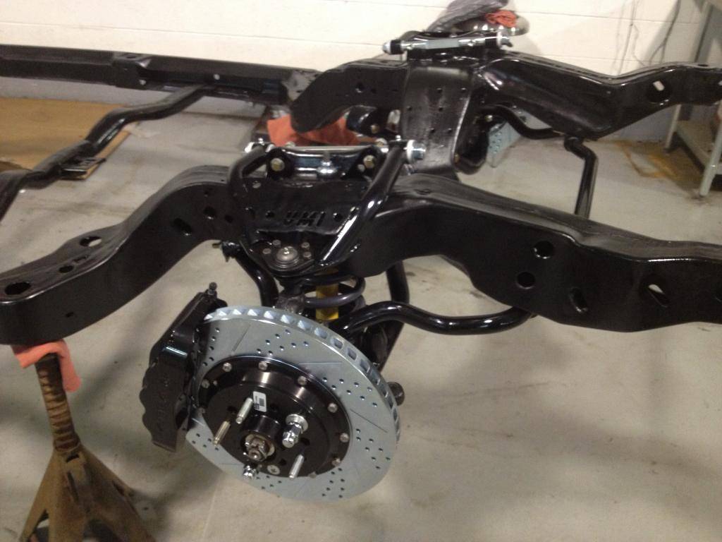

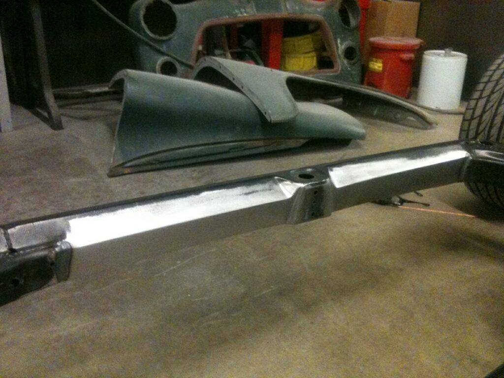

      Matt said he will look over the suspension the see whats wrong and also inspect for any other issues. Well we hadn't seen the frame after the previous builder said he was boxing it, this is what we found:
      Mind you this was welded by someone that used the word "fabricate"
      Matt made quick work of the problem. He burned in some new TIG welds and repainted the chassis. He also boxed the portion of the frame around the rear LCA mount just for a cleaner look. Upon further review and a call to UMI, Matt discovered the problem with the old shop(besides the welds) was they put the upper control arms on the wrong side! WTH!!!! Switching shops quickly paid dividends.

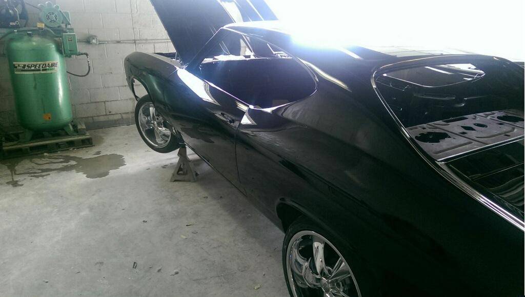

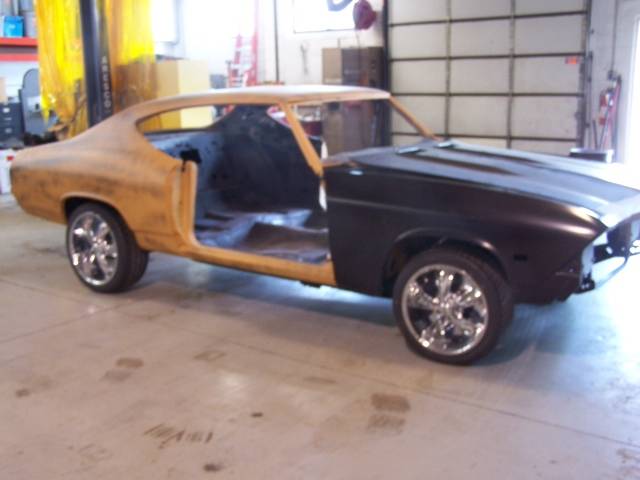

      Well the car has been painted and will be polished and dropped off at Sled Alley on Monday.

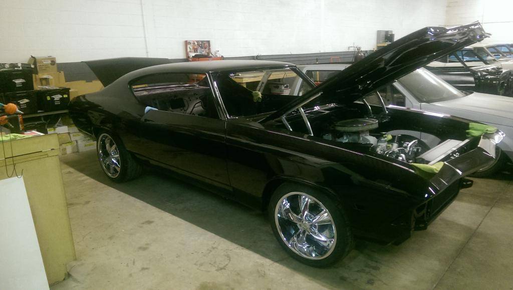

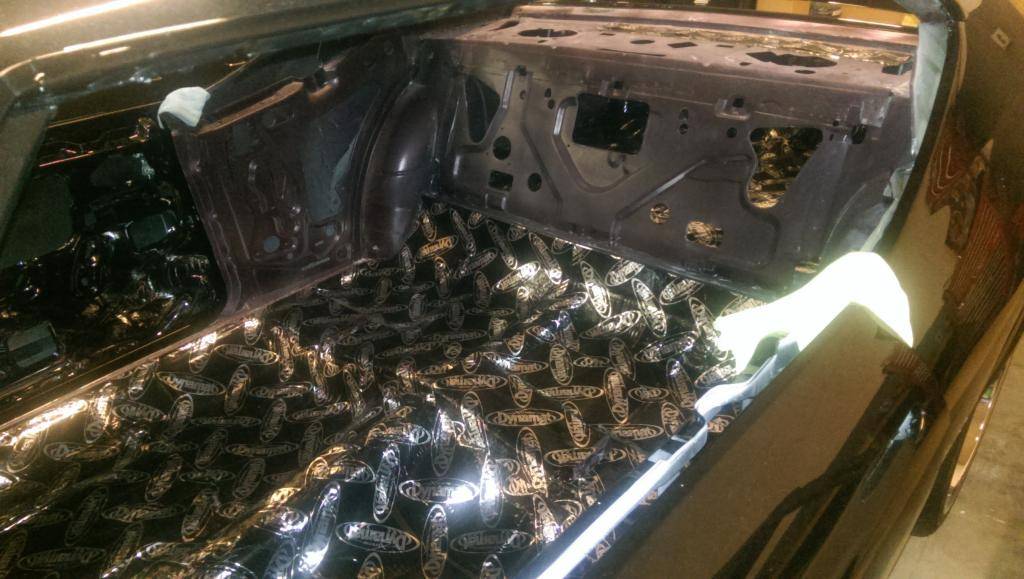

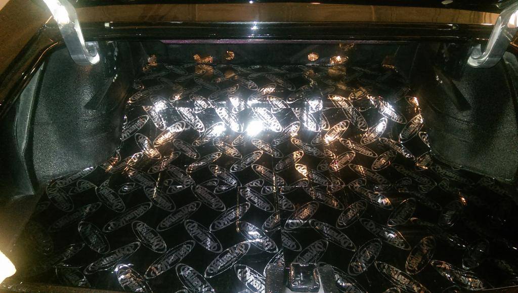

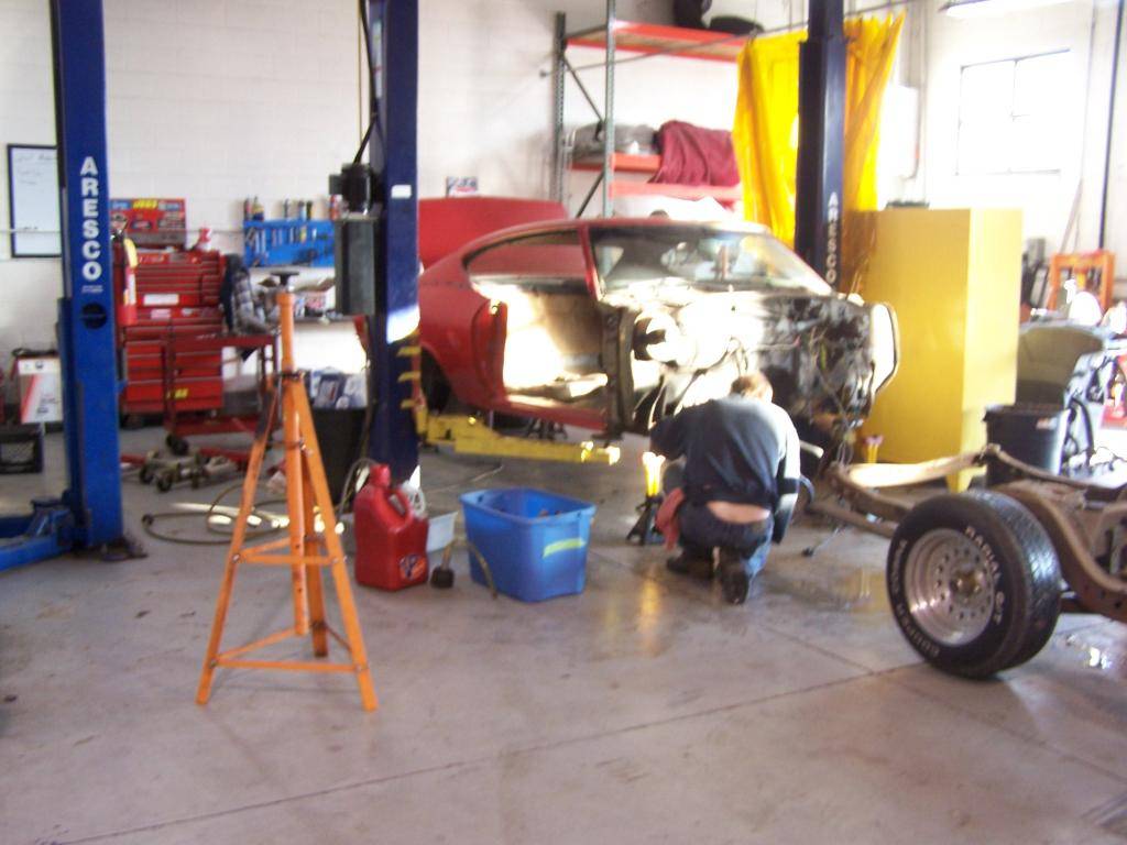

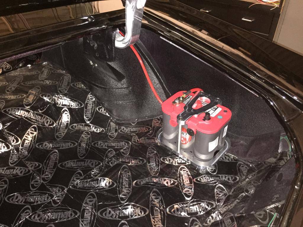

      Here are some pics as the car sits now at Sled Alley. Matt is working on the wiring now. Car will have power windows, locks and push button start.
      Black dynamat throughout
      Ride height has since been adjusted, rear wheels now slightly tucked.

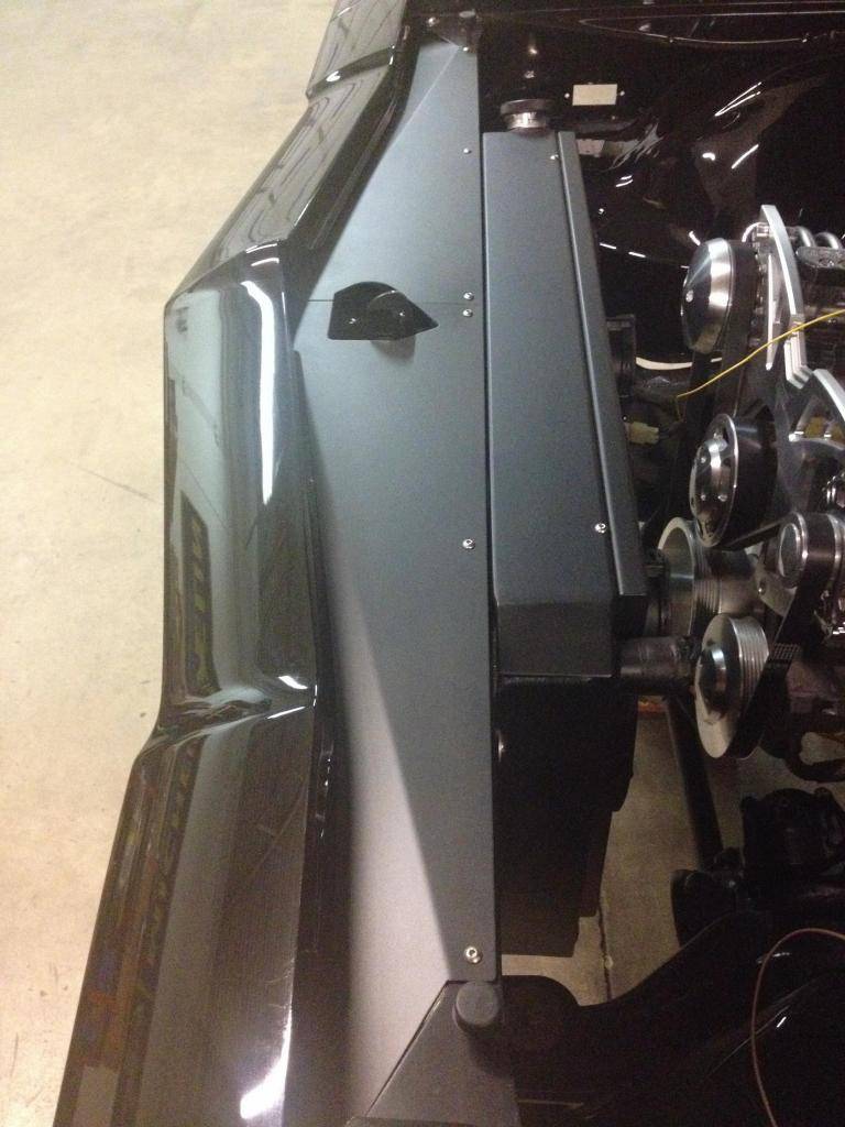

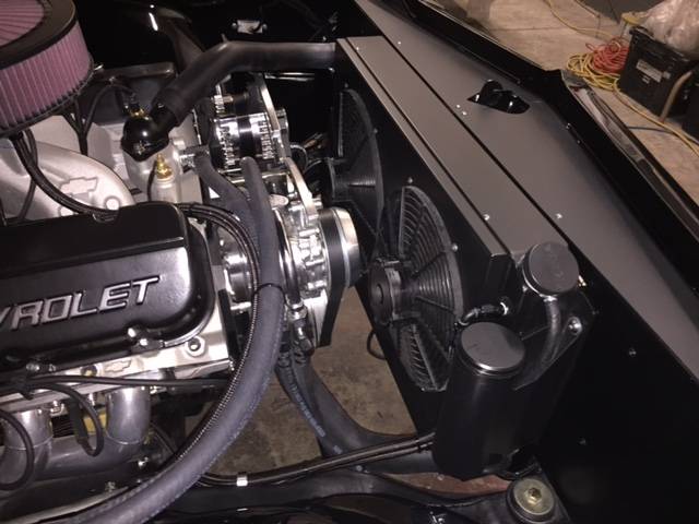

      Autorad radiator support and radiator painted satin black... Nice detail. Matt will measure for the new wheels once the wheel wells are bolted in.

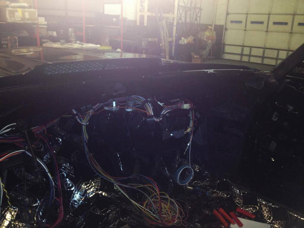

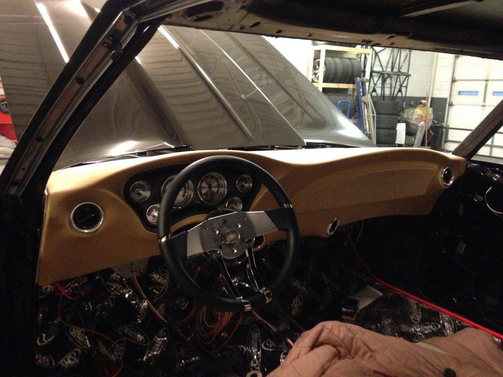

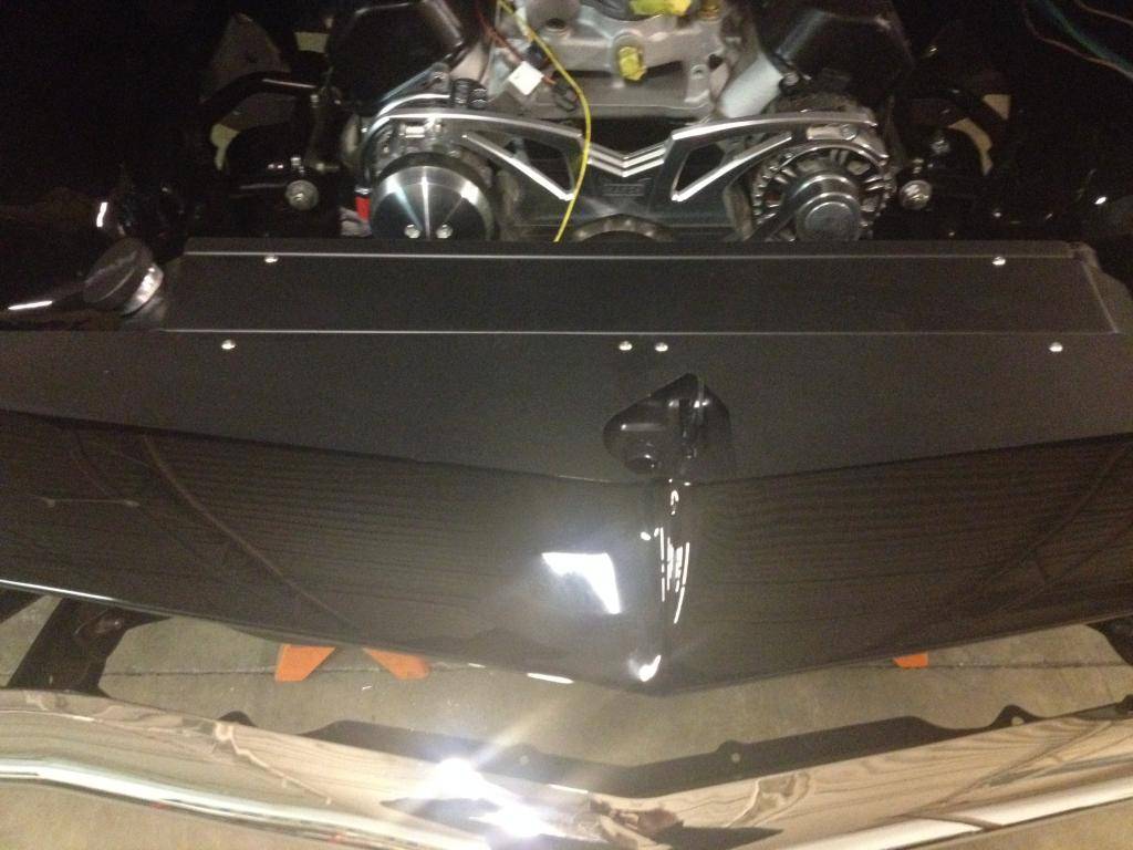

      A little progress has been made this week. Matt is spending plenty of time wiring the car and hiding some of the controllers for the EZ-efi, TCU and the push button start. The biggest obatacle will be the control box for the push button shifter.
      After some minor trim work, the Autorad closeout panel looks great painted satin black
      Wires seperated for optimal routing. DSE wiper motor

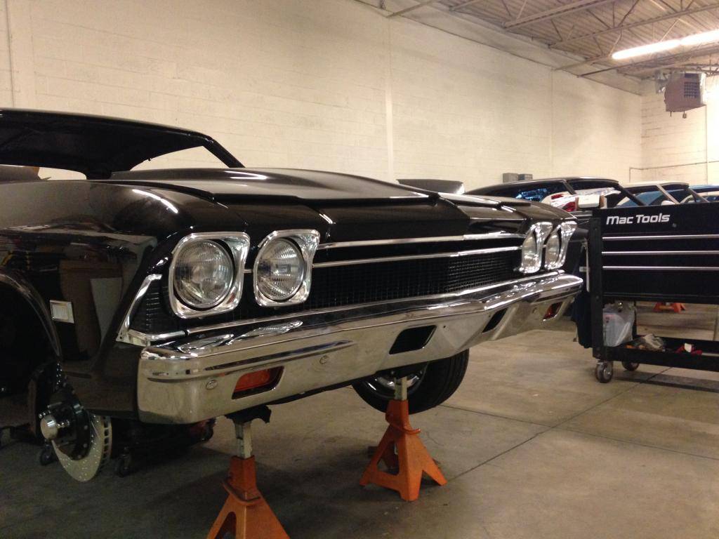

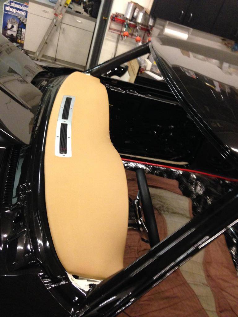

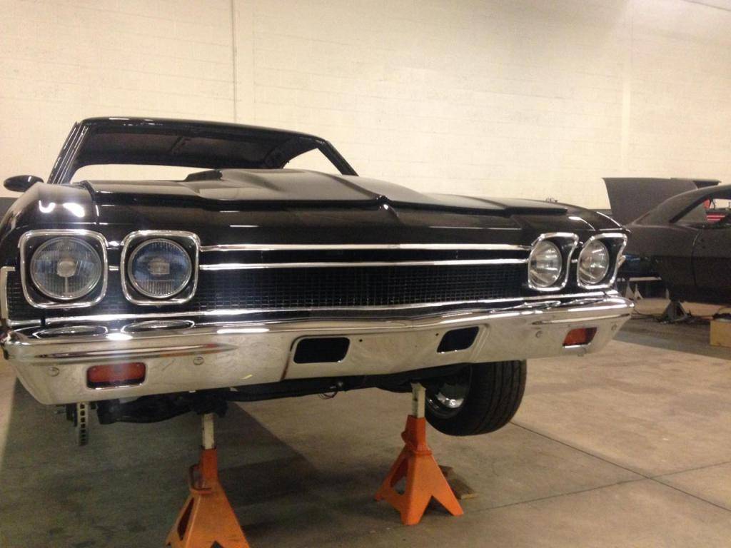

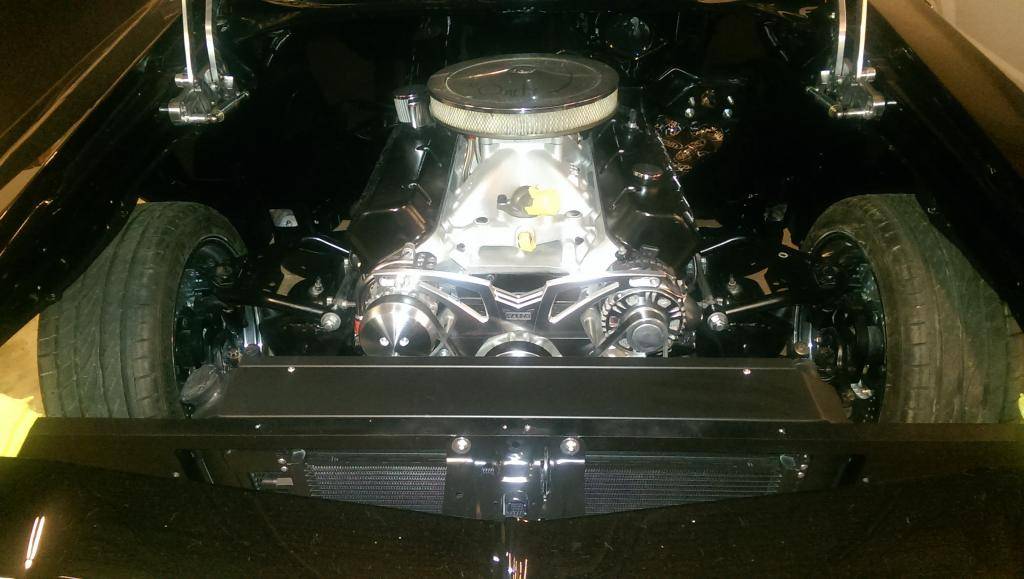

      The Chevelle is starting to make a little more progress now. Matt is finished Stielows car which was a priority since it had to be ready for SEMA and OUSCI. He's made more progress in the wiring area, battery installed in the trunk and front end completed. The engine compartment is also starting to come together.
      Front end will still get some more detailed touches.
      Painted the bezels black to tone down to the brightwork

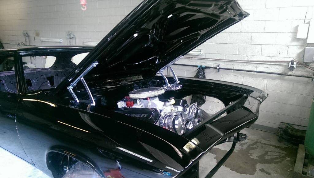

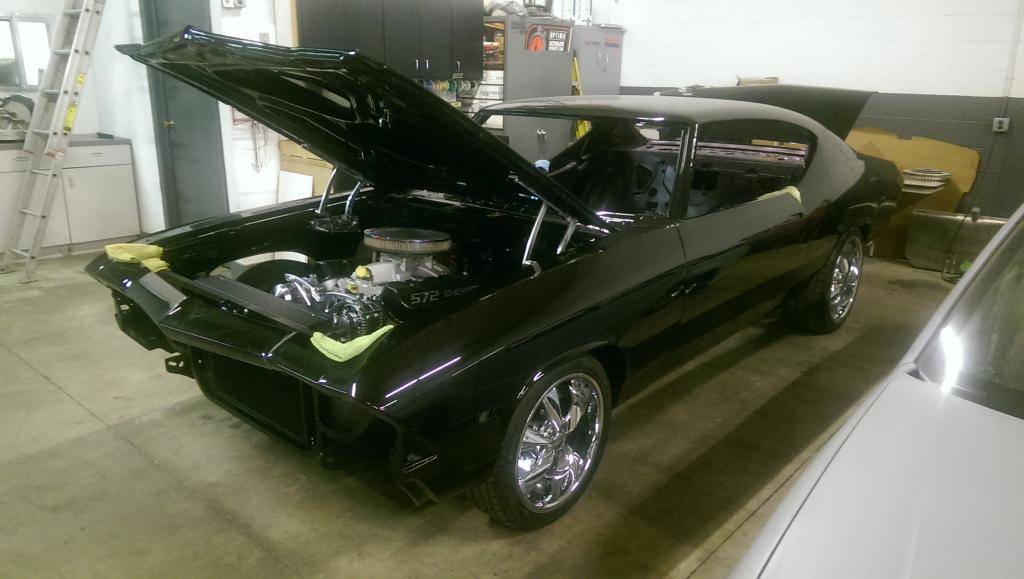

      Well, the build is still going... Matt is off to SEMA, but he did get some things done prior to leaving. He did a test fit of the dash. He'll get it installed so he can finish the Vintage Air setup and get the gauges installed.
      He also measured for the new wheels which will be ordered shortly

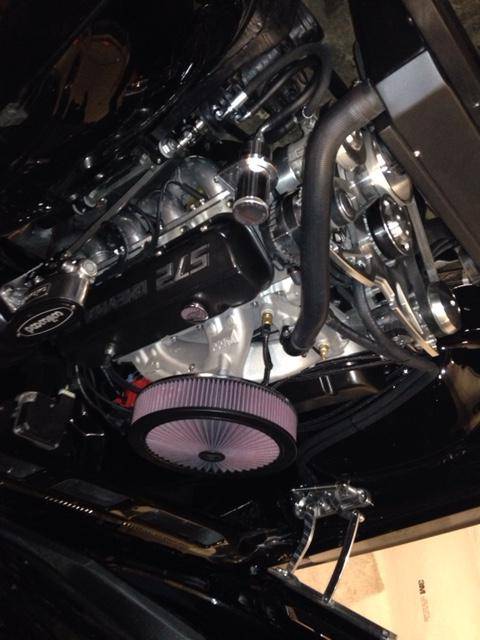

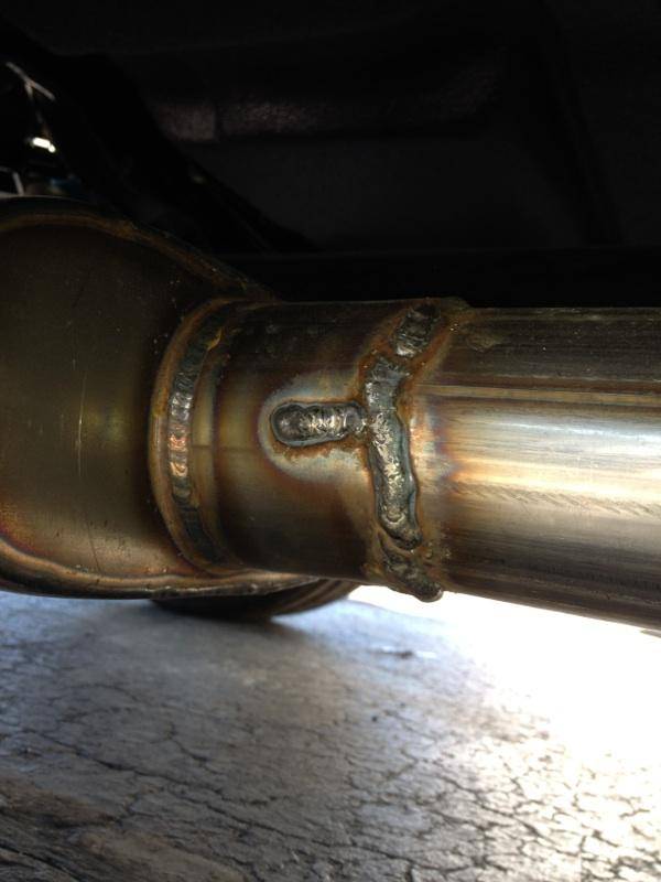

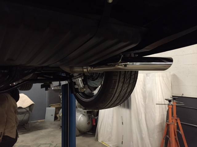

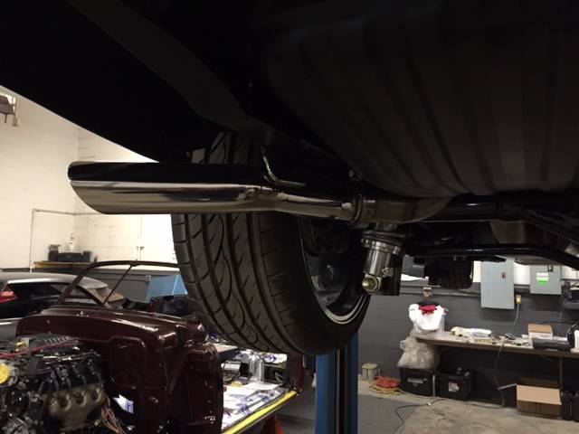

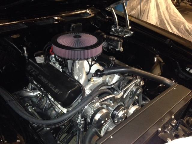

      Here are a couple pics of the cleaned up engine compartment and the finished exhaust.
      Hoses will be finished with shrink tubing.
      Diamond did a great job on the exhaust. We opted for v-bands at the muffler and the tip in case there is ever service needed that requires removal.
      Polished the stainless out for a more finished look
