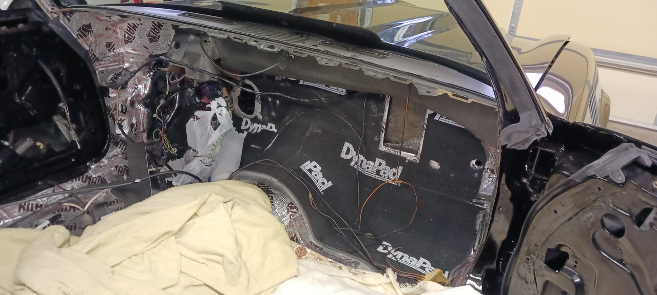

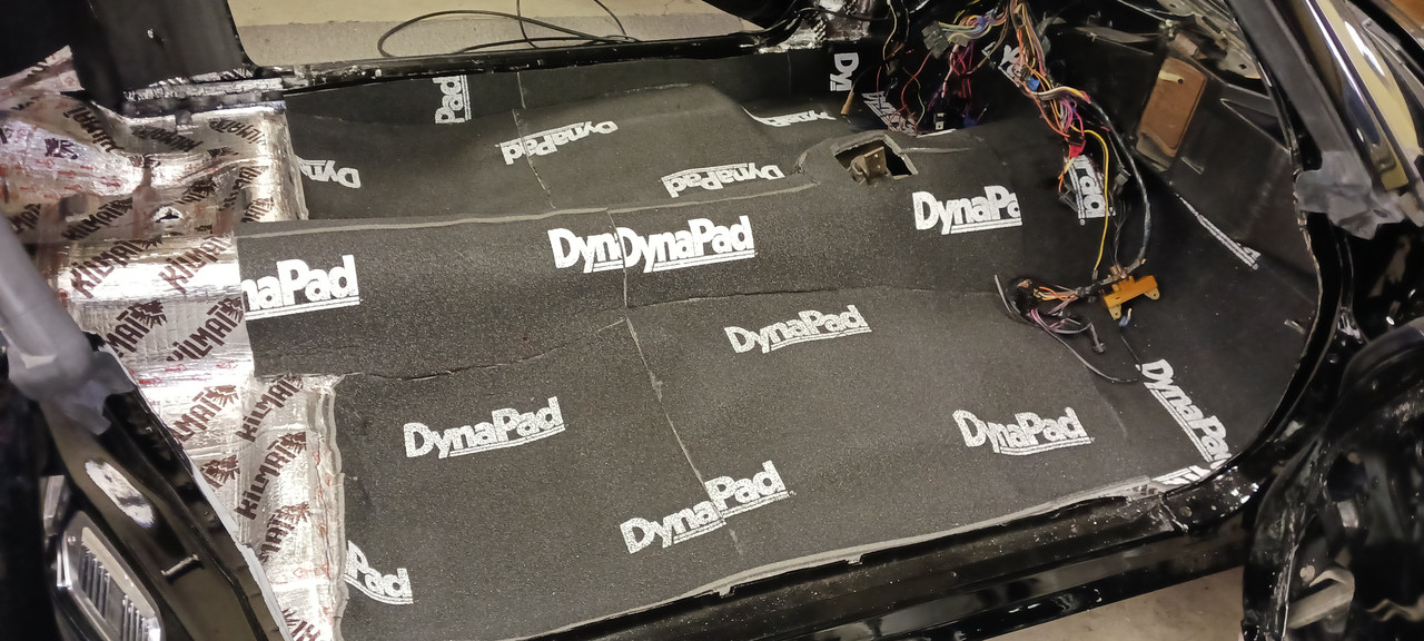

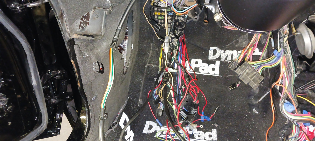

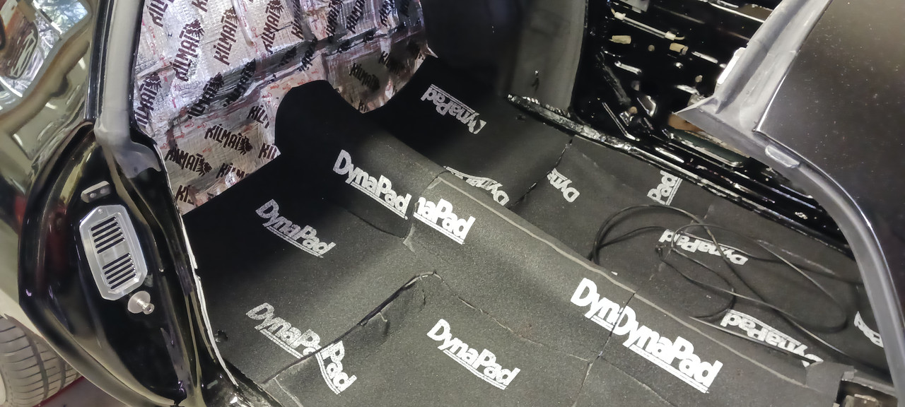

      Made some progress with the Kilmat. I wanted to get the firewall done so I can get the Dynapad and Dynaliner installed. That way I can get the heater box back in.
      Then I can move on to the rest. Working on putting on the foil tape to seal the seams. I went a bit far with the Kilmat but I wanted full coverage.

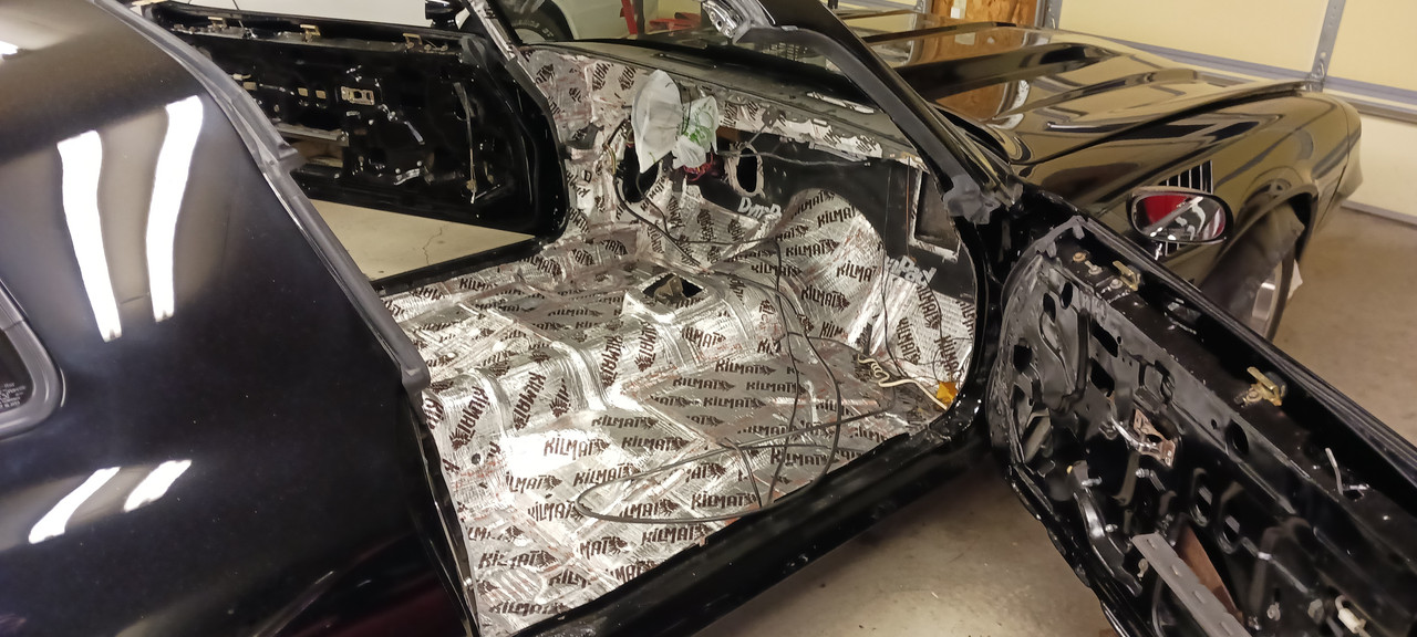

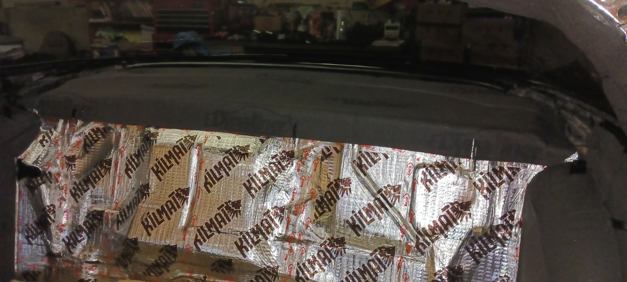

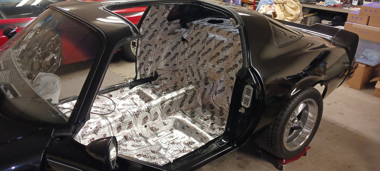

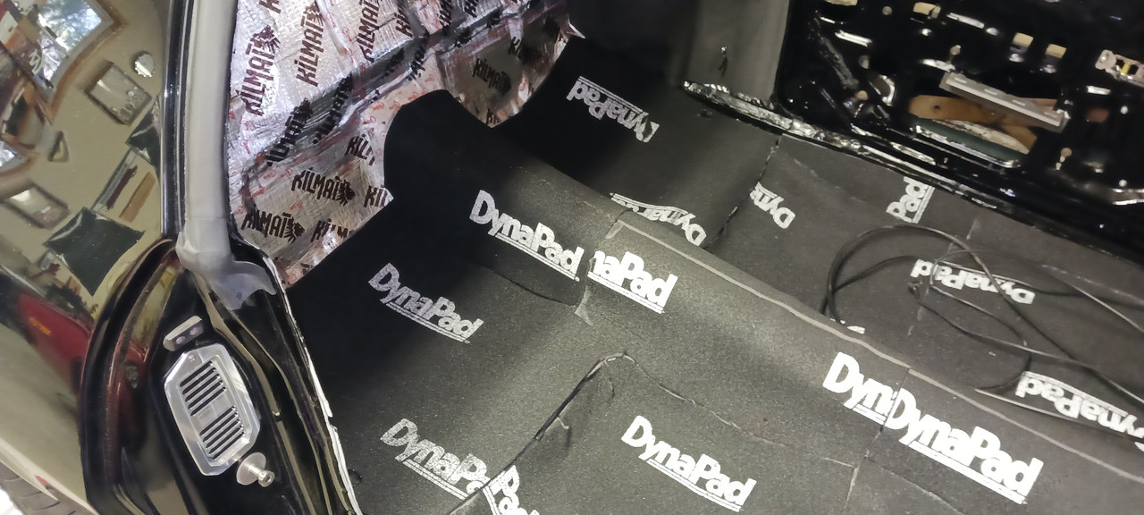

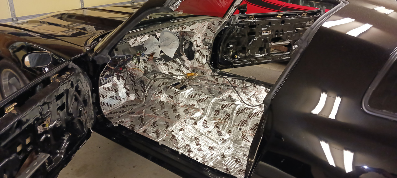

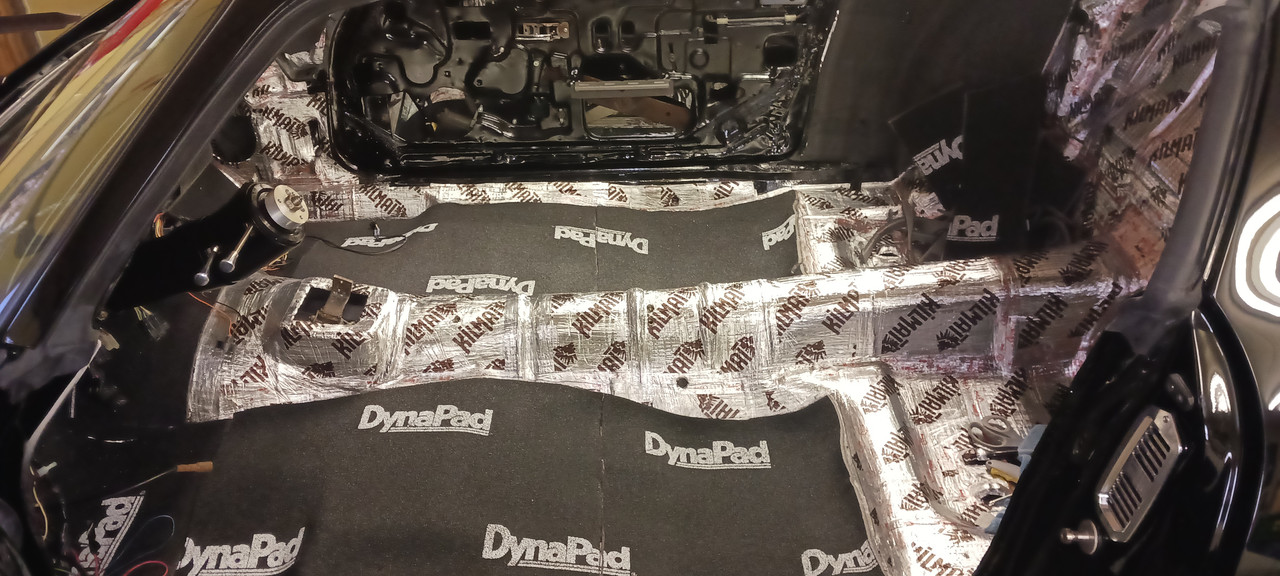

      Finally finished the Kilmat installation in the interior. Working on installing more Dynapad next.

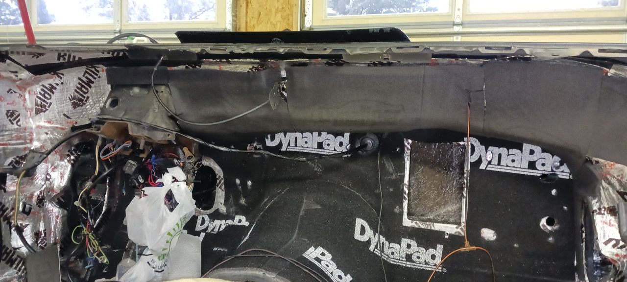

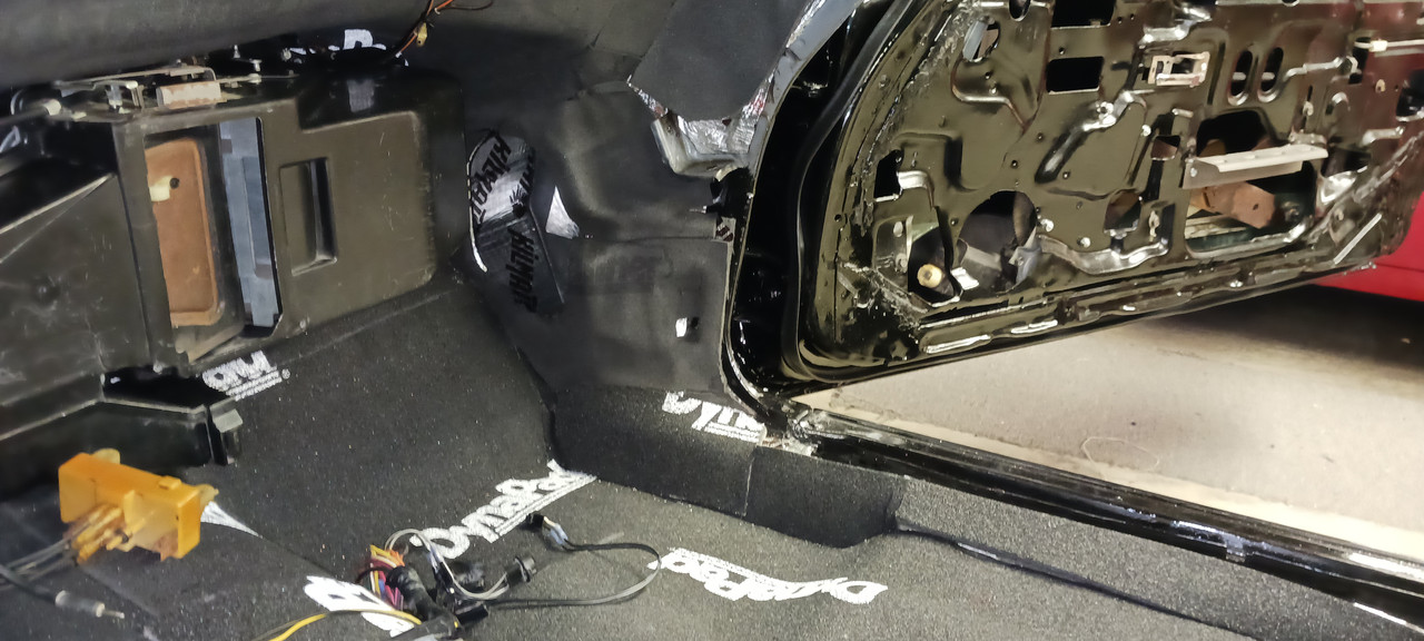

      Started installing the Dynaliner in the upper part of the dash before putting the heater box back in.

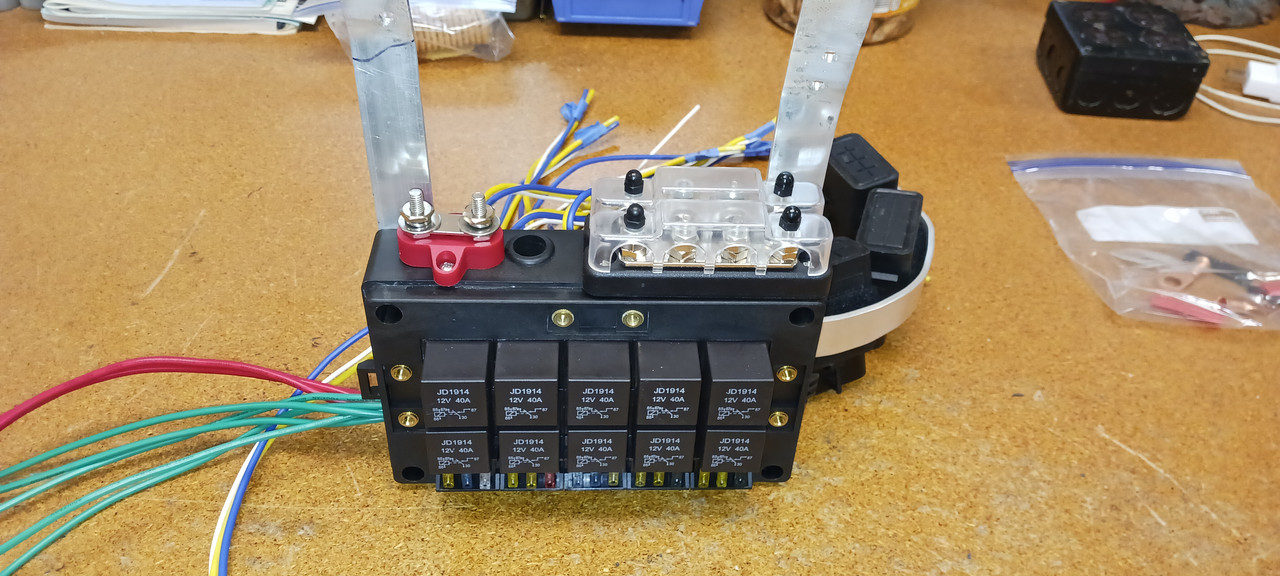

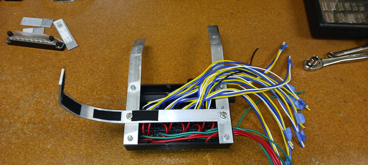

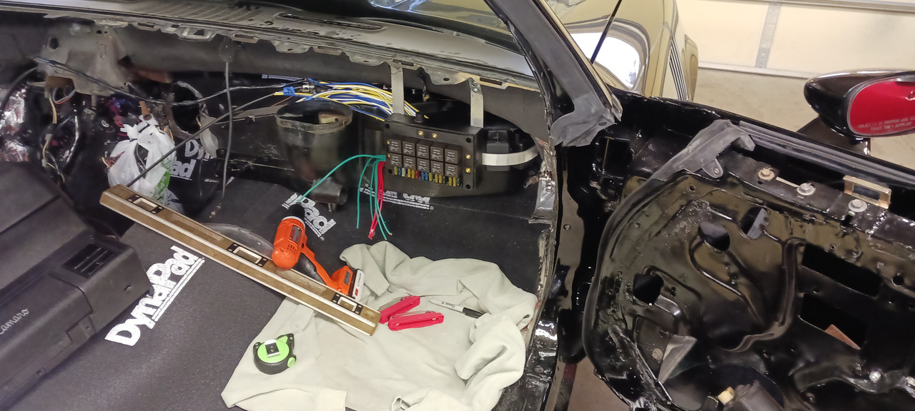

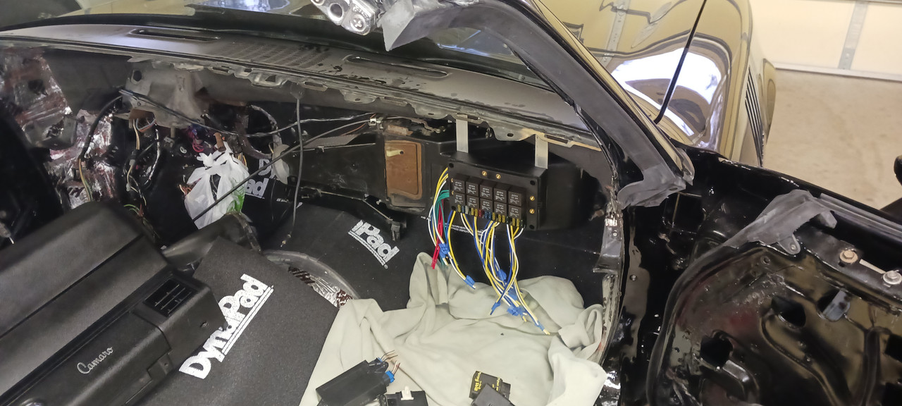

      Just a little bit of an update. I have been working on mocking up and making brackets for the second relay/fuse panel for all of the extra stuff I want to add. I also got my hands on a tilt column that I have been rebuilding as well.

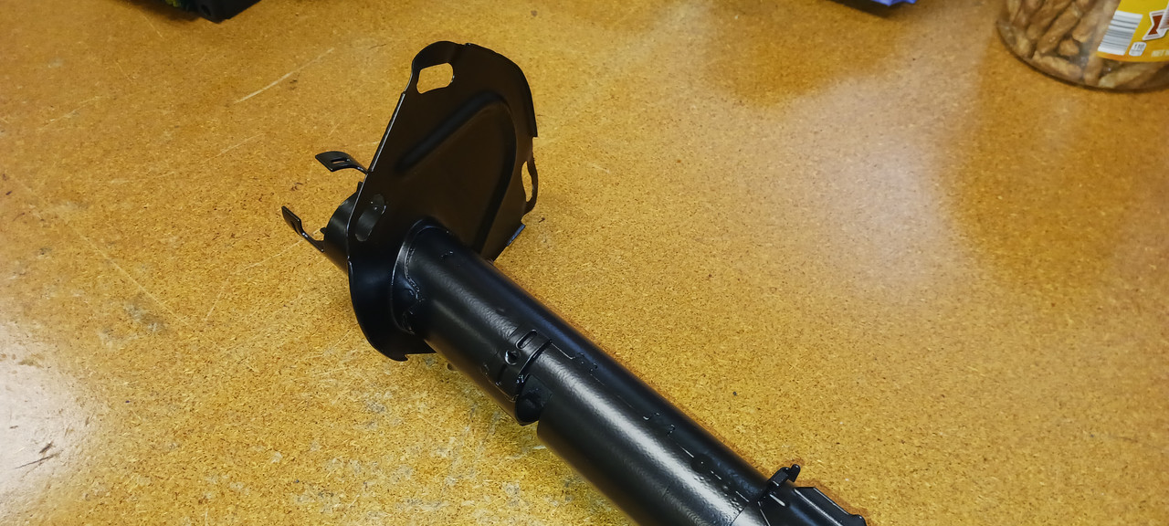

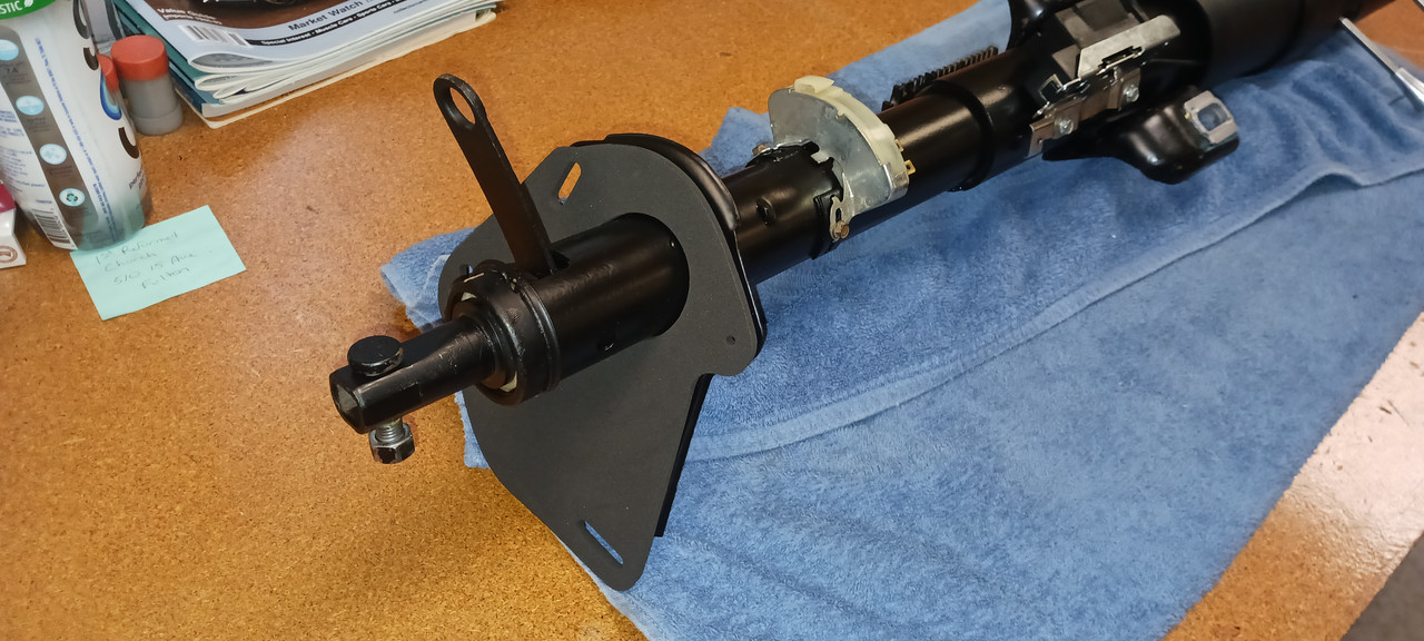

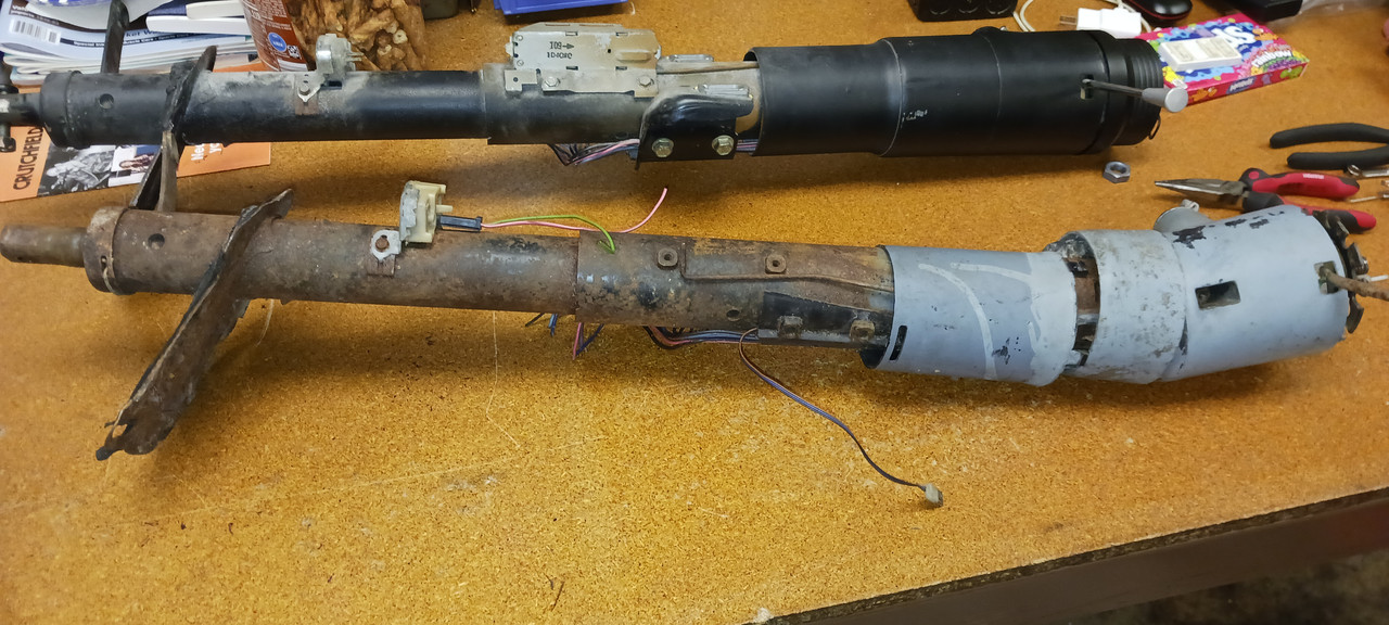

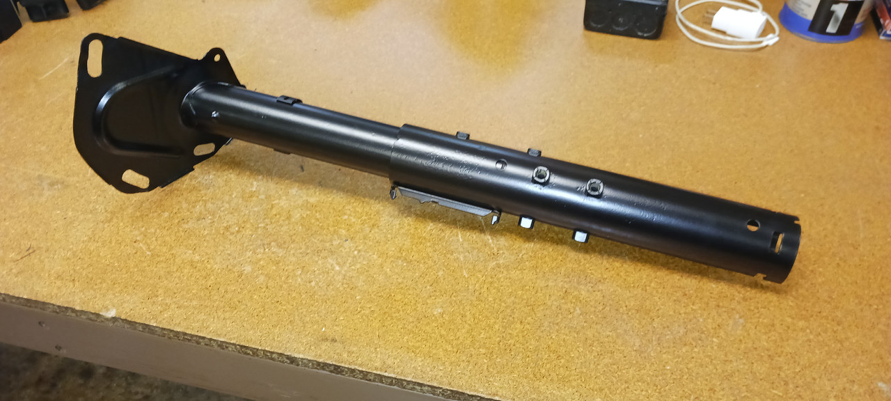

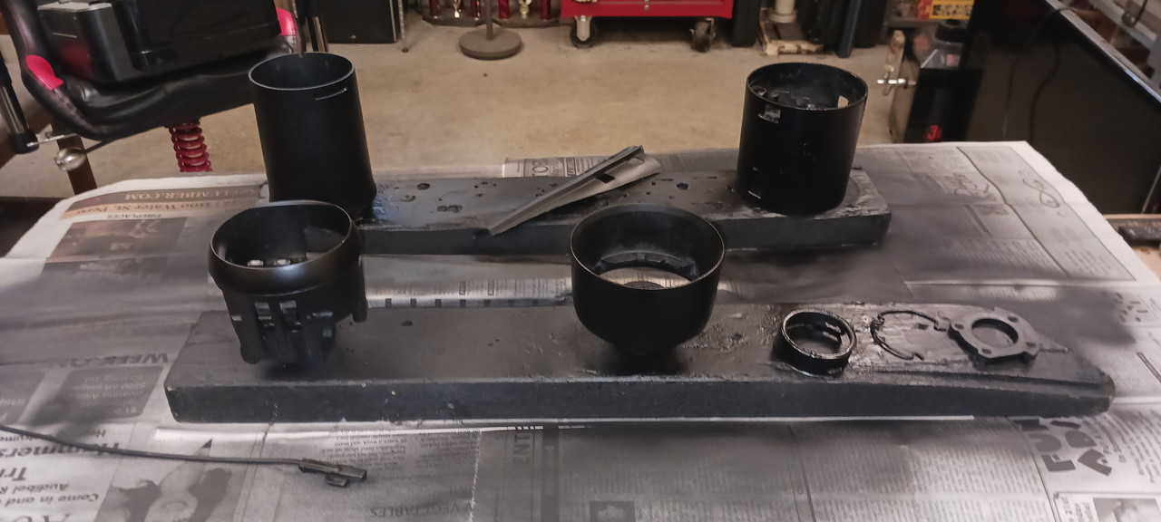

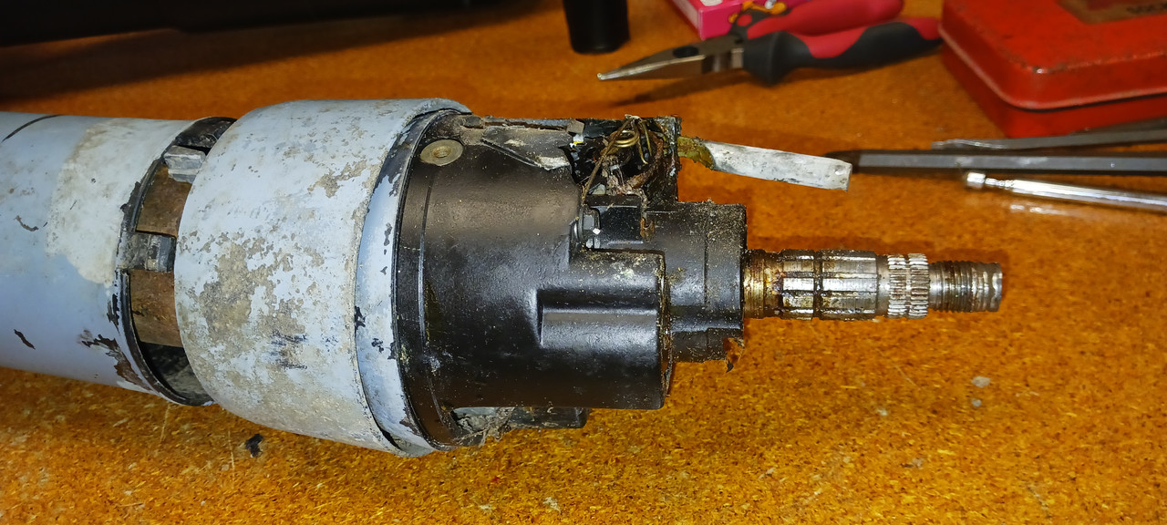

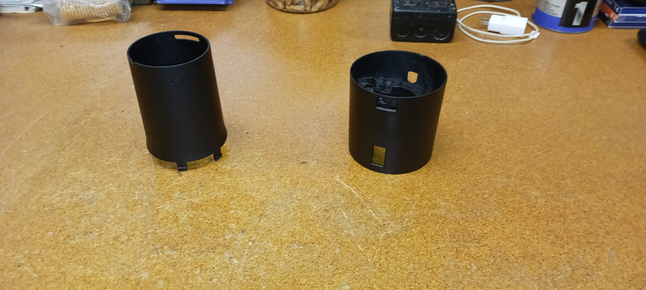

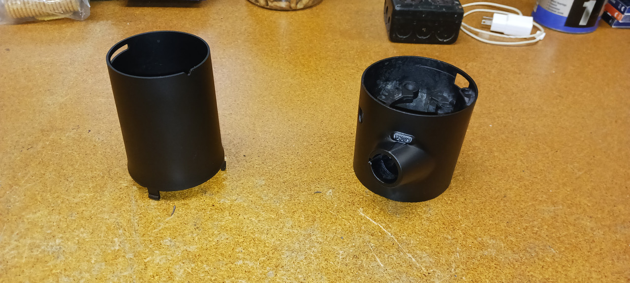

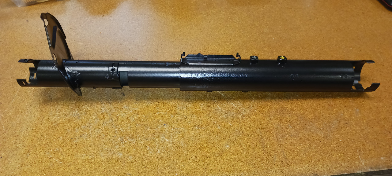

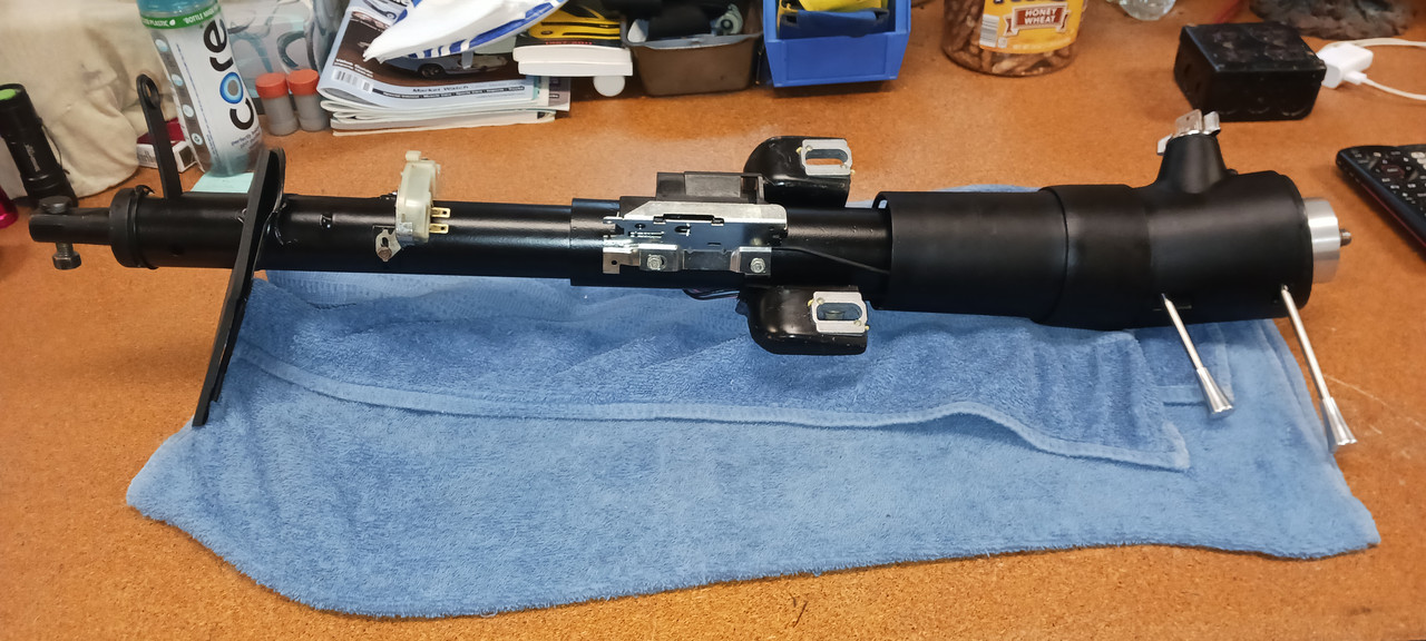

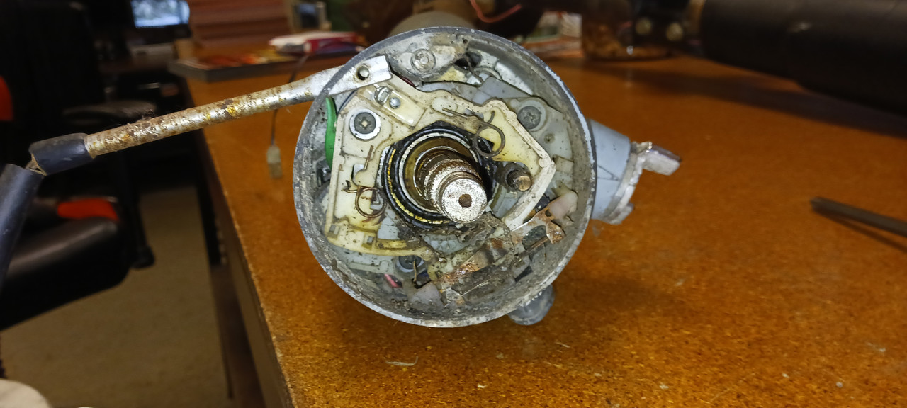

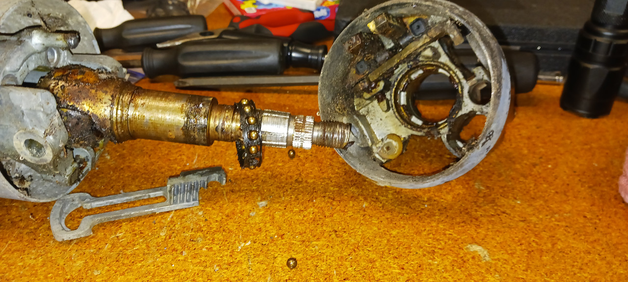

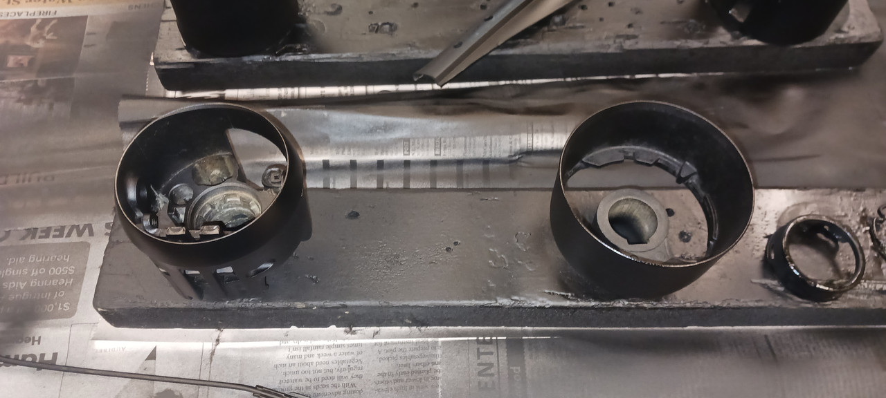

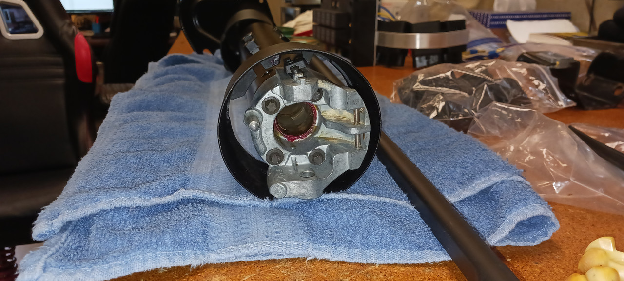

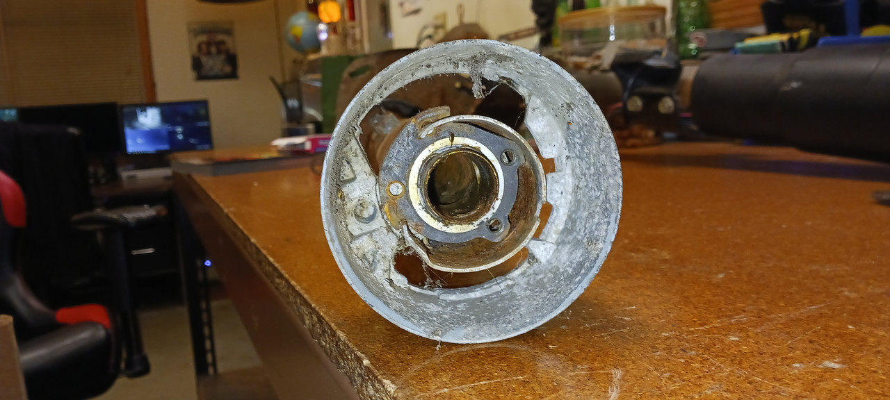

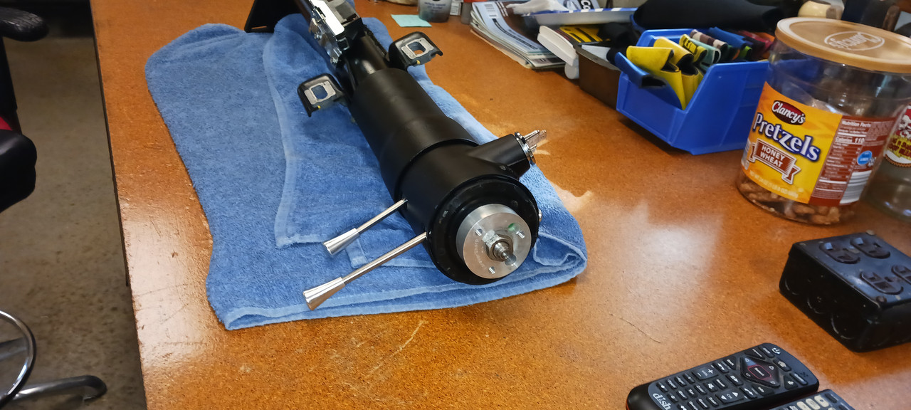

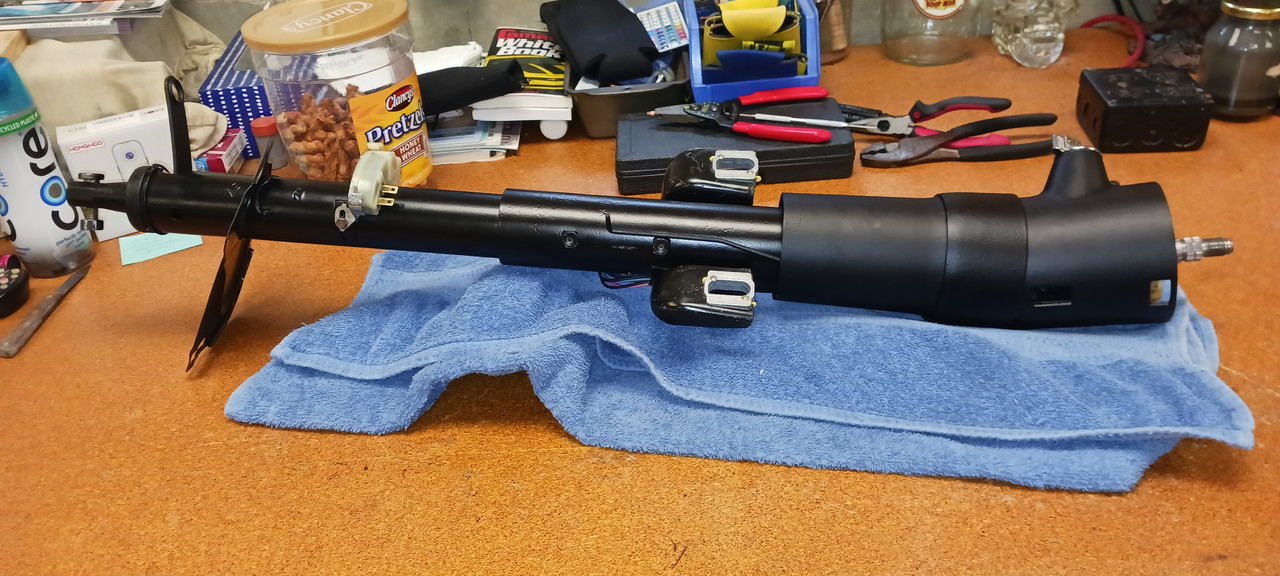

      I have the column all done except that I had to replace the turn signal cam which is now done and the levers I bought were not right for this column. I also found out that the tilt and non tilt ignition switch on the steering column are different so I had to get one of those on order. Should have it done this week. Here are some pictures of the assembly of the reconditioned column. I had the main piece of the column blasted and powder coated.

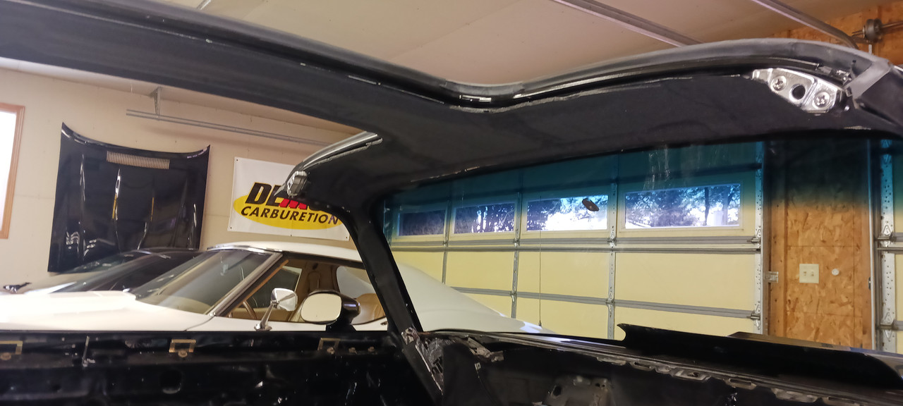

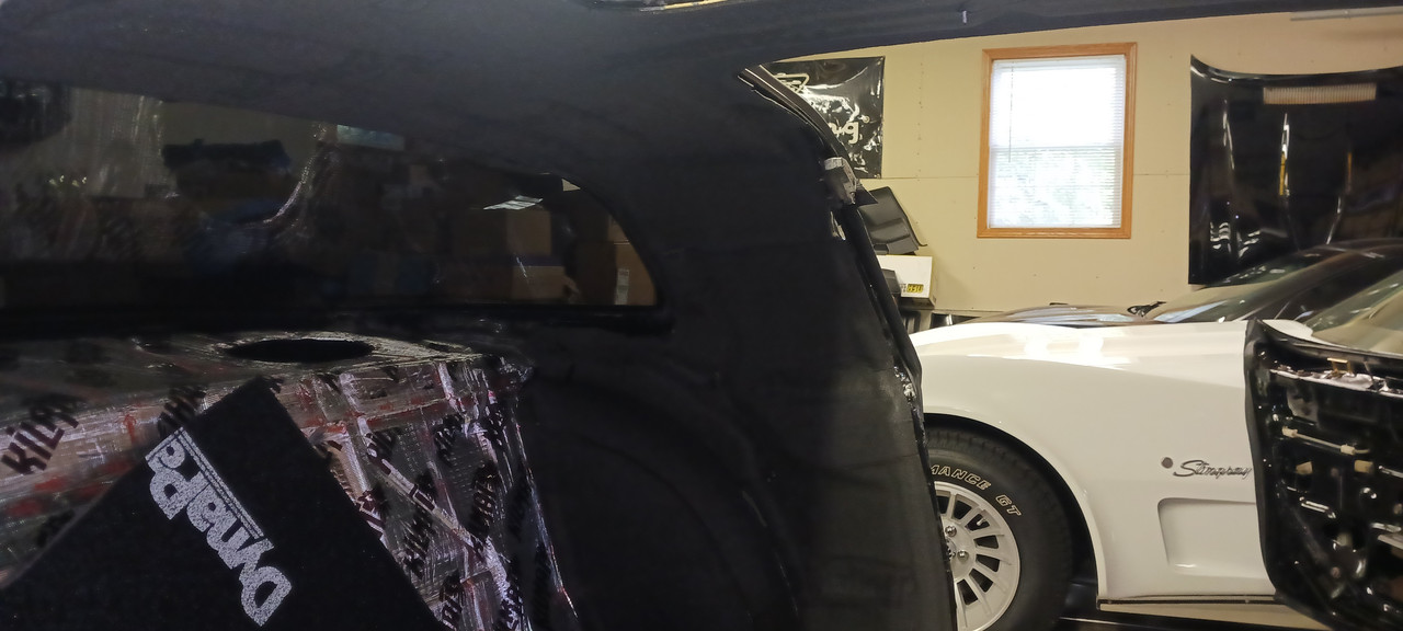

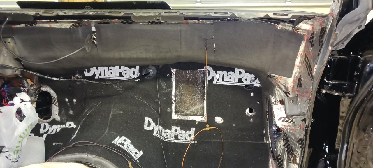

      Steering column is finished and ready to go back in the Camaro today. I finished with some more of the Dynaliner on the rear sides, roof and pillars.

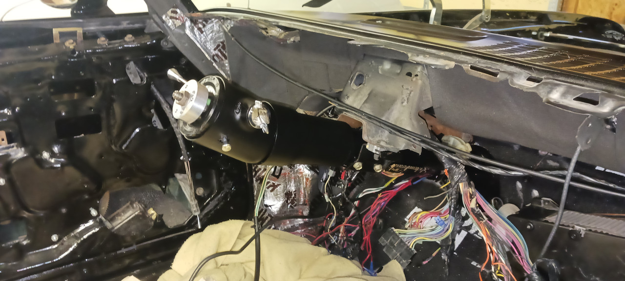

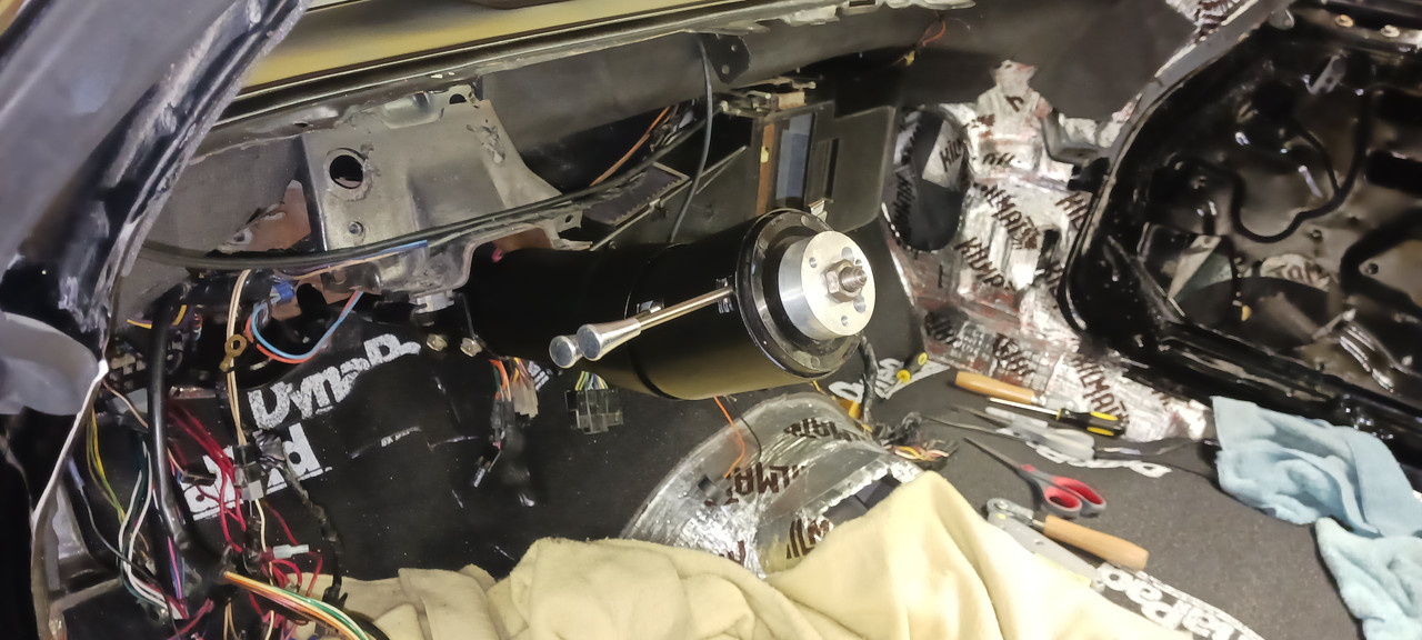

      Steering column installed the other day. It will sure be nice to have a tilt in the Camaro finally.

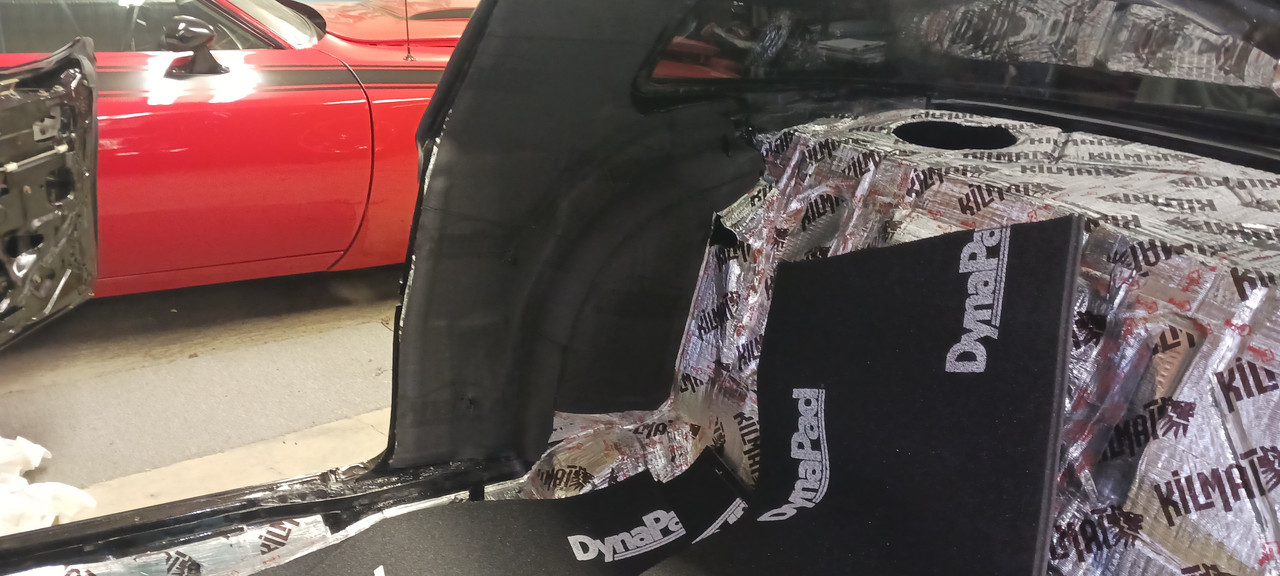

      Got some more progress with the floors and finished the kick panels and rear package tray.

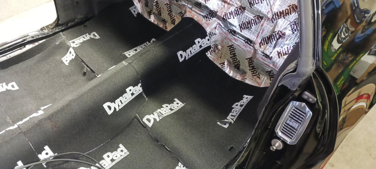

      Finished up the floor and tunnel. Just have the back panel to do and the interior should be finished with the sound deadening. Still have the trunk to do at some point.
