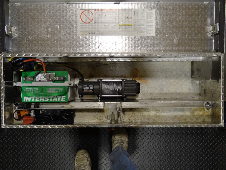

      I repurposed an old side truck box onto my open trailer...and put my harbor Freight 5000 pound winch and battery inside it to protect them.
      It works great plus gave me a plus to keep my straps, gloves, wireless remote for the winch and anything else I might need to secure with the trailer. The battery is wired for a backup on my electric brakes and the truck charges the battery when rolling down the road. The winch drug a full sized 4x4 C10 up onto the trailer with one of the brakes locked up just sliding the tire with no trouble at all.

      That's a pretty nice setup, Lance. We have a perch on the trailer for the winch already but I suppose I could torch it off and do something like this. I like how it conceals and protects everything.

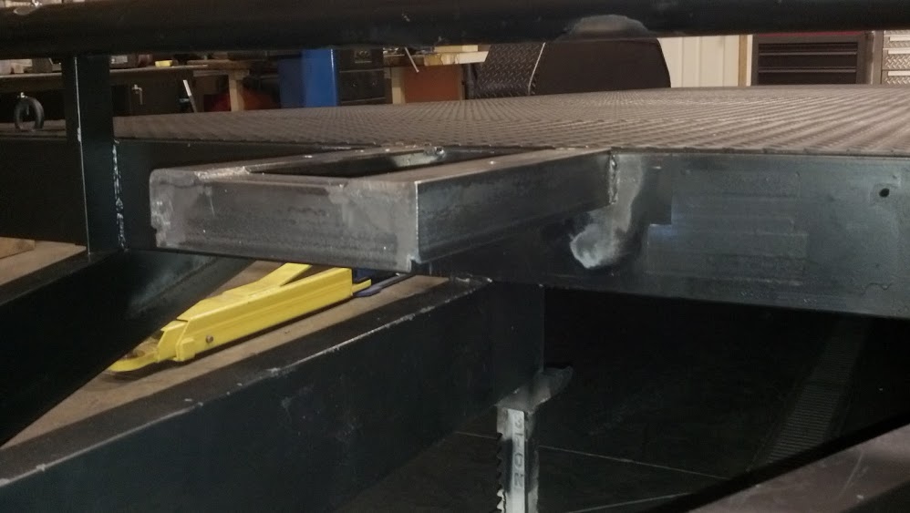

      I built this perch for under the box
      The winch is bolted to it through the bottom of the box. I put another brace on it to the tongue which you can kind of see here.
      It supports the box and the winch and gives the winch a strong point to pull from. The whole setup works pretty well. I like the winch too, it'll free wheel out or winch out to unload, and winch in. The wireless remote works well too. You probably only need a 2500 pound winch, but since this was a "cheaper brand" I stepped up to the 5,000 pound version. I think I paid about $250 for it on sale at Harbor Freight.
