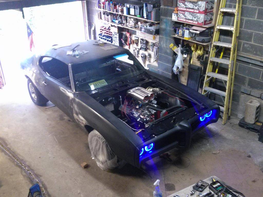

      here is the pic of front wheel without shims
      here is a pic of the car

      That's 2 Degrees negative.
      edit:
      That's a tongue in cheek reply, that i'd bet Dr Pepper is pretty close. IMO 2 degree will handle great with everything else in order, but you need to be real friendly with your tire dealer, tires get eaten up quick, not sure if from alignment, or the constant need to reform that grin that pops up after every hard cornering application. I don't see anything over 3 neg on the street, and at some point braking starts to decline, and not a great tradeoff again, IMO for street manners
