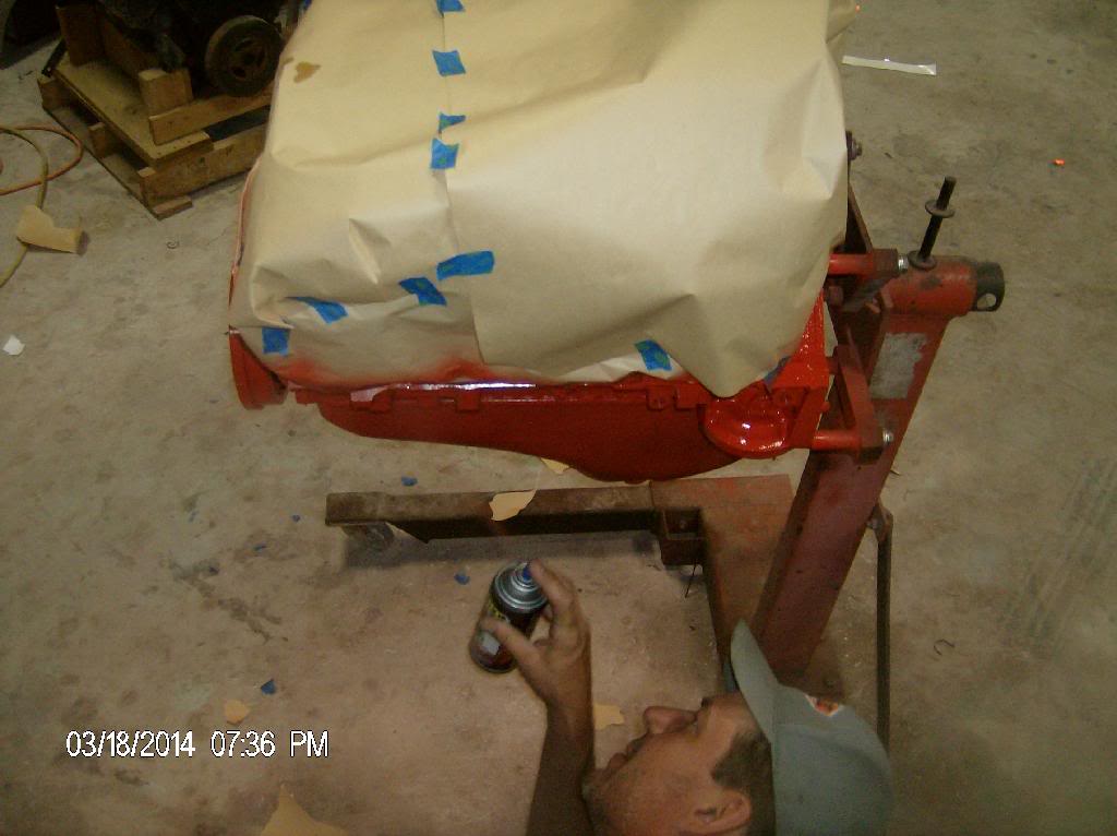

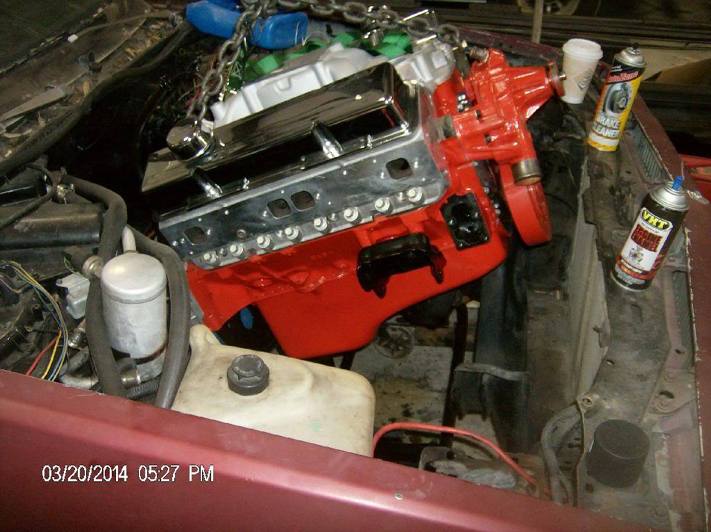

      First, the BluePrint 385 Stroker had to be painted, so I went back with the original red orange color as before, but I've added a little chrome to bling up the engine bay.

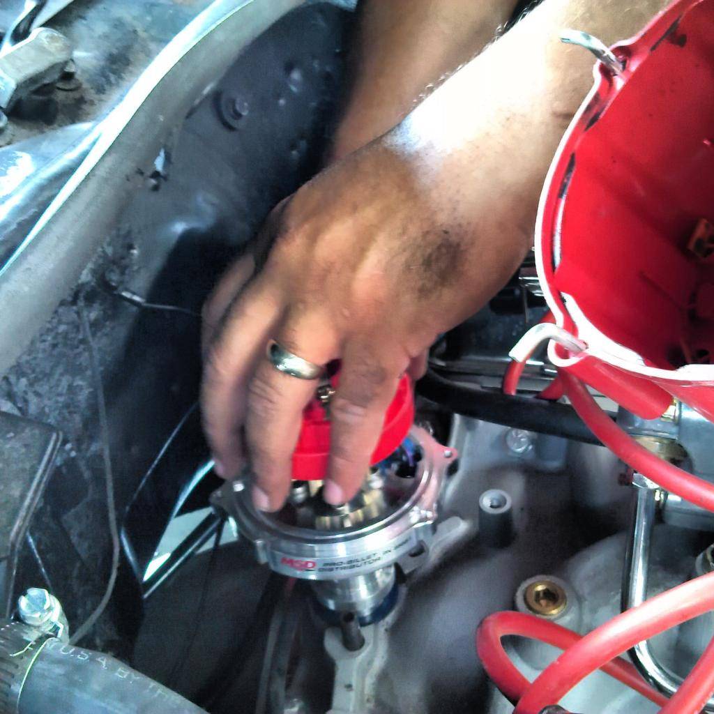

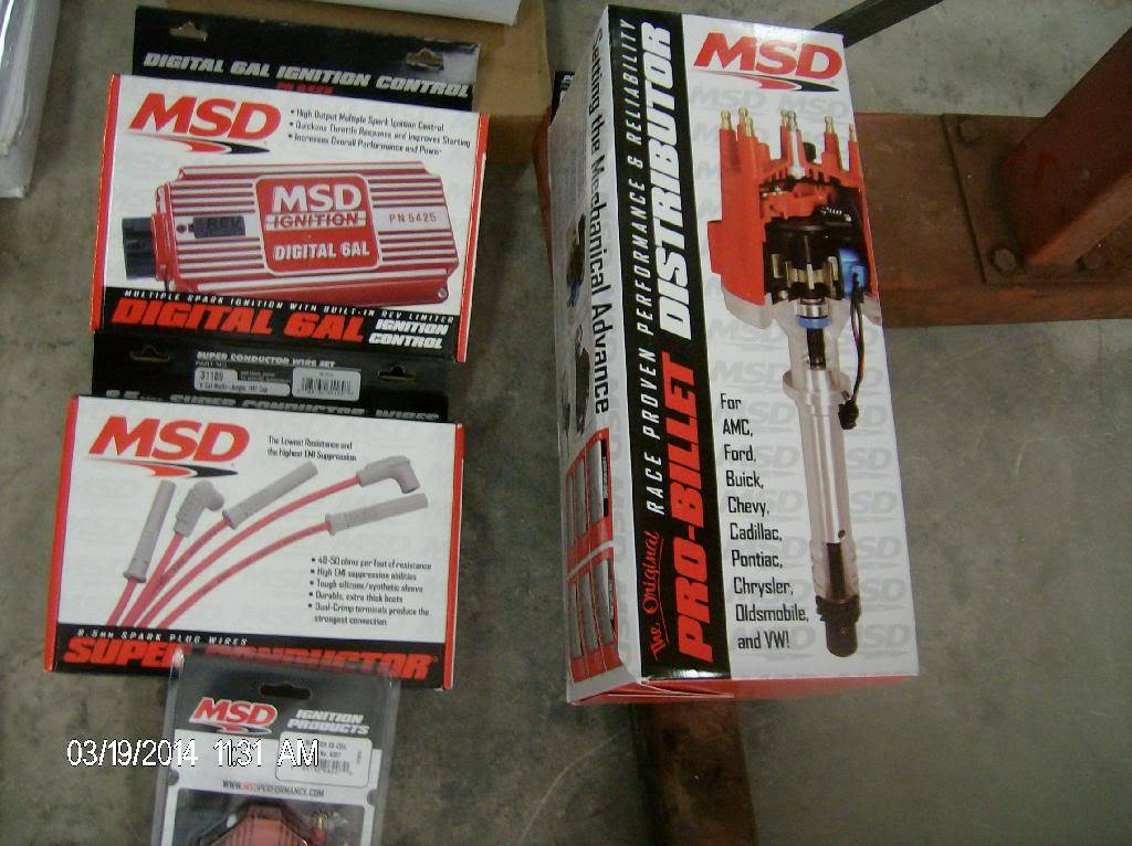

      I was stumped on an ignition system, so I had to do research on what's available and reliable for street/strip use and I can depend on for years to come.
      After weeks of research, I went with MSD Ignition's Digital 6AL with the built in rev limiter and Pro-Billet distributor.

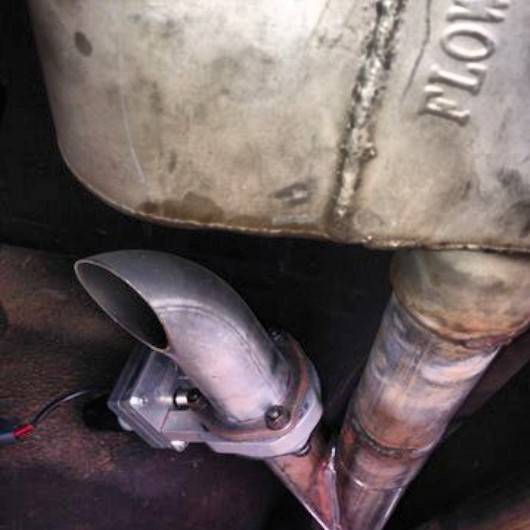

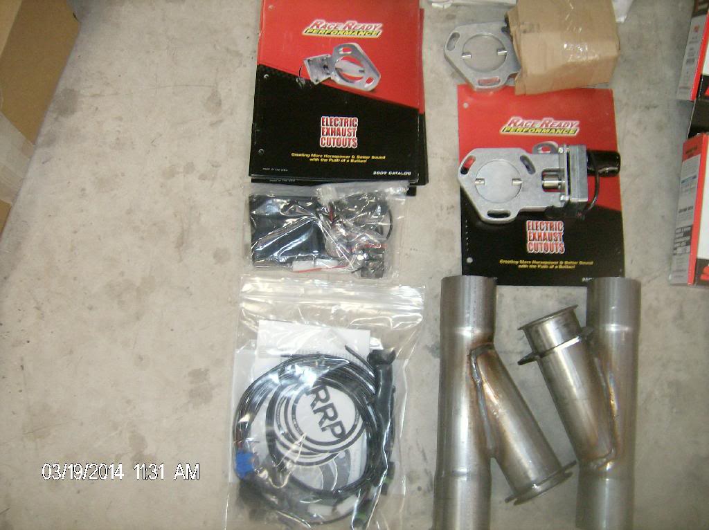

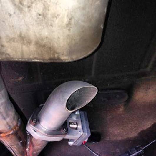

      Since were trying to vehicle as a sleeper, I had to contact Race Ready Performance here in Texas for some of their electric cutouts to not only increase exhaust flow, but to get a few horses.

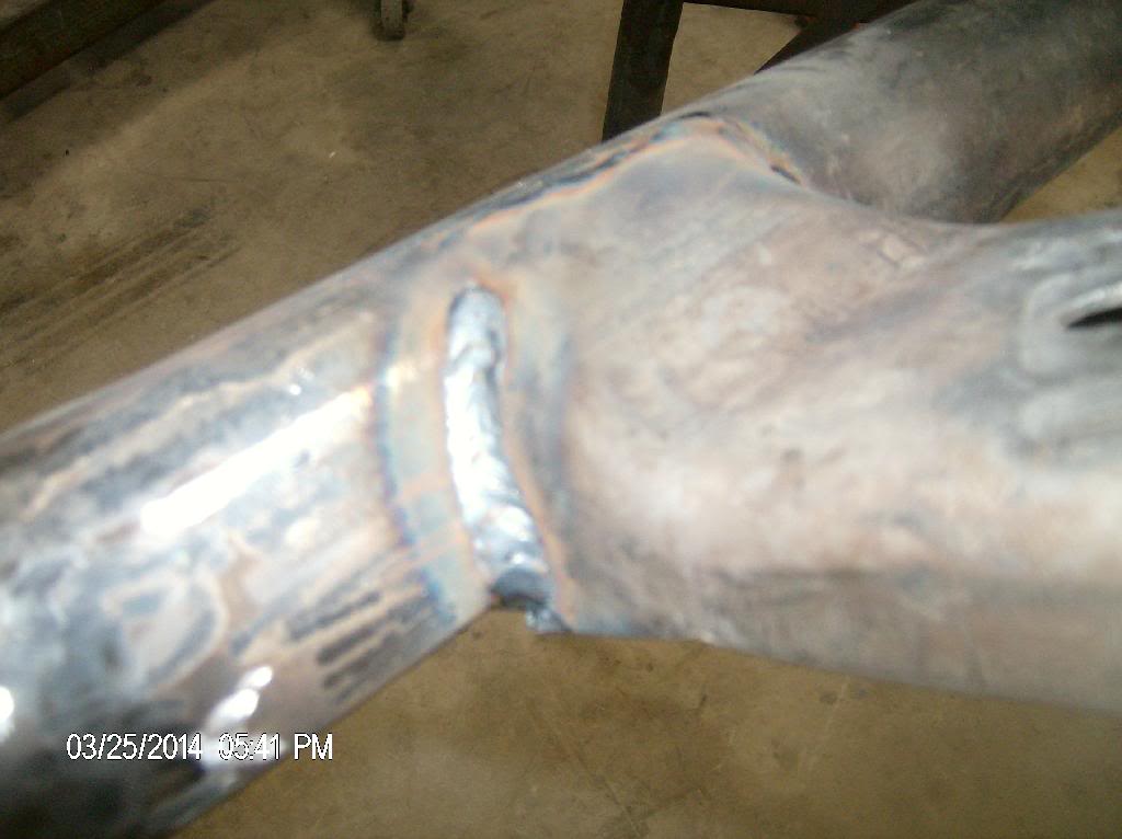

      Fast forward to the drivetrain install, we ran into a problem.

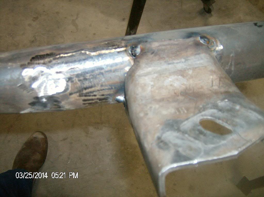

      The stock crossmember wouldn't work with the 700-r4 transmission, so it had to be modified & moved back a few inches.
      (Due to budget, it was fabricated.)
      NOW, shes in!

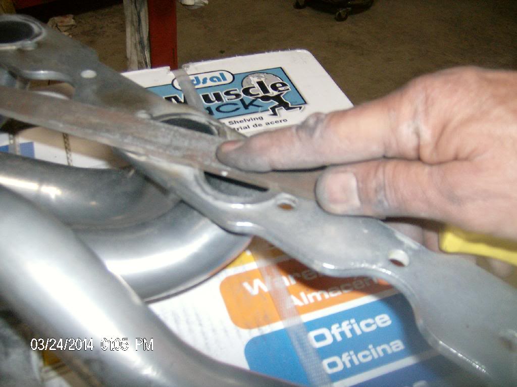

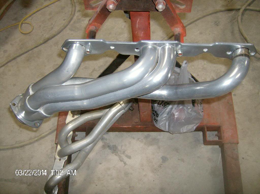

      The ceramic coated headers needed to be cleaned up since they've been sitting for a while.
      Also, filing down the flange helps reduce gasket leaks.
      Got the Race Ready Performance Electric Cutouts installed.

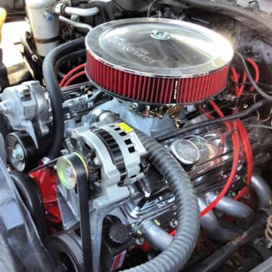

      This is a pic of the BPE 385 installed. This shows the old HEI distributor.

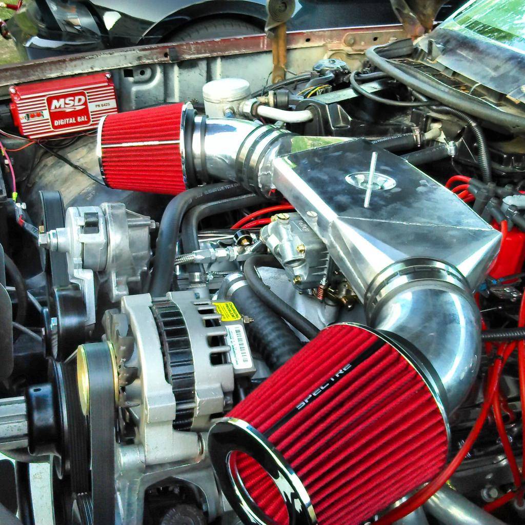

      And THIS is the final stage of getting the engine bay done!

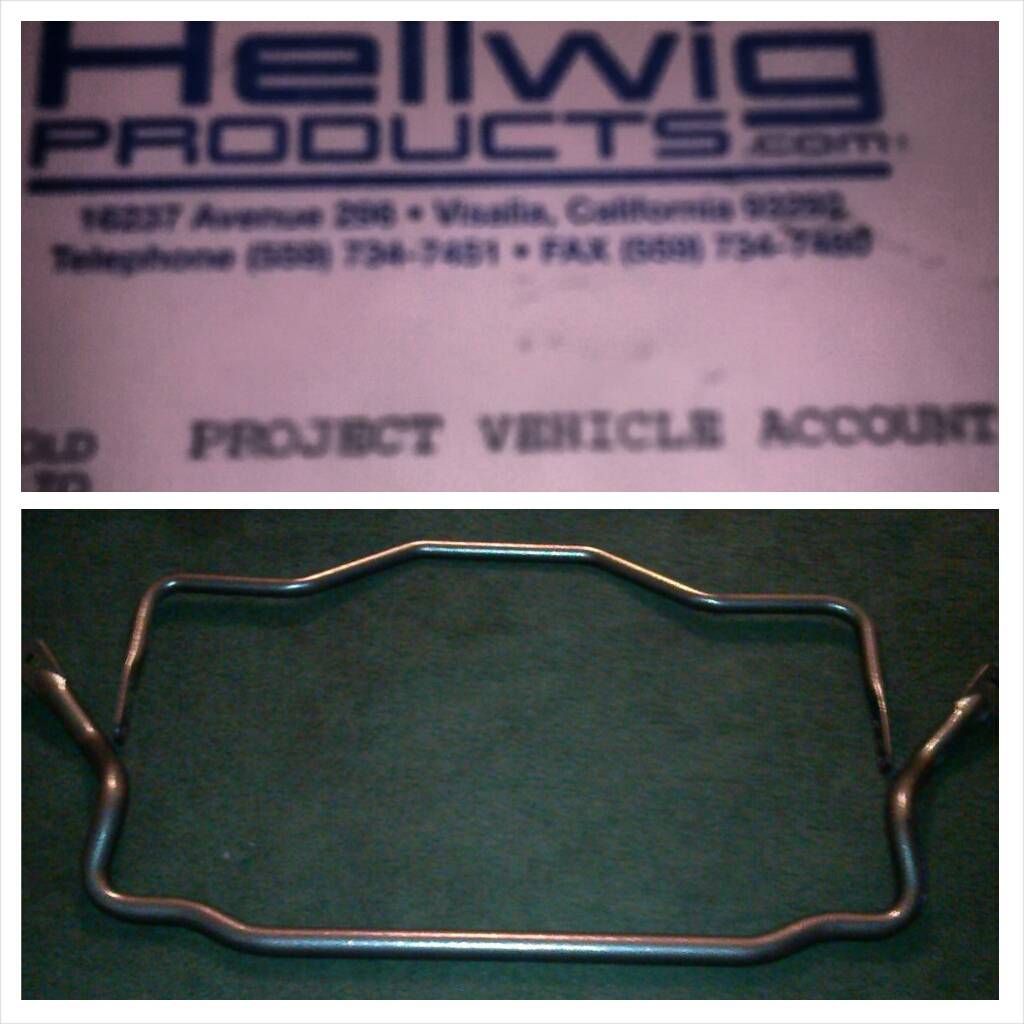

      Big Front Pro Touring sway bar and adjustable rear sway bar.

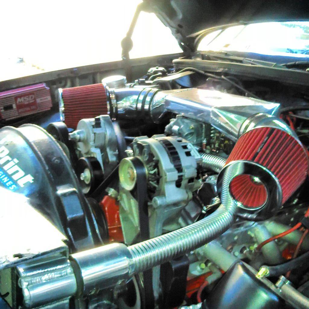

      It's been a while since I've been on, so here's the updates.
      I've finally gotten the engine bay halfway decent with the engine and MSD Digital 6AL dialed in exactly where I want it.
      It took some beating and fabrication with a BFH to get my seats mounted be my buddy and I got them in.
      I've also decided to remove the old school rallies and replace them with my black 17 inch Cragars.. Fronts are 17x8(246/46/17), Rear are 17x9(245/45/17).
      This picture is from a photoshoot I did for my sponsors BluePrint Engines and BOOSTane.
