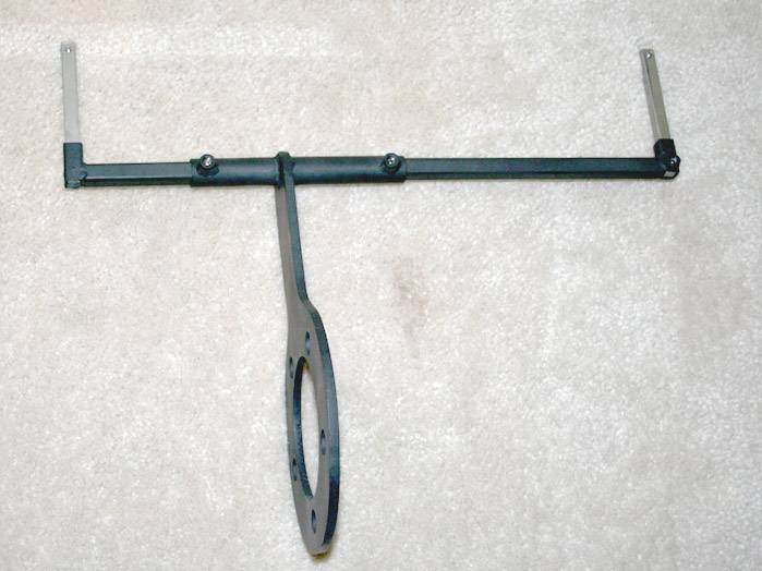

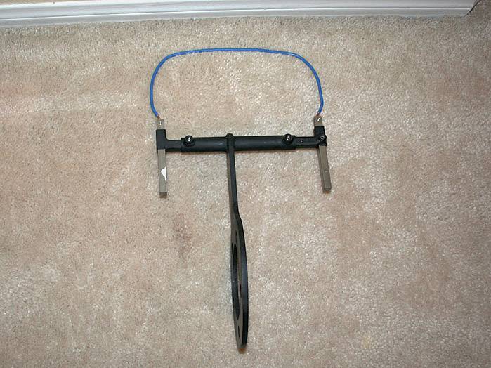

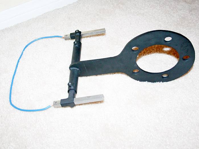

      Maybe a home grown tool? If you can weld or do wood work (yeah, one can be made of wood that will do the same thing) you could make one for pennies on the dollar, even free-ish if the scrap is on hand.
      This gauge will simulate at the large size a 16.5" wide x 24" tall wheel. With a max backspace of 11".
      At the small end it will duplicate a 6.5" wide x 15" tall. And a min backspace of 3.75". Front space min at 2.80".
      The pic with the wire is where I will bolt it up simulating a 17x7 wheel and a 215/45/17 tire. Back space of 4.5" Im actually kinda excited!! No more guessing for me.. All scrap laying around cept the set screws. Had to buy them. JR
      16.5" wide by 24" tall wheel
      17x7" wheel with a 4.5" B/S 215/45/17 tire..
