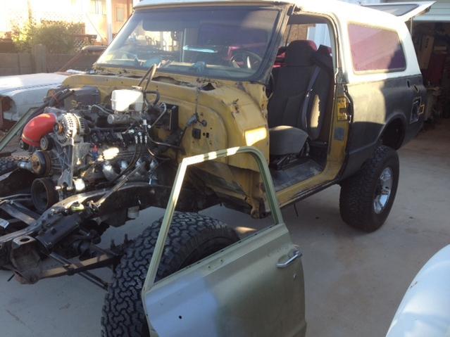

      I did this on my 72 Blazer but its not finished. I have a GM master cylinder and used two hard lines to go into the Wilwood proportioning valve. From the Wilwood valve I have 3 braided lines, male flare fittings on both ends, going down to the frame. Each braided line goes to a hard line at the frame, two for the front and one for the rear. This is the only pic I have and its not that great but you can see the lines....
