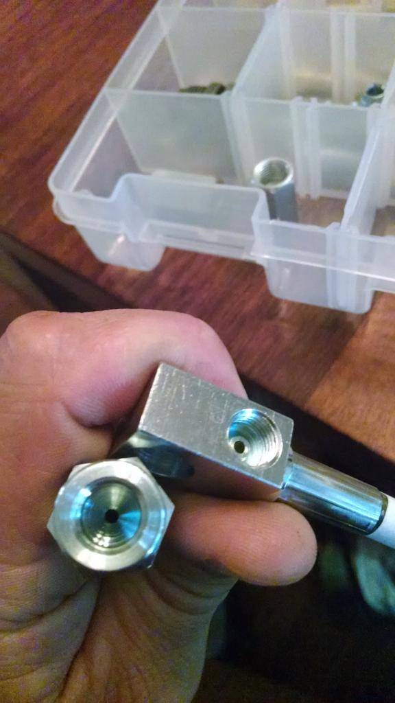

      Here is what the bubble flare looks like. Will this work?
      Here is a picture of the two types of brake hose connections I have. The one on the left appears to be a bubble flare connection (outer rear line) and the one on the right is the center rear line and appears to be a single or double flare connection. Is that right? I am using an aftermarket Russell braided hose kit that is a stock replacement for the 2002 Camaro I am using the brakes off of.
      Just need to make sure I understand what connection needs to go where. The fitting kit I bought has a lot of fittings but not a lot of descriptions.

      The hose fittings on the 1998-2002 caliper hoses are M10x1 bubble flare and the rear center hose is M12x1 bubble on the frame end and 3/8-24 inverted flare at the tee fitting. Your bubble flare looks solid...nice work.
