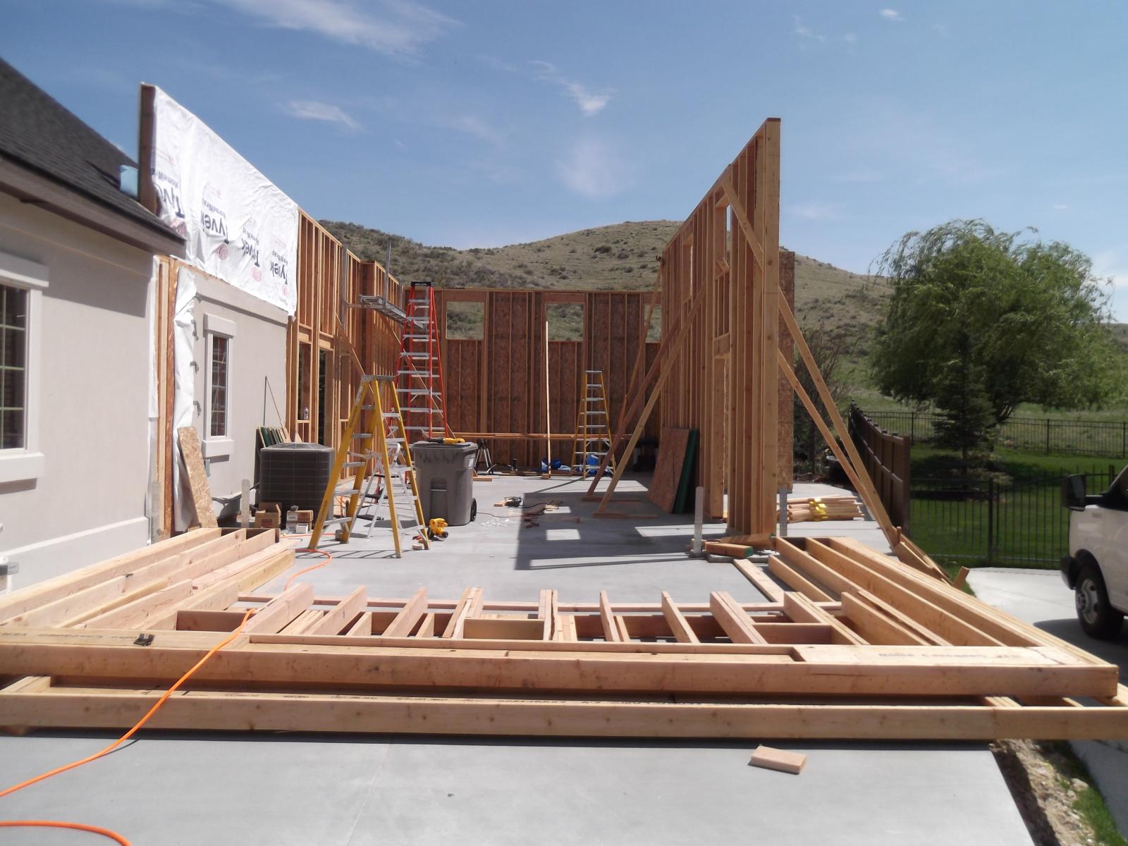

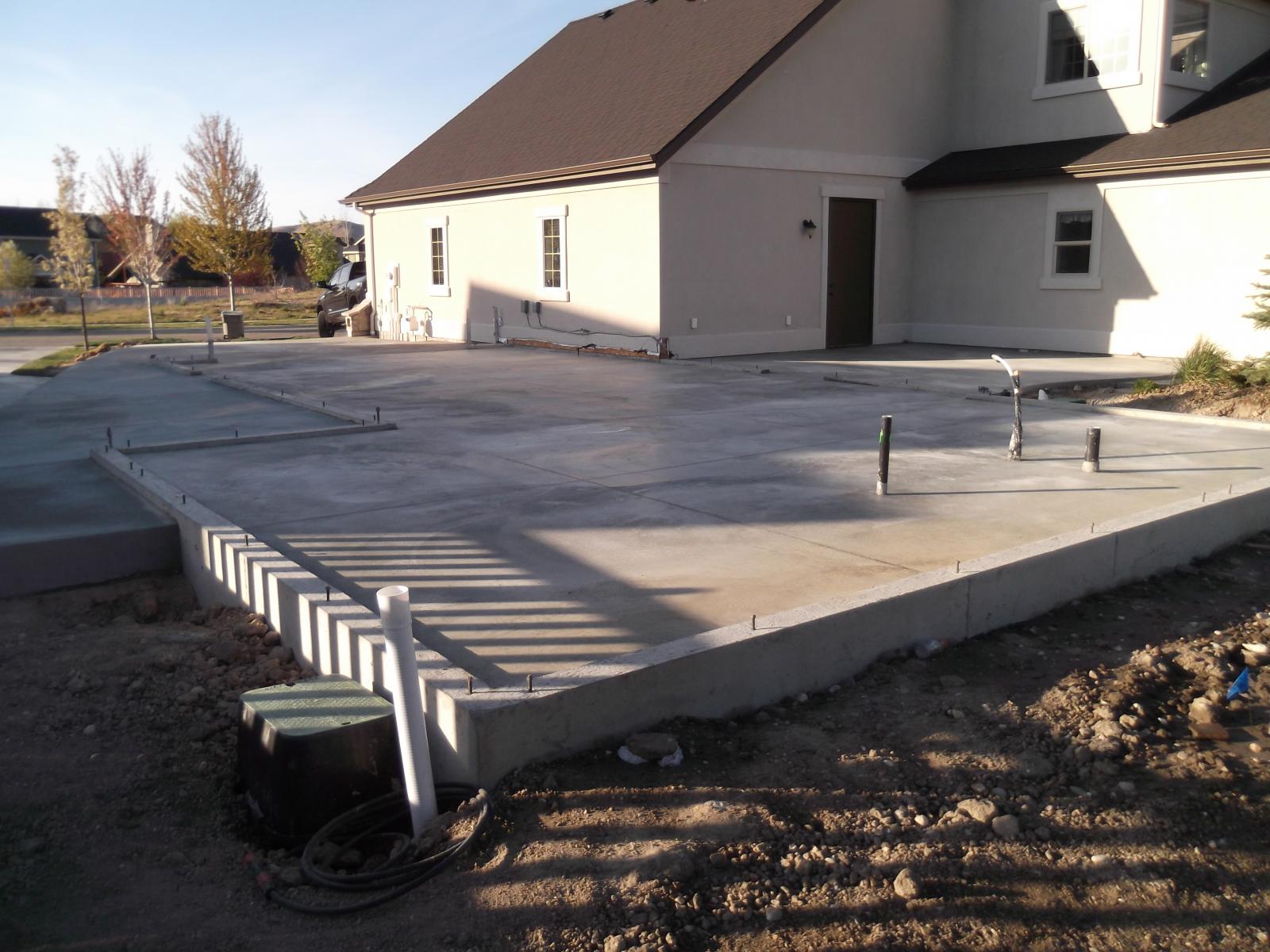

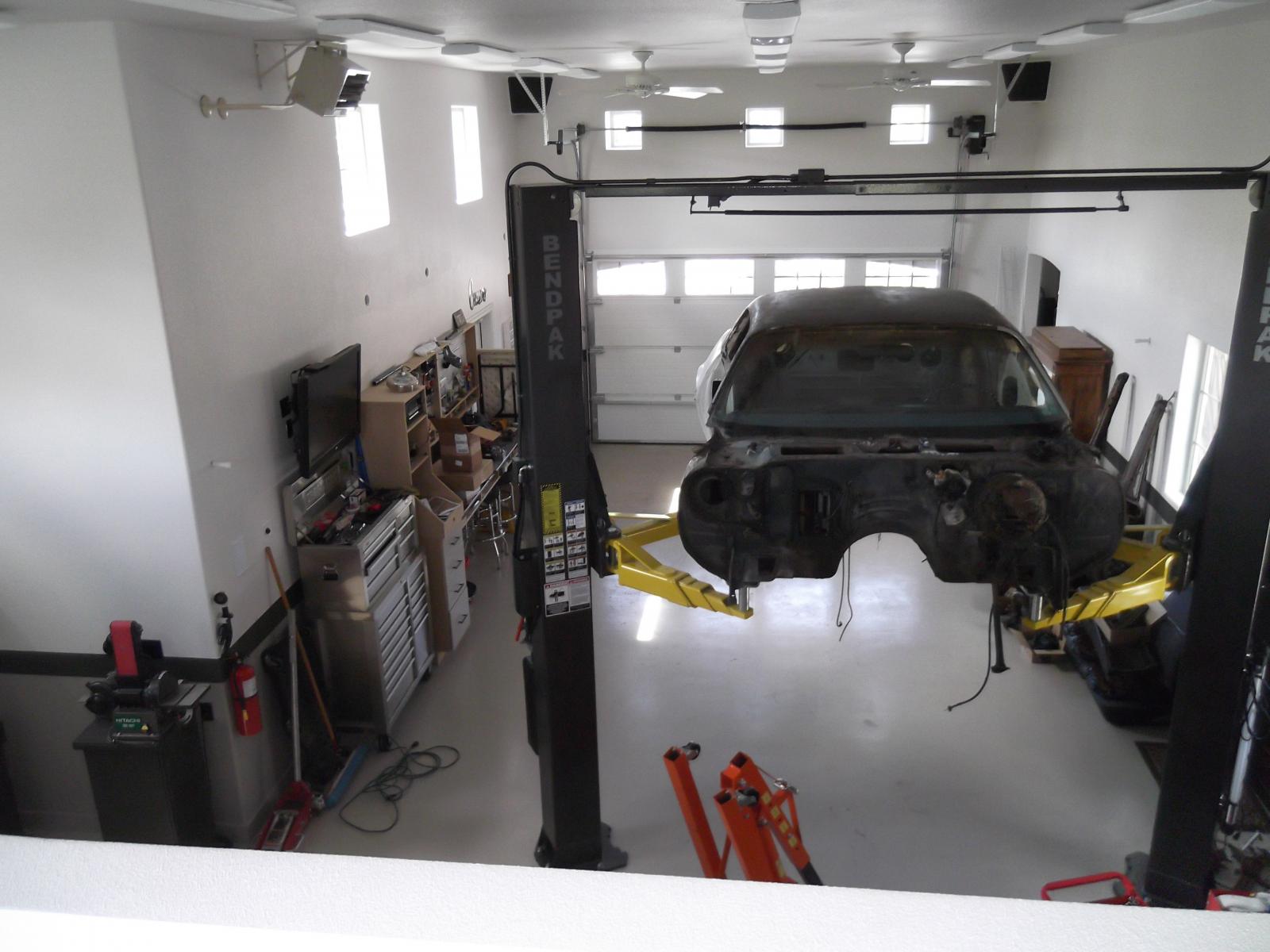

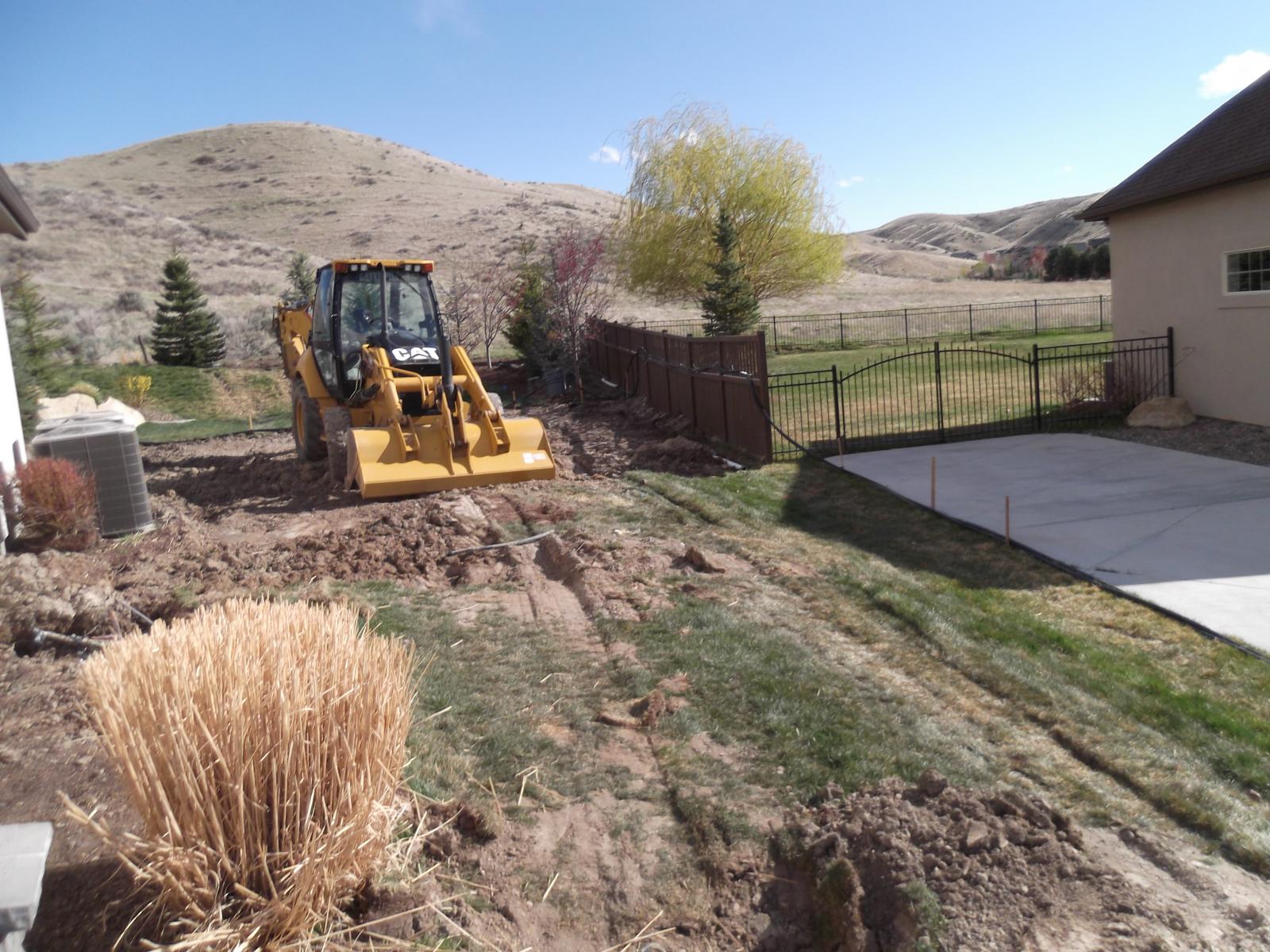

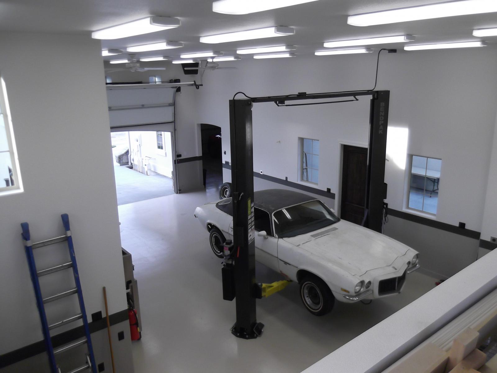

      Been involved in many forms of racing my entire life from Karting to Stock Cars to Drag Racing. Moved to Boise in 2007 and last year we added a 1200 sqft shop to the side of our garage so we could build our 70’ Camaro PT. Did 90% of the construction myself leaving the drywall and stucco to the experts, or at least leaving that work for someone with younger than 48 yold bones!! We are about 95% complete, pictures attached. Put in a 2 post lift, a small paint room, a bathroom and a pretty large 2nd floor storage area. Pretty proud of the results and so far I haven’t heard from a lawyer with any papers to sign!! Wife is spectacular!
      Bought the car in So Cal when I was down visiting last year, mostly a rust free RS. It’s in disassembly right now with the fenders, hood, deck lid and inner fender panels at the media blaster just yesterday. Only have the dash to remove and some other little clean up then it will get mounted on the rotisserie that I stole from a guy on Craigslist for $700. Should have that ready for the blaster the first week of July (tied up with large projects for work right now…gotta pay for all this stuff!!).

      Nice shop! What finish [if any] is on the floor? What model hoist is that? I am currently building my own shop with room for a hoist! and almost have it enclosed so wondering about floor finish.

      Thanks. The lift is a Bend Pak. Pretty pleased with it overall, I painted it black using that Rust Oleum hammer finish paint. Level and square is the key to installing. I used a commercial grade 2 part epoxy from Sherwin Williams on the floor. Pleased so far. Apply it thicker so you don't get roller strips.
