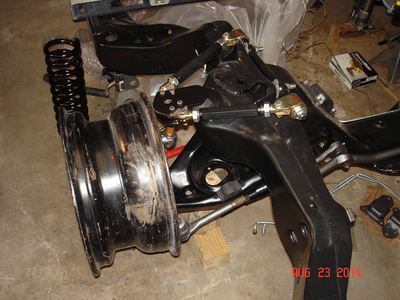

      Sorry about the F-body comment, I read Pontiac and assumed Firebird. I've seen guys weld plate steel to the bottom of the stock LCAs around the ball joint for more strength. That seems to be where they break when they fail. In my build I'm using the stock LCA with SPC adjustable uppers, stock spindles and tall ball joints, but I'm wondering if it's smart to run modern low profile tires with 40-year old stamped steel LCAs. I just didn't want to mess with all the spring pocket spacers, or coil-opver conversions that come with the tubular LCAs. Here's a couple pics of my front suspension.

      Adjustable arms
      Pitts64:
      The adjustable arms on my car are made by SPC and they're kinda spendy. I don't think SPC listed anything for a '64 Bonneville; however the arms are made from individual pieces, I'll bet you could mix and match components to get something to fit your car. I suggest you call Marc at SC&C to see if he can assemble something for your car. Here's a pic and a link.
