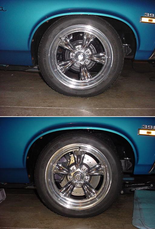

      I have a '70 Nova with a 454 and recently installed the BB Hotchkis springs. Prior to those I had worn out SB springs that allowed the front to sit at a decent height and provided a decent (yet somewhat soft) ride (top photo in link below).
      When I first installed the Hotchkis coils the front end sat 1.5" HIGHER than the old coils (bottom photo). Needless to say that wasn't going to fly so I cut a full coil out (yes, I allowed the coils to settle for a few months 1st). After that the stance was excellent but the tires rubbed the upper fender well. Point is.... If you cut the Hotchkis coils dont' go crazy like me, only cut 1/2 coil to start.
      Oh , btw the Hotchkis coils (and leafs for that matter) make the car handle like it's on rails but they ride HORRIBLE. If I had to do it over again I'd try the Hotchkis SB coils.
      http://www.danhardison.com/discs/before-after.jpg
      HTH,
      Dan
