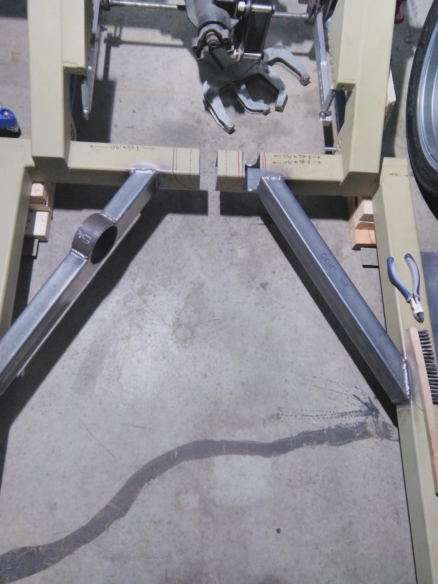

      I am finally getting back to working on my Monte again. I have rebuilt the perimeter frame out of 2x4x0.125 wall tubing. I have a cross member at about the middle of the frame for my truck arms. Then I have braces going forward basically from the truck arm mounts to the front torque boxes on the frame (see attached pics). I am thinking I want to some how route the exhaust through these by welding in some round tubing. I am just a little unsure on what size/ thickness to use. I am figuring on running oval exhaust, but is still think I am going to want the extra clearance. So if it goes through the braces, it will give me plenty of room. The exhaust is going to have to exit in front of the rear wheels, because it would be impossible to get it over the axle with the truck arms, panhard bar, and gas tank setup.
      Thanks for any and all suggestions. I was thinking about using something like 4"x0.250 wall? Not sure what I need to maintain adequate strength?

      So the question is: How to go about cutting a nice matching radius into my 2X3's so I can (hopefully) weld them cleanly and not have it look like I hacked them out with a stone axe?
      Any and all suggestions welcome.

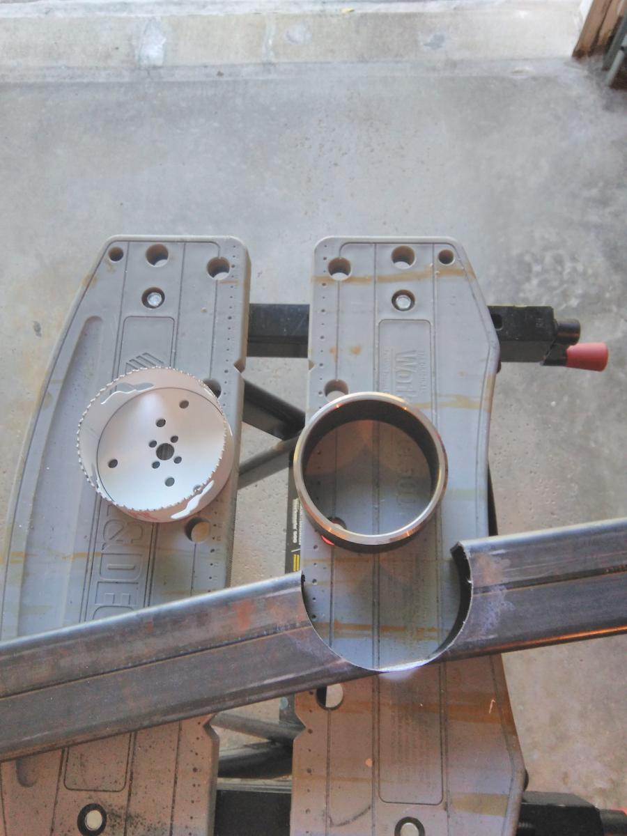

      So I took redss86/Joe's advice and picked up a 4-1/2" bi-metal hole saw. Wasn't sure how well my 18V cordless DeWalt would handle it. I've never hole-sawed anything that large. Shouldn't have been concerned, it powered right through it. Thanks Joe, worked great!

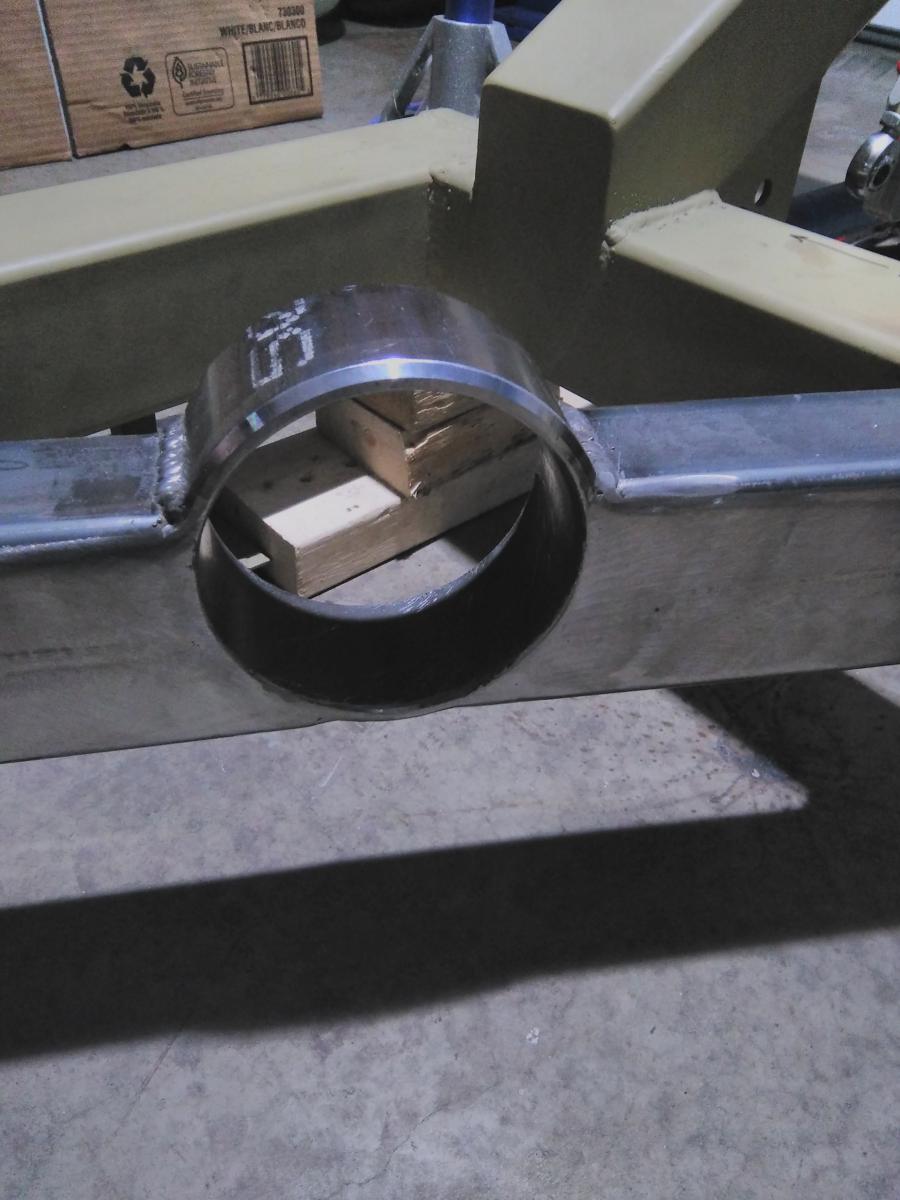

      This was on a 2" X 3" X .120 wall reinforcement tube. Clearance for round 3-1/2" single side exhaust; outlet thru-body in front of rear tire. Clearance ring/donut is 4-1/2" OD, 1/4" wall, so 4" ID. I have two more of these to do in the transmission crossmember for the 3" header collector extensions. I might start with a 1/2" smaller ring for those.
      The key (like most good outcomes) was in the preparation: measure twice, cut once. Carefully measured and scribed out the pilot hole location on both sides of square tube. Drill pilot from each side and run hole saw through each wall separately from each side. I made it so the bottom of the exhaust pass-thru donut sits flush with the bottom of the square tube so as not to give up ground clearance. (Bottom of the frame sits 4" off the ground.)

      The "web" that's left between the two walls was cut out in the following pics so that the donut would fit and sit flush.
