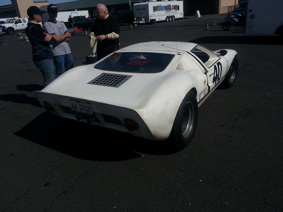

      60% weight on the rear wheels can make for a well handling car. I had fun chasing this guy in my camaro:
      On topic the AP racing stuff with cooling ducts would be the best of the two options. StopTech or BrakeMan would be better though.
